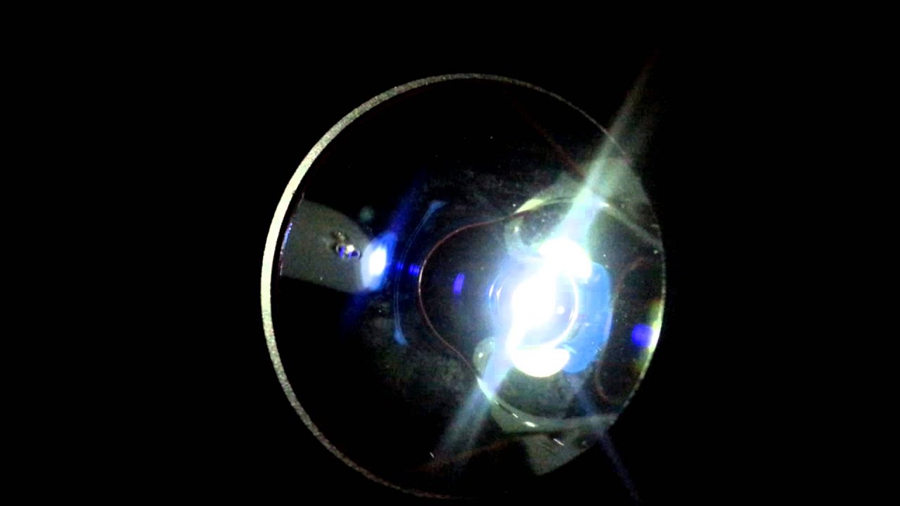

A thing cought my attention in lowest mode i can see light flickering and ramping all by itself.
Also when i press the button sometimes it changes mode, sometimes not, sometimes when it should shoutdown it changes mode for a millisecond before powering off.
Made a video of the flickering, i wonder if could be all related to the button or a bad joint?
Note that i was helding the light in the middle of the tube with one hand and the phone with the other, so i never ever touched the power button while shooting, you can even see the light ramping in full mode by itself
(it did it also one time while a was looking at the led in the lowest mode to see if it was just barely an impression or something else …. LOL
First thing I would check is the retaining ring on the tailcap to be sure it is tight.
Next are you using unprotected or flattop batteries? I tried some in mine and they just were not quiet long enough and the slightest bump or shake would cause a flicker.
If neither of these work for you PM me and we can see what we can come up with.

Cells were panny’s ncr18650b protected.
