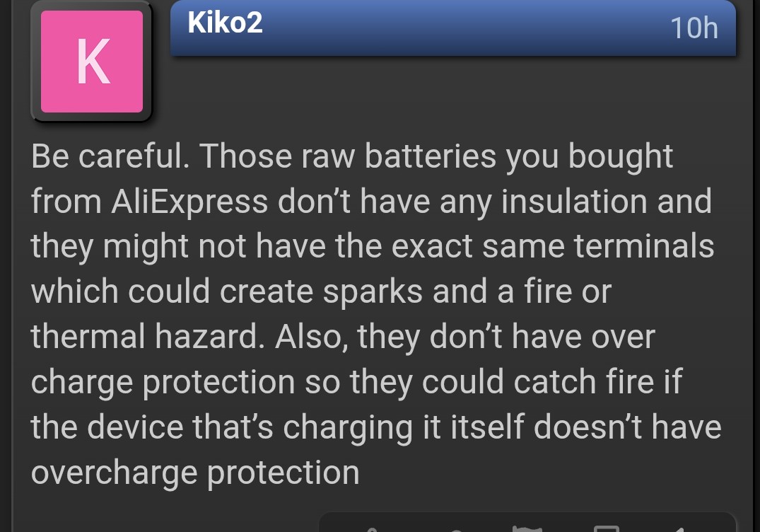

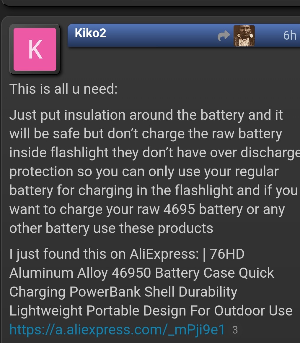

The other guy(Kiko2) was telling me differently that is not safe and all this stuff can happen using the Eve 46950.

What makes you think that if the manufacturer offers that USB-C charging option itâs not safe?

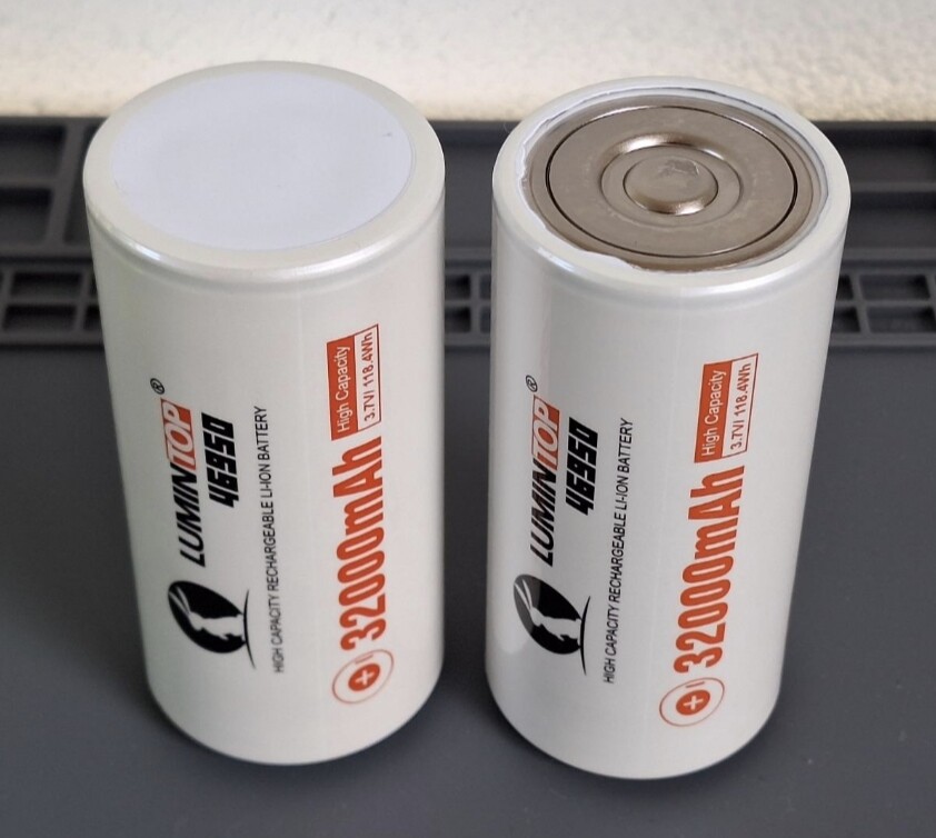

Itâs completely safe. The only thing you need to keep in mind is that the bottom of the battery should be insulated, just like the original Lumintop battery. You can put a plastic sheet over it to prevent it from touching the flashlightâs chassis, since the negative terminal connects directly to the top, as does the positive terminal.
The concern was the blue Eve battery not the charging method.Especially after what Kiko2 shared.

The problem is contradictory information from different people. See screenshots. Heâs telling me itâs not safe to charge that Eve battery in my flashlight because it doesnât have over discharge protection or whatever. And then all the things that can happen Sparks explosions Etc LOL
Iâm pretty sure you said the flashlight has over discharge protection when you charge it in there.

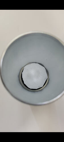

Howâs this sir? I used my 45-year-old German Landscaping hand pruners to shape it! Still as sharp as a razor.
Itâs a pill bottle top from Walgreens the big bottle, so I have plenty of drugs.

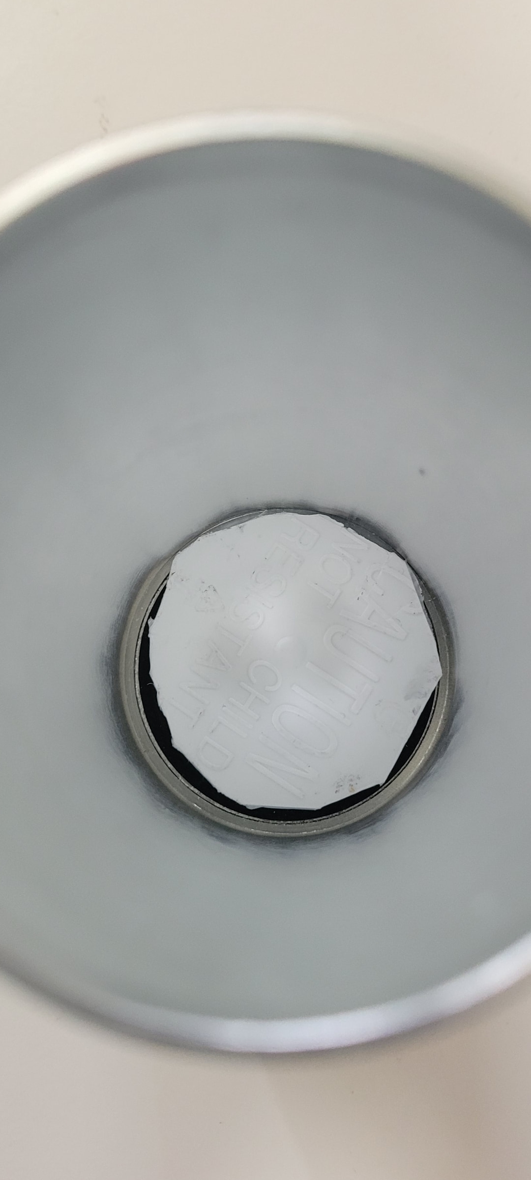

If I keep it. Should I put that plastic disc in there when I charge the eve battery? Thanks for your help sir.
I put the custom-made plastic disc in the light with the Eve battery and it worked. Its thin enough not to screw up with the connection.
What do I think? That youâre doing it backwards.
The terminal youâre covering is the positive one, and you need to cover the negative one, on the bottom of the battery as shown in the images I showed you.
Itâs best if it covers the entire circular surface of the battery.
You have to use it every time the EVE battery, both for charging it with the flashlight and for using it with the flashlight.
Also, the sheet needs to be thin, like the blue protective cover that comes with the battery, so it hardly changes its overall length.

What? That is the bottom of the battery tube just like the bottom of the battery which doesnât have the plastic insulator.
Is it the top of the battery both positive and negative? The bottom of the battery is neither correct? The photo you sent me is installed just like mine?
So what is the purpose of the photo you sent me of supposedly your light with a piece of plastic at the bottom of the tube?
The insulator on the Lumen top battery is at the bottom of the tube the top of the tube is a negative and a positive thatâs how I measure the voltage
Yes, itâs perfect. The picture confused me, and I thought it was the battery, but upon closer inspection, itâs the inside of the flashlight tube. Sorry, everythingâs fine.
In fact, the entire body of the battery, except for the positive pole, is the negative pole.
You can also put a sticker on the negative terminal of the battery, so you donât have to keep an eye on the plastic sheet . It will do the same job and wonât be as cumbersome.
