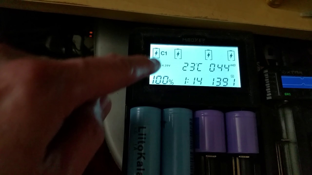

Here they are finished charging.

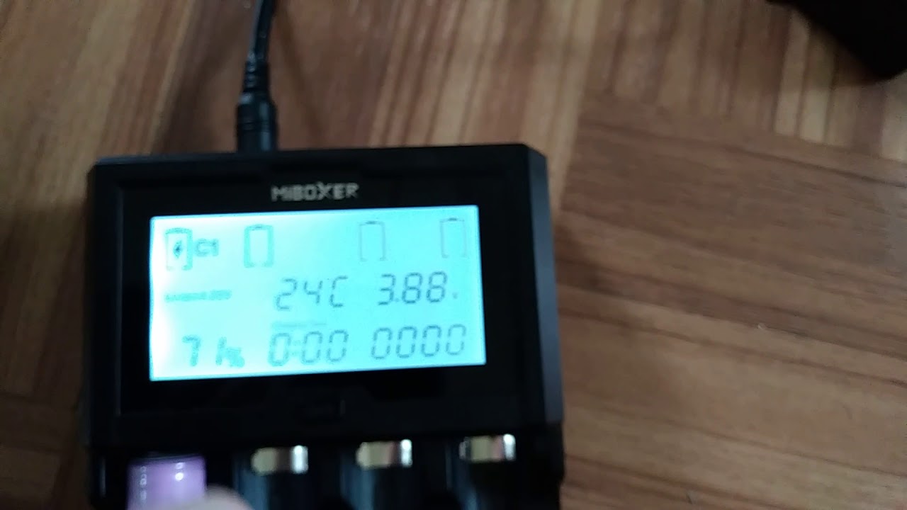

This is my Miboxer charger. Short video of how it’s been working. It don’t seem right. Been doing this with most cells lately. Gets the cells charged but it worries me now. Anyone else have this problem?
Something doesn’t look right. The drop in % of charge when you select a different charging rate in particular seems odd. Maybe it’s all a result of the very high IR that it is detecting on this cell, I’m not sure. My C4-12 doesn’t do that, but it does not show such high IR on this cell either.
Take a similar video with different cells (just to eliminate a potential cell issue) and send it to Leo @ Miboxer.
