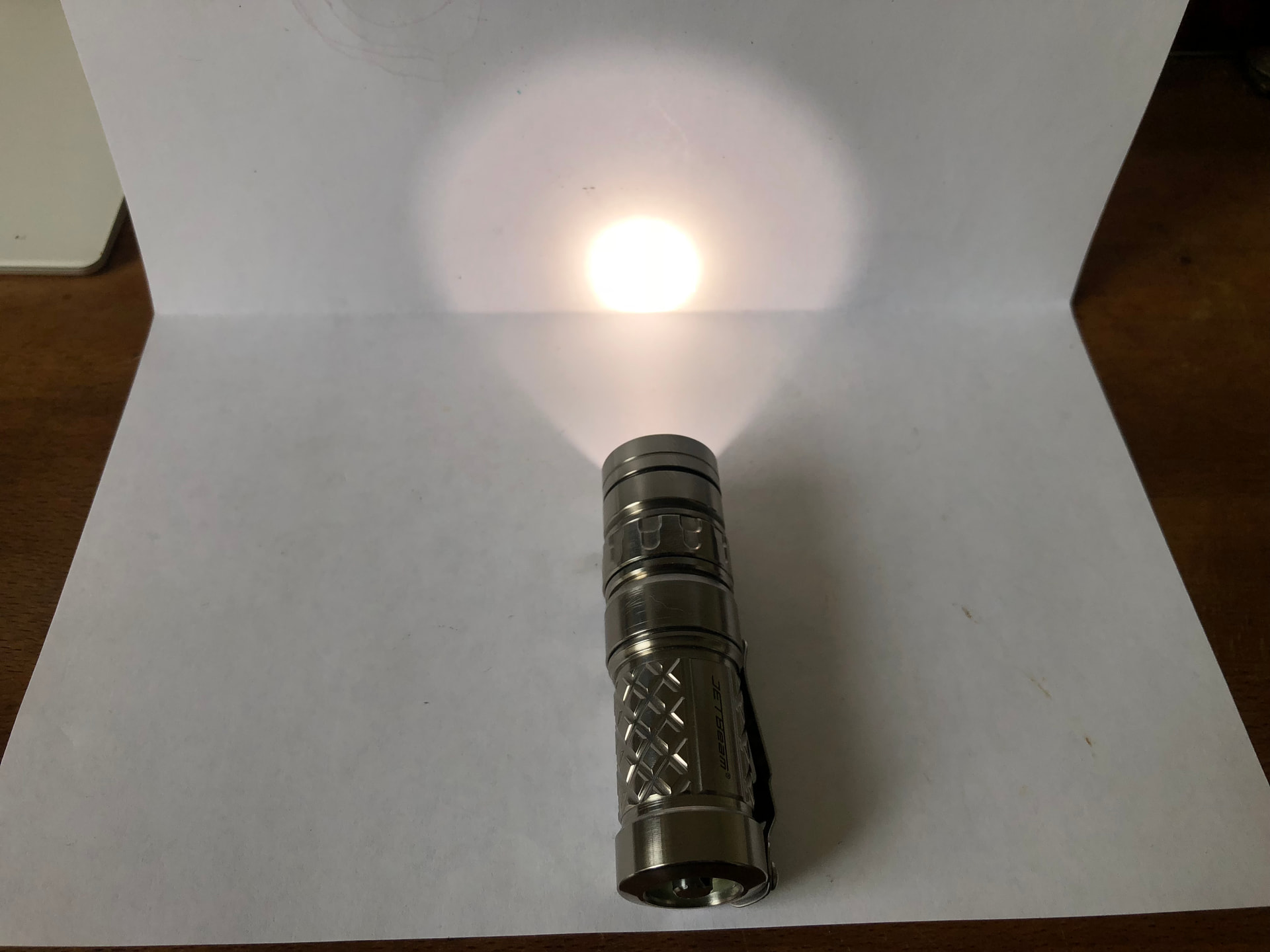

Tl;Dr: The UI and switches are excellent and the whole point of this light. The smooth, stepless dimming through the knob is fantastic and I don’t know of any other light that matches it. It will run on a huge variety of batteries too. The clip and beam are great. Build quality, brightness and throw are good. Runtime and ergonomics are fair. Regulation and voltage immunity are poor (on li-ion batteries). It continues to be the go-to rotary EDC light.

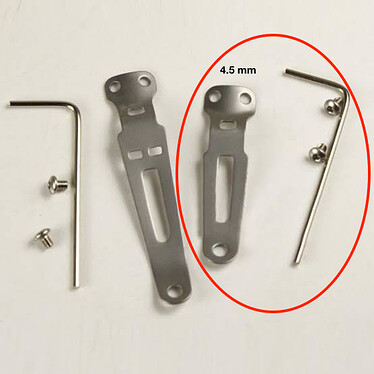

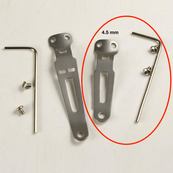

The rotary ring is comfortable to turn in a forward grip, but the clip partially blocks it in the shortest configuration.
there is an alternate clip, that is shorter and does not reach the ring.. it can be ordered from Jetbeam
My 219C sample is 80CRI, 4000K, with ~0.0050 DUV. A Nichia 519A LED would be a nice improvement, but I’m pretty happy with this 219C. The LED is set in an orange peel reflector.
I was disappointed by the low CRI nichia.. I wish they had used one of the High CRI ones.. but the light makes a good modding candidate.. fwiw the Cree LED version comes with a smooth reflector, imo the OP reflector is more desireable
