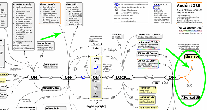

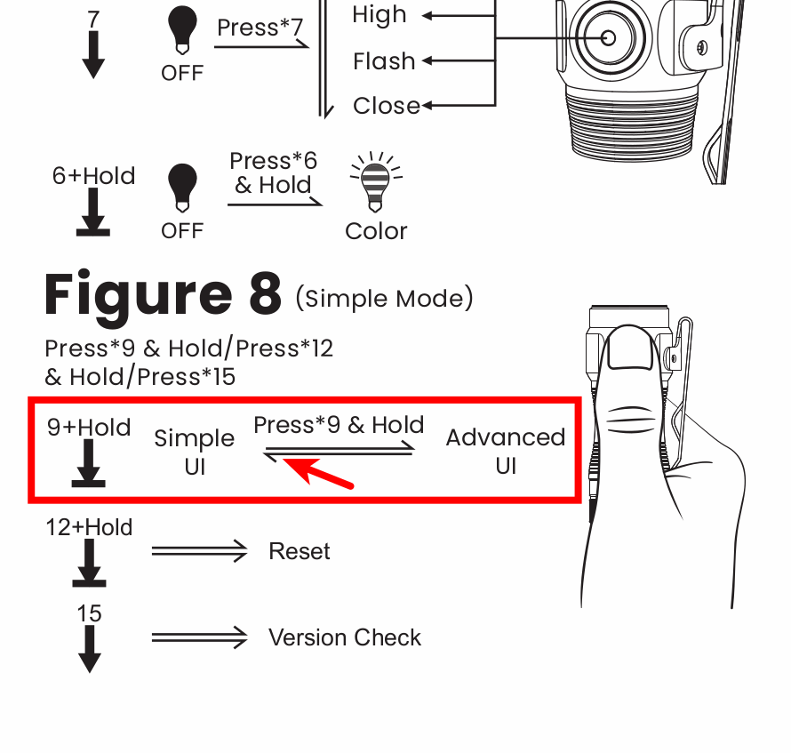

@Barry0892 Here is some feedback on a possible error regarding Anduril 2 in the user manual that came along with the SC13 Copper. This is not about the new layout itself (which, as I noticed, did not receive much love recently over at Reddit), but about the content of the description for switching between Simple UI and Advanced UI:

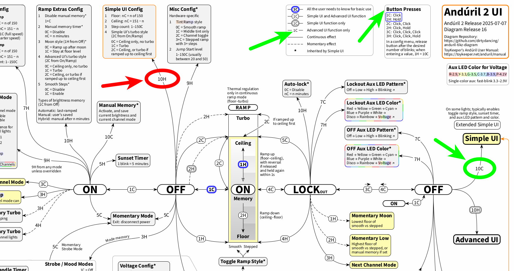

If I am reading this correctly, this description states that with 10H(or in your terminology Press*9 & Hold) you switch from Simple UI to Advanced UI, and back. But to switch back from Advanced UI to Simple UI, you need to do 10C (or in your terminology Press*10). 10H (or Press*9 & Hold) from Advanced UI will not go to Simple UI, but rather to the Simple UI config menu within Advanced UI.
To illustrate what I am talking about with this difference, I have marked 10H and 10C from Advanced UI’s OFF in this “vanilla” Anduril 2 (release 2025-07-07) diagram by myself (source):

I tried it, and it’s exactly as you said; switching from advanced mode back to simple mode requires executing 10C.
Yeah. I figure a straightforward fix for the SC13 Copper user manual would be to only document the UI switch from Simple UI to Advanced UI. As far as I can tell, the SC13 Copper user manual only focuses on Simple UI anyway.

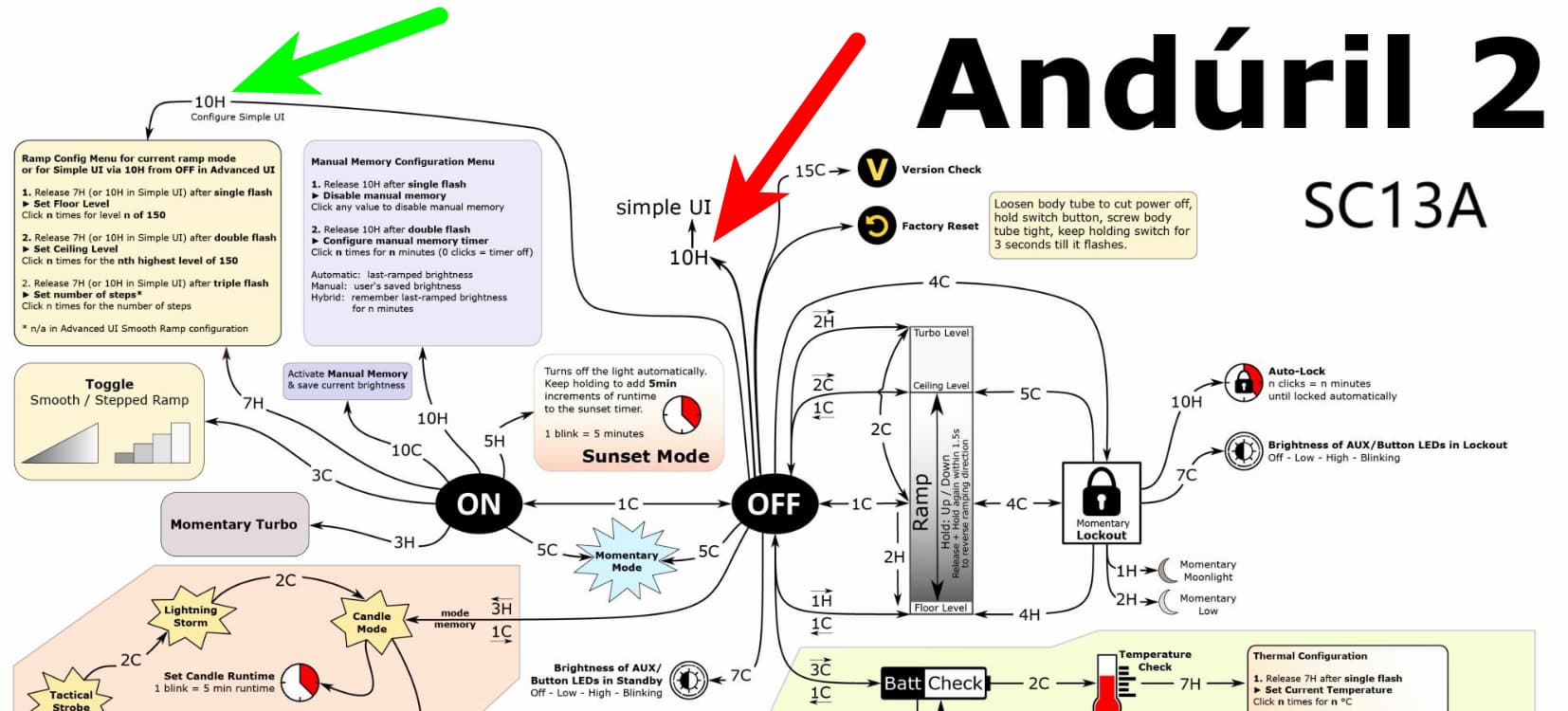

For some reason, I couldn’t locate the web page for the SC13 Copper with its user manual. But I came across the SC13A, and the user manual for this flashlight also wrongly states 10H for switching from Advanced UI to Simple UI:

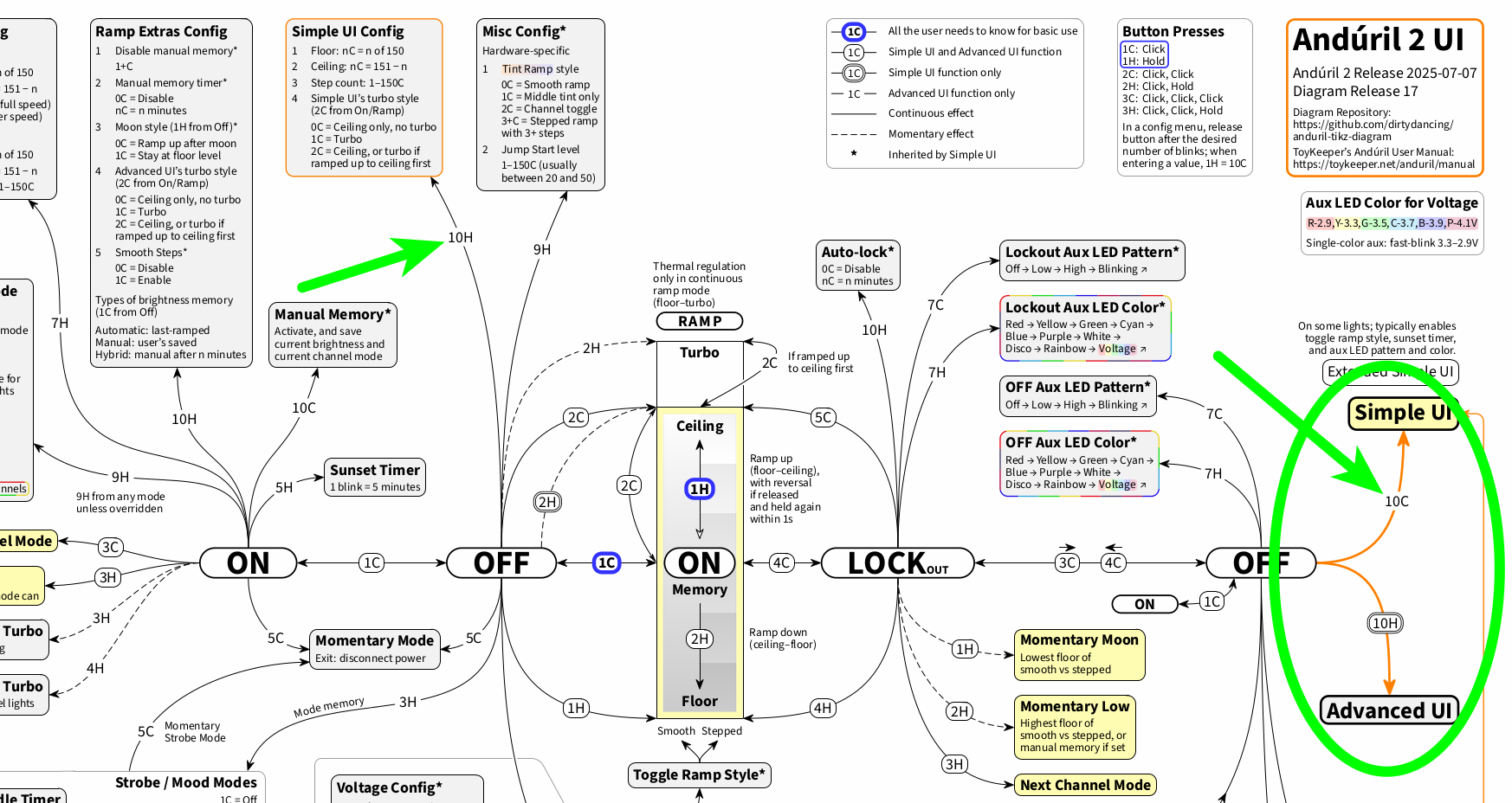

By the way, this situation has prompted me to visually highlight the UI switch lines in a new release of the diagram I referred to above, so all of this is helping to clarify the Anduril 2 documentation:
