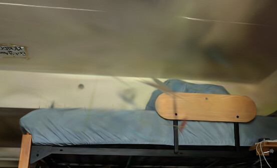

I’ve never heard of this technique until I saw this post! Looks very interesting. Do you have a guess for what in your original set of photos could have caused these “broken shards”?
I’d be interested in seeing what you end up doing with beamshots. From what I understand, Gaussian splatting (with its transparency parameter) should be very good at handling translucent objects, like a beam in the air.

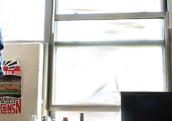

for the window, likely just that theres almost no data there, it absolute white, which is due to the limited range of a camera with fixed settings.
the rest of them is a lack of data, from the few views that cover where those shards are in the original data, it looks quite perfect, but from otehr views it doesnt. the program needs more views to really nail down the surfaces. since its not a mesh based method it can create visually accurate but physically incorrect renderings.
Im installing a update rn and a plugin that has better densification algorithms and a outlier remover tool which will remove the shards that are a significant distance away from the others.
A lot of this goes over my head, so thats my best attempt at explaiming it.

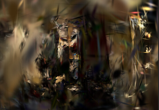

Presumably I didn’t capture enough data. There are black floaters that contribute almost nothing to the image, I assume these are from random noise in the images, blur, and some randomness introduced by the training process.
Also, fly inside of the mirror and look around.
I can share some other scans later that show this off better.
If you download lichtfeld studio you can render each ellipsoid with a opaque border which makes the error ones much more obvious

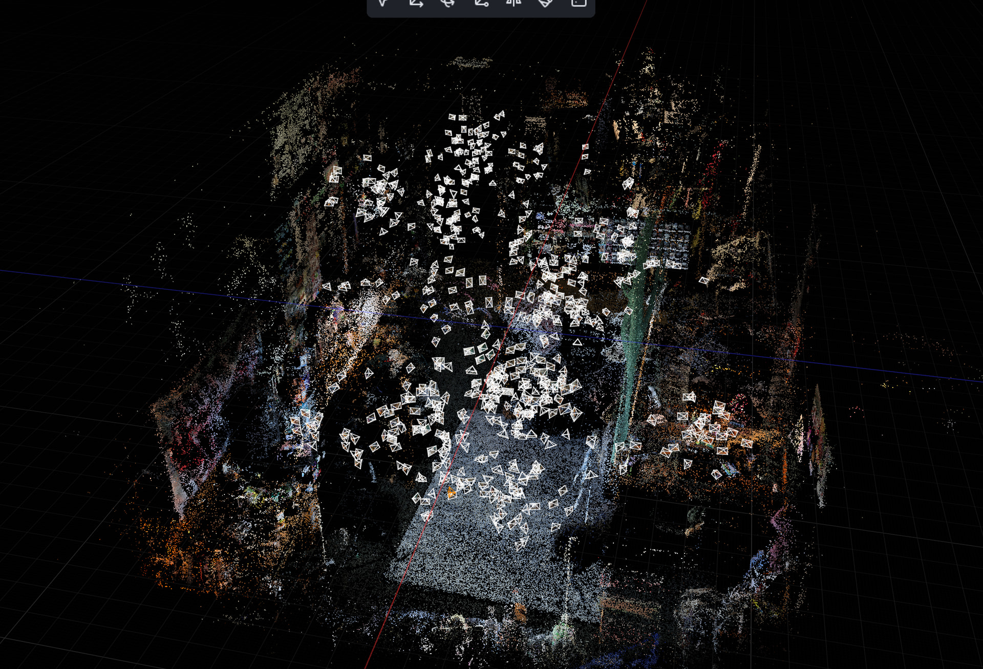

heres the point cliud that the splat initializes from, each white frustum represents the 3d position and rotation of my camera

Flying into the mirror is a great suggestion! It looks like the program interpreted the mirror as “a hollow frame with physical objects on the other side”, except that those physical objects have very few projections to be consistent with, i.e., only in the directions looking into the mirror. As a result, these objects are a complete mess when viewed from the inside!
