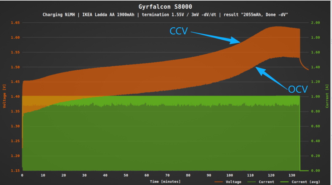

Actually there is one thing which I noticed: when put in a NiMh battery to charge, the voltage for the first few seconds spikes up well above 1.55V (between 1.6 to 1.8 V), then after about 10 sec or so gets back to normal range around 1.2-1.4 V, depending on the discharge state of the battery. But I noticed this voltage spike consistently and I was wondering if this is a glitch that can be improved or it’s by design. Thank you for any info on this.

Please don’t worry. This happens because the initial reading shows the closed-circuit voltage, while a few seconds later, it shows the battery’s open-circuit voltage.

Thank you Enova. Is the initial higher closed-circuit voltage the internal voltage without the battery (load) being applied, before the charge actually starting? Many thanks.
Please check the image below.
