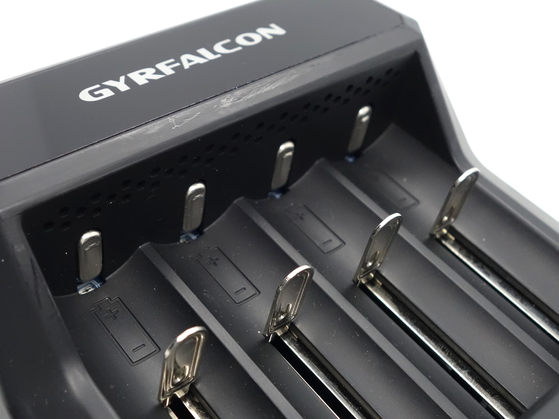

There should be dimples on the positive contacts to allow proper contact with flat top cells, especially for smaller cells around 10440 size.
I have positive contact issues with both the Vapcell S4 + V2 and the LiitoKala Lii-600 chargers that I have. Issues occur particularly when trying to charge smaller flat top cells like the 10440.

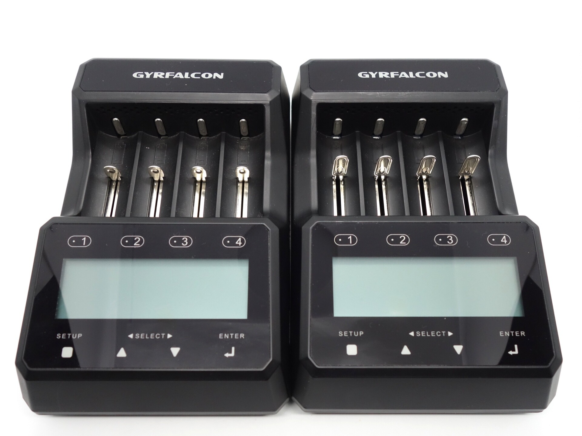

I visited Enova while in China just as a typhoon approached and Mr Wu kindly gave me up updated version of the S8000.
The user interface has a lock mode (firmware update).
The sliders are slightly easier to use.
The positive terminals have smaller notches.
The negative terminals are longer.
