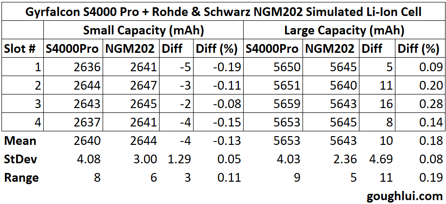

After six months of in-depth technical evaluation, Dr. Gough Lui has completed a comprehensive review of the Gyrfalcon S4000 Pro. We sincerely appreciate your meticulous and scientifically rigorous analysis of the S4000 Pro.
Capacity accuracy when tested against an emulated battery was within 0.3% (on an individual slot basis) and averaging 0.2% (across all slots) when the reference equipment (Rohde & Schwarz NGM202) has an intrinsic error of around 0.05%. This is much more accurate than ordinary chargers which often only claim to be 1-5% accurate. The ability to set and measure current and voltages at fine granularity was another key thing that impressed – the unit meters down to 1mV/1mA with “fitted” error of <4mV/2mA as compared to a Keithley 2450 SourceMeter SMU.

That’s an impressive review! I hope Gough’s health has improved.
It is great to see Gough use the Rohde & Schwarz NGM202 and a Keithley 2450 SourceMeter SMU to check the accuracy of the Gyrfalcon S4000 Pro.

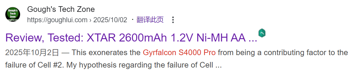

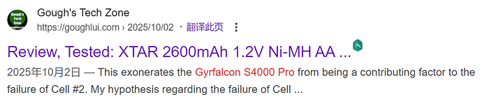

Gough used the Gyrfalcon S4000 Pro as a testing device to evaluate the X*** 2600mAh Ni-MH batteries.
