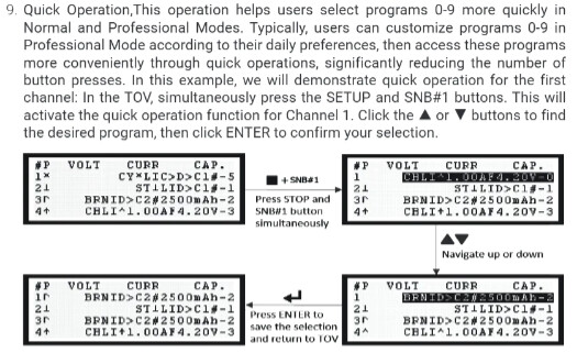

In addition to the method introduced in SammysHP, you can also use Quick Operation to conveniently access programs 0–9 in both Normal mode and Professional mode.

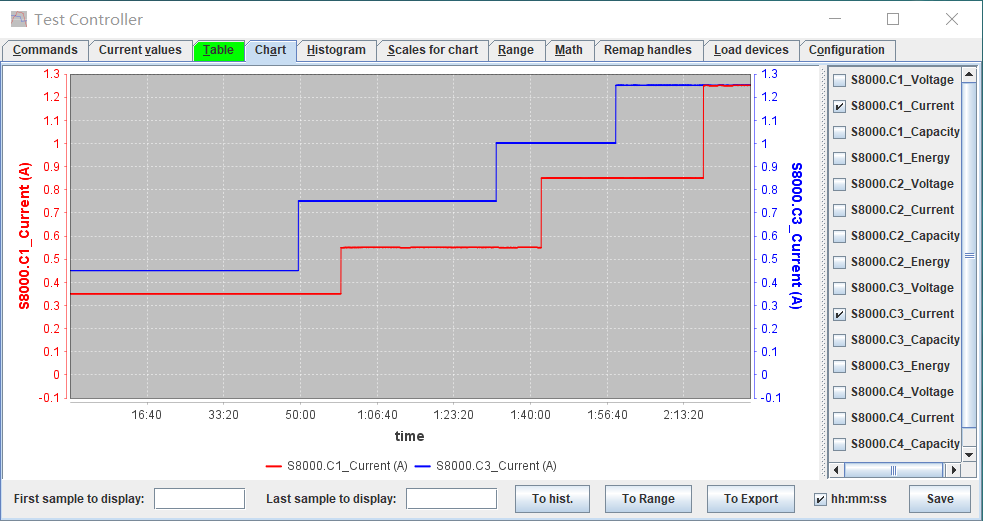

In response to feedback from some users that the charging current in Simple Mode on the S8000 and S4000 Pro is initially around 350 mA and appears low, we would like to clarify the following:
In Simple Mode (Auto Mode), the charging current is dynamically determined based on factors such as battery type, voltage level, internal resistance, and charged capacity. The current will gradually increase during the charging process. This is normal operating behavior.
The charging current trend can be referenced from the S8000 Simple Mode charging curve:
  • The red curve represents Li-ion batteries
  • The blue curve represents Ni-MH batteries
Therefore, a lower current at the beginning of charging is expected, and it will increase progressively as charging continues.

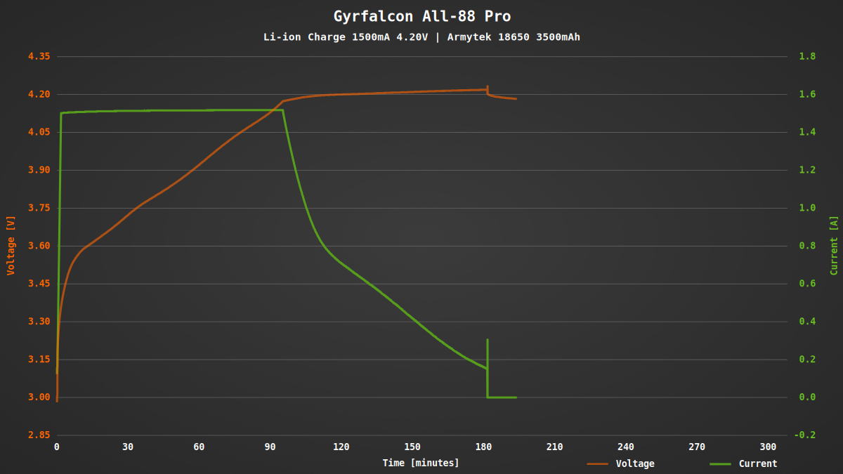

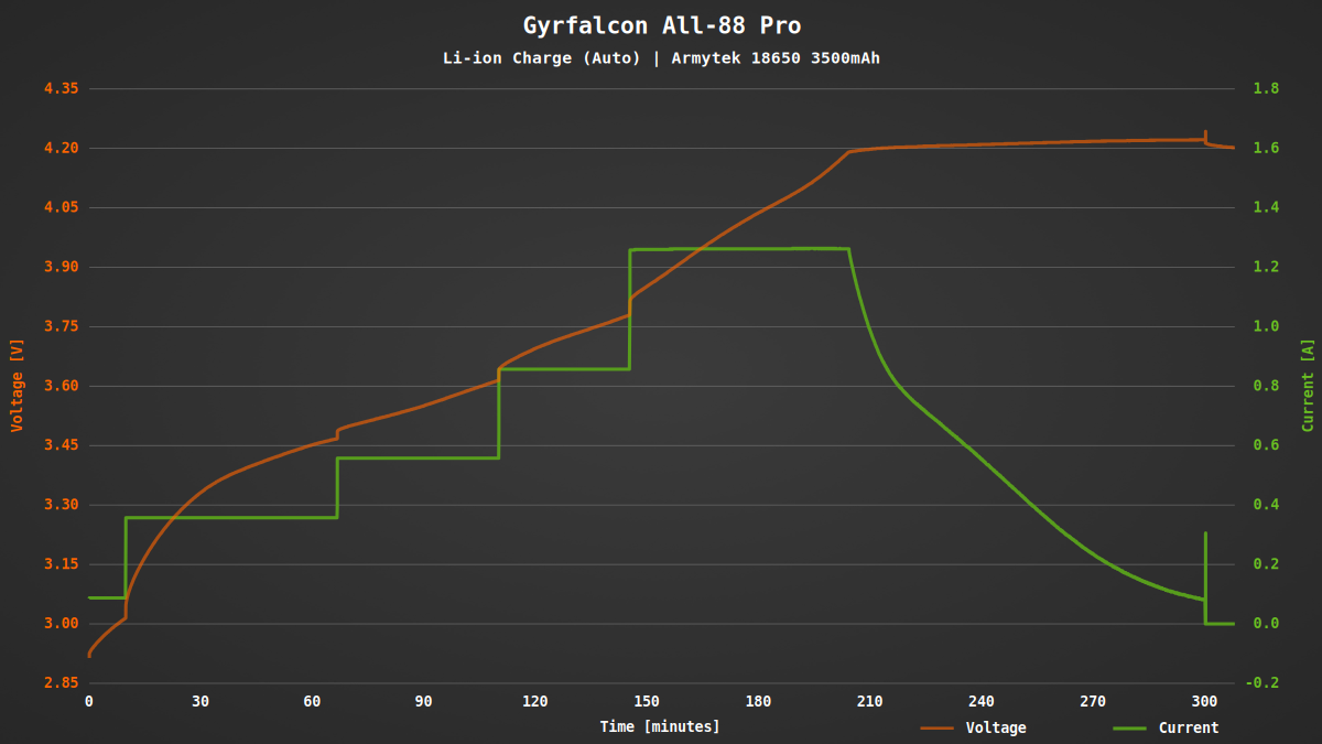

The same behavior can be found in the All-88 Pro:
Compared to manual settings it takes significantly longer, but on the other hand it doesn’t charge low capacity batteries with too much current. Internal resistance isn’t enough to select a current, so this approach makes sense.
