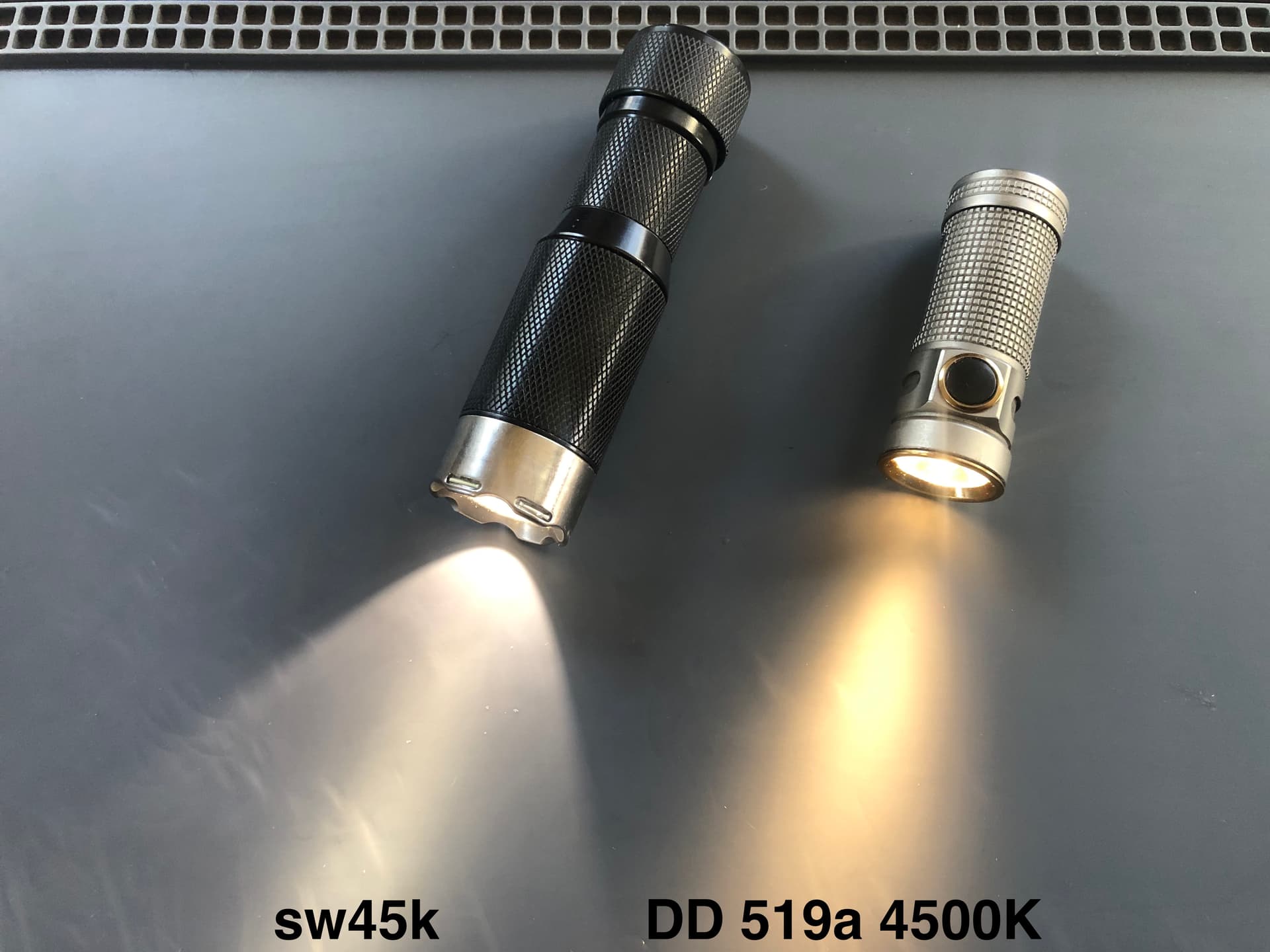

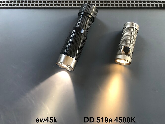

agree, and the not warm is what I like about it, during the day, when my eyes are adapted to daylight
at night, when my eyes are adapted to my Incandescent house lights, I prefer a warmer light than during the day.
they each have their uses, under different circumstances
I like warm for relaxing uses, I like sw45k for activities when I want to be more alert
These are my two favorite LEDs, I use sw45k during the day, and the DD 519a in the evening:
Yes I am not hating at all. Its just I have a lovely D8 with 519a 5700k that serves the purpose of a lovely pure white (without the rosiness unfortunately). Its just not what I wanted, at least not in this host :slight_smile:
That’s a great photo by the way, that is very close to spot on of what my eyes see with mine over here for the SW45K.

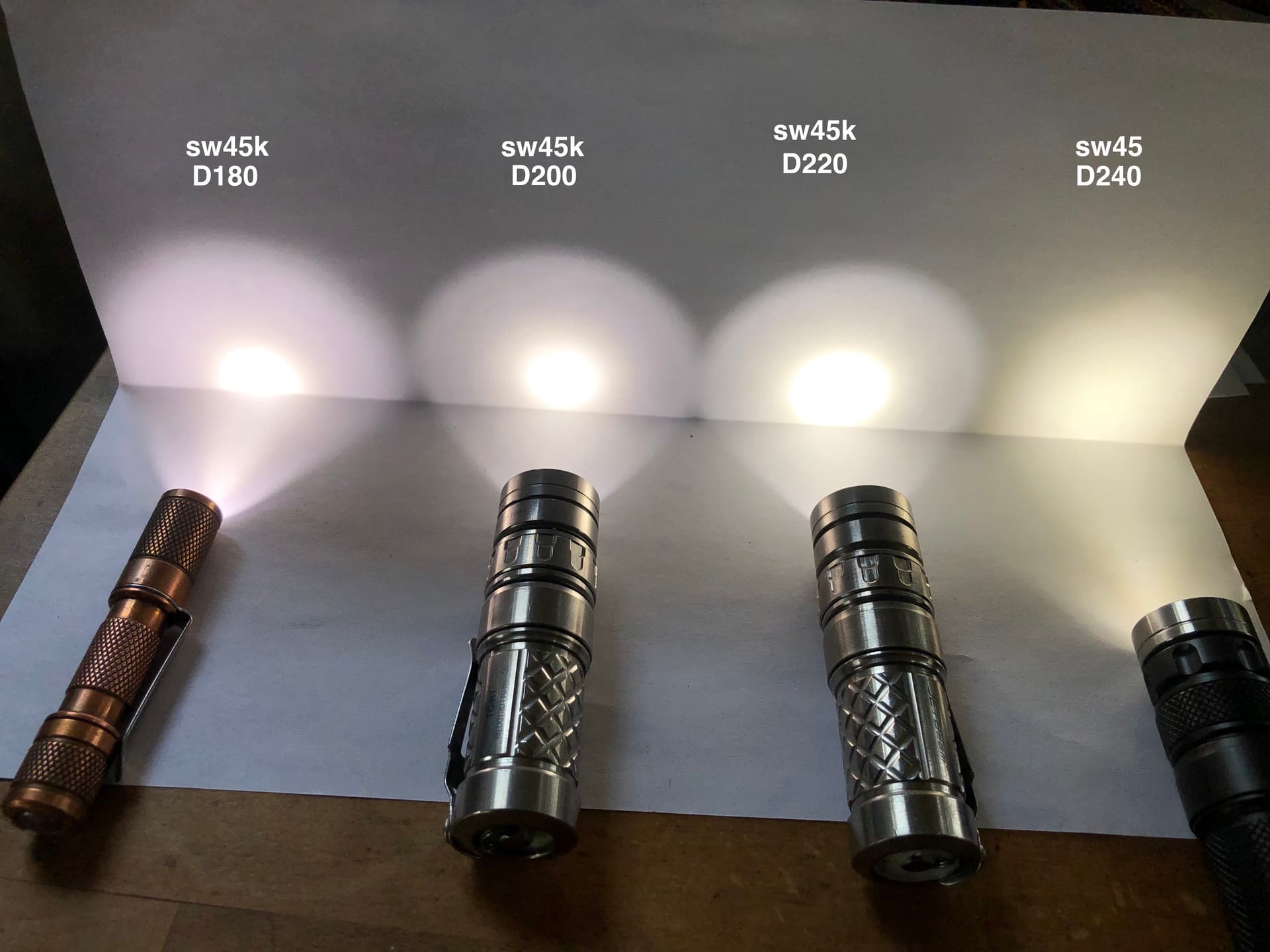

fwiw, when the sw45k first came out, around 5 years ago, it was the only 9080 LED… the extreme pink of those D180 LEDs became a sign of Ultra High CRI Ra And R9
but there was consumer backlash against the extreme pink tint, and the lower output compared to Low CRI LEDs
So the D180 was followed by D200 (11% brighter and less severe pink tint), and later that was superseeded by D220 (another 10% brighter and GREATLY reduced pink tint, which is where we are now.)
Presently available D220 sw45k have very little pink tint, as you noticed.
for illustration purposes (tint also varies with output), here are some of the sw45k I have owned… (they have corresponding Tint duv differences ranging from -0.0125 down to about -0.0035)
