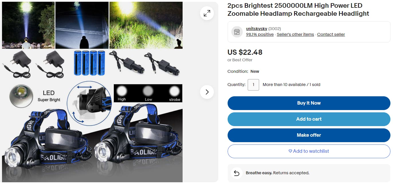

Definitely room for improvement but when you have a light like the TS10 selling for sub $10 its gonna be hard.
C’mon… we’re almost there already.
And it might be 50bux, tops.
Hot damn, who doesn’t like a 900000 lumen strobe light right up their faces!
At this point they are just chucking 0’s up there. I’d be surprised it can output more than 250 lumens IRL.
I was actually hoping to find some headlight bulbs - which I recall claiming gigalumen output, claiming more wattage than alternators have to spare.
Be careful! It might back feed into the electrical system and even blow your engine up.
