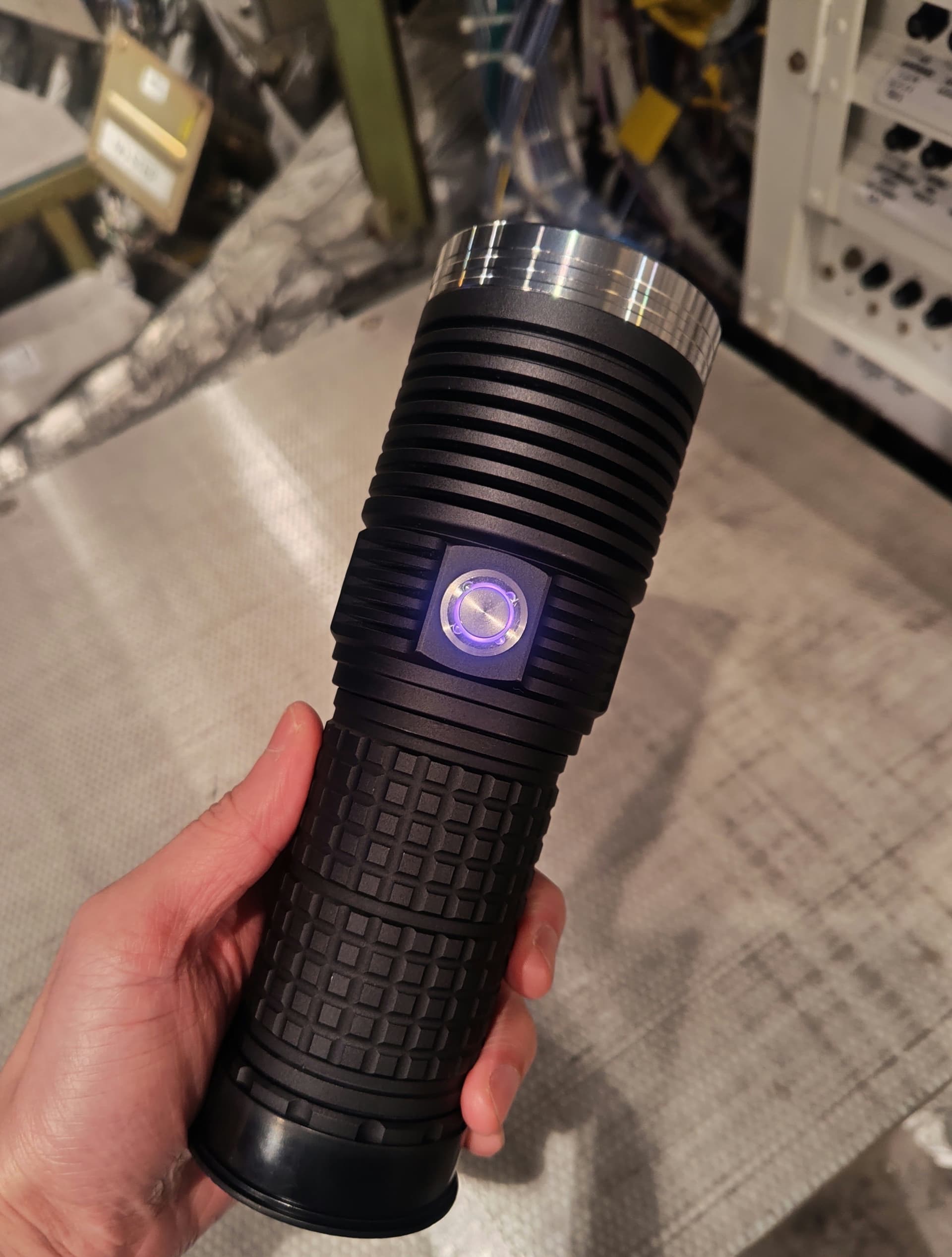

Thanks! 18650 is not a hard requirement
So then would the Convoy S11 with XHP50.3 HI R9050 be the best option since thats like a 26650 version of what you said?
I have no idea how those calculations work but chatgpt said that the Convoy S11 with XHP50.3 HI R9050 with a Vapcell K70 26650 7000mAh would run for 1.3 hours if it were to run for 100% continus but then it added that the XHP50.3 HI would step down to regulate thermals and because of that it would have a runtime of exactly 2 hours. no idea how acurate that is but that does sound like exactly what im looking for. it alos has a 4000k version and it has high cri which are not really requirements but very nive to have
This sounds like a reasonable option from your requirements. Be aware that it is a pretty big light. As you might conclude by the fact that it uses a 26650 cell. I have one. It is bigger than I would want for pants pocket carry.
I have a C8 with that very emitter and mine has an ugly green tint, especially visible at low settings, indoors. 4000k. At 100% it is a bit off to me when indoors.
I can’t tell you about running times as I use it for short tasks only, a battery can last to me two three days easily (I have three Liitokala 3500mAh,35A)
