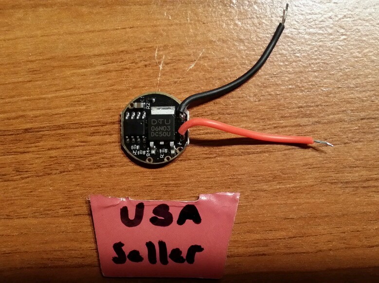

yes, seller sent me the wrong drivers. I got a full refund. Problem was solved quickly and nicely so I can recommend the seller. Its all good! :)

That one you linked to sent me HX-1175C’s. He told he he could not get “b”’s because the manufacture does not make them any more. After I escalated and was refunded, he sent me a message saying he had “b”’s and could sell me some. I passed. Best of luck. Hope you get the “b”’s. By the way, that is the same vendor you purchased from earlier, just a different account name.
How do you know the Ebay seller (boyatech) is the same as the aliexpress seller (2012beautifullife ) that sent us the wrong drivers?
I hope its not the wrong drivers again. If so, ill try and get a full refund (like I did last time). Picture clearly shows HX-1175B. Description and headline clearly says HX-1175B. If its the same seller, he better have learned by now.
