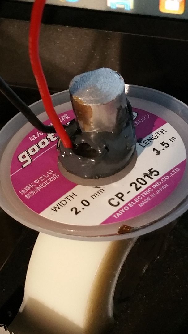

Here is a picture of the FT version I just potted. I've already tested it on high for 5 minutes and it is doing well, still hot as hell, but running good. I intend to pot it further into the inside of my Supfire L3 pill cavity.

Nice find. Think I'll take a couple too. Looks like the same driver only with the "correct" inductor installed on it. Heatsink it! It will blow if you don't. This one too like rich's is running at 5 amps. I won't trust anymore of these 5 amp drivers without encasing them in a block of aluminium.

Well, I know this one works. Had it in there previously, but only 2.8 amps. Guess what? Its going back in...
However, that potion is working very very well, strongly recommended. JB weld and some of that pixie dust I mentioned above. And of course, you need a reliable driver. There aren't any unfortunately >3.5amps on 2 - 3 cells.
