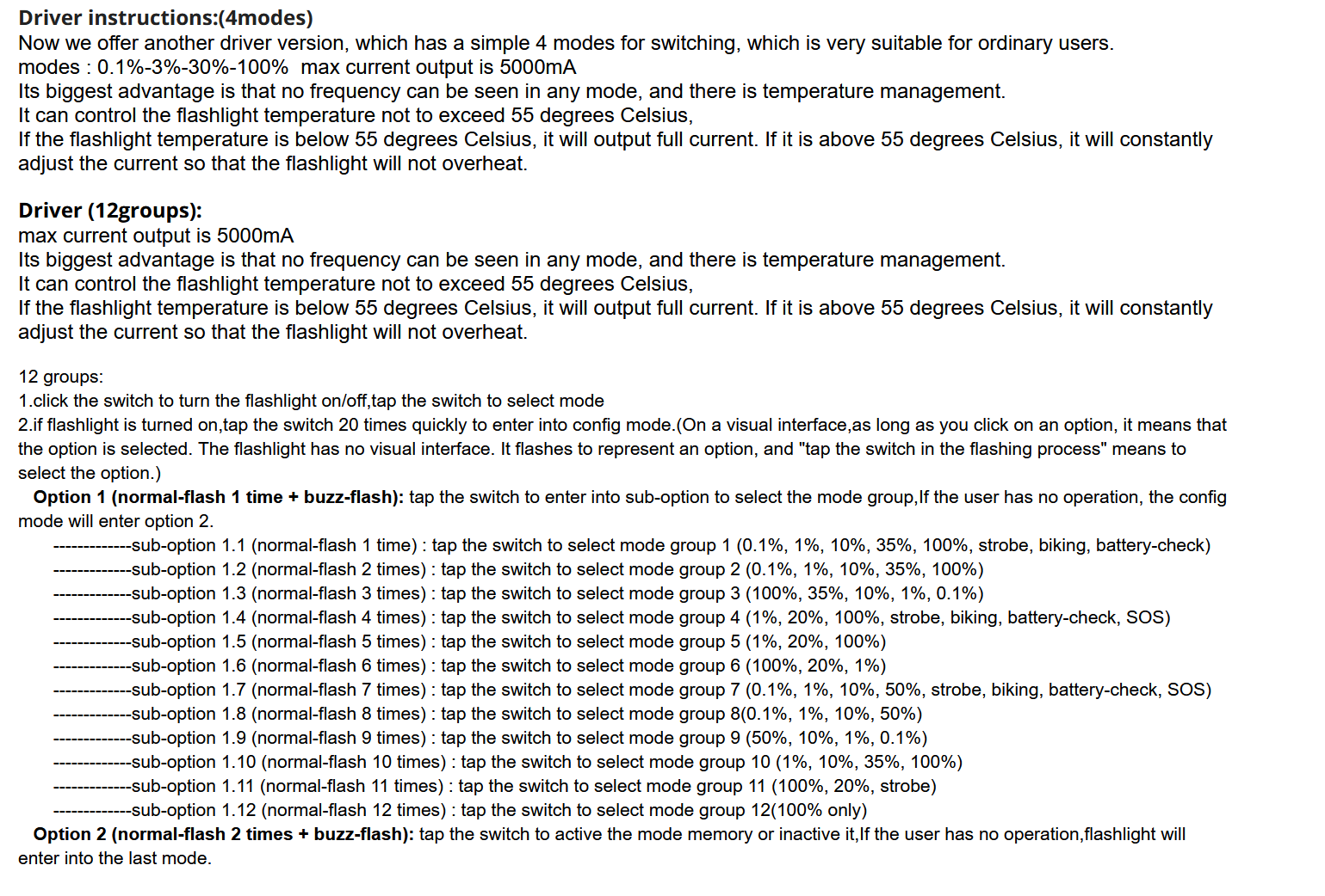

How to change group with Convoy S2+? Alix instructions not working
New Convoy S2+ owner, just received my 519a 5700k and can’t get out of 1st group. The ali express instructions say to click 20 times but mine just cycles the modes in group 1 over and over. I’m sure this is me being dense - any dumbed down instructions available?
i googled my butt off and see numerous different methods suggested - I can’t seem to get any to work.
You should cycle in pace of about 2 clicks per second. After 20 hits you should notice the flashlight stopped cycling modes and gives 1 second high frequency strobo. That’s how programing start.
But I encountered once faulty driver which programing mode couldn’t be accessed. It was like yours, only cycling through first group. So the latter option is possible if you make sure you’re doing it correctly.
You need to Tap(Half Press) it 20 times, not click.
If you click it, you have to start all over.

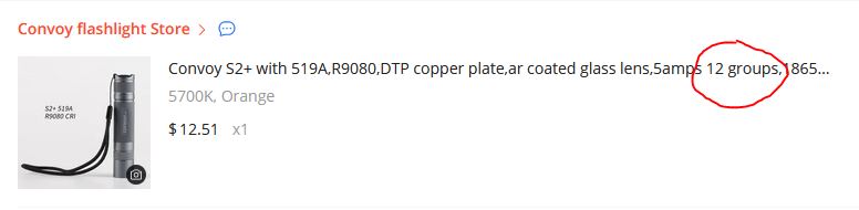

Did you get a driver with multiple groups? You can choose between the 12 groups model and a simplified 4 mode (so 1 group, I guess?) at checkout. Sounds to me like you got the 4 mode one.
Does that mean you have the following modes:
  • 0.1%, 1%, 10%, 35%, 100%, strobe, biking, battery-check
Or just 4 modes?
I have a terrible time doing the “20 half clicks.”
I wrote about it in this review, and posted a video of someone doing it correctly:
(It might help to check out the video in the above review.)
I was supposed to get 12 modes - here is a screenshot of my order:
and right now I can only cycle through: 0.1%, 1%, 10%, 35%, 100%, strobe, biking, battery-check
How would I change groups if I got the 4-group version?
The 4 mode driver doesn’t have these modes, so you have the 12group driver.
Take a look at this video:
