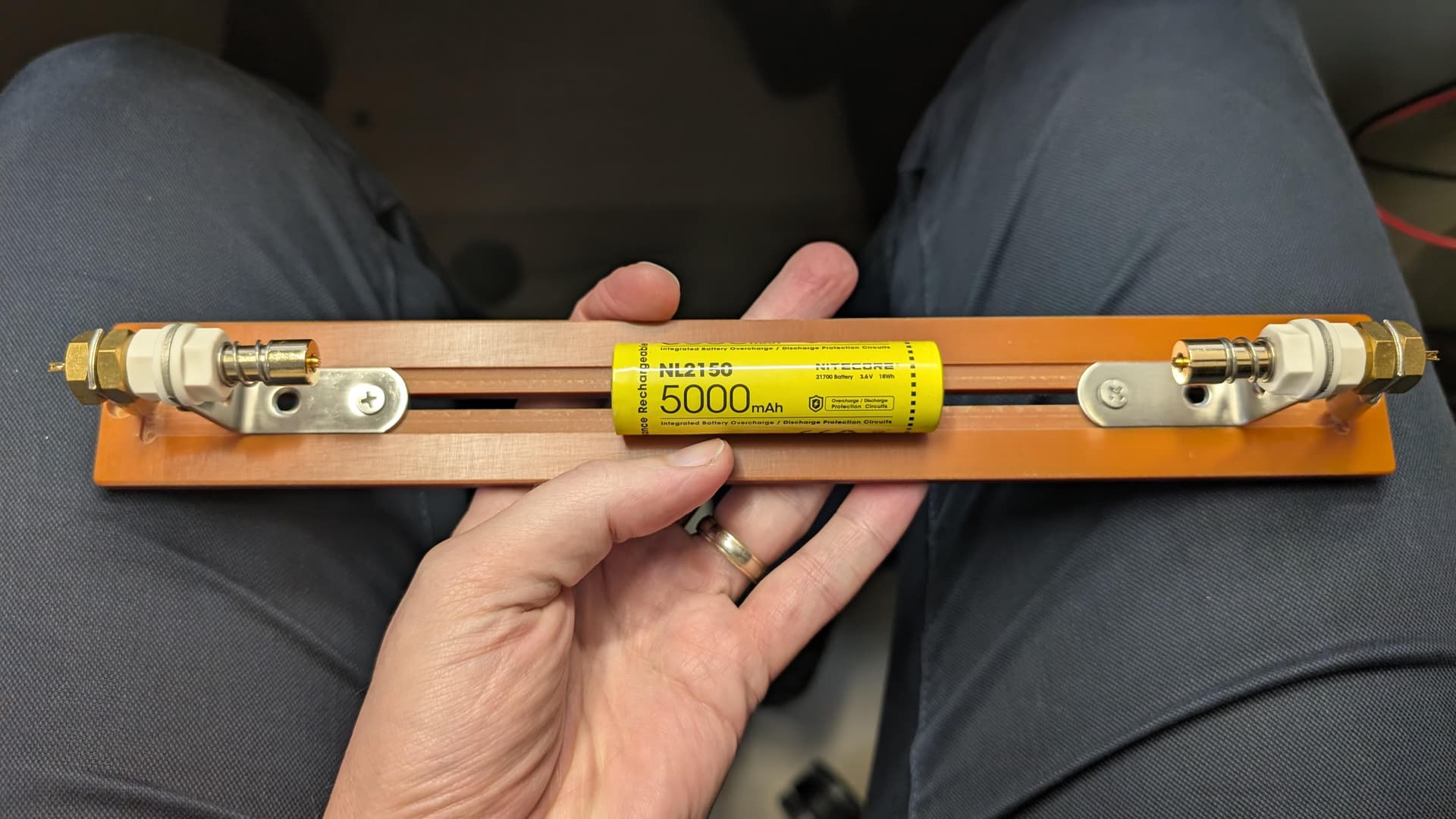

This is the one I ordered: https://www.aliexpress.us/item/3256806907999195.html

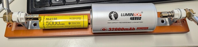

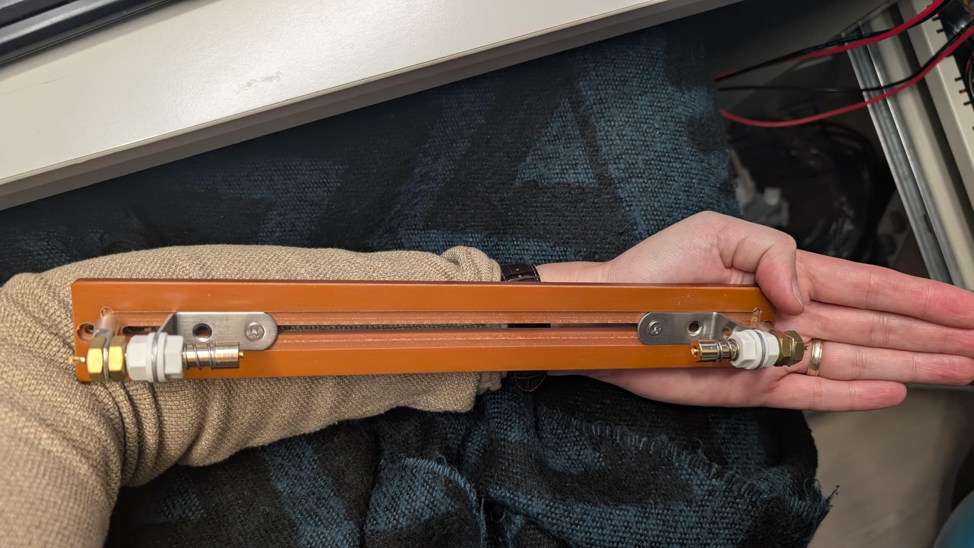

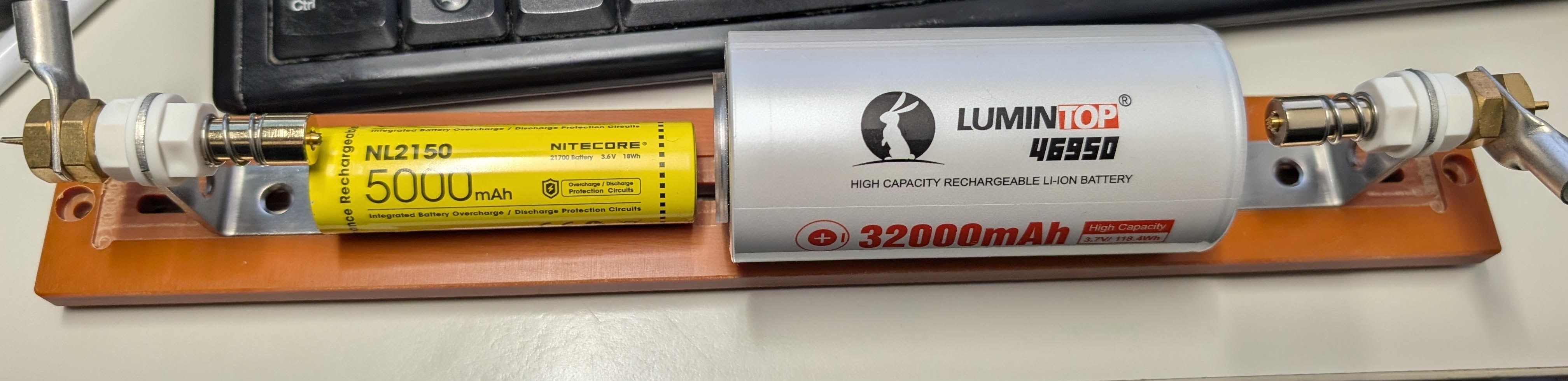

@Wingman I received it today.. it’s a bit bigger than I anticipated :smiley:
Here you can see its size even better
I think I’m future proof now

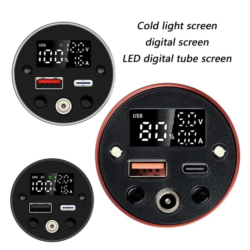

I recently also purchased this 46950 powerbank housing to try out:
It outputs 22,5 watt, charging is limited to 18 watts, so slightly below that of the Lumintop Aurora, but should still be (well) above 3A.
Build quality is pretty decent, with a light (but sturdy enough) aluminium housing/casing and charging/discharging seems to behave quite well, although it does stop discharging at a bit too high voltage in my opinion (3,3-3,4V if I remember correctly), but the Lumintop also does something similar.
What I do like about this powerbank housing, and what the Lumintop Aurora doesn’t do, is that by press (and holding) the left button, it also shows the battery voltage.

and y’know leaving Li-Ion batteries out to charge overnight or whatever is a terrible idea imo. the one you linked does seem interesting. especially showing the battery voltage, all of my regular chargers just have up to four lights to show charge (they’re all older). I would imagine that the charger/powerbank goes off of batt voltage to decide when to stop charging - around 4.2V?

Both 46950 powerbank housings (Lumintop Aurora and the generic one) show the battery status in percentage, but that is a bit relative, since they both show 0% (and turn off) at a bit too high voltage in my opinion, leaving a (little) bit of useful battery capacity unused.
The 2 Lumintop aurora powerbanks both stop charging at almost exactly 4,20V (measured with several digital multimeters afterwards), which is surprisingly accurate. The ‘generic’ powerbank terminates charging a bit early (4,15V if I remember correctly), but I prefer a tiny bit of undercharging than overcharging and at that last 0,05V of an almost full Li-ion battery is only a tiny bit of capacity.
That generic powerbank shows the battery voltage in 2 digits, so 4,1V for example and is ‘accurate enough’ for a quick indication. I expect that it uses a different chip for displaying that voltage number and that the voltage reading to determine charging termination is done by the charging/powerbank IC.
