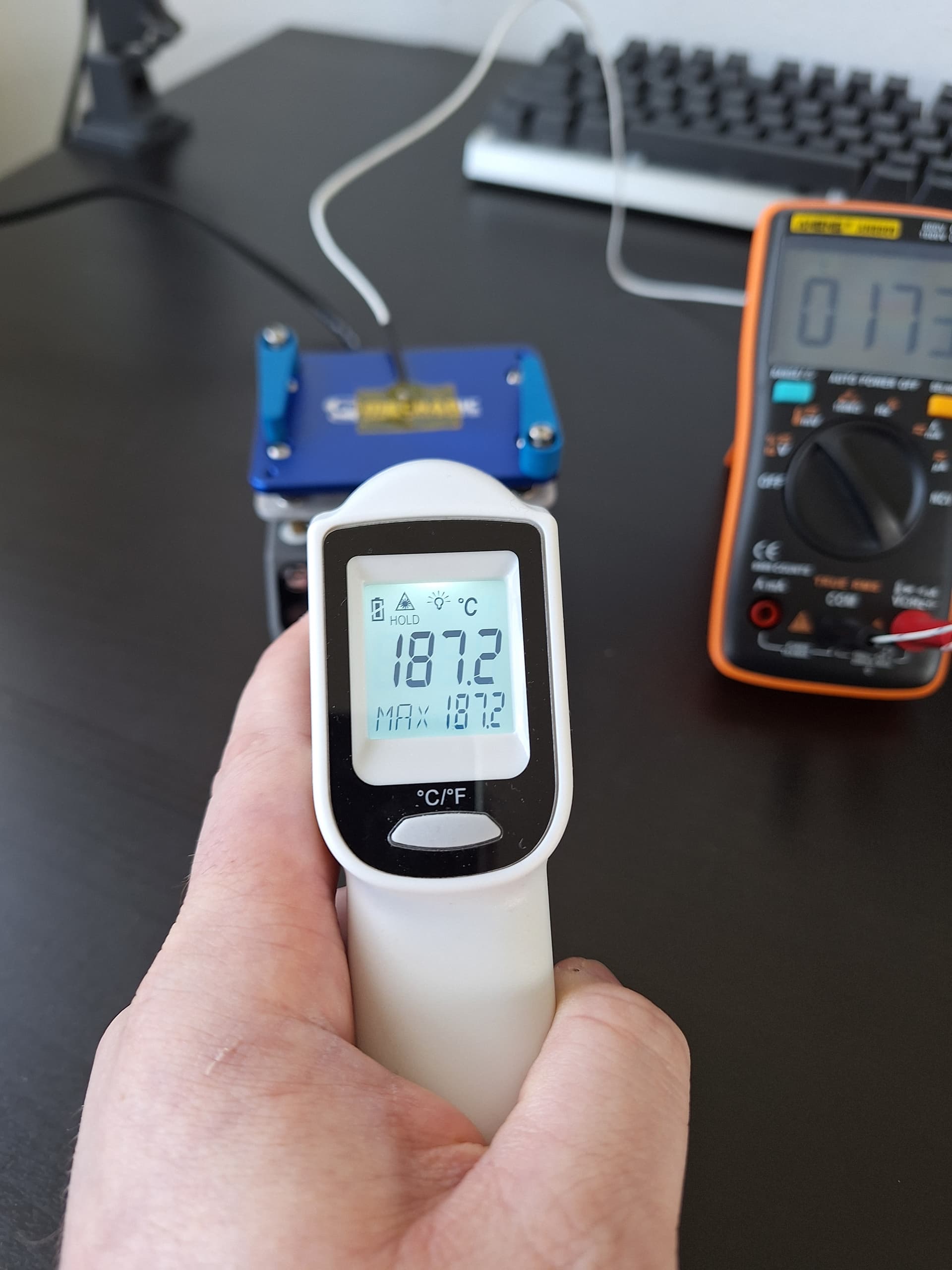

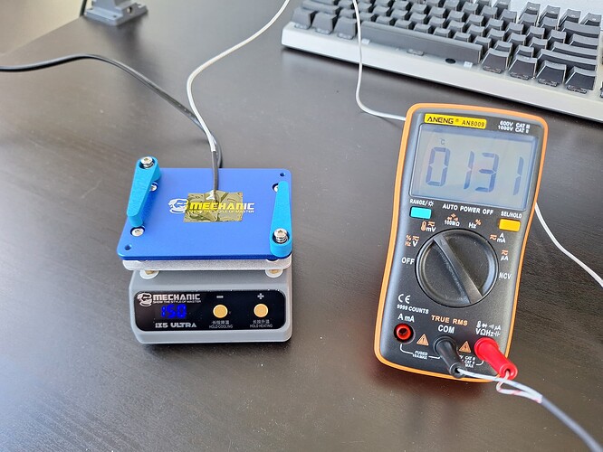

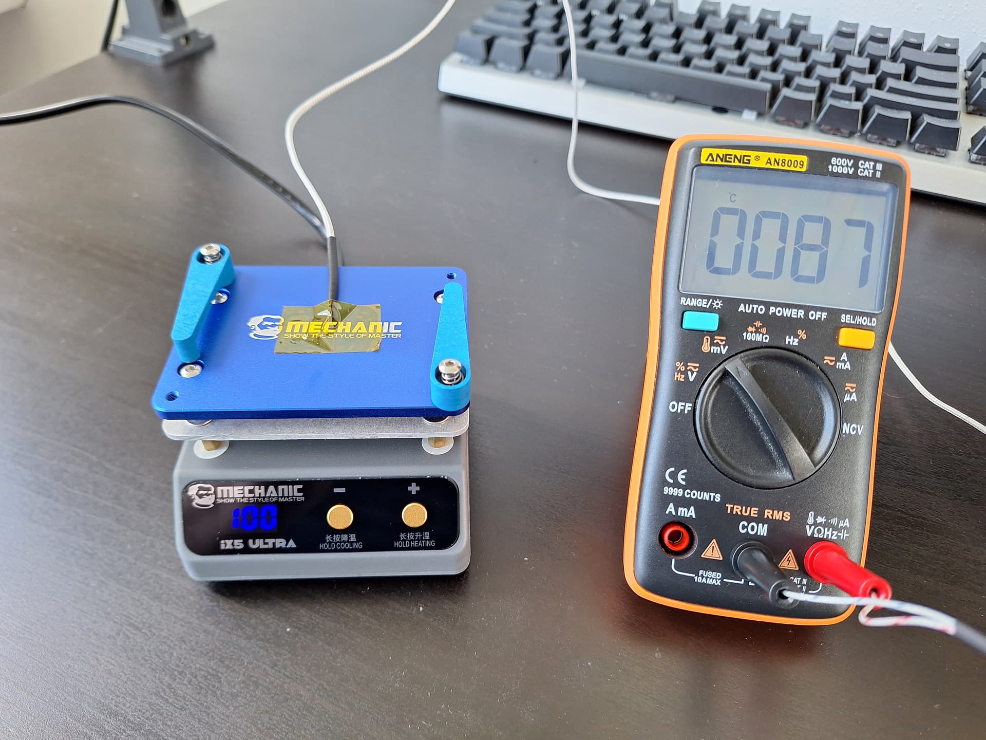

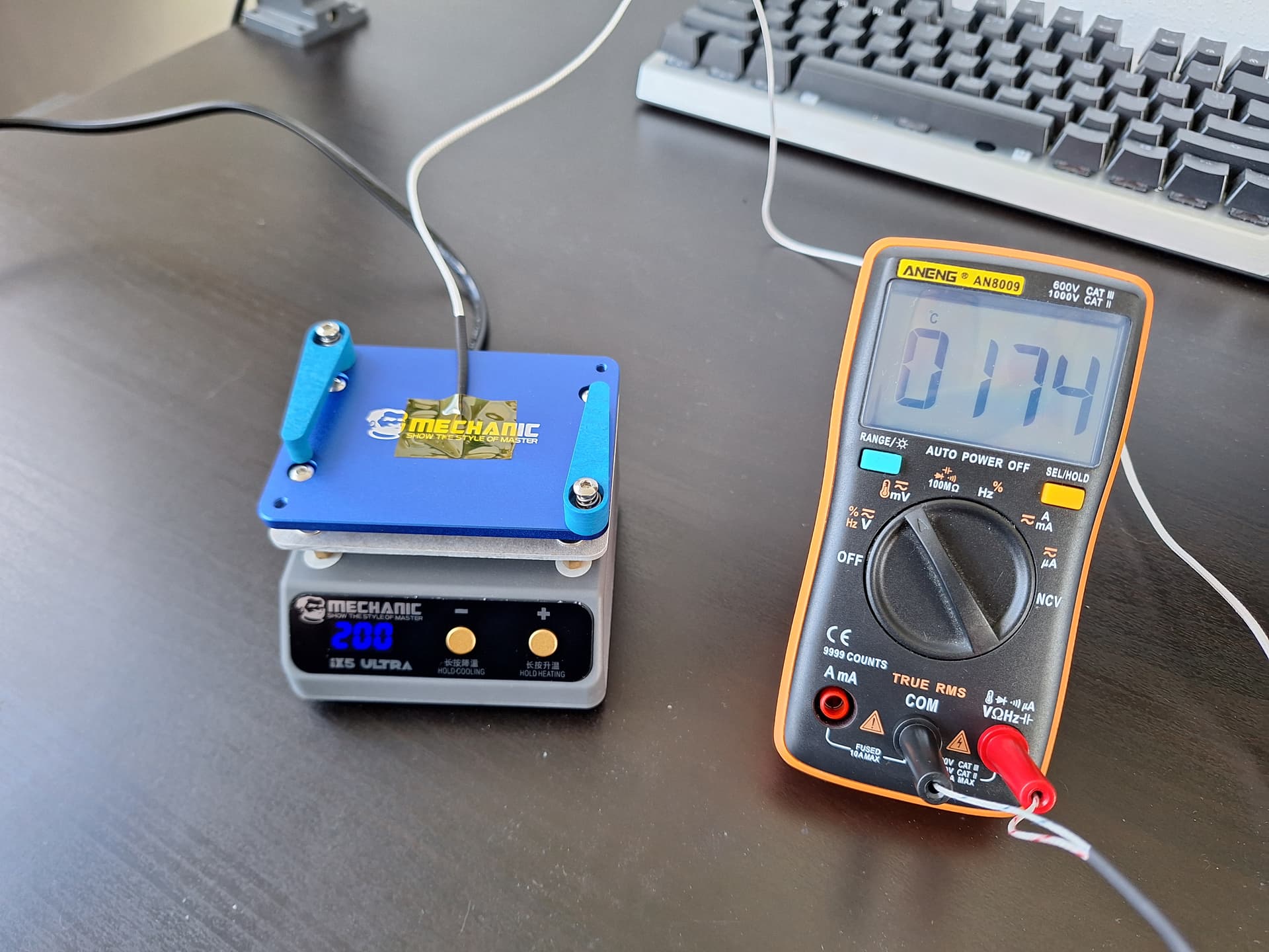

Here are some of the tested temperature settings:
At 100°C:
At 150°C:
At 200°C:

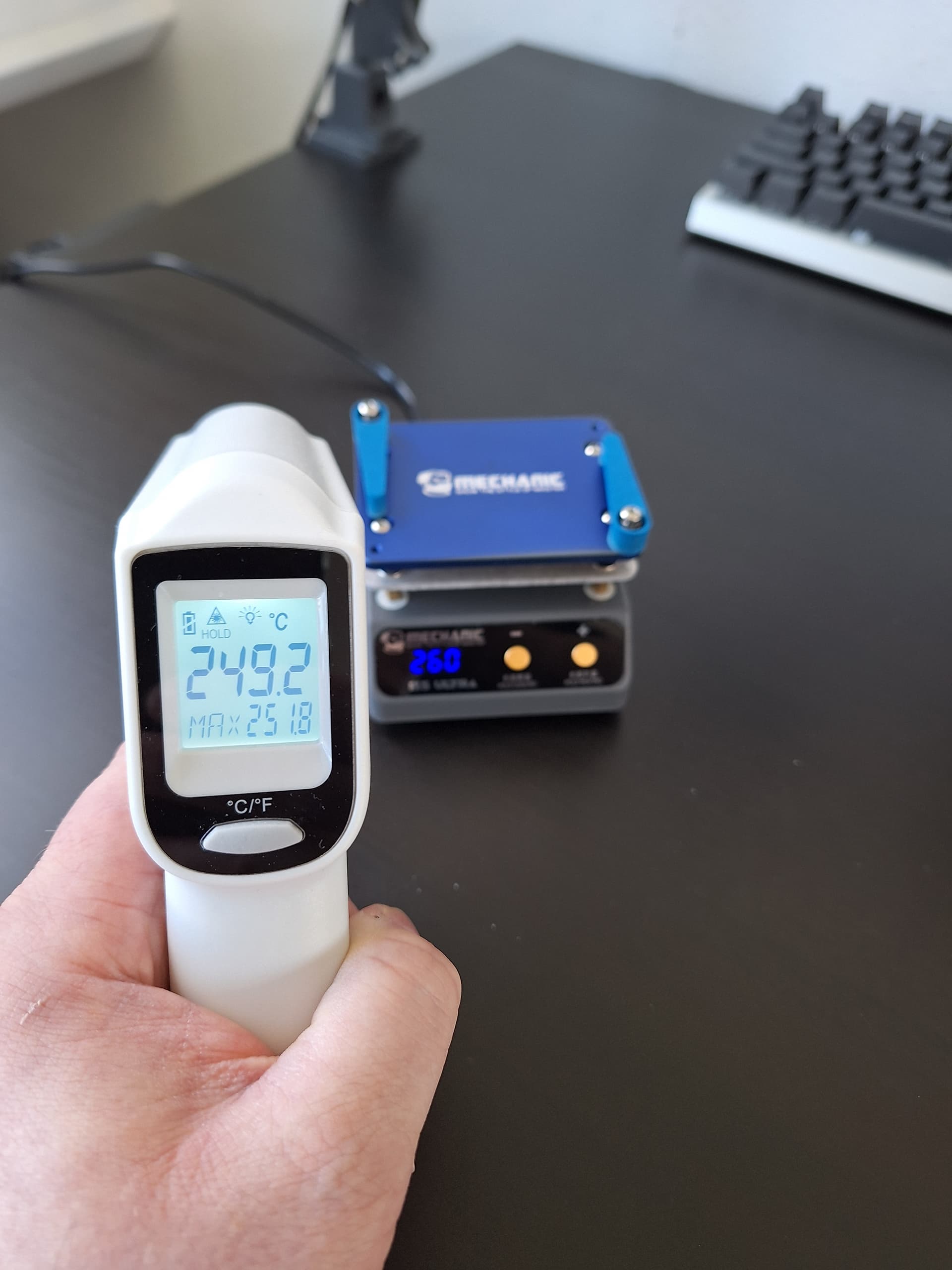

Above 210°C my thermocouple sleeve started to smoke, so the measurement of it’s max temperature (of 260°C) I only took with my IR thermometer:
It seems to reach well above 200°C (at least in the center/hot spot), so it should be quite capable of reflowing LED’s with most solder pastes quite easily.
