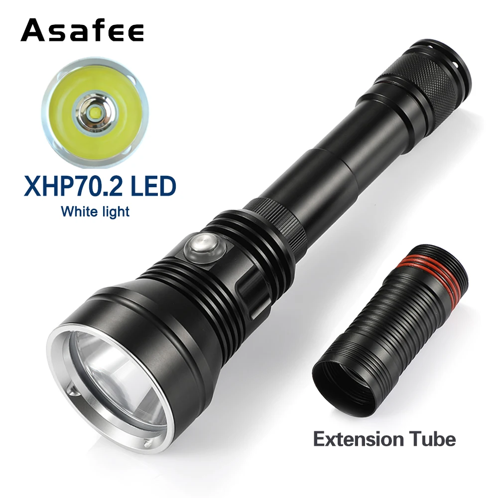

I just found this cheap XHP 70.2 light from the brand Asafee:
Do you guys know, please what driver is used in this light?

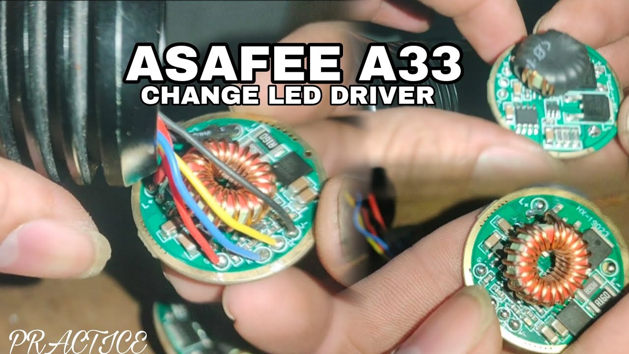

In this video a guy took the driver off:
Maybe a buck?
