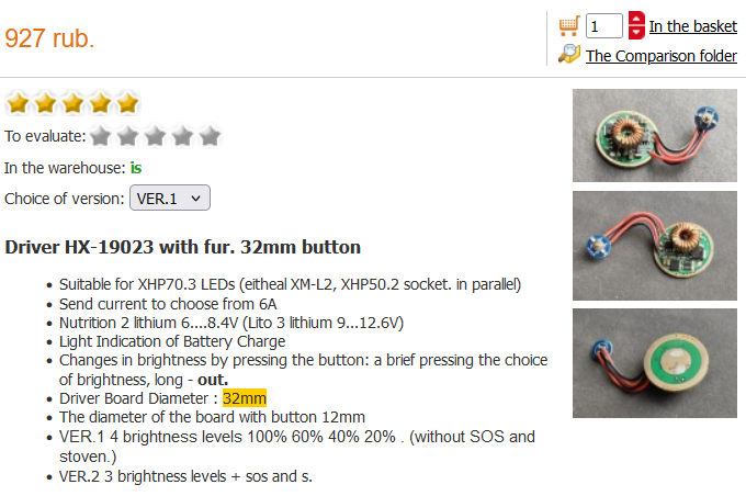

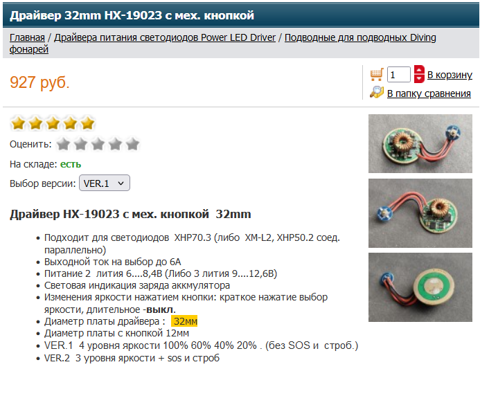

Just acording to what the driver says - “HX-19023” - I found this russian site: Драйвер 32мм HX-19023 с мех. кнопкой 32mm 6A - 927 руб.
translated:
grafik
Thank you very much!

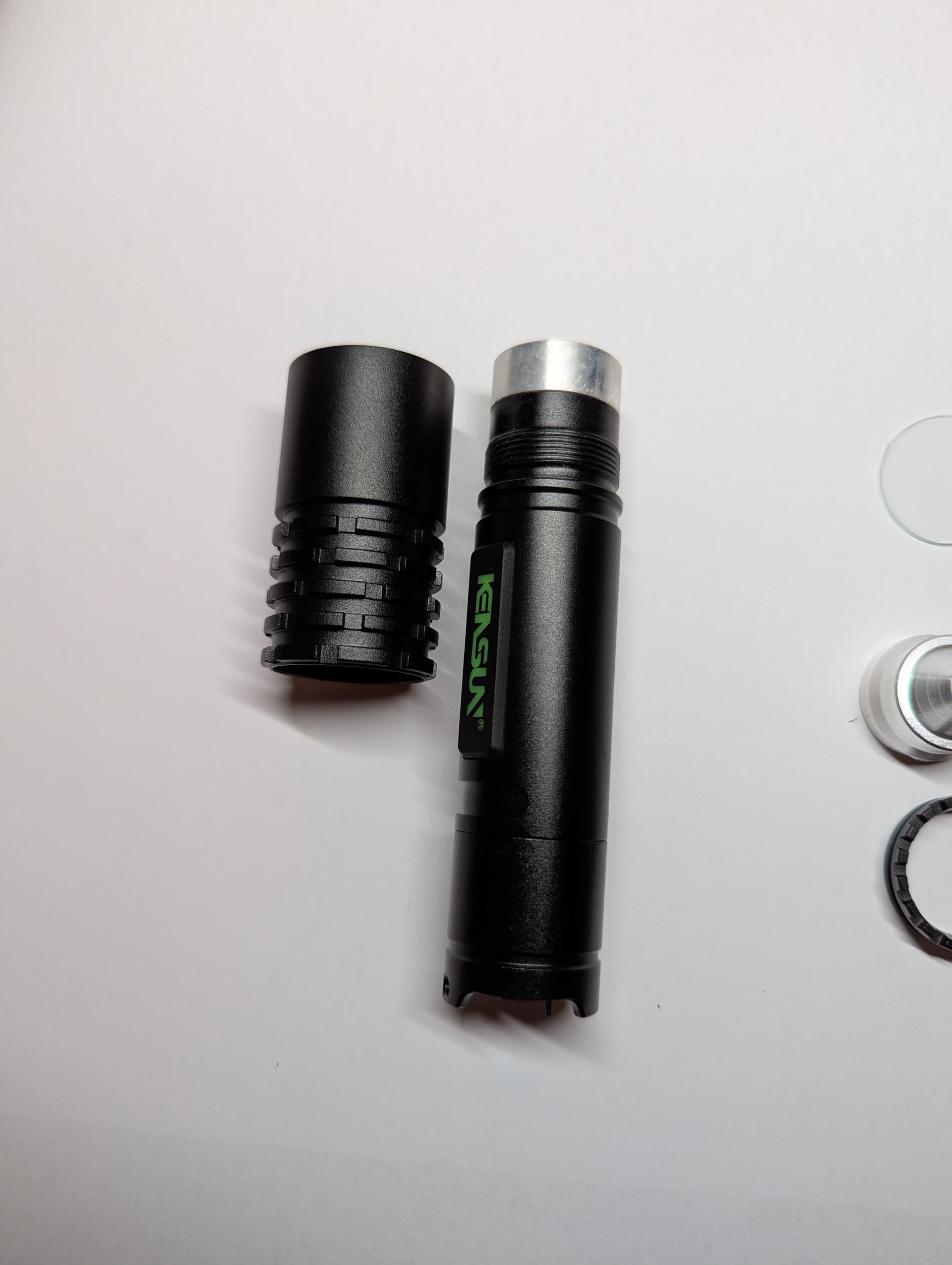

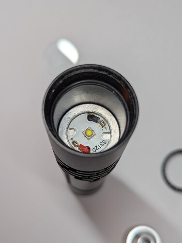

Kensun SST-20 → Wasserdichte starke Licht laterne Hochleistungs-LED-Taschenlampe mit fluor zieren dem Logo Typ C USB wiederauf ladbare ultra helle Taschenlampe - AliExpress 39
I really like the heatsink here, it just looks nice.
vs Convoy S3

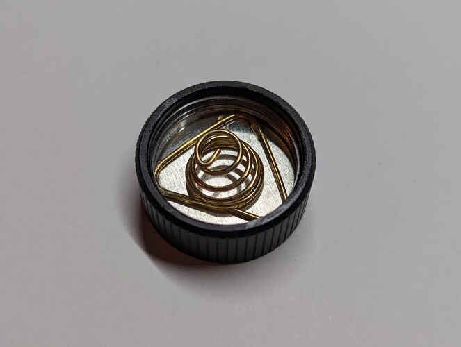

The retaining ring was loose

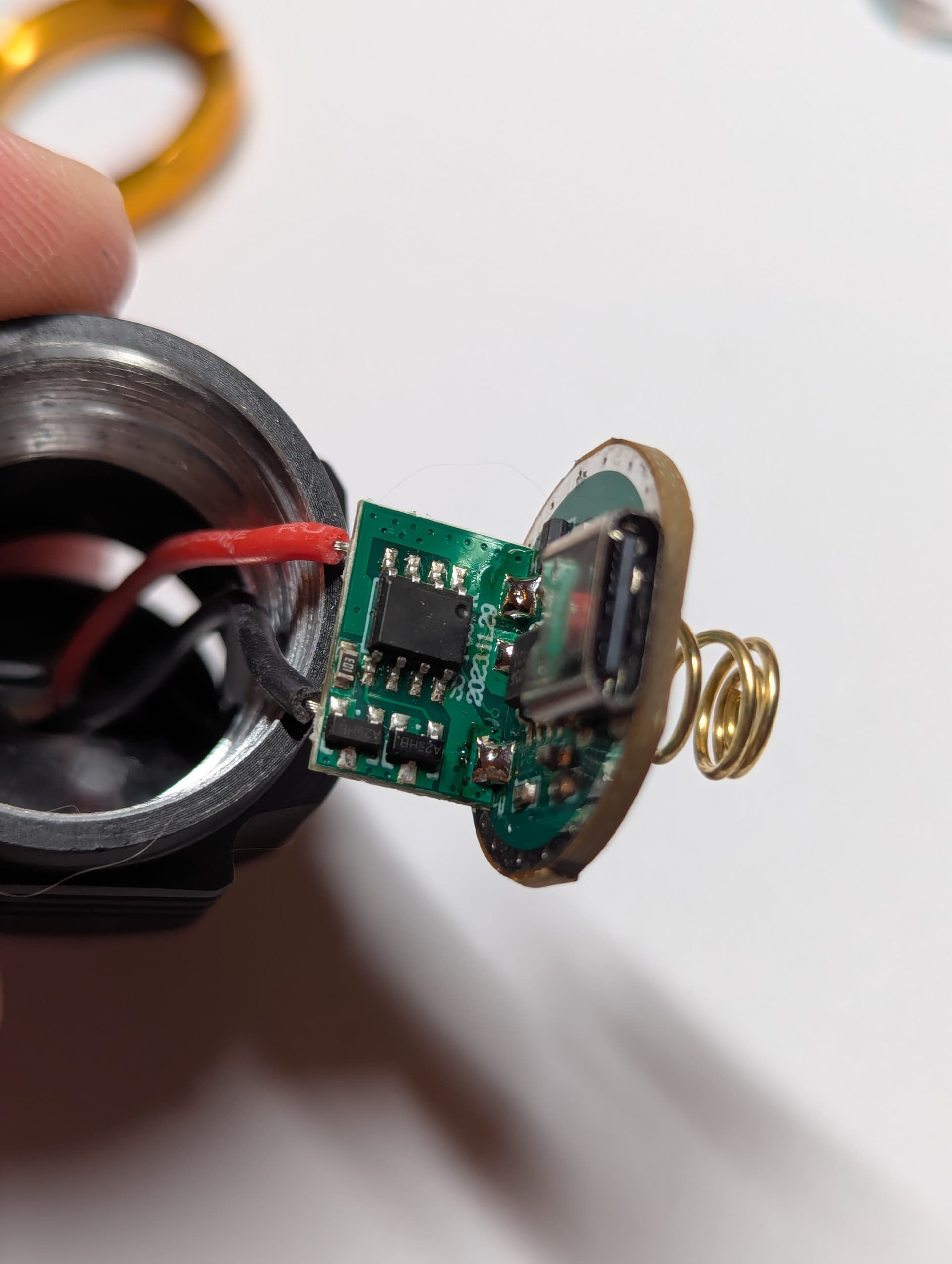

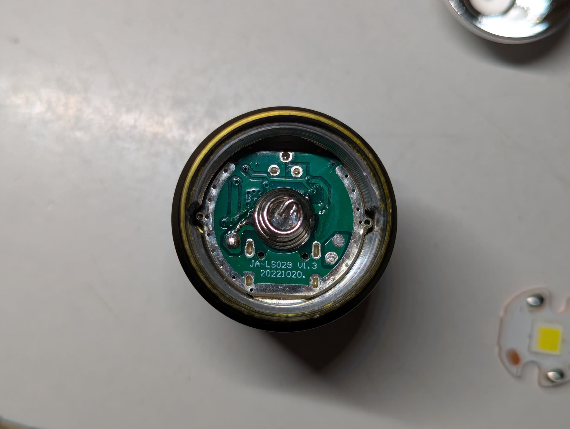

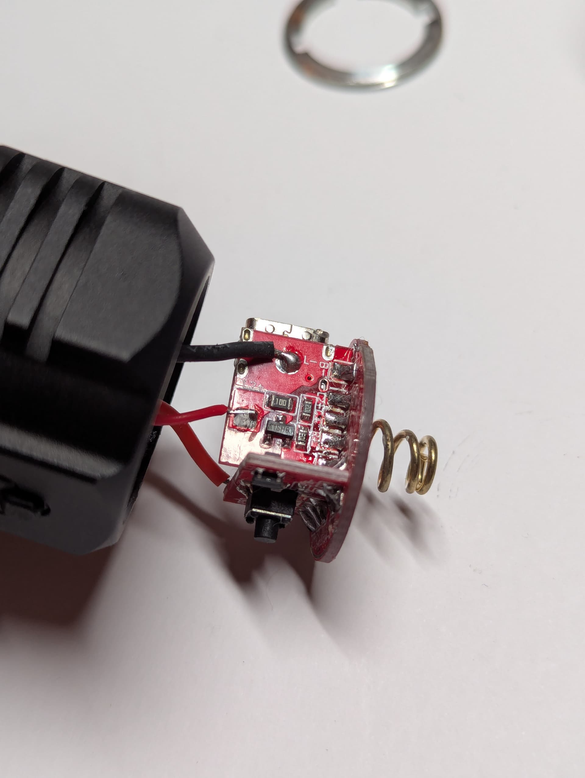

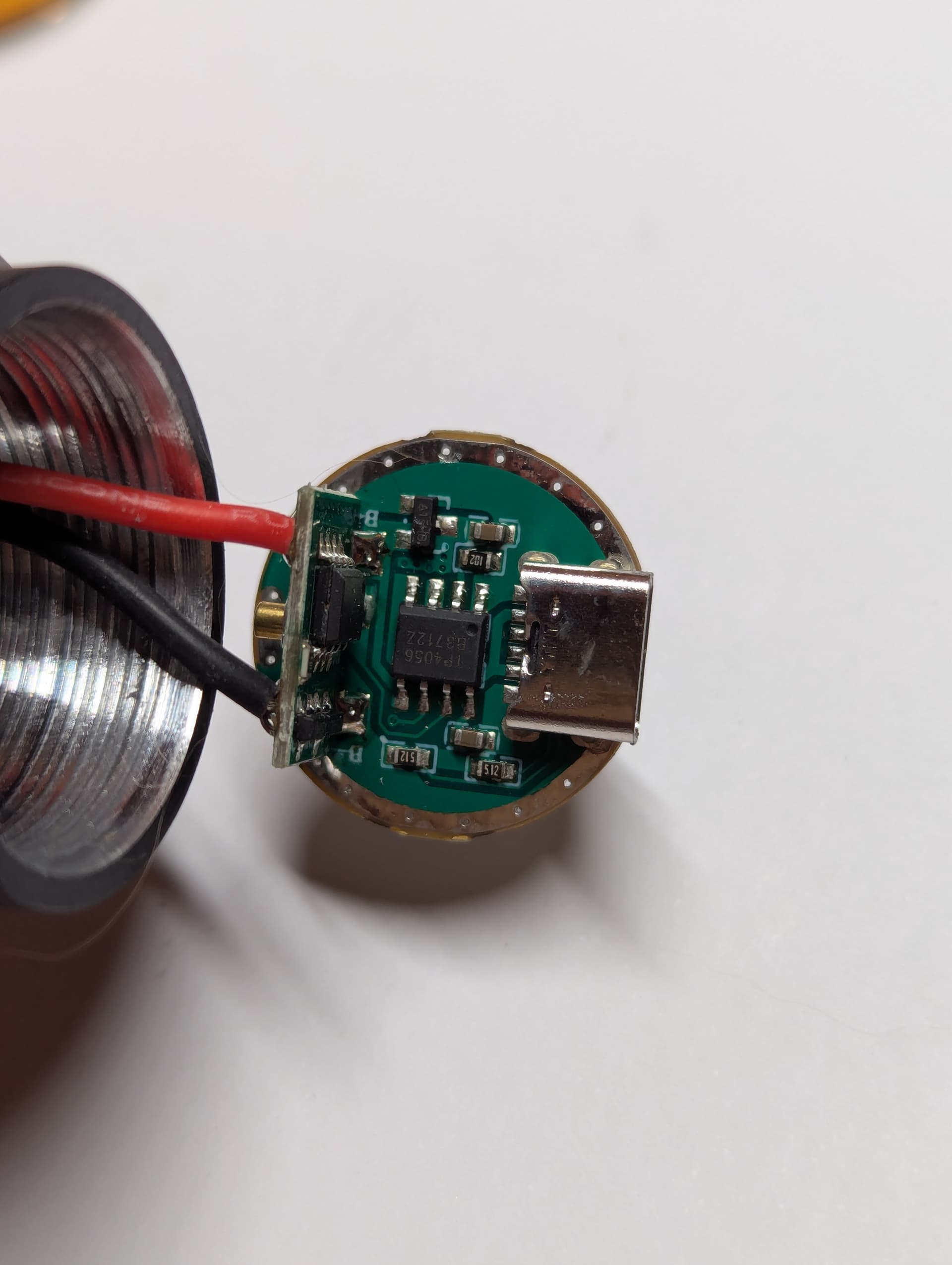

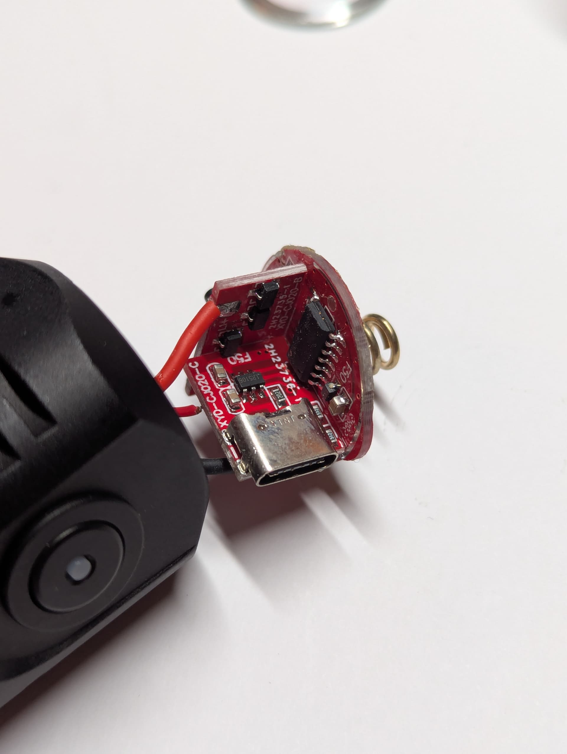

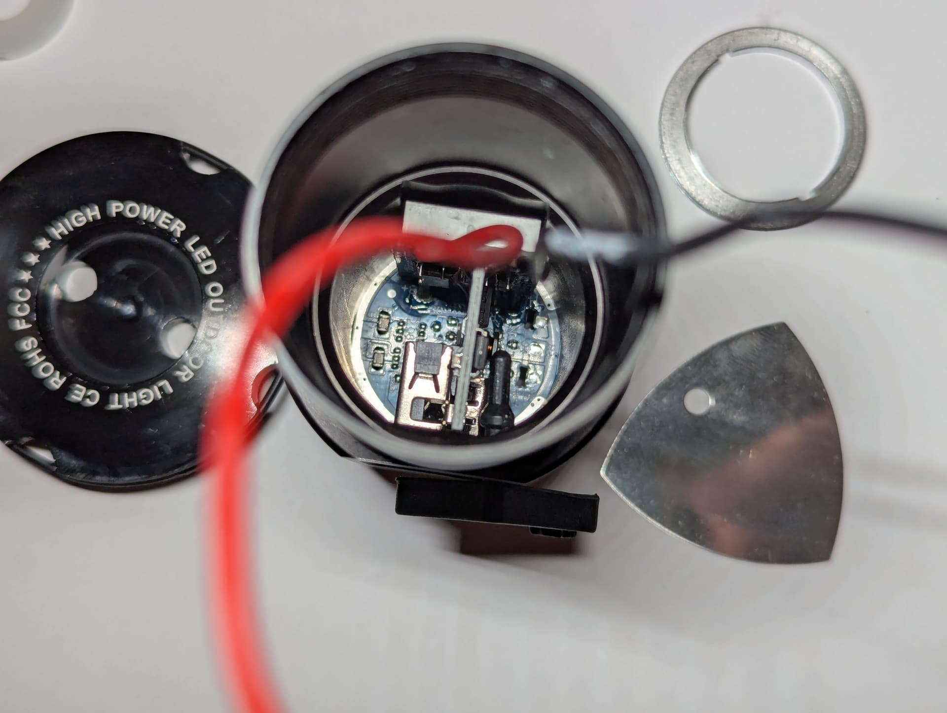

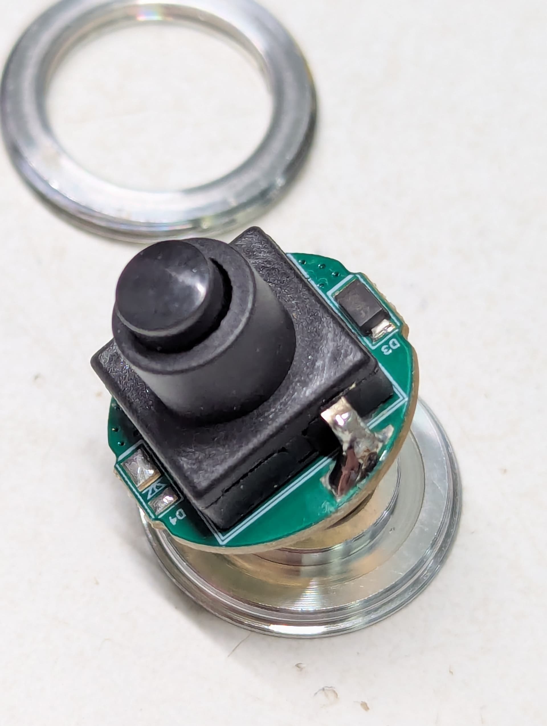

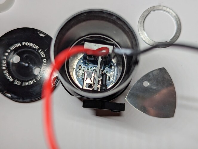

Driver / charging circuit

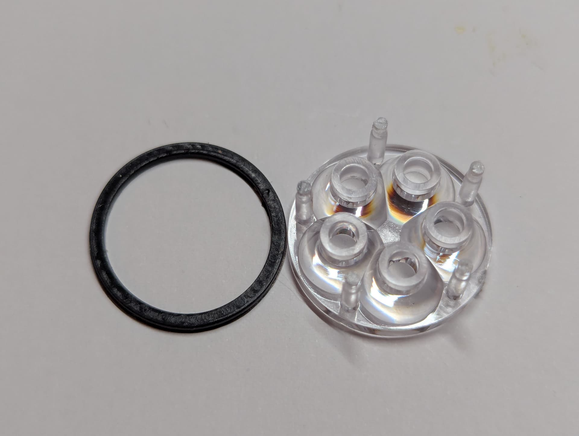

SST-20 LED? With way too big gasket

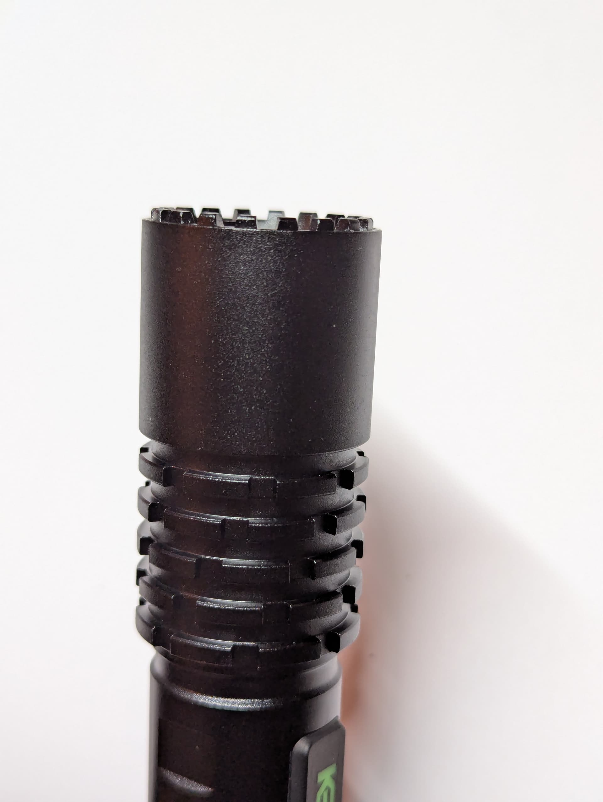

The crown sticks above the case

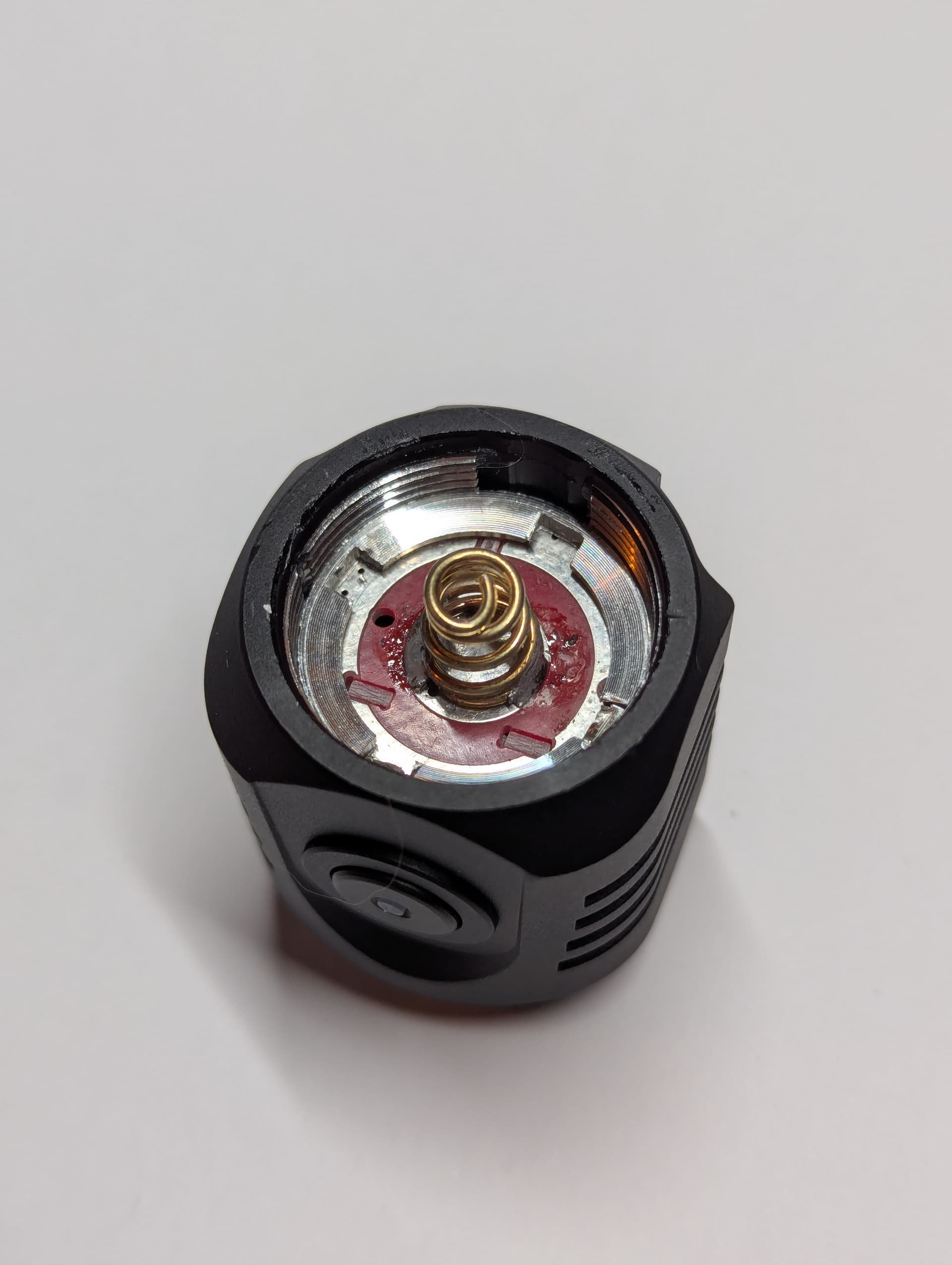

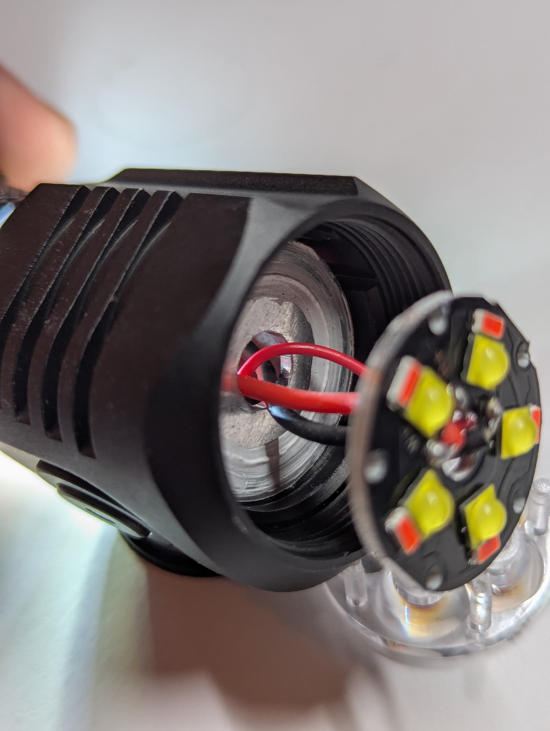

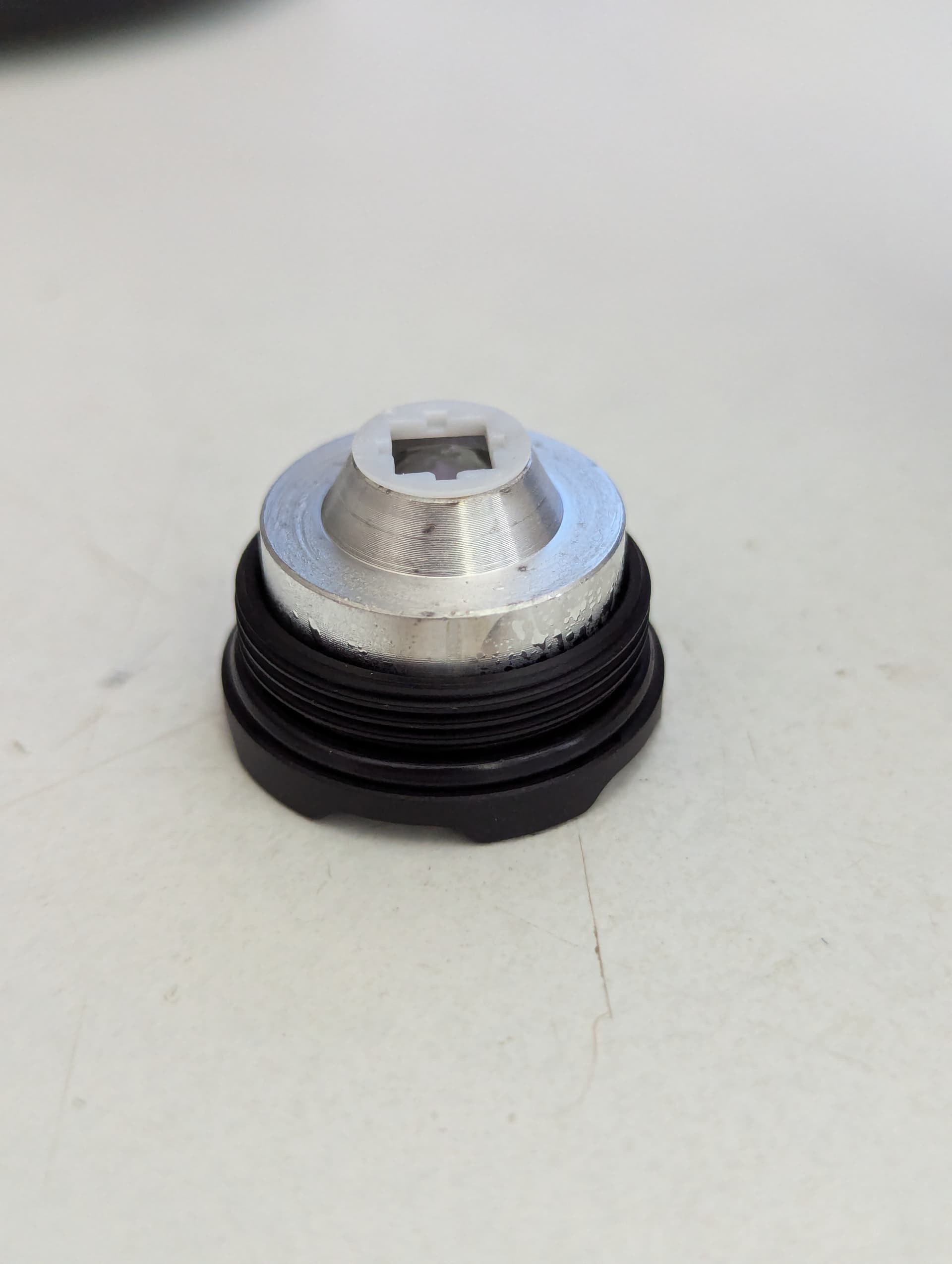

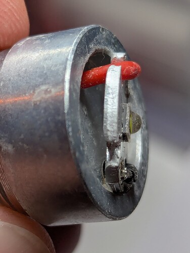

The construction is a bit weird, it seems to be from a zoomy-light, because the pill isn’t screwed into the head, but into the body and then the head gets placed over it.
The heat has quite a way to travel to get to the heatsink
Pill itself

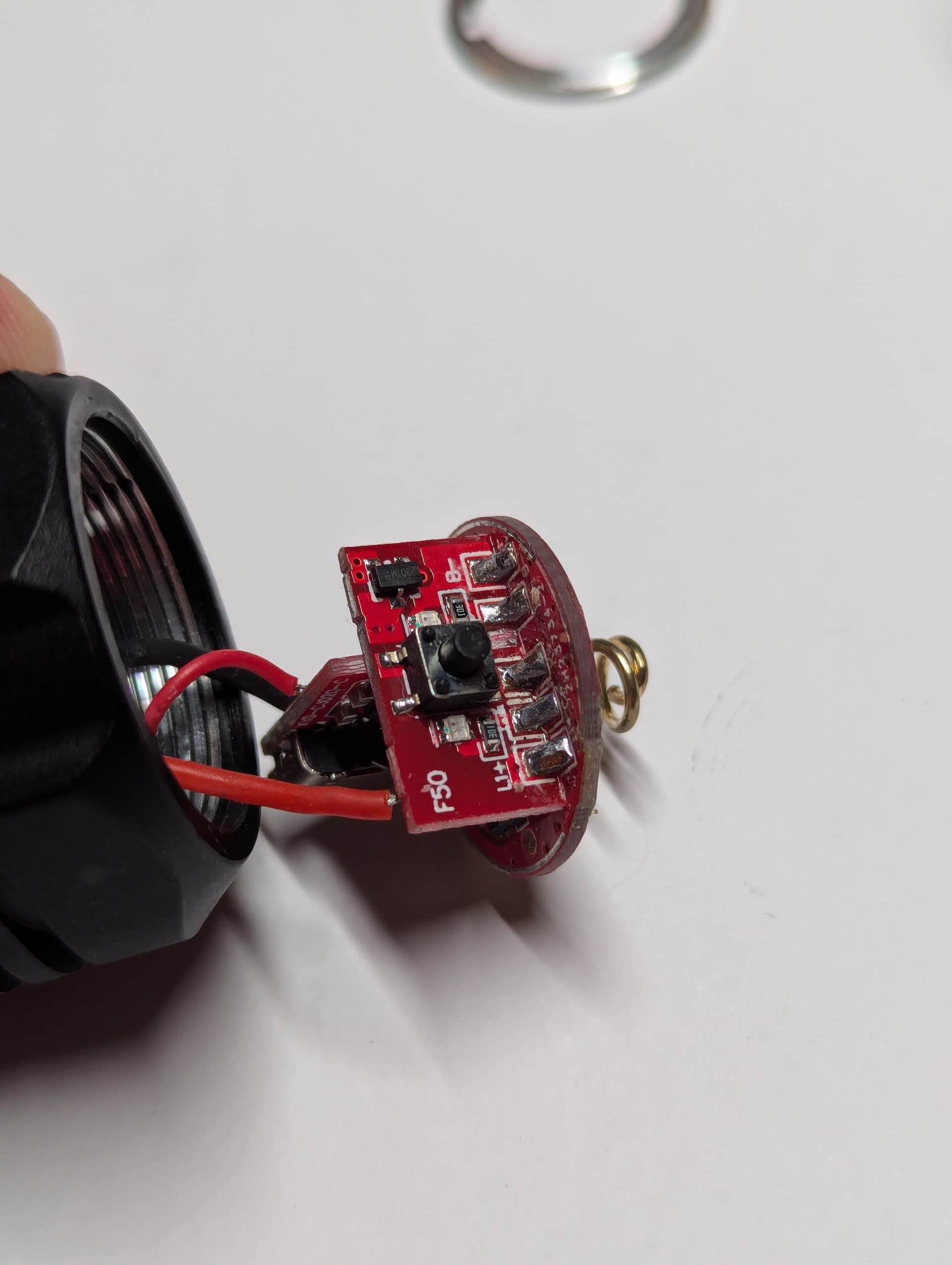

And this is where it dawned on me that in the back there is more than just a digital switch and charging circuit like I hoped, but also the whole driver. That makes a driver swap hard to impossible.
At least the original driver has no blinky modes in the normal switching.
Material: Yes, Heasink compund: No.

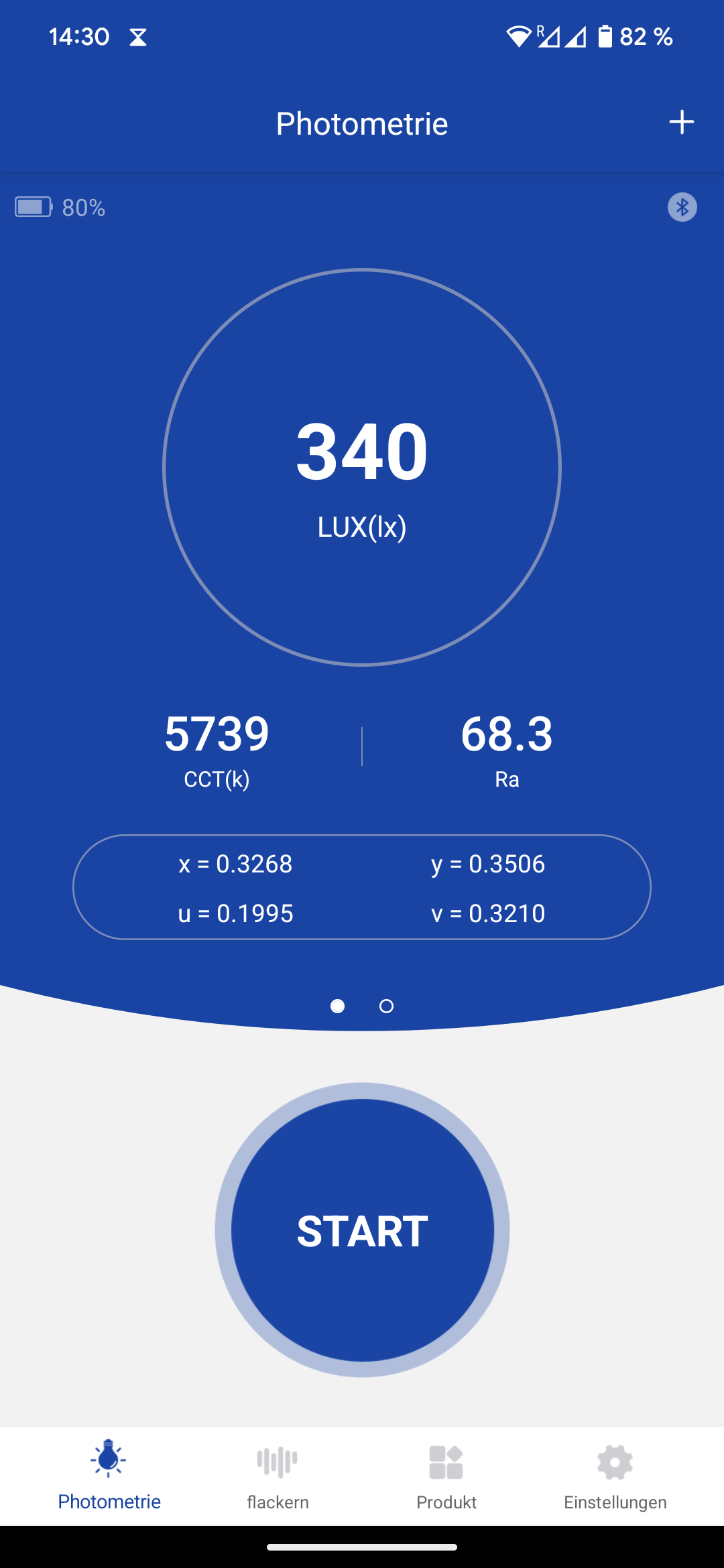

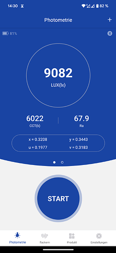

Beamshot:
Lens: 24.2x1.2
Reflector: 22 (W) x 20.8 (H) x 7mm (opening)

I am thinking about a swap to a triple or quad-board with lens, but first I need to have a new driver in this thing.

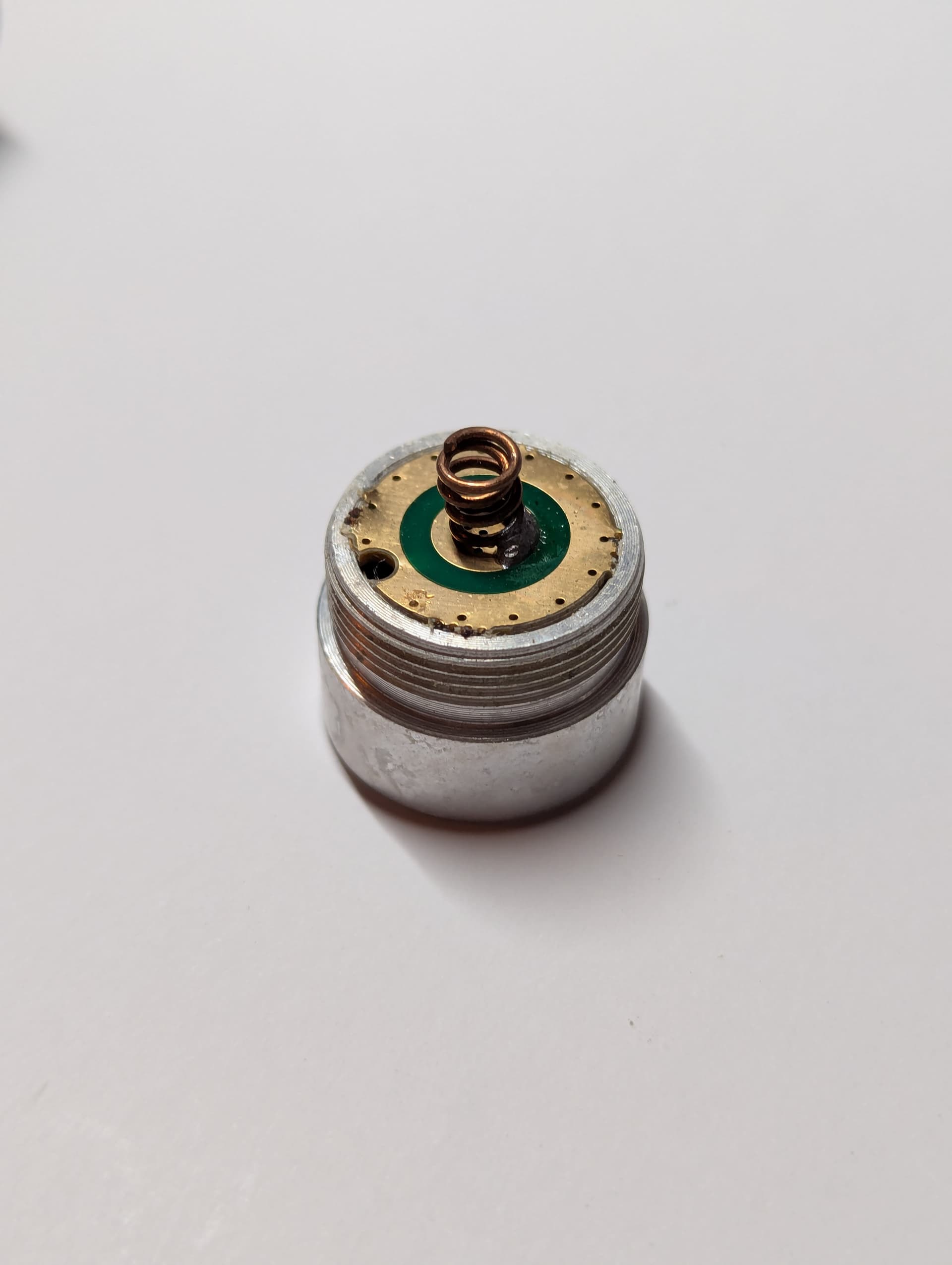

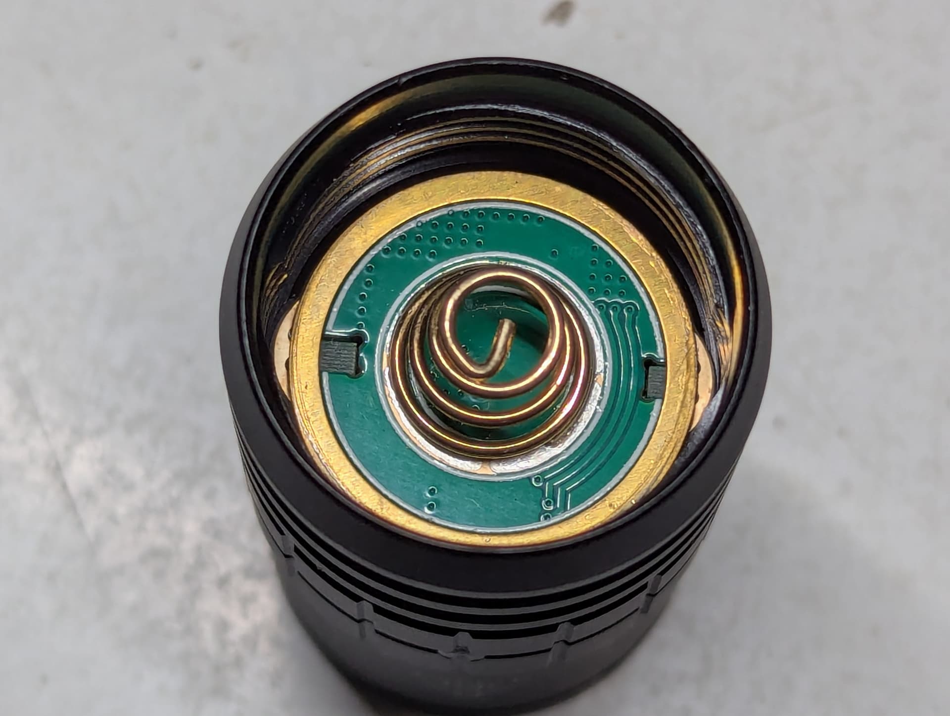

The LED Board sits on a pressed in disc. not super thick, but hey, it’s something!
even thermal paste was used.

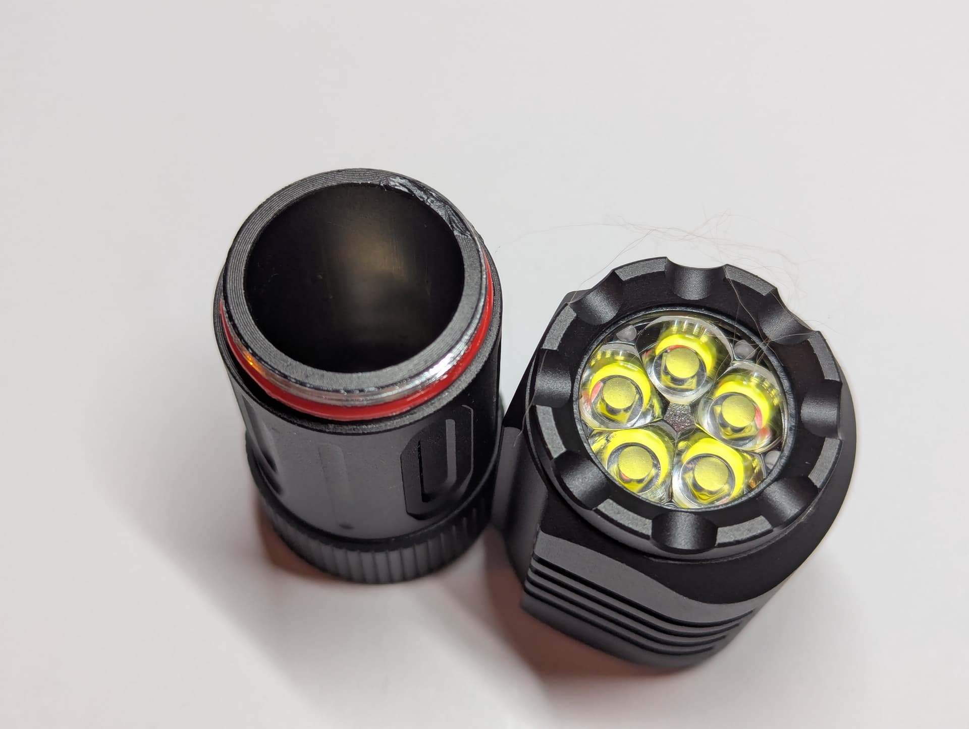

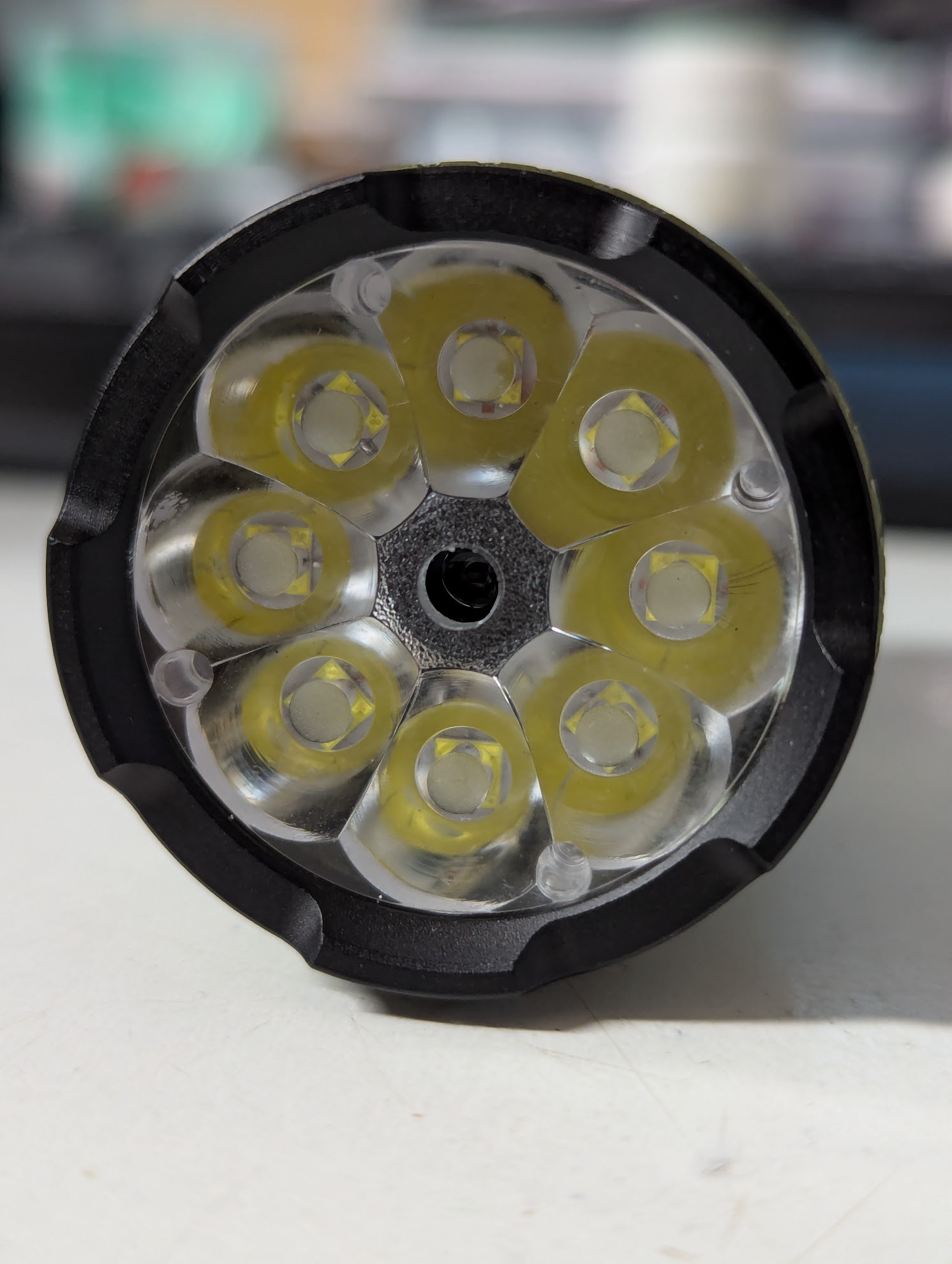

I like it, it is short but thick and the 5 LED-optic looks nice, haven’t seen 5 LED-optics until now.

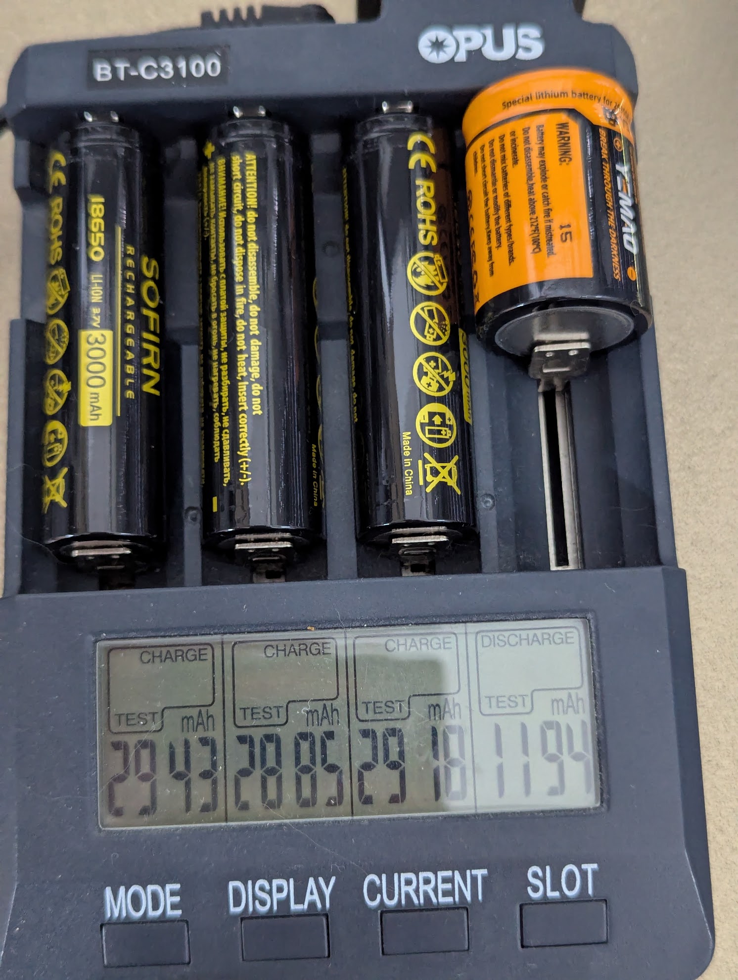

The cell, 18350, claims 1500 mAh, has 1057mAh after first charge.

Cell, 18490, claims 1200mAh but has 1240mAh.

Just discovered that the lenses that Convoy sells fit perfectly!

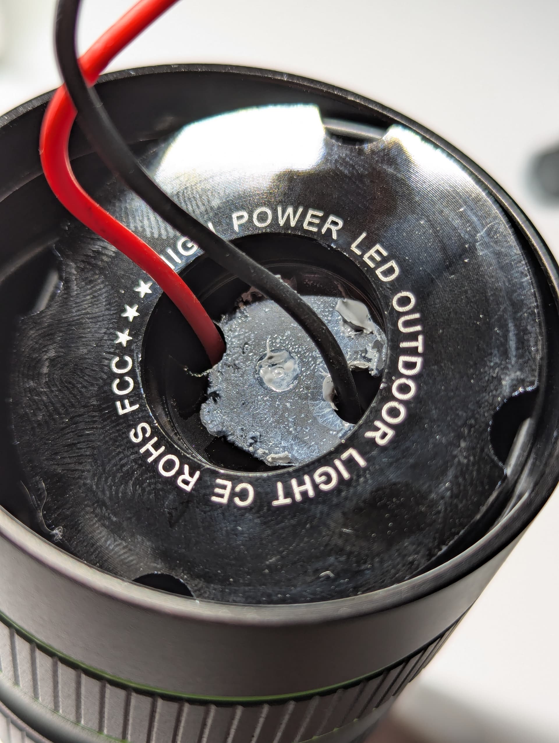

This time: 26650 Kensun Zoom-Lamp
Saw this light basically everytime I went on AliExpress, so when the price dropped to around $18 I bought one.
Put a battery in it and wanted to see with how much current the lamp charges - it was around 1.5A at 75%
Weirdly, the charger was still charging happily after the display showed me 100%… The battery was at 4.1V at this time.

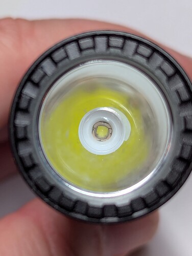

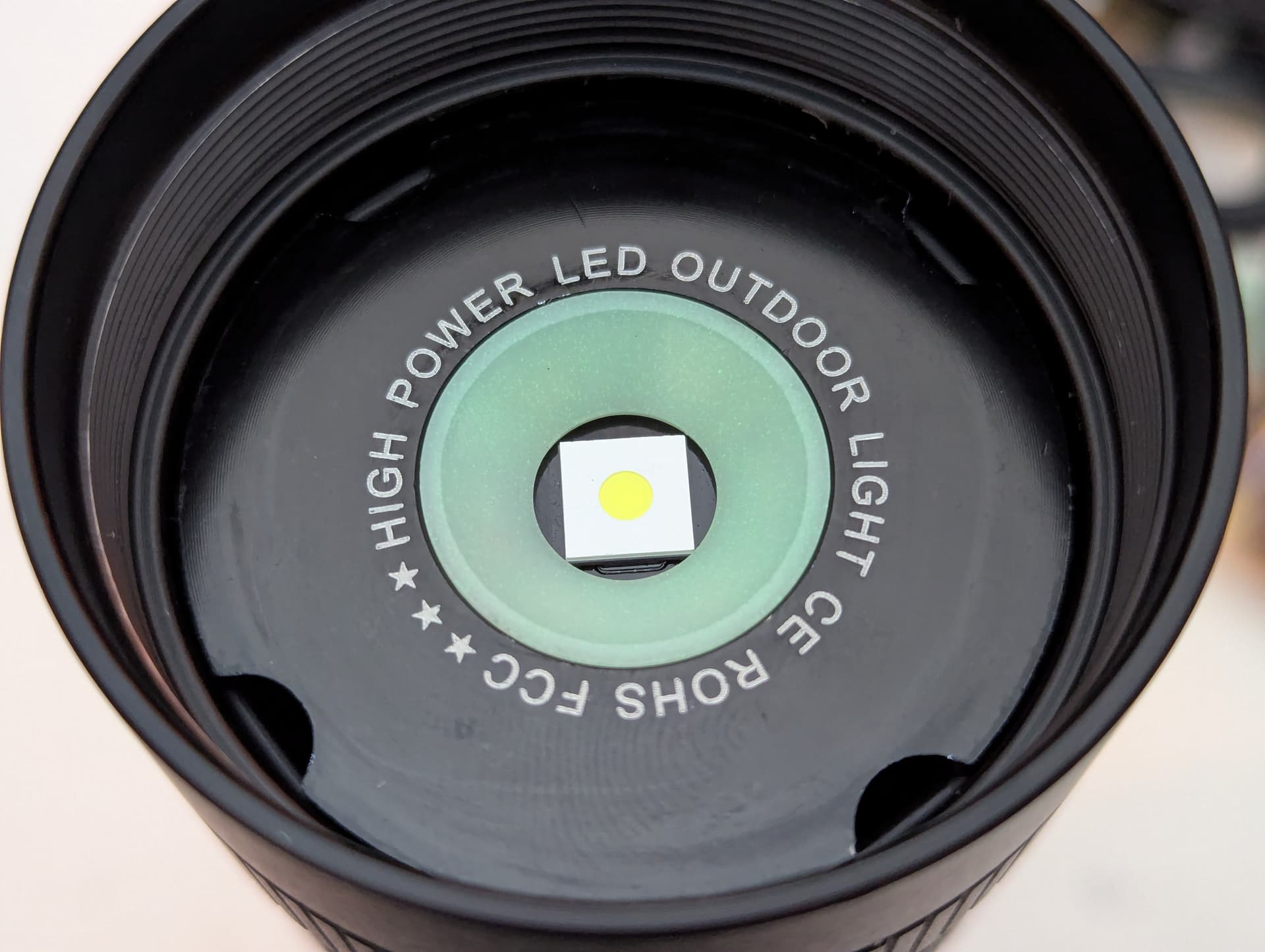

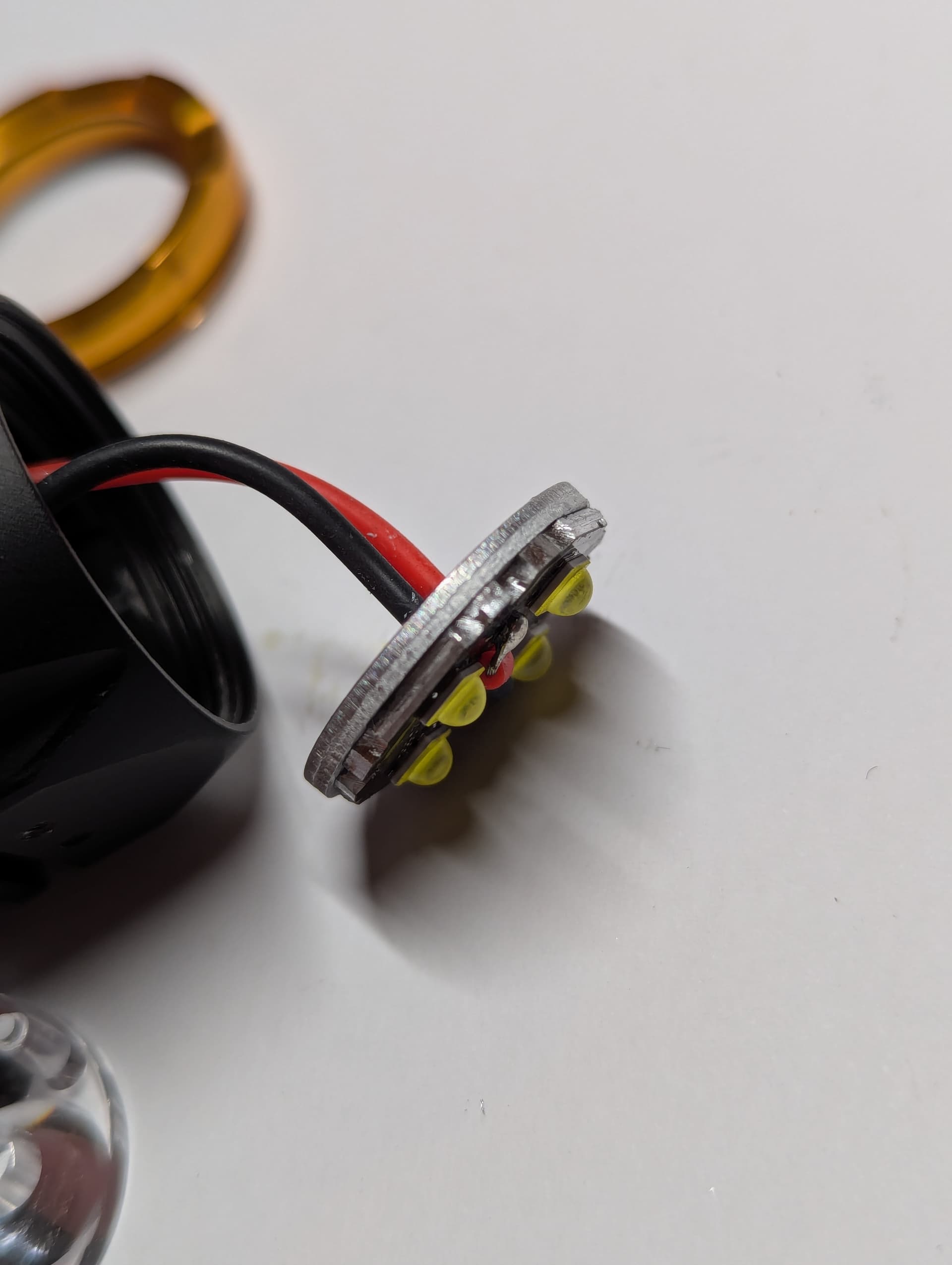

This is NOT a 5050 or 3535 LED, this is a 7070 ON 20mm COPPER DTP Board! I couldn’t believe it!
Diameter of the LES is ~2.8mm

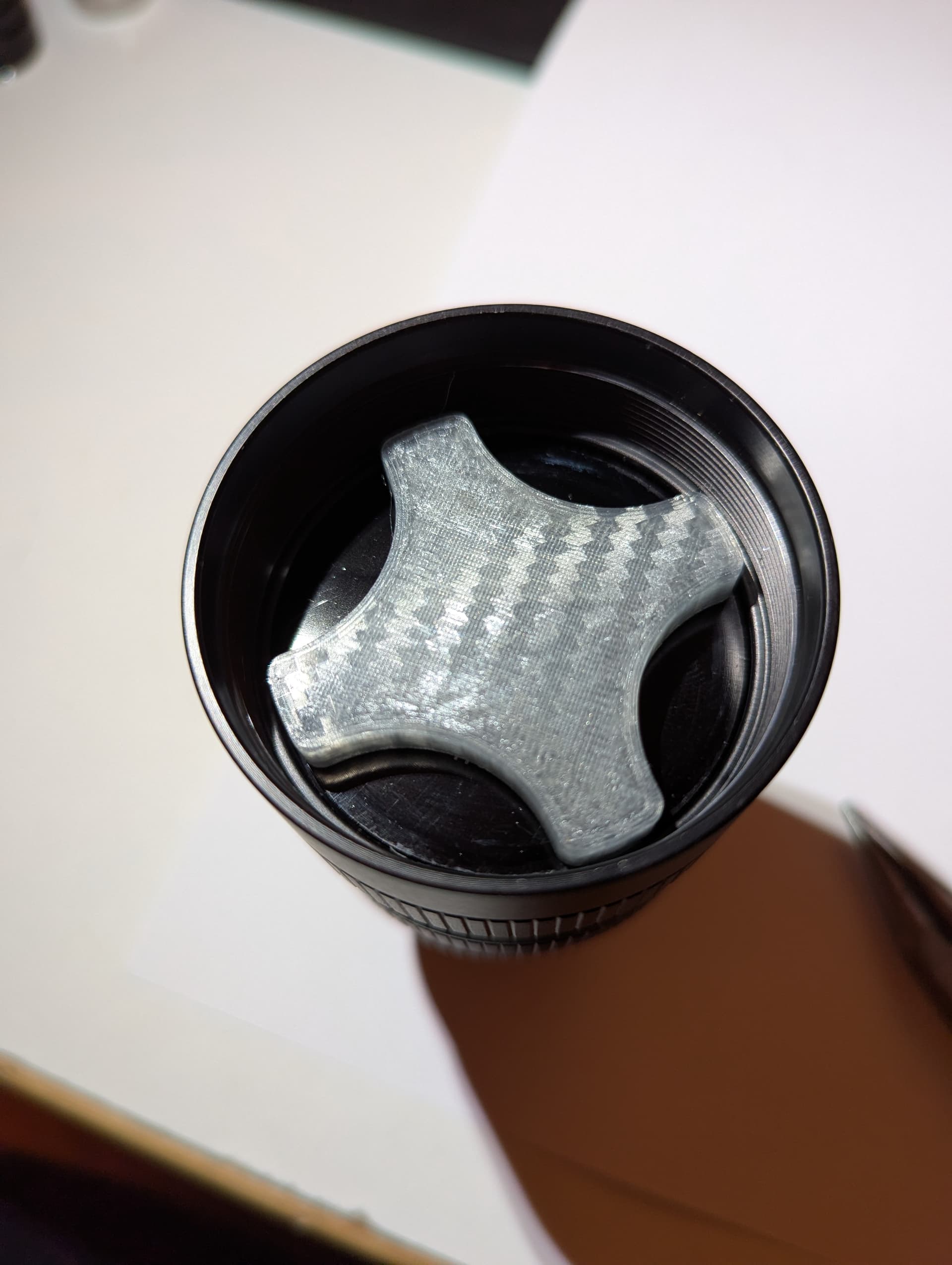

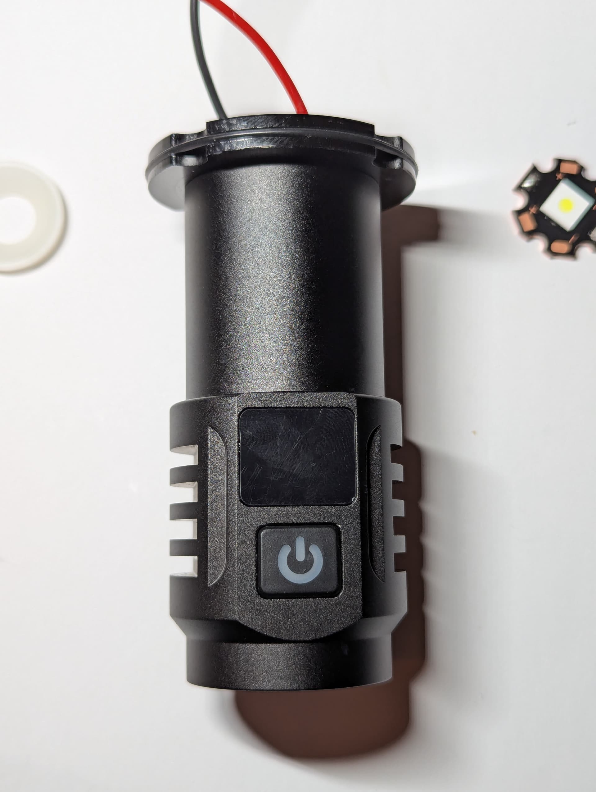

Printed something from Polycarbonat to unscrew the pill. Still had to use pliers, so no chance of disassembling this light with standard tools.
Thermal paste was in use.
Pill has around 5mm of aluminium under the LED.
I cannot show you the driver other than like that. The voltage display catches the rubber of the switch and it blocks it.
The driver has Hi, mid, lo and two blinky modes.
Quite a long way for the heat to travel until it’s at the heatsink…
I would say, one of the better lights for people that don’t want to bother about their flashlight and just want a bright zoom lamp.
The lens is made from plastic.
I will swap the LED for the “L75” from Kaidomain. THe LEM is a little bit smaller.
Maybe I order that 1mm² Osram on 20mm star…

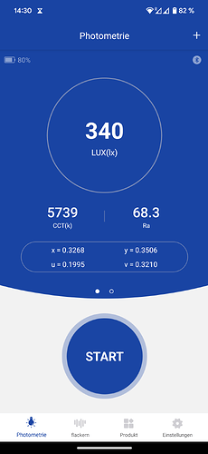

Looks bluer than it is, because the room light is 2700K.

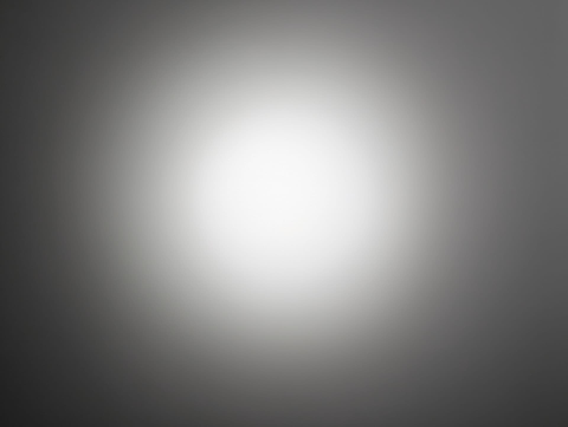

Now the beam looks so much nicer than before and this light is actually very usable even with the original LED.

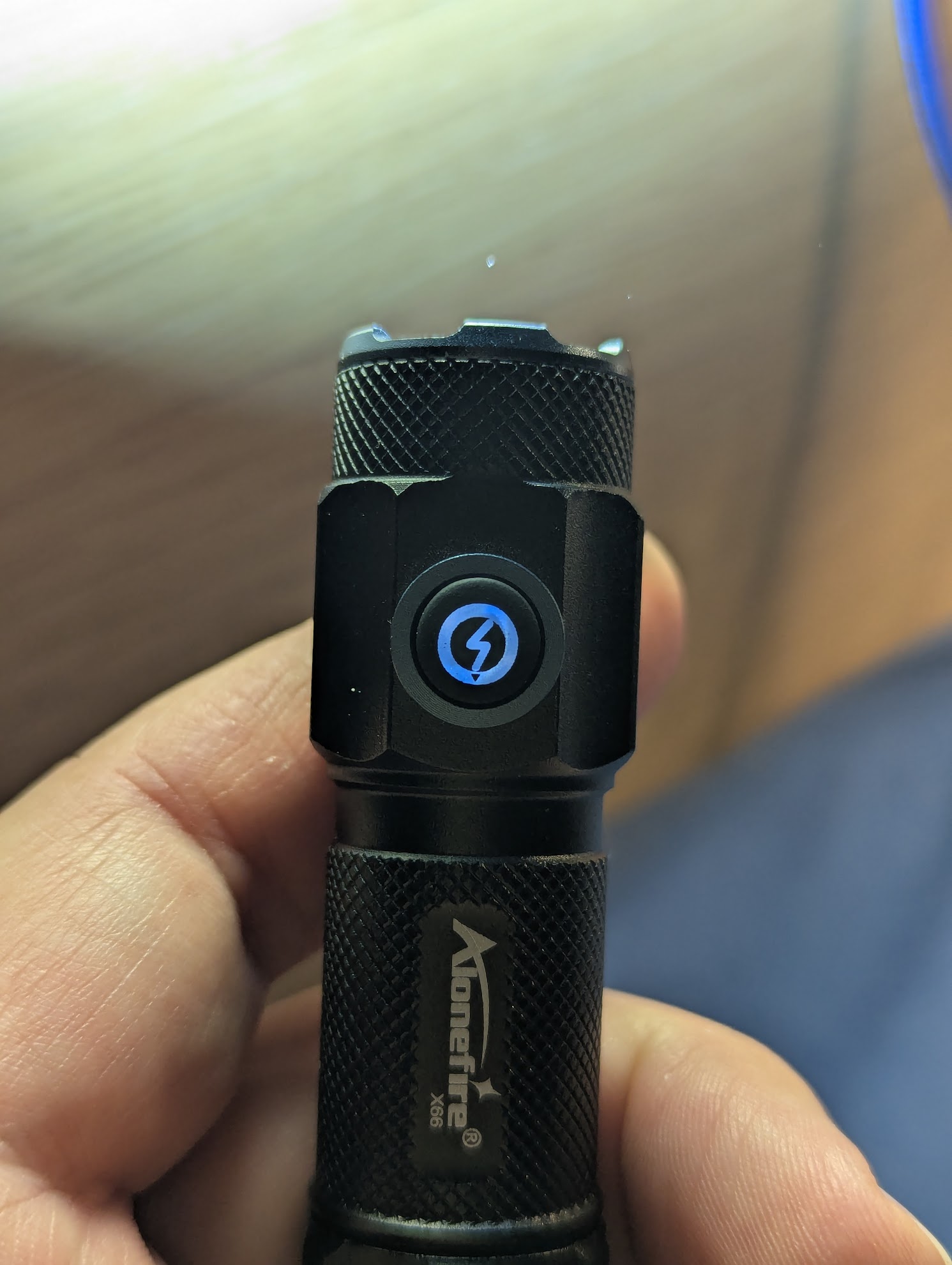

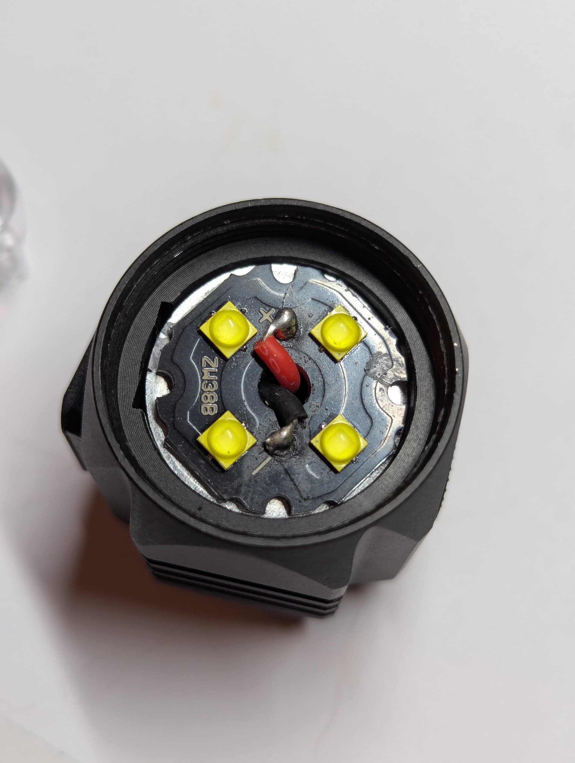

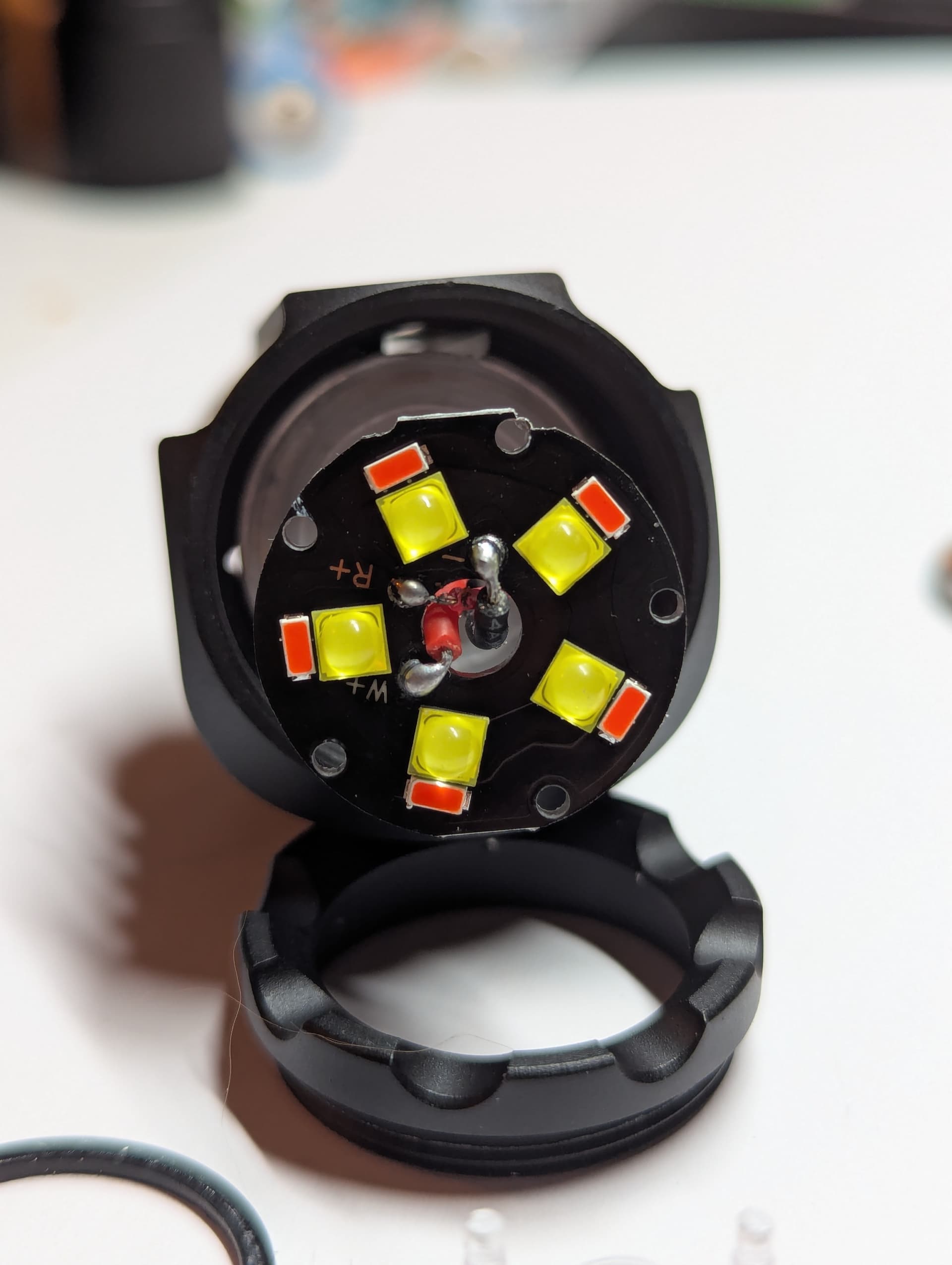

Sooo, I needed a new light for my keychain since the battery on mine was so weak that it didn’t turn on at all anymore.
I bought 3 lights this time.
This because Boruit is some sort of “brand” and I expected this to be the replacement that I will most likely use
This one because it looked nice and I wanted to see how good it was:
And this one because it has a zoom function.
Turns out, the Boruit was the worst of them all.
The beam pattern was super bad, inside was yellowish with a blueish ring around, just overall ugly.
I changed the LED with a 519A and took the lens from my old light and put it in. Now it is better.
The switch feels and sounds cheap. Is is kinda recessed and not easy to find.
UI is the same as they all have, one click gets you nothing, double click goes to Lo, Mid1, Mid2, Hi, Double click from on goes to Turbo, triple click activates the side lights in various order.
The second one was good without modification, but I still put in a 519A. Smallest light of them all, nice wide beam, even pattern.
UI is Low mid High, double click gets to turbo, Long click goes to white flash, one click more goes to red and blue flash
The zoomy one is my favorite. As long as the Boruit. The original LED was a generic 3535 round-die LED with horrible blue white low CRI tint. Now it has a SFT-25R 5000K.
The zoom function works great, but it has some artifacts in the beam because the ring that holds down the LED is silvery and reflects light.
UI is Hi mid Low, double click gets to turbo, long press white flash
The switches of the latter two are pronounced and easy to find but need some force to activate, which for me is a bonus since these are meant to be on your keychain and it is a good thing to not have a switch that activates easy there.

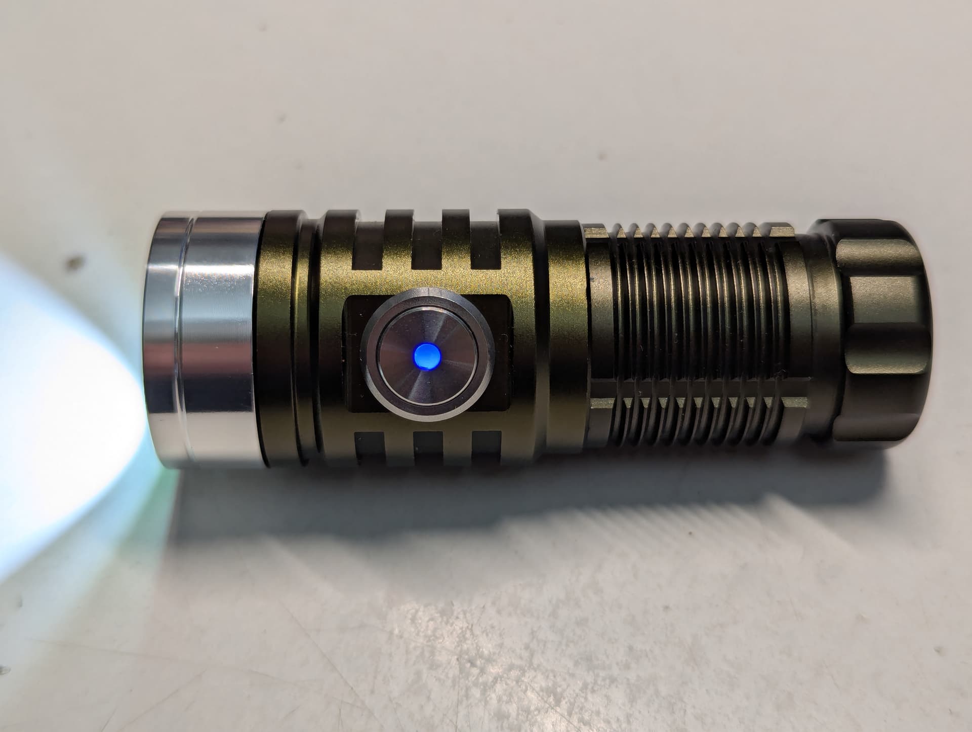

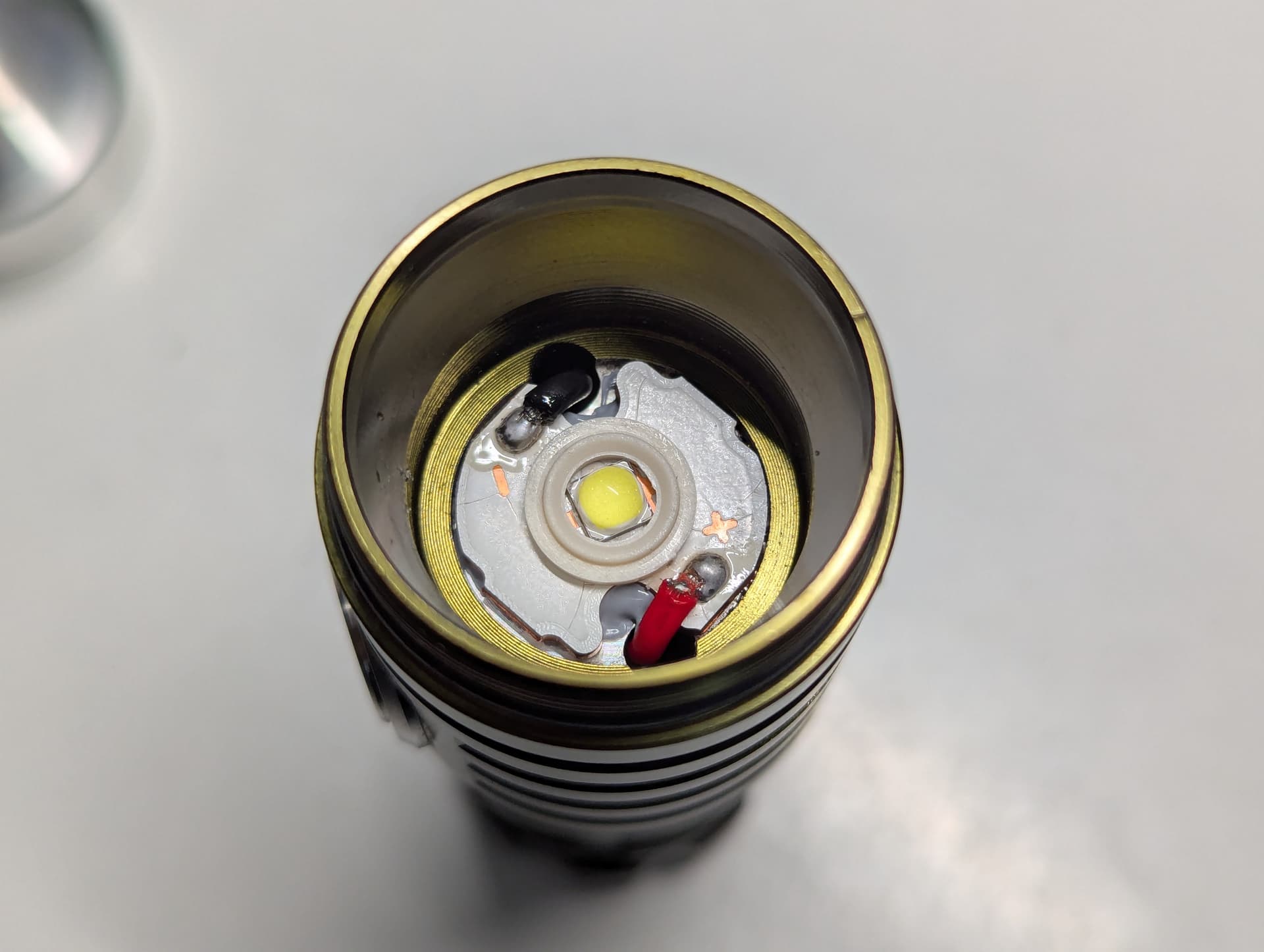

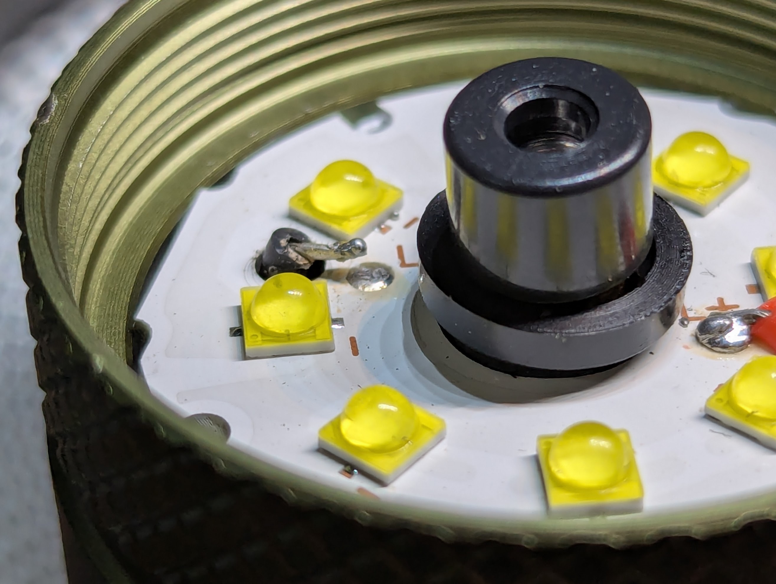

Yesterday, this light came:
Back then $16.79 with the cone
I like how it looks, nice green/bronze color, thick but short… And so is the light.
Well…

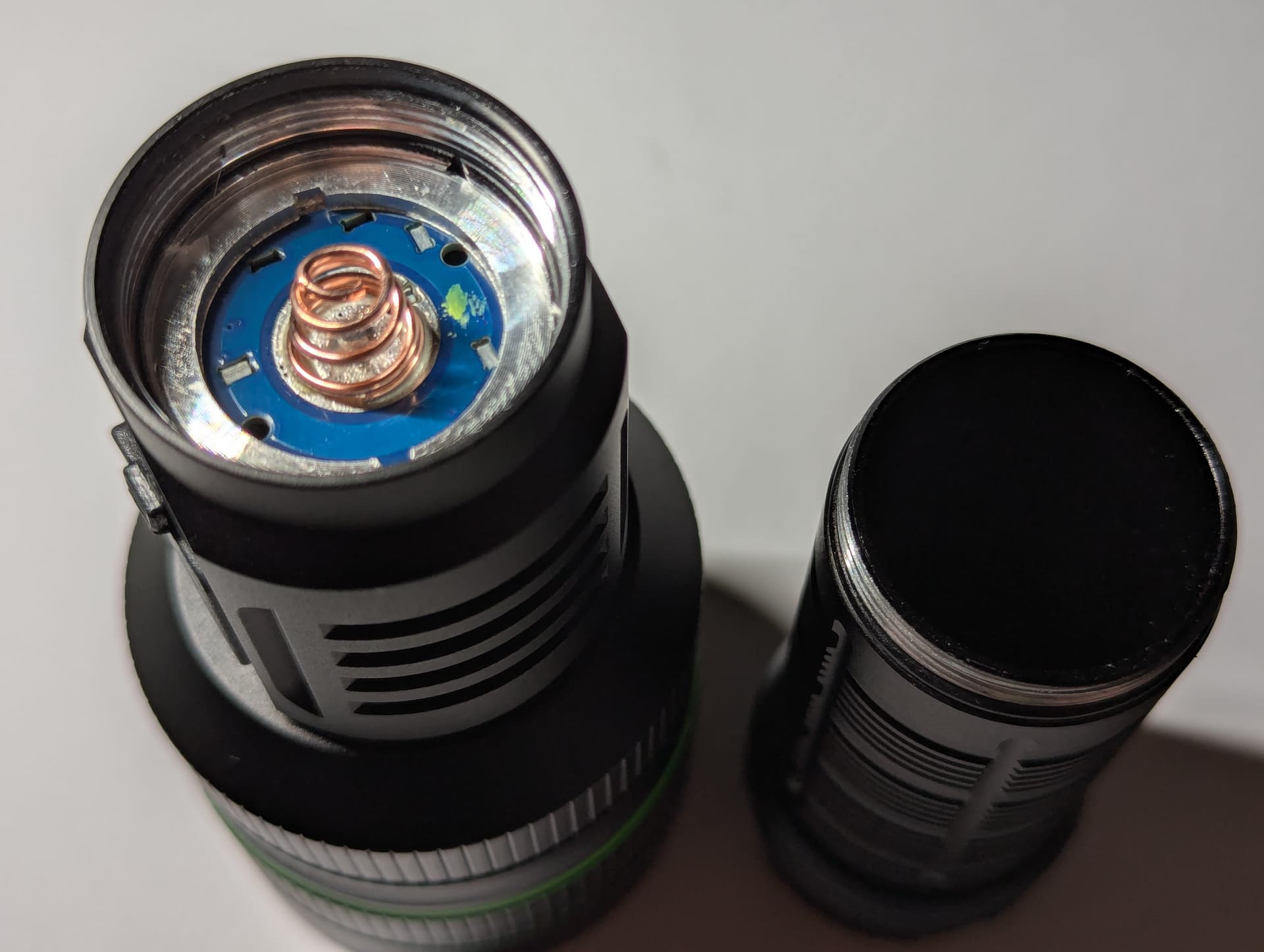

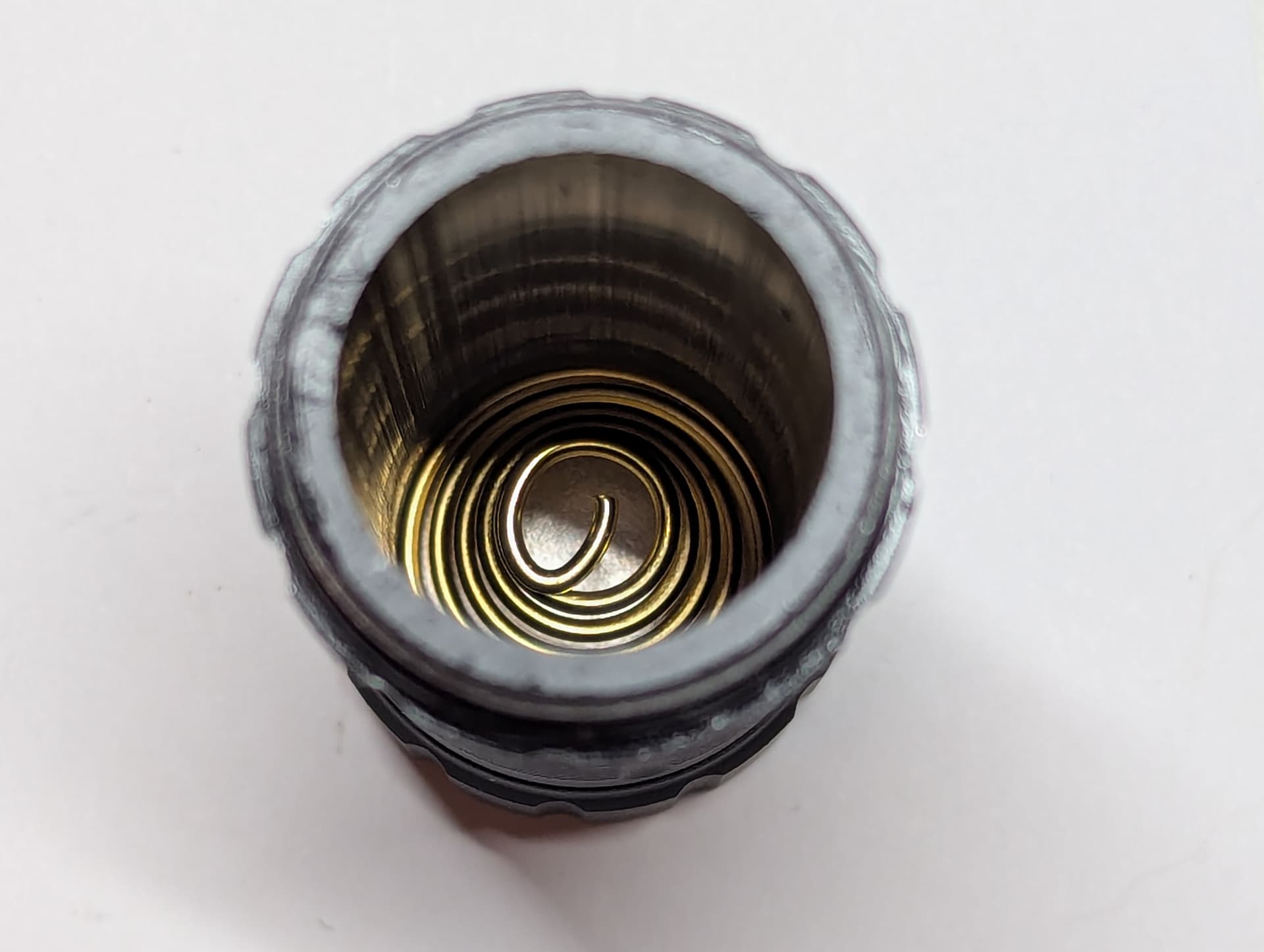

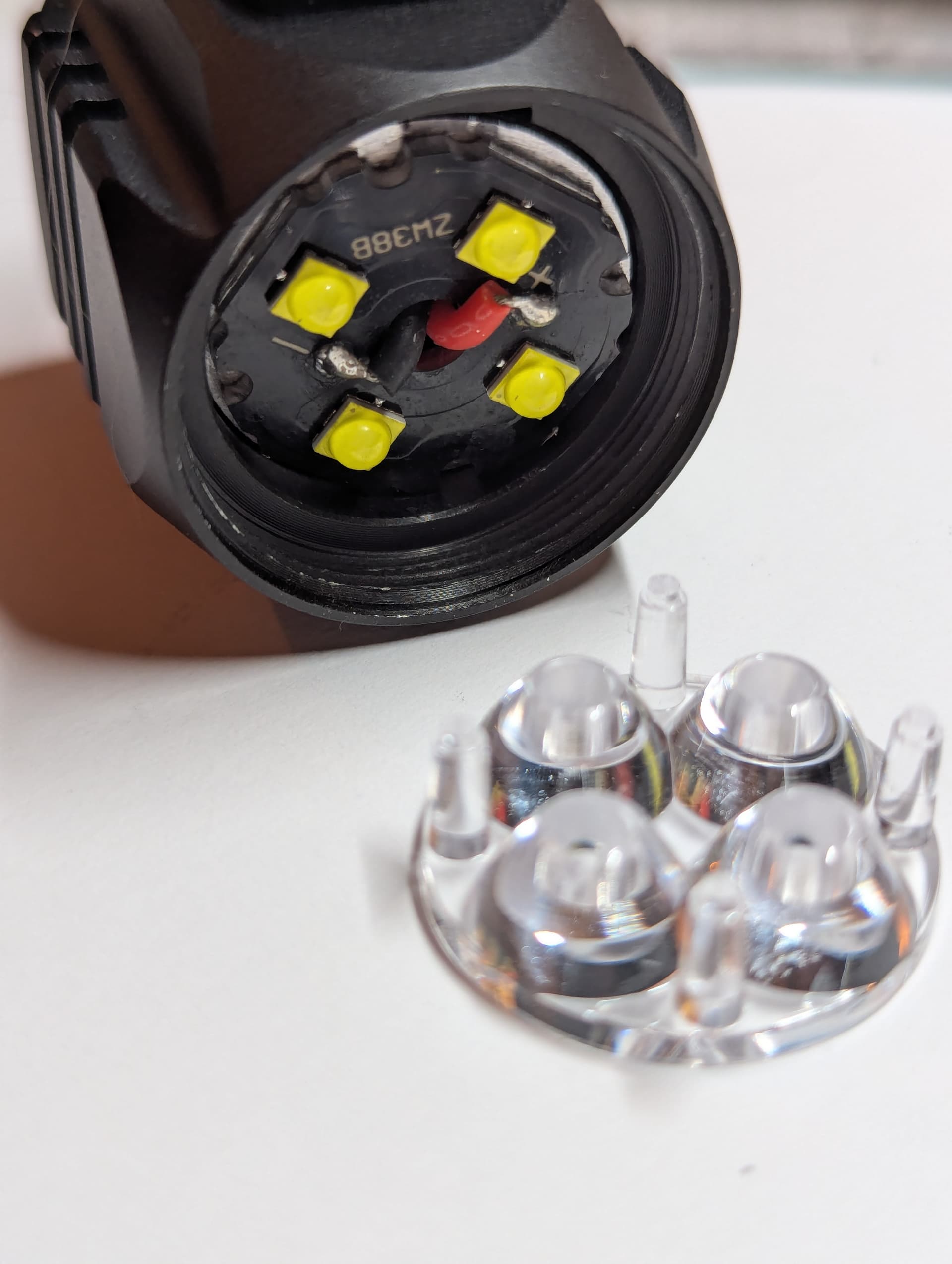

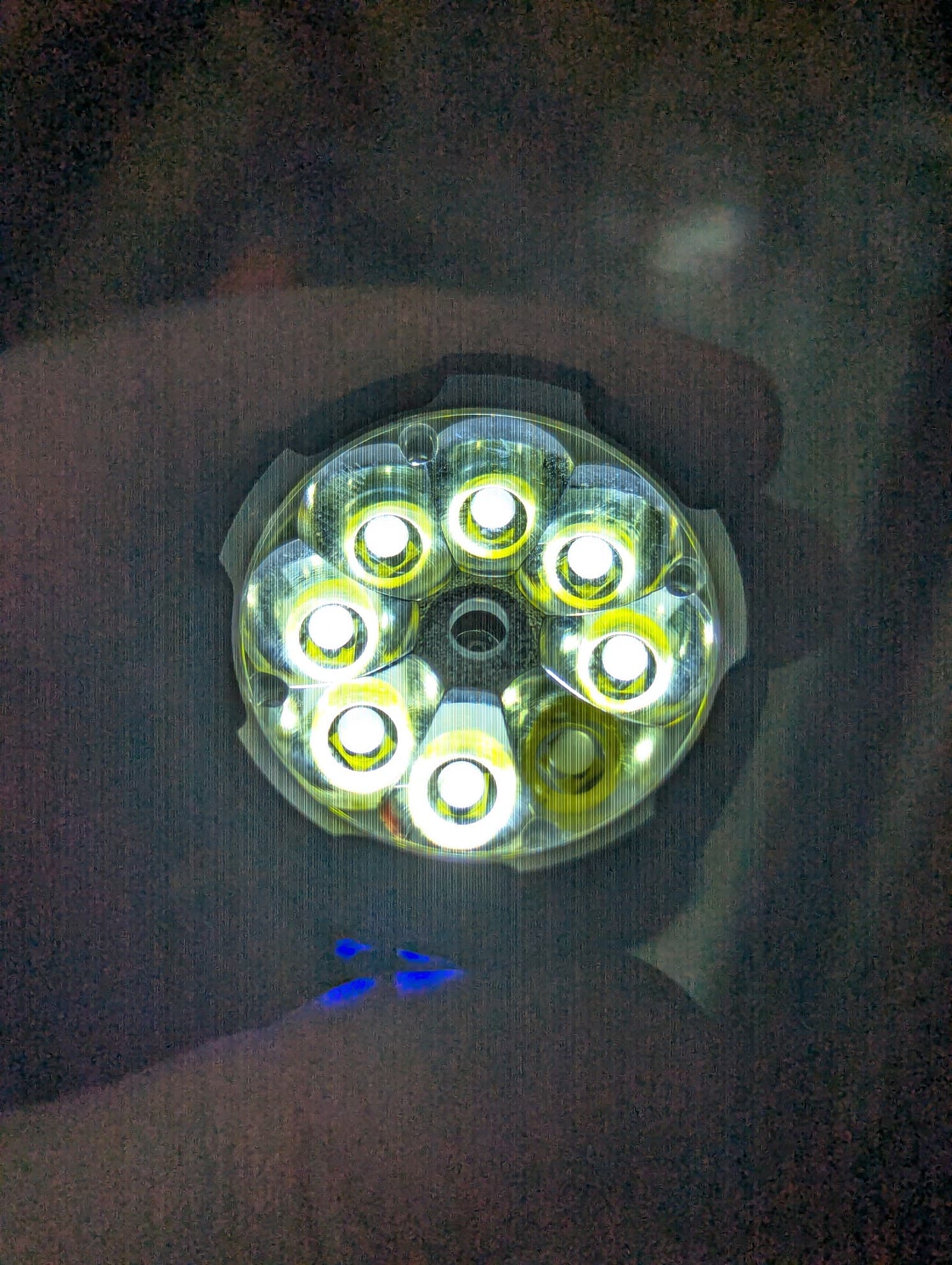

I tried it, didn’t work. Second mode - a friggin Laz0r, did work. So the driver and battery were fine.
opened it, solderpoint was loose:
After resoldering it, the light worked. Well, at least most of the LEDs did…

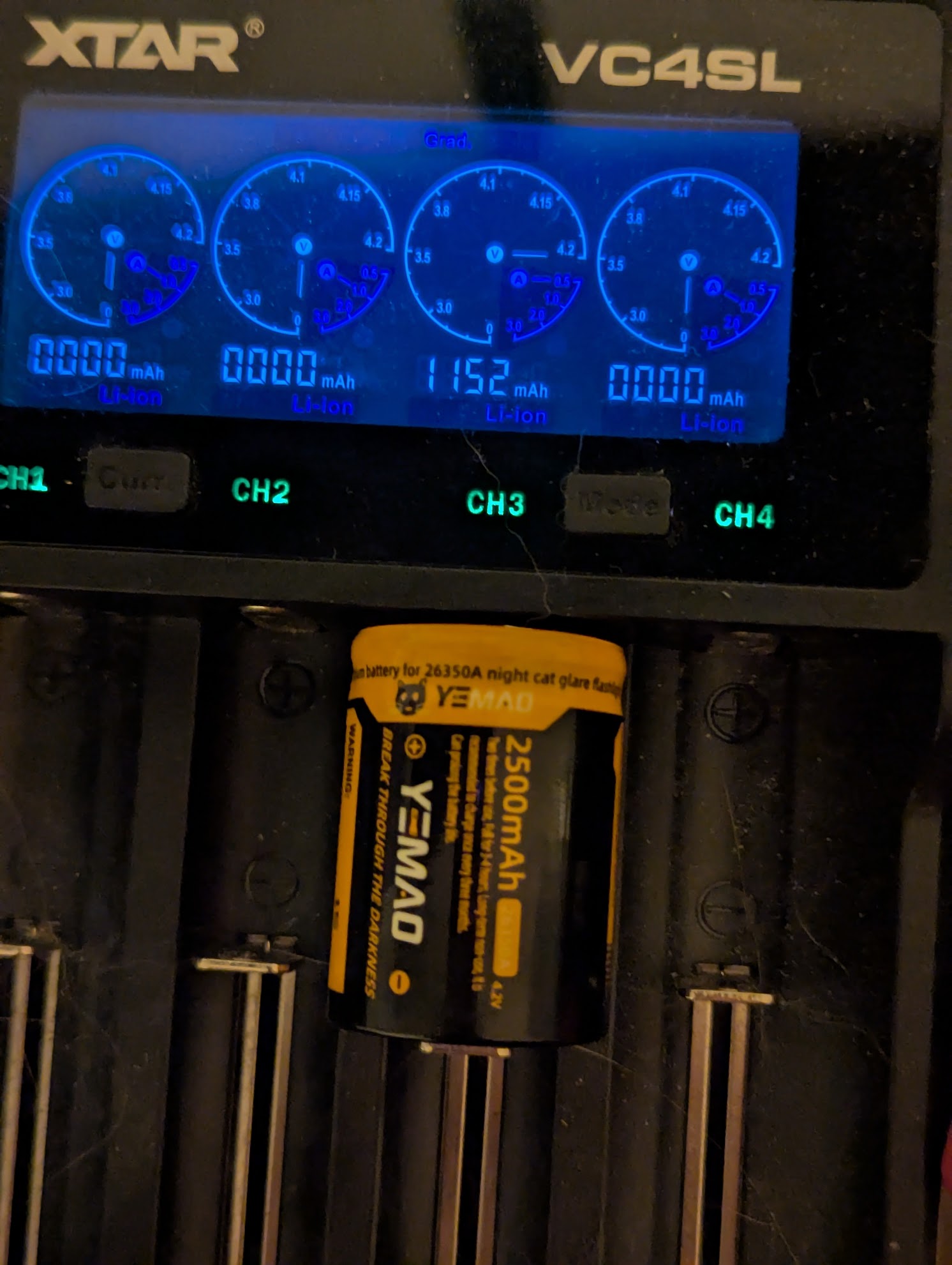

Then I tested the cell, claimed 2500mAh which is realistic for a 26350 - well, not even half of that, probably a 18350 repacked in a 26350 case?
I opened a refund and got ~$7 back.
Since I will cange te LEDs anyway, te defective (or probably just poorly soldered) one is no problem.

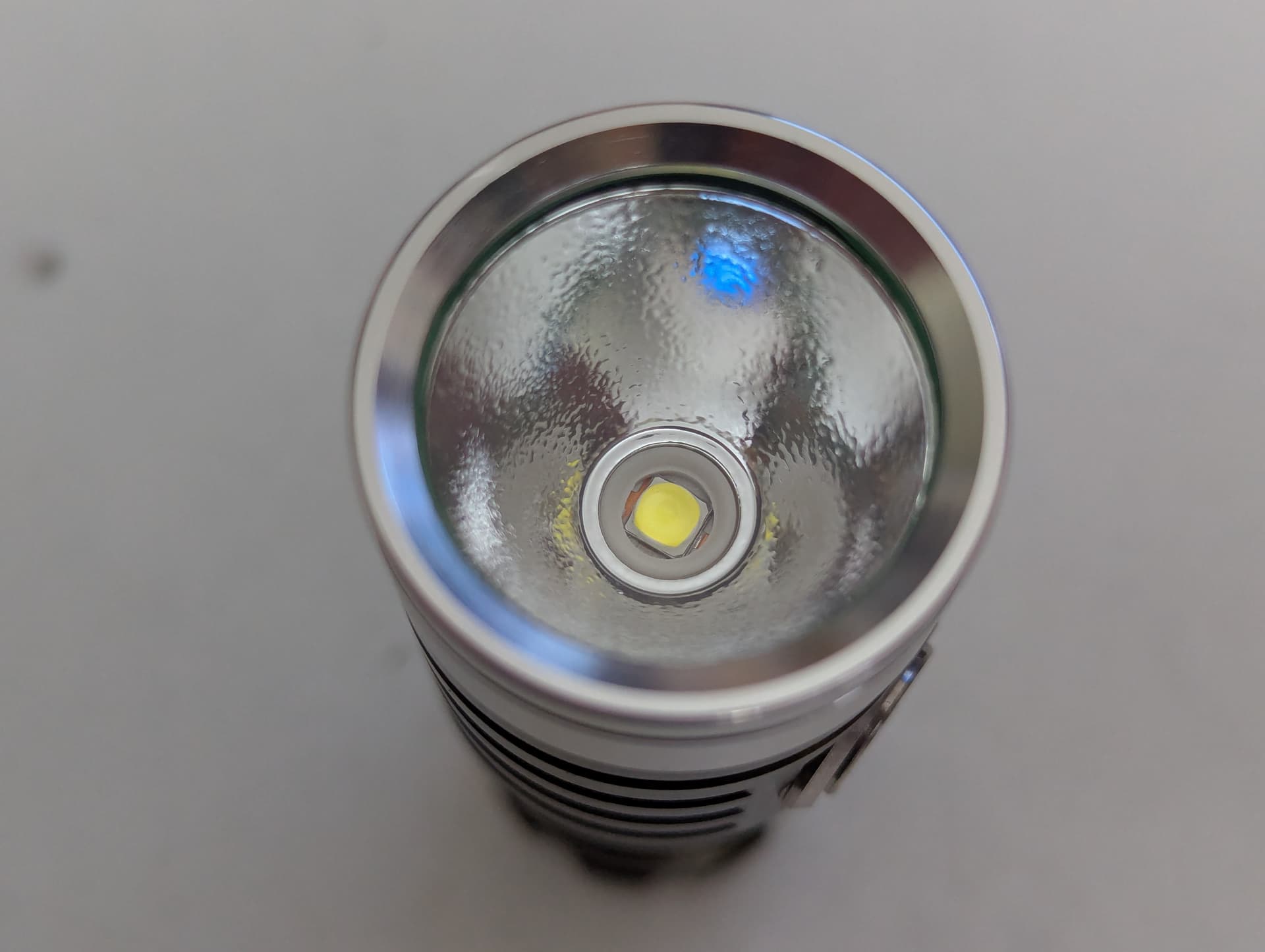

Next contestant:
Price paid: $17,88 incl. 1200mAh 18350 Cell
Cell arrived with 3.98V
What I don’t like is the color difference from head to tube. Quite noticable.
Some generic 3535

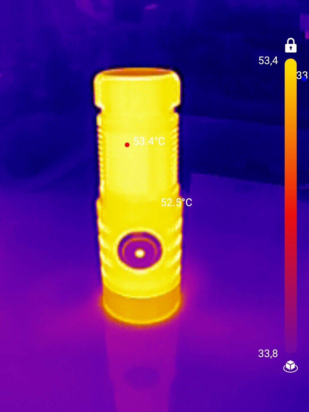

Having it on for some minutes shows a good heat dissipation throughout the lamp.

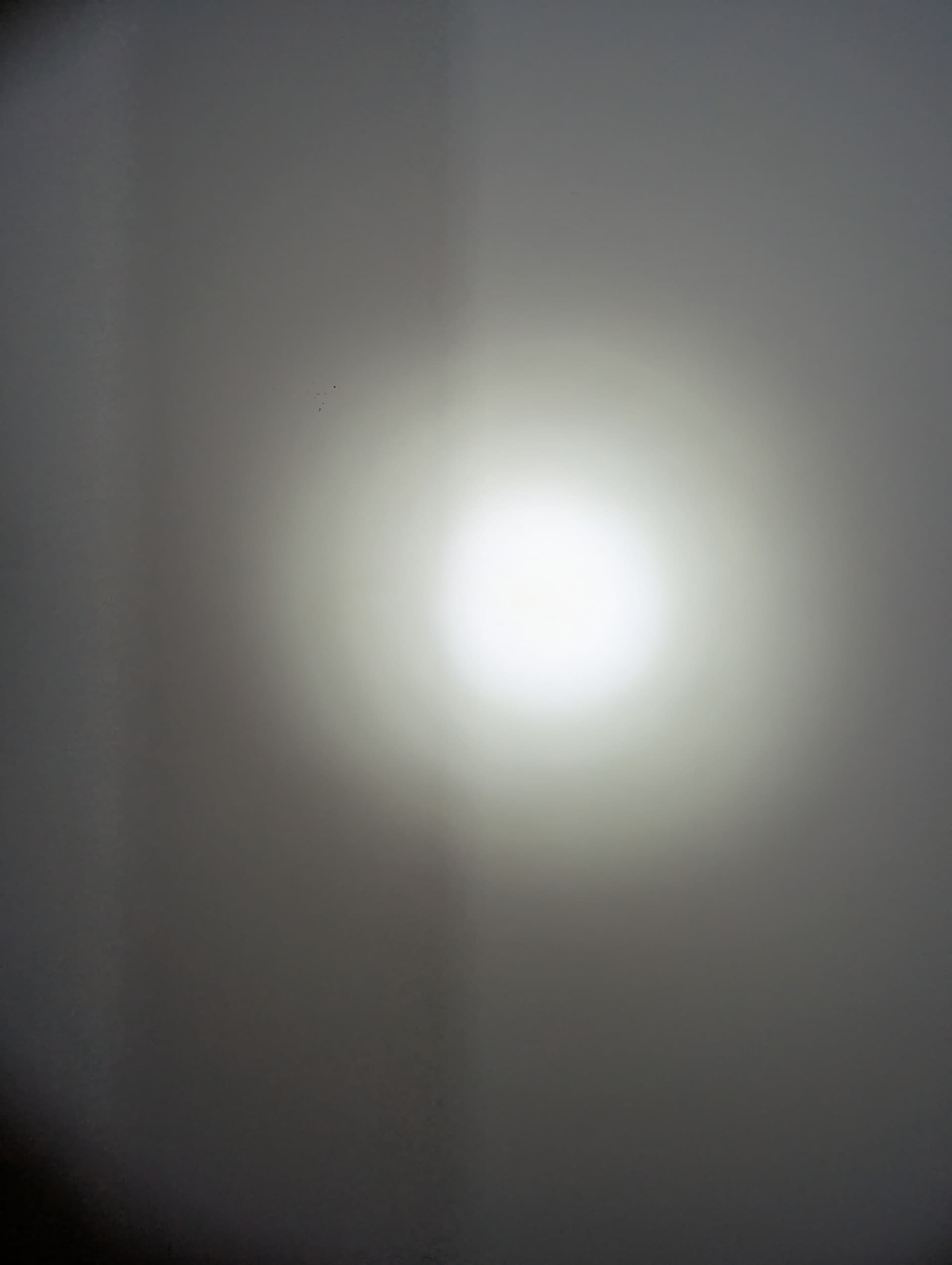

Turbo from 1m:
Lowest mode from 1m:

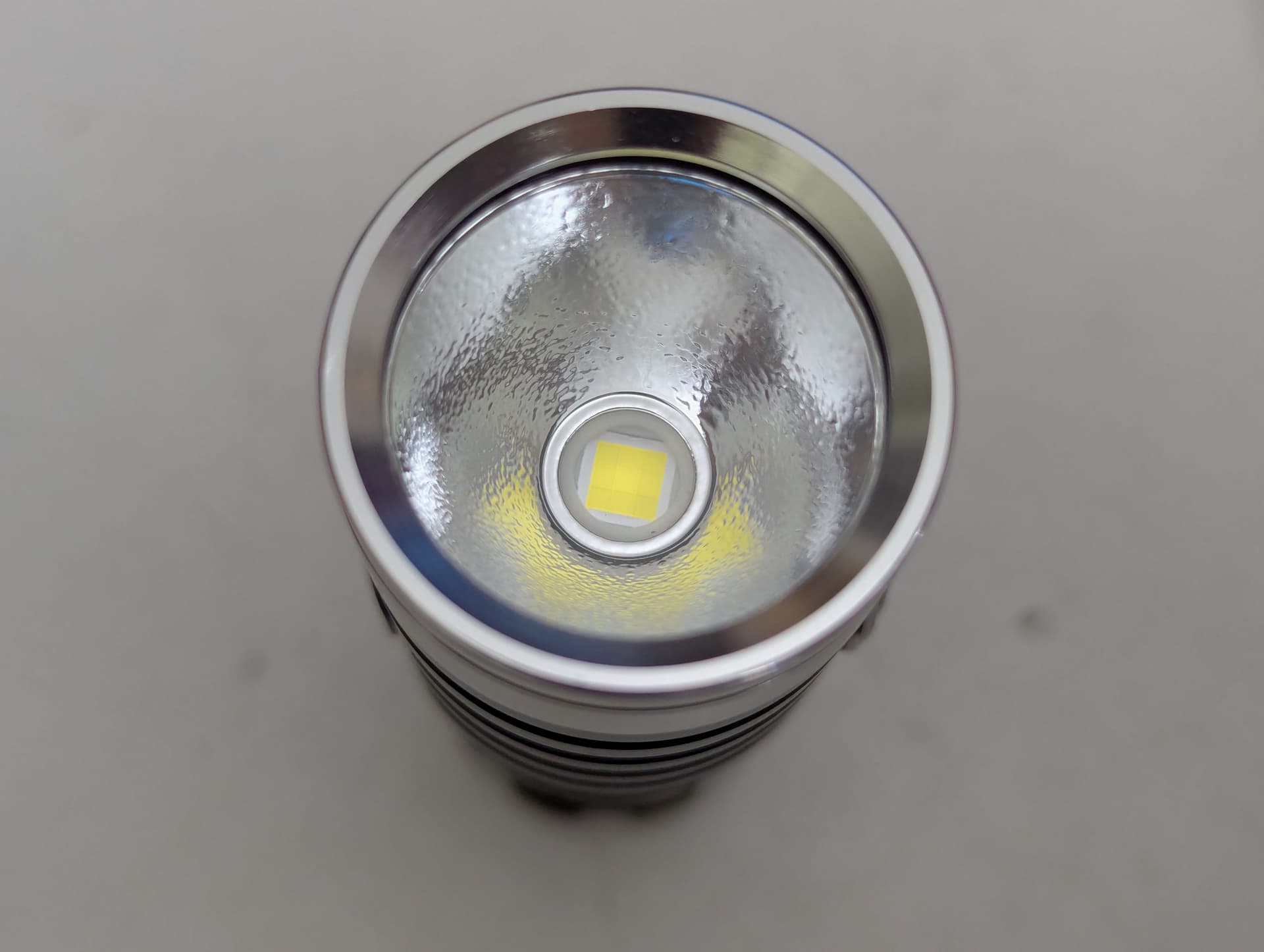

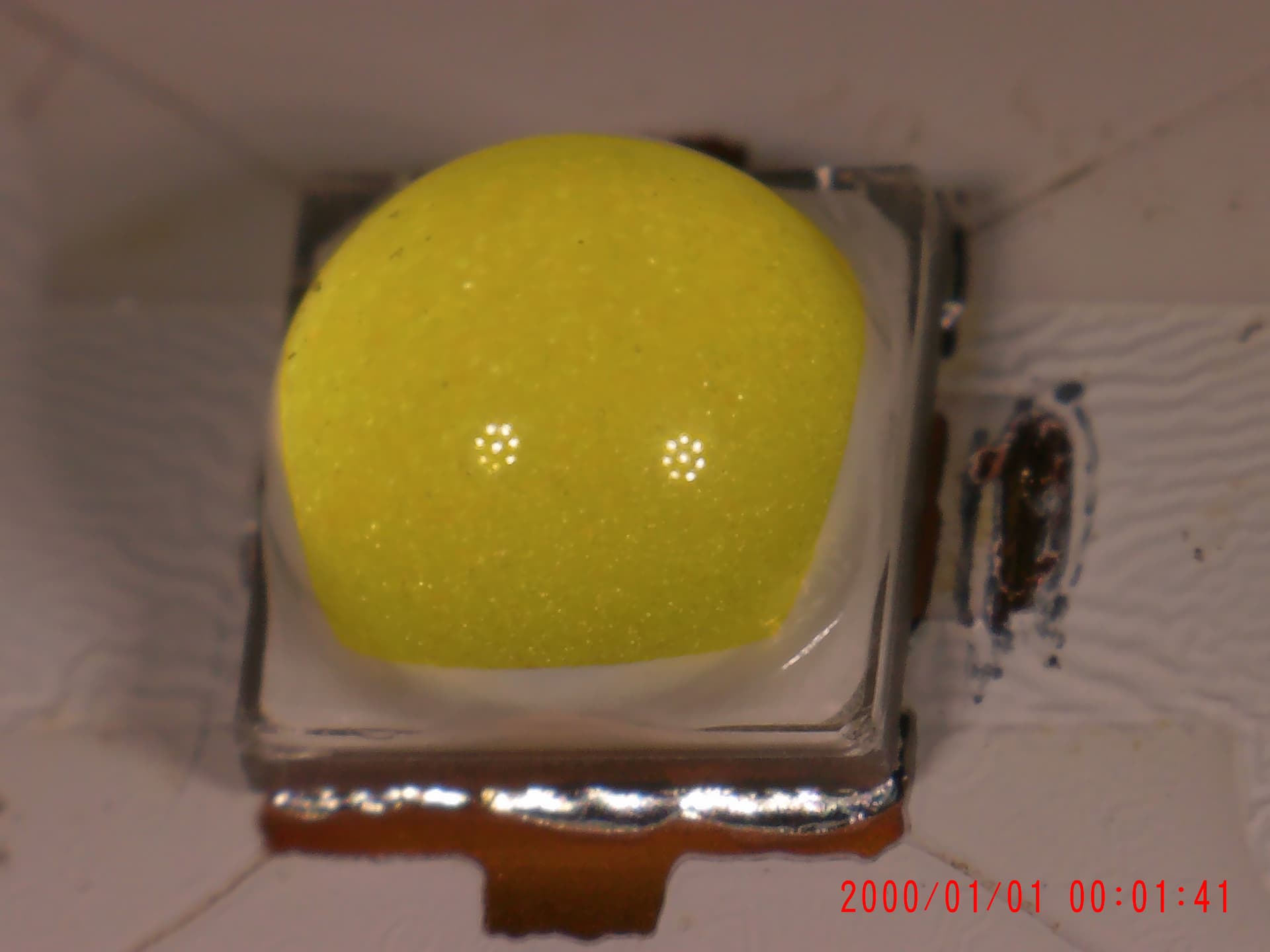

I am testing the cell and trying to fit a LMP LHP531 in there.
Edit:
Modification done.
Just perfect!
And if someone wants to see the OG LED up close…
The MCPCB is a copper DTP Board by the way! (That’s why it is scratched on the pictures)

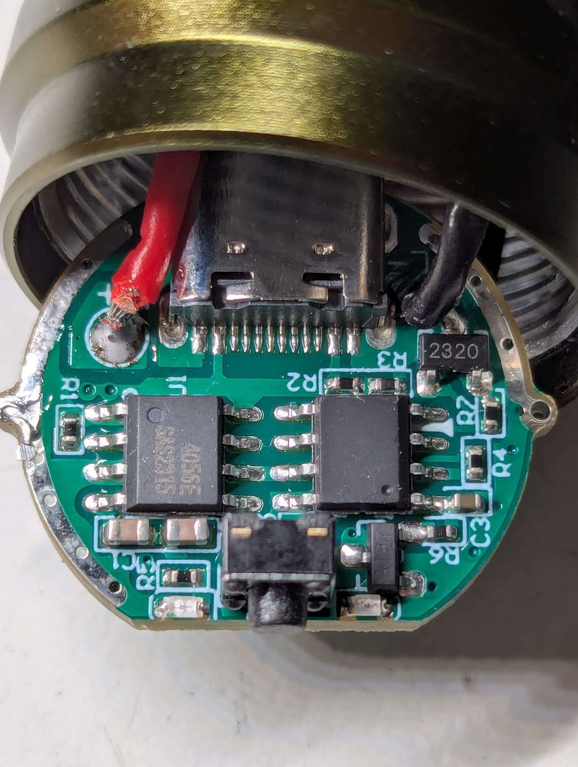

Ok, I have to make a new post because I must clarify something.
I don’t want to be unfair.

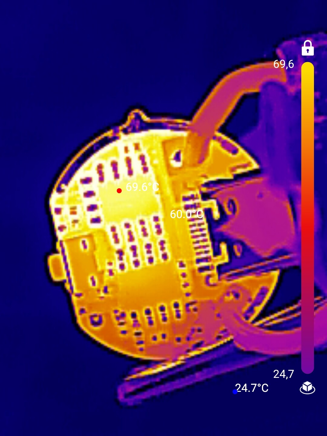

I did put in a different 18350 and the light heated up by itself.
Then I remembered, that I did use my Lab PSU that destroys drivers, as written in other posts in this threads.
So I used my other (Riden) Lab PSU and saw, that the driver draws 1 Watt while doing nothing.
Then I grabbed my IR cam with the Closeup Lens and located, that the 4056 charging chip was hitting 90° after a couple of seconds.
Again - the led was not on, just voltage to the driver while off and not charging anything.
So, I changed the chip and fixed the problem.
Draw in Idle was now not measurable.
Was.
Because when I checked the amperages again, the Chip drew 1A in Off and burned up again.
So then I decided to just remove the chip and the USB C Port and use the light as a light without USB charging.

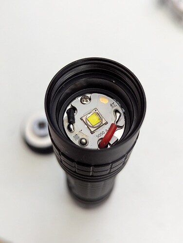

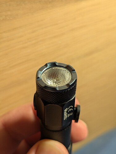

Warsun A700

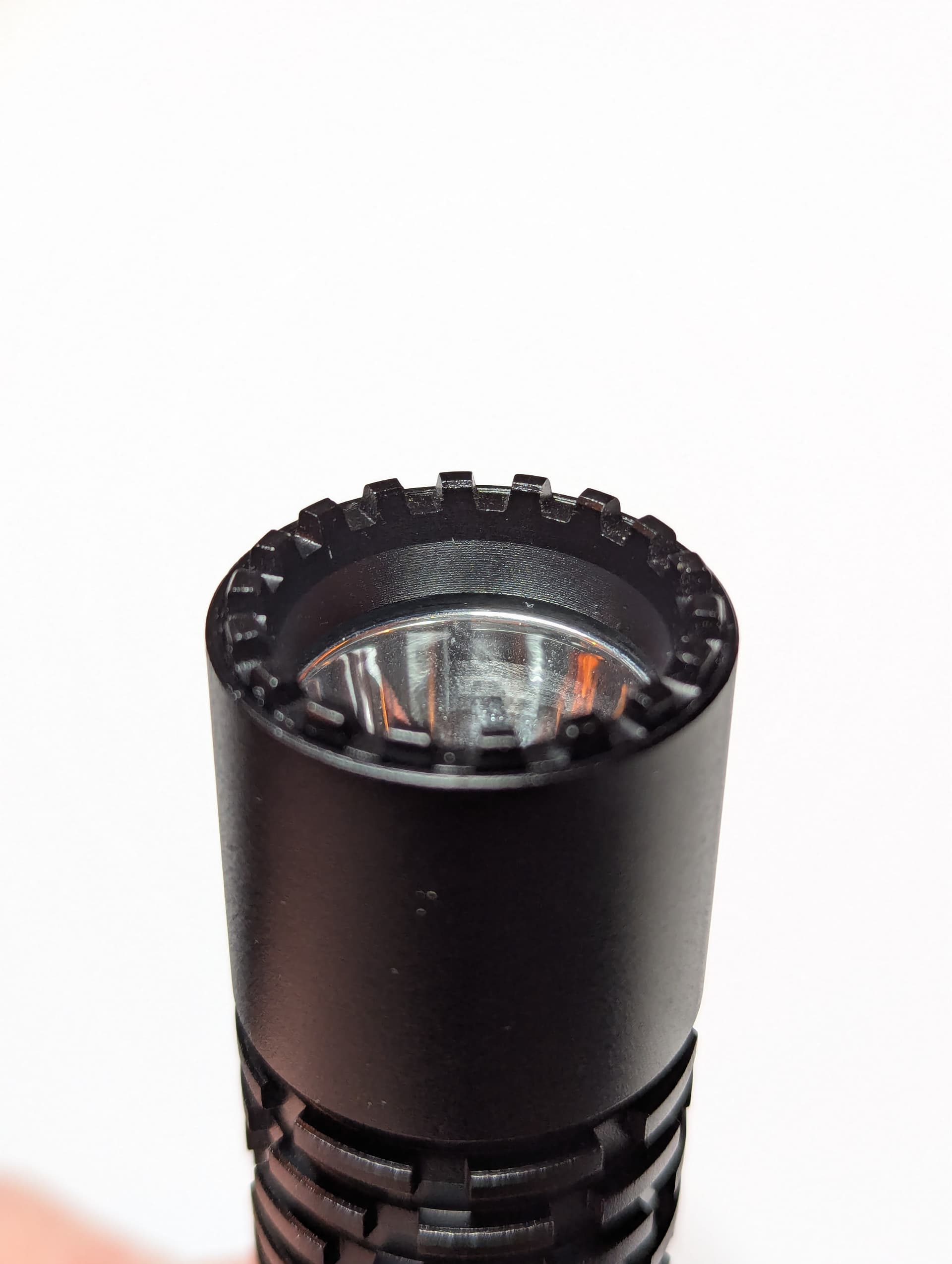

Bezel can just be unscrewed with the friction of the fingertips, not waterproof!
Looks like a standard 20mm Lens
After unscrewing a aluminum ring the inside just pops out the front.

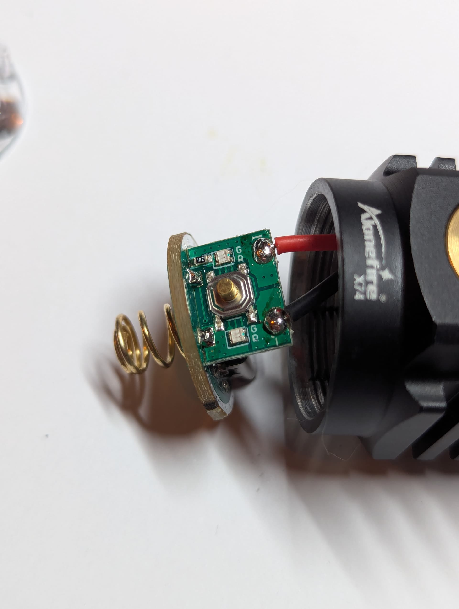

Not much meat for the heat, but a copper DTP-MCPCB, didn’t expect that.
Charging circuit and back-LED
Won’t take it apart further than this.
The LED on the back is so dim on the outside, some lightened up switches are much brighter. Don’t know what this is actually for, maybe they reused an IC from a light with a COB or something?
Maybe as a ultra-giga-low-powered night light?
Changed the LED for the LH351D that I pulled out the Sofirn HS22 earlier this day.
For the money it’s an OK system, ready to go, just won’t last too long. Not something for a night walk or so, more for people that use a flashlight every 3 months for 5 Minutes.

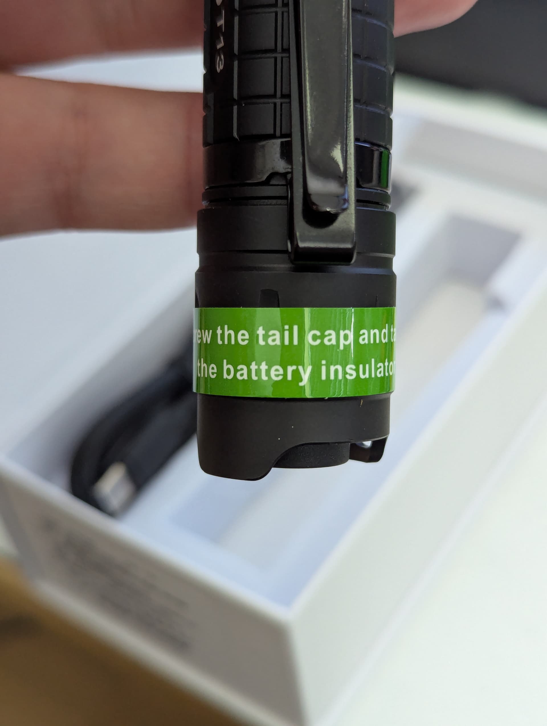

Packing looks a bit like Sofirn, two instructions that you have to remove the little insulator

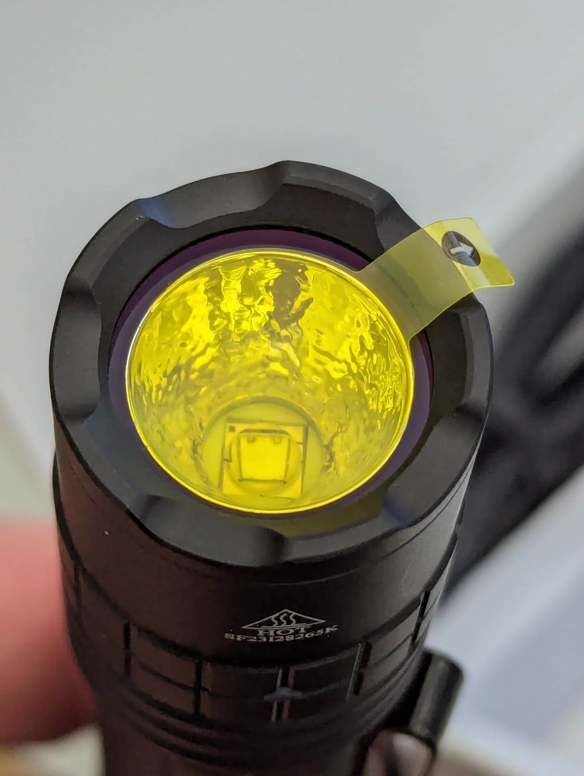

Fancy yellow protection on the lens - I like this more, on the Convoys it can be hard to see if there is any.

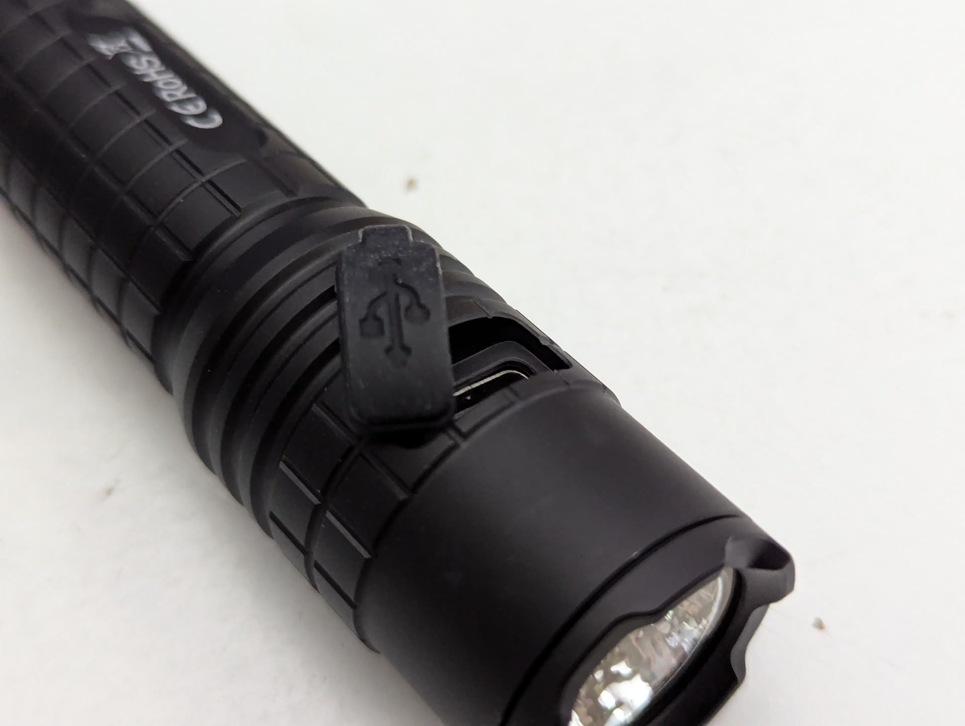

Quite a deep charging Port, small status light on the other side

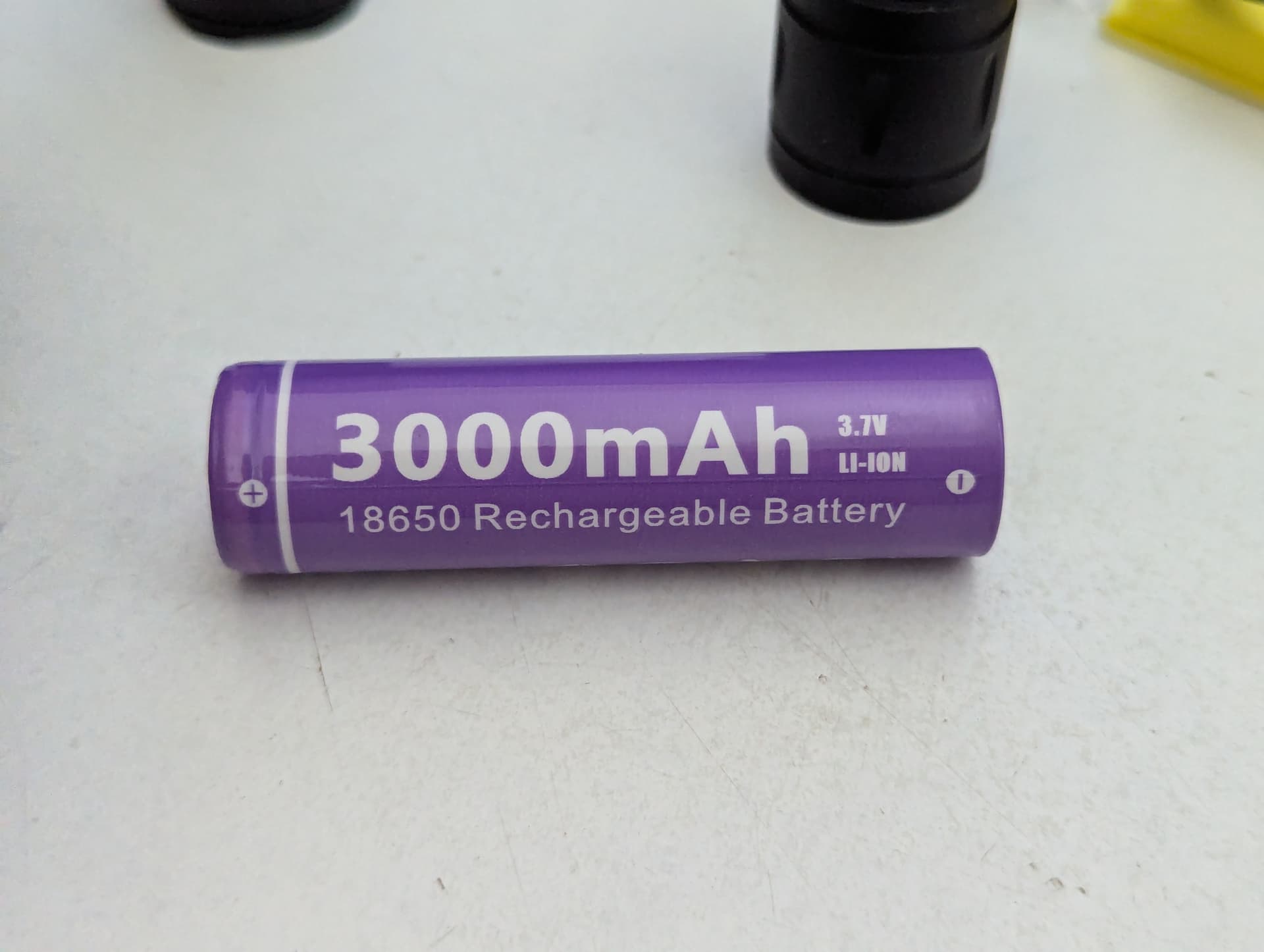

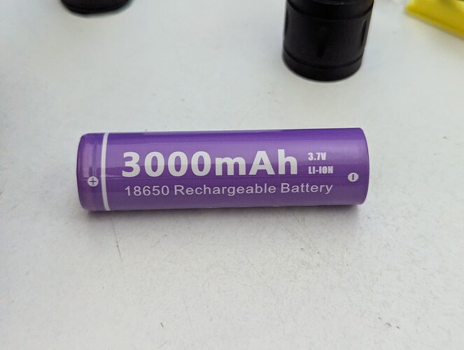

Cell will be tested (Edit: 2958mAh first test)

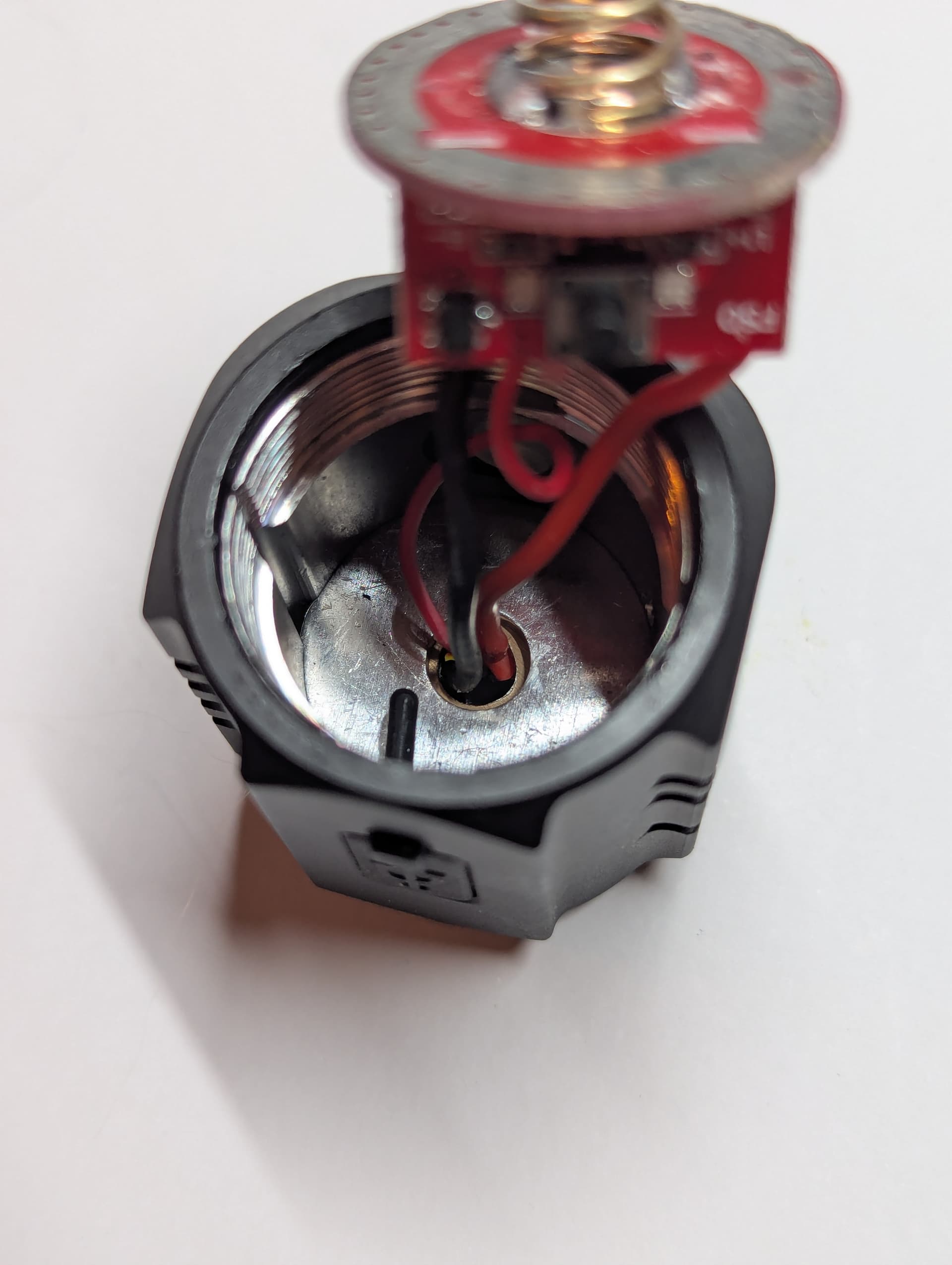

Switch, feels quite nice, it sticks out quite a bit, the light still tailstands, but not very stable.

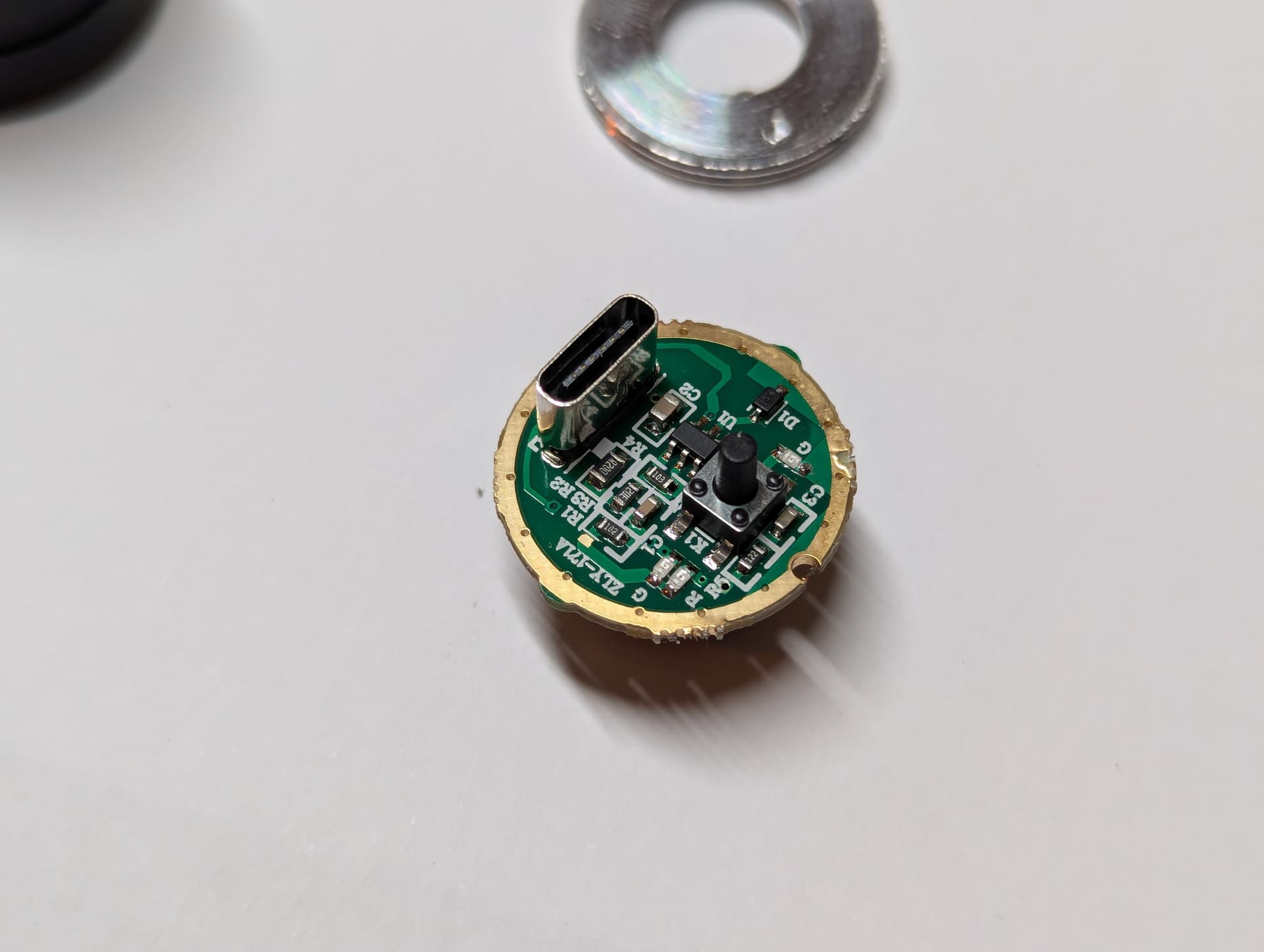

Driver probably glued in? Not so nice…
Aside from the unreachable driver, this light seems to be a nice alternative to the classics in this size and brightness-class, just with USB charging.
