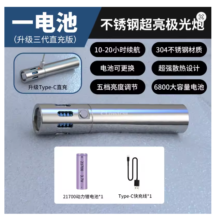

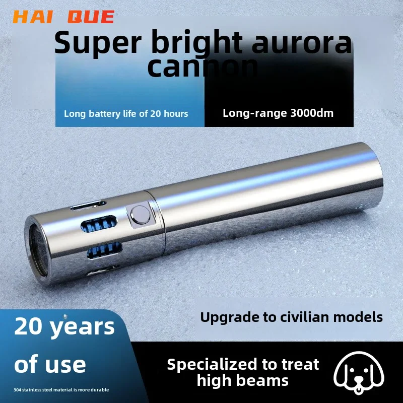

I just stumbled upon a “cheap”/Chinese stainless steel flashlight I haven’t seen before. It’s maybe a bit more on the upper end of the ‘cheap-scale’, but given the somewhat unique looks and material, it might be an interesting flashlight.
Lumen and distance claim is obviously total BS, but it looks like a decent flashlight, with a replaceable 21700 (possibly included?) and USB-C charging.
Here it can be seen that it has a USB-C charging port on the opposite side of the button:
This is the store with the lowest price and with the best ratings:
This is the only other shop that I could find that offers this light, but it is more expensive and it is a pretty new store with only a few reviews/ratings:
I’m really curious and tempted to order one, but over the past couple of weeks I already ordered way too much stuff on Aliexpress, so for now I will pass on it and hope someone else orders one and posts more details about this light, here on BLF. :sweat_smile:
It has 5 Modes but nowhere it is said what the modes are.
5 Modes are too often Lo Mid Hi SOS Strobe, before I buy this, I will ask the seller

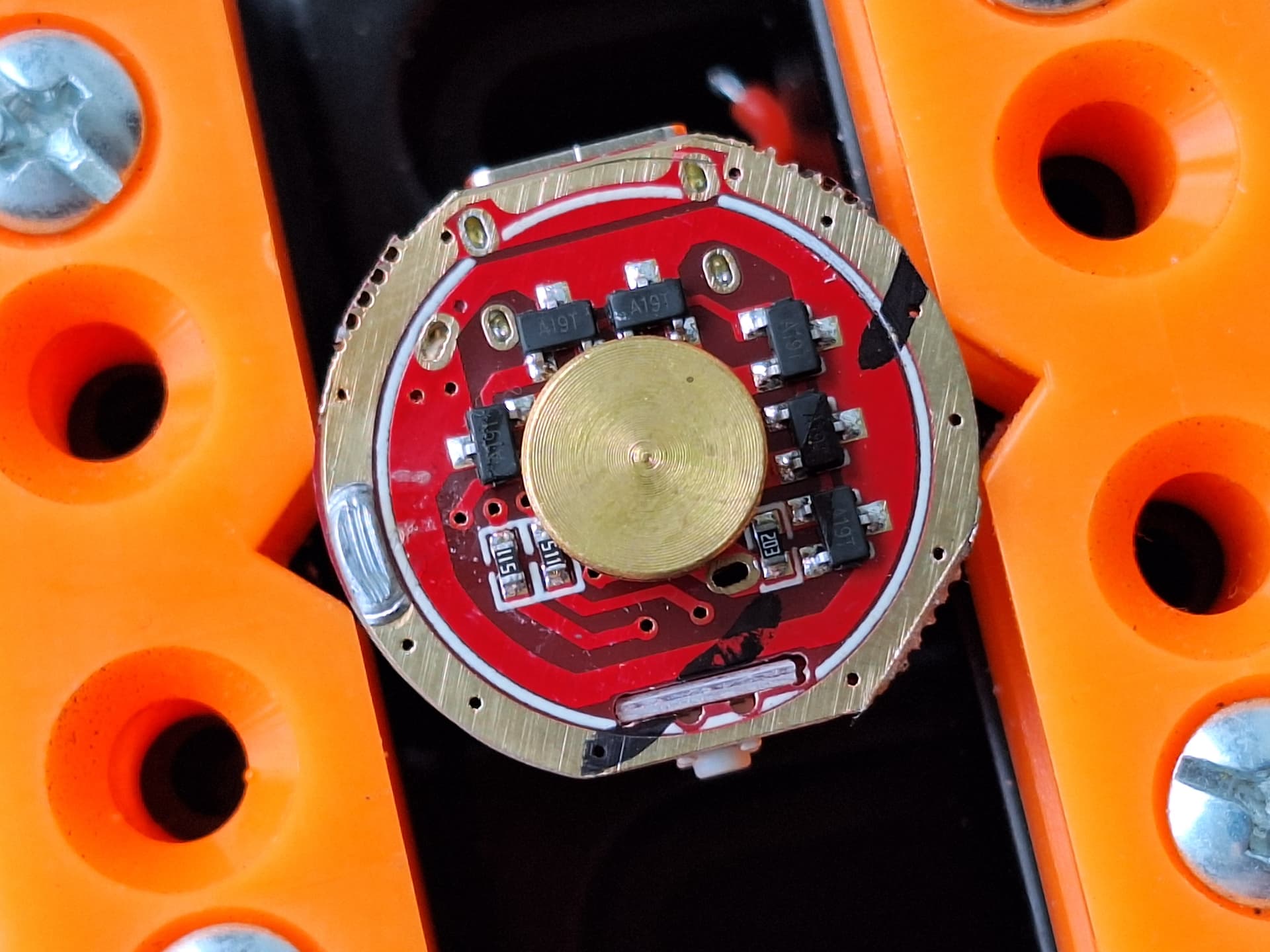

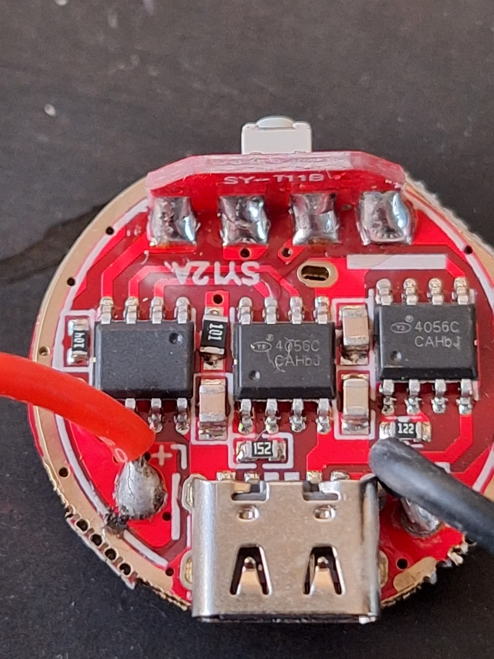

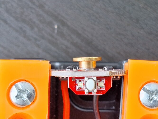

I was curious about the driver and I believe there have been no pictures in this topic, I decided to pull the driver out of my BT13, to make some quick close up photos from the driver components/construction. (Photo quality could be better; just took a few quick photos to get an idea of the driver.)
Some photos and after that some things that stood out to me:
-The ‘underside’/battery side of the driver houses 6 A19T transistors/P-channel mosfets.
-My sample had a ‘thick’ blob of solder on the outer contact ring, which will likely prevent the driver retaining ring to make full/flat contact with the driver.
-The copper ‘button’ (for battery contact) on my driver is not soldered on flat; it is slightly angled.
-The ‘upside’ of the driver has 2x 4056C chips, which should be li-ion charging chips I believe. The only reason I can think of that they used 2 (identical) charging chips, is that each of them only charges at 1A, so maybe 2 in parallel to get 2A charging? (Correct me if I’m wrong!)

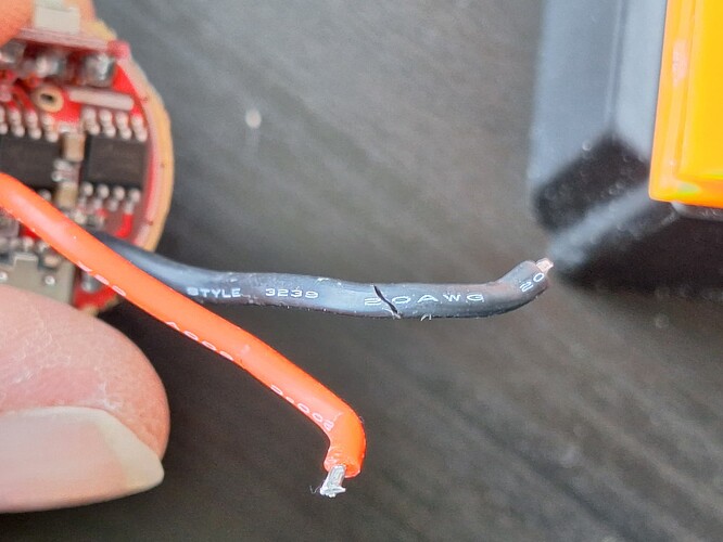

The driver wires used are 20AWG, which is not too bad, but the negative wire had a big cut in it, as can be seen in the last photo. Given the location, this is probably caused by a sharp edge on the hole through the ‘shelf’ of the flashlight and could cause some serious issues when it would make contact with the housing/body of the flashlight.
Not too much I can think of right now, to mod on the driver, but I will be rectifying the few issues I’ve spotted and I will replace the 20AWG driver wires with 18AWG ones. When everything is put back together, I will do an amp test at the tail with several high drain batteries, to see how much my sample will pull.
