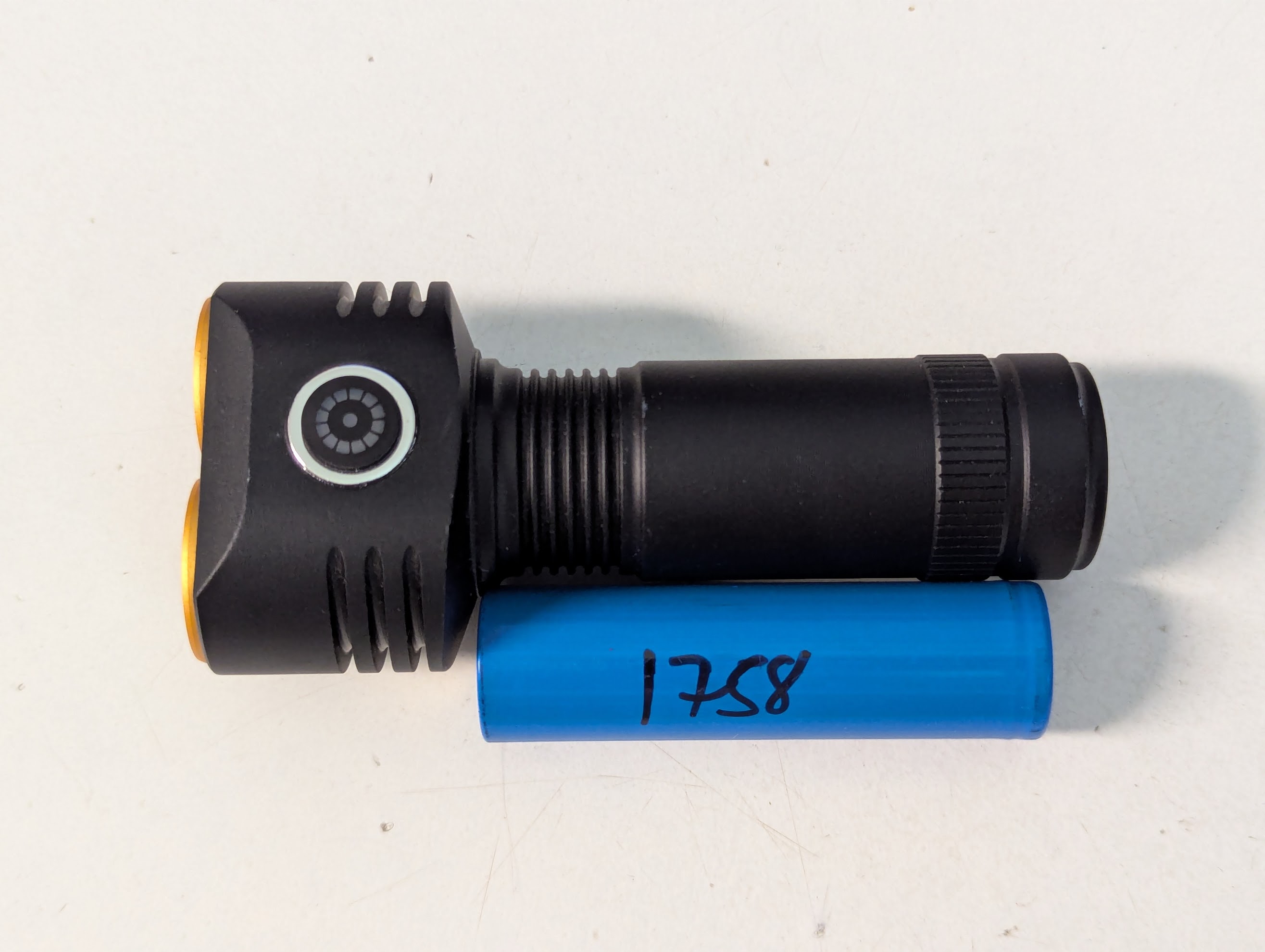

I’ve seen this flashlight popping for quite a while now and it makes me curious for a while now, since it looks A LOT like a flashlight that Niwalker is producing for quite a while now: the Niwalker Etmini (series).
There also is a black 18650 version of this one and I’m really curious if (“by miracle”) that battery tube would fit onto my Etmini.

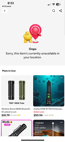

I guess it’s not available in the US:
Fortunately there are a lot of other stores that also offer these lights (for more or less the same price), so I expect that there will be a store that does ship to the US:
If none of these links work, let me know, I could easily find another 5-10 listings! :grin:

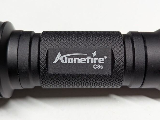

Now for something you have never heard of, a design that has never been used before with a name that no one here will recognize: The C8!
Bought it because it was cheap (USD6.63 for T6 1 mode) and I wanted to see, how good or bad super cheap lights are today.

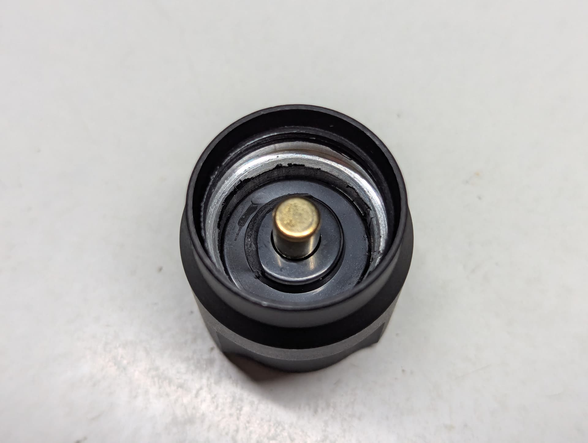

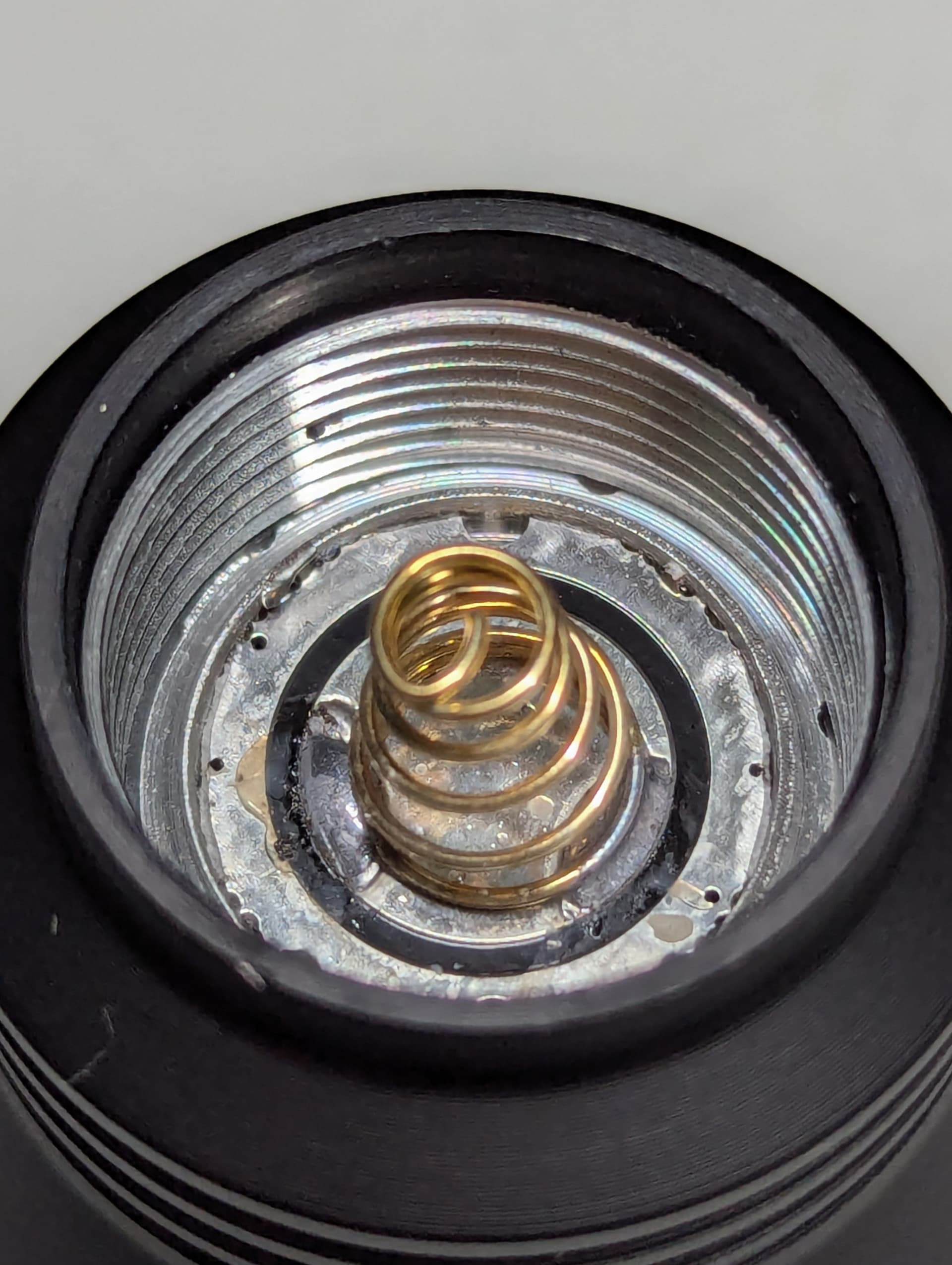

Pressed in switch with some material ground away in the middle, who knows why.

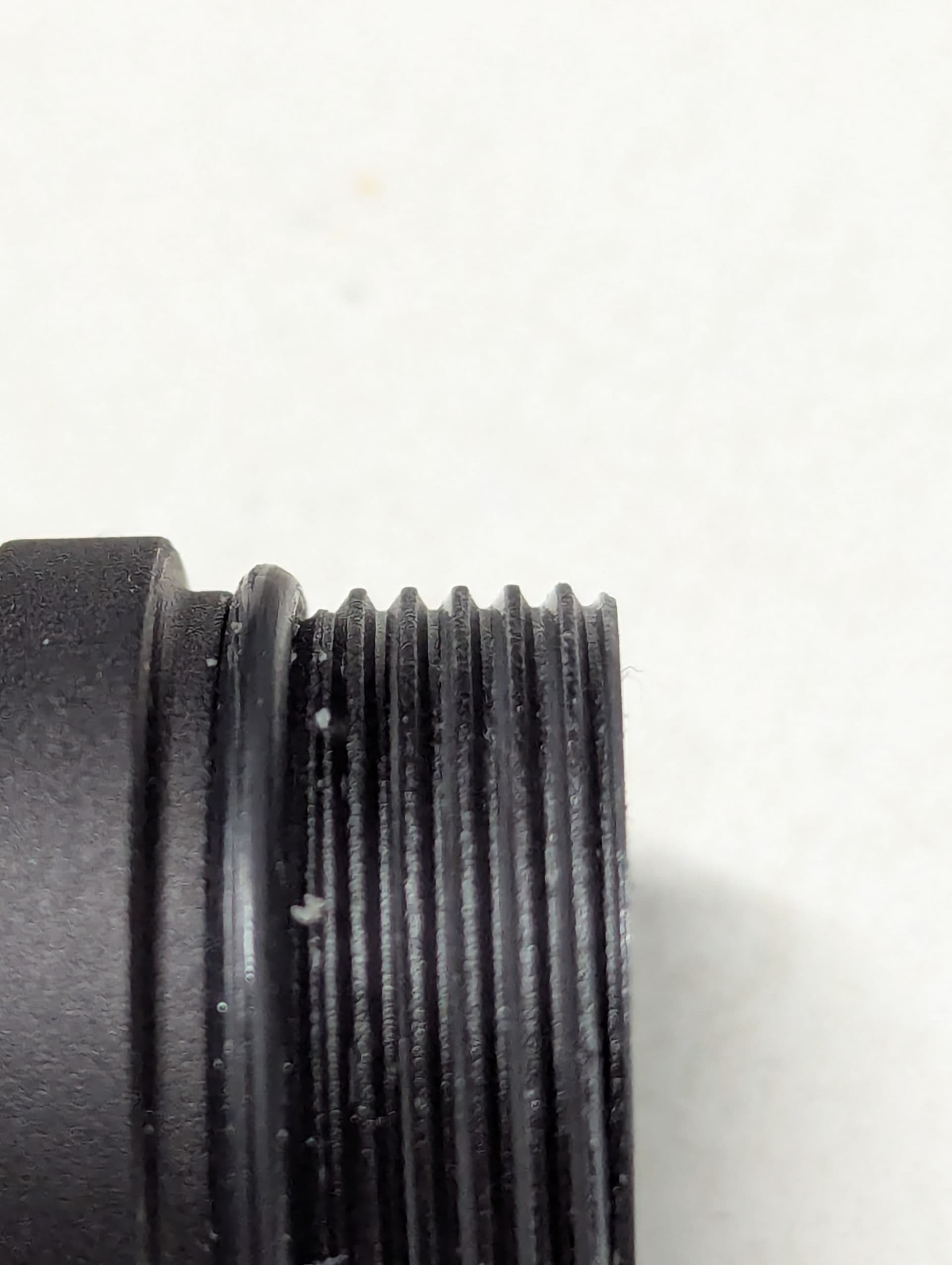

Square threads, didn’t expect those!
Anodizing feels quite nice, I thought this thing will be shiny - I like the very matte finish more.
C8s - s for “superior”

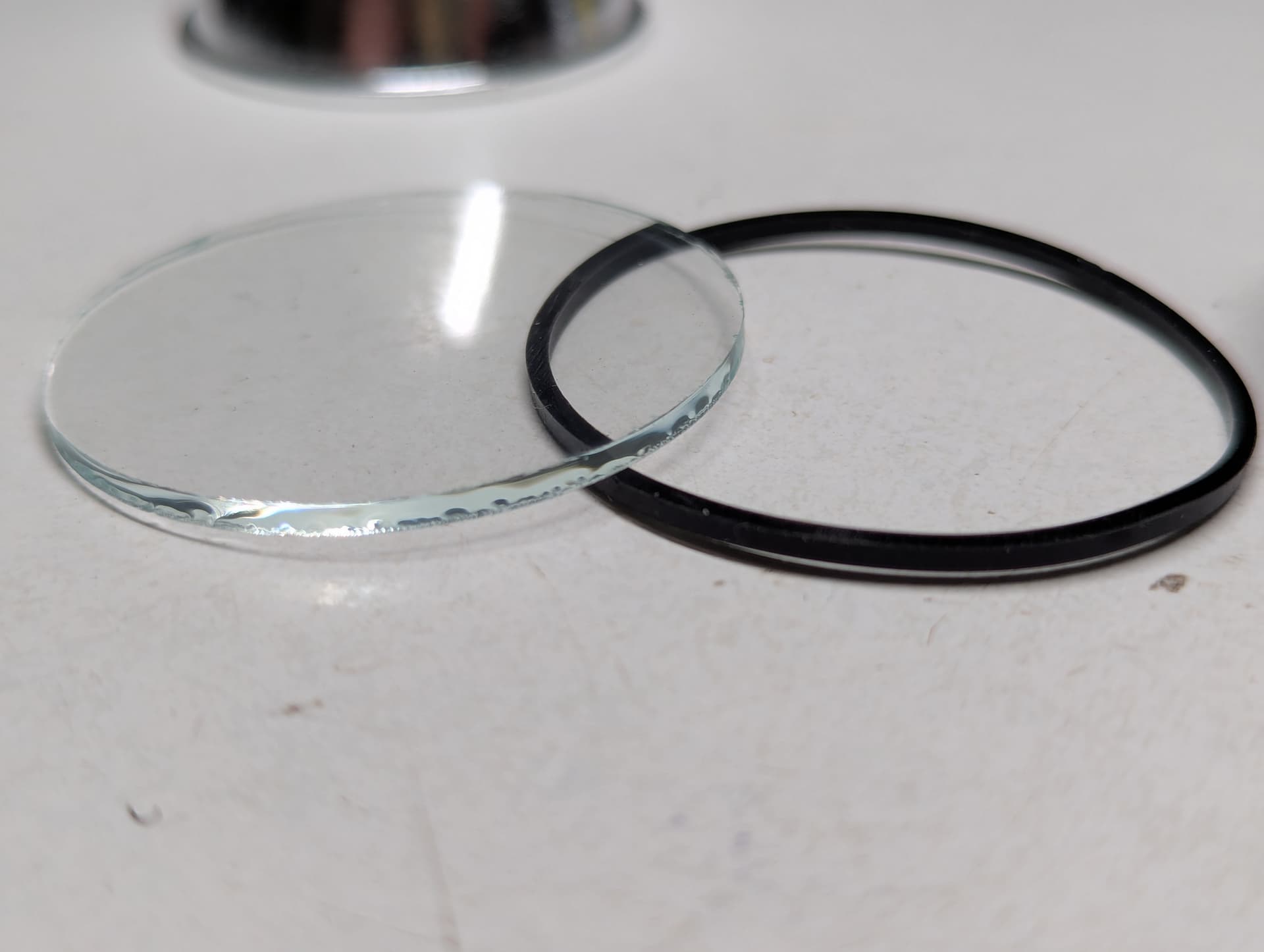

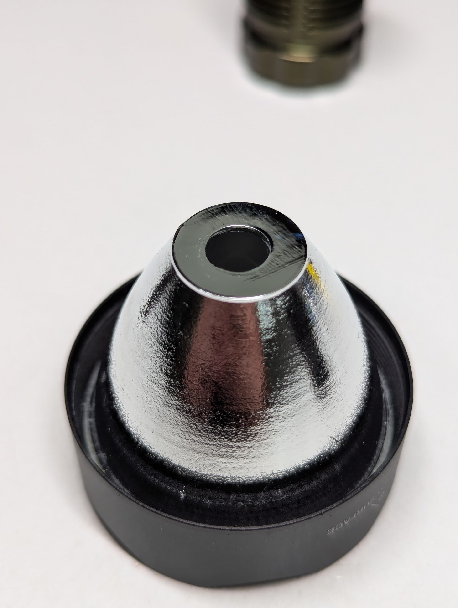

The reflector is made from plastic
THe lens is glass, the O-Ring is square

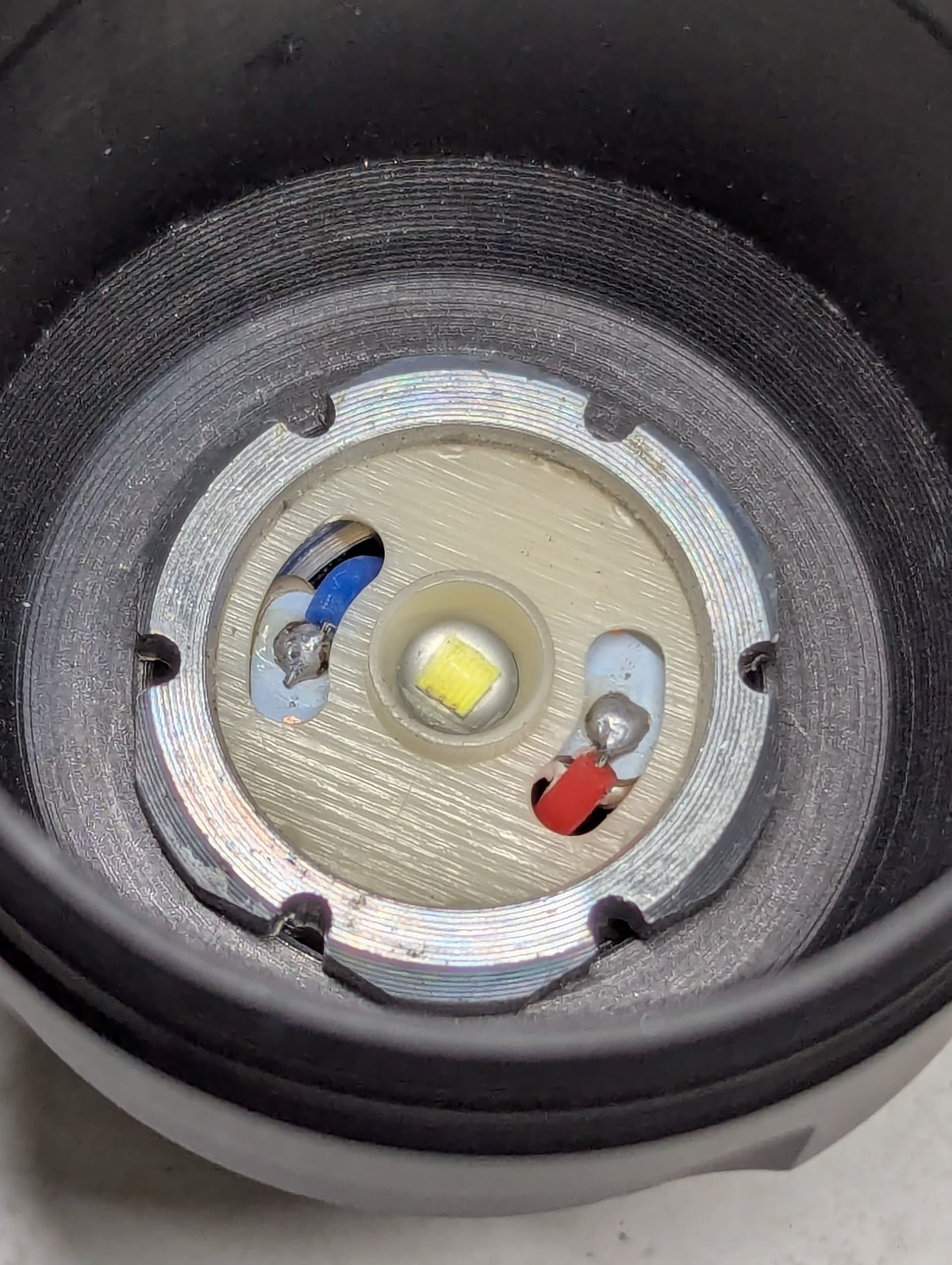

And the mighty LED that I couldn’t get out of the pill

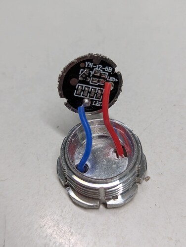

Resistor-Board with 4 1Ohm resistors in parallel and Wifi-Cooling for the LED

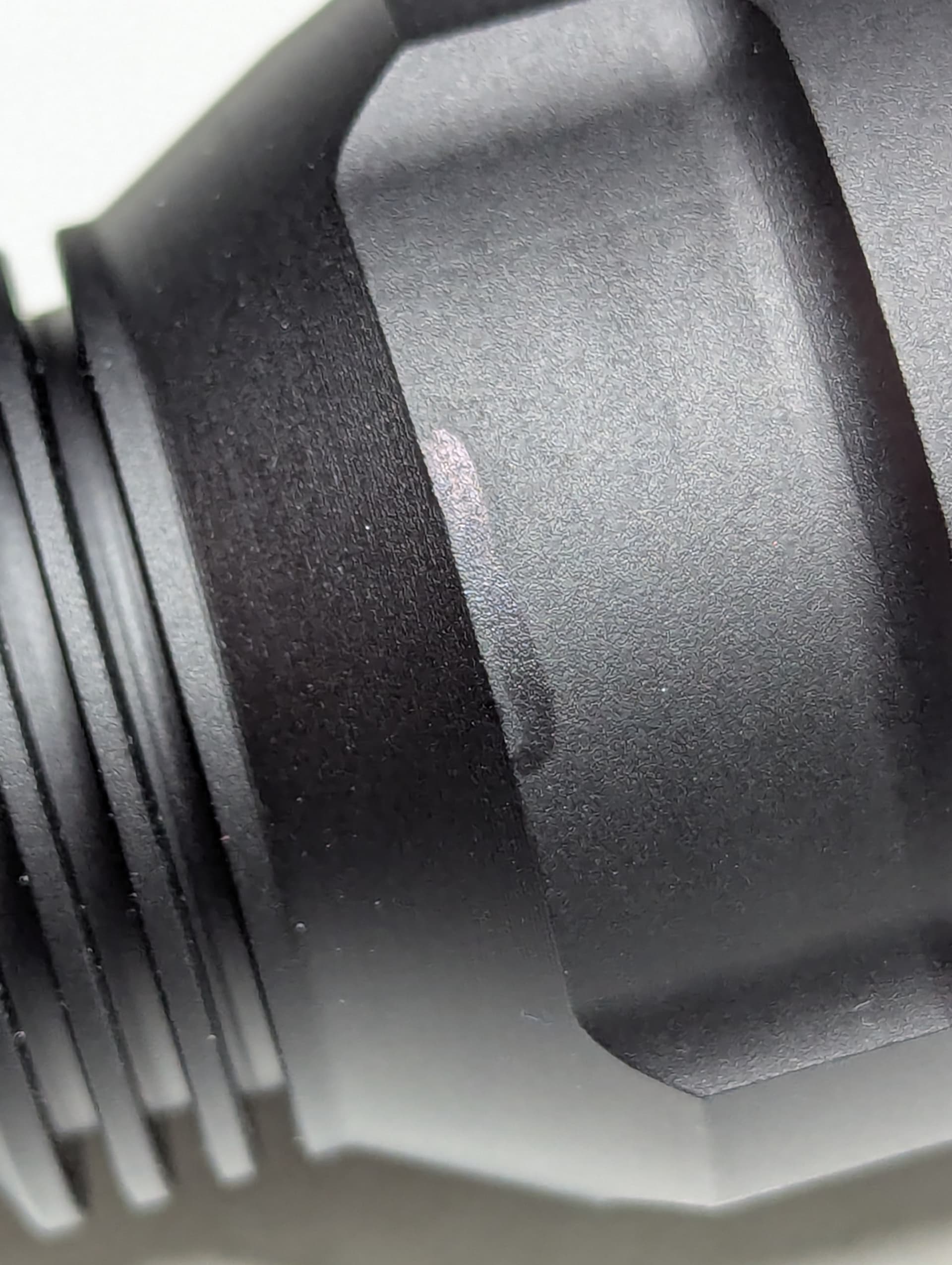

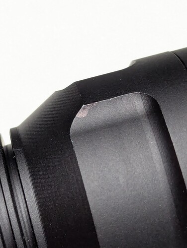

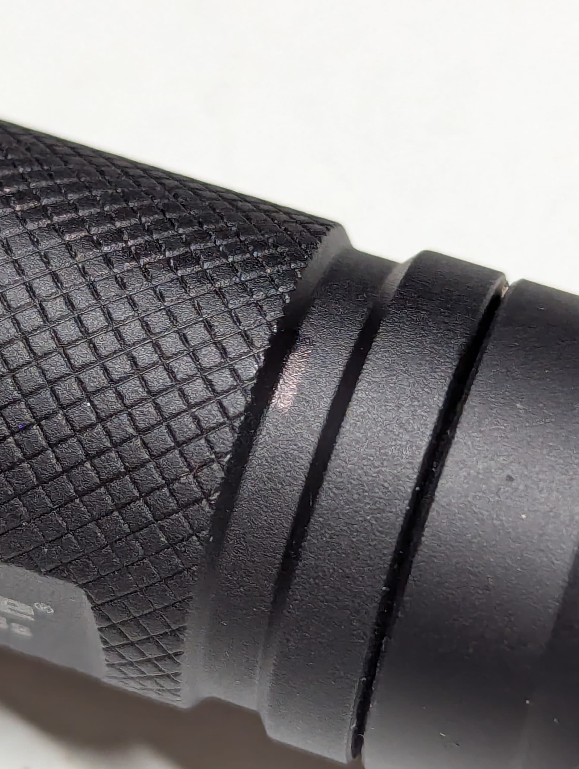

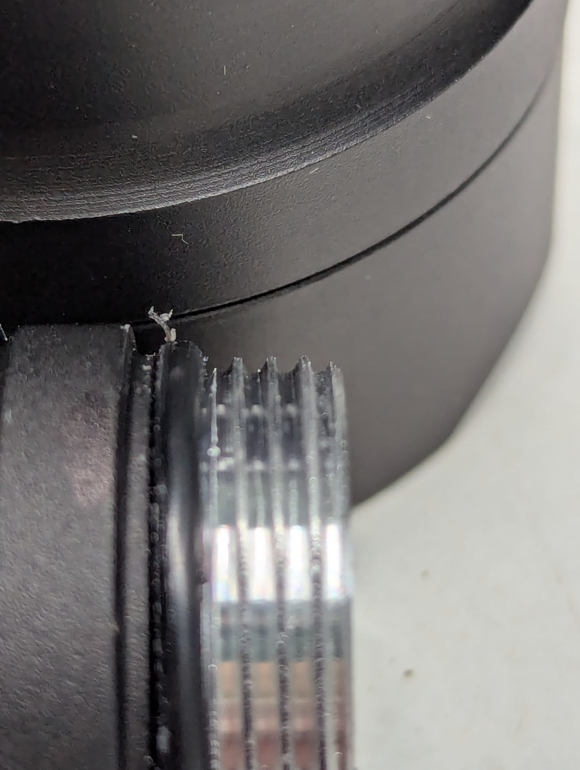

Something that both did and didn’t surprise me - blemishes were “fixed” with permanent marker
It did surprise me because it means there is more QC going on than I expected.

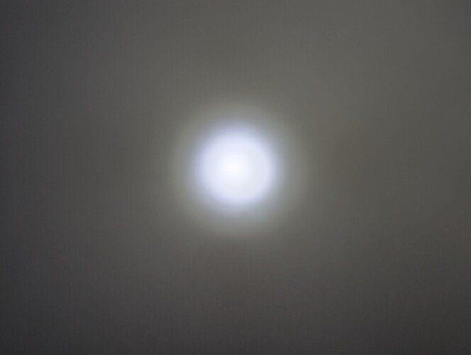

The beam isn’t nearly as bad as I thought it will be. Perfectly usable until the LED dies of heat.
Overall, not good enough for modding, you would need to buy a new reflector, lens, driver and you would have to modify the pill to have the LED cooled.
And then you still have the switch that you can’t replace.

Because I couldn’t sleep last night and I was a bit bored, I decided to take out the pill and remove the LED from it:
Clearly visible is the completely hollow pill and the unusual gasket. What surprised me was that the extremely thin MCPCB the LED was soldered on, had an identically shaped thicker aluminium disc underneath it, with thermal paste inbetween. But besides that, the contact with the pill would still be very minimal.

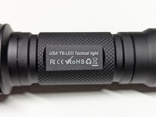

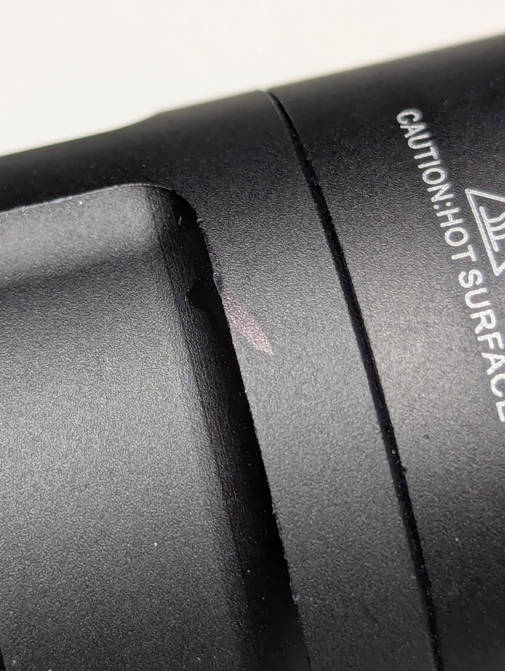

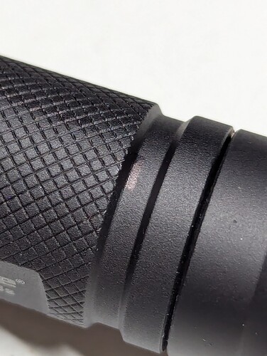

By the way, my sample had the exact same issue you mentioned:
I have to say that I only noticed it after you mentioned/showed it here in this topic. I probably stopped paying attention the moment I realized it was yet another “useless” cheap C8! :joy:
