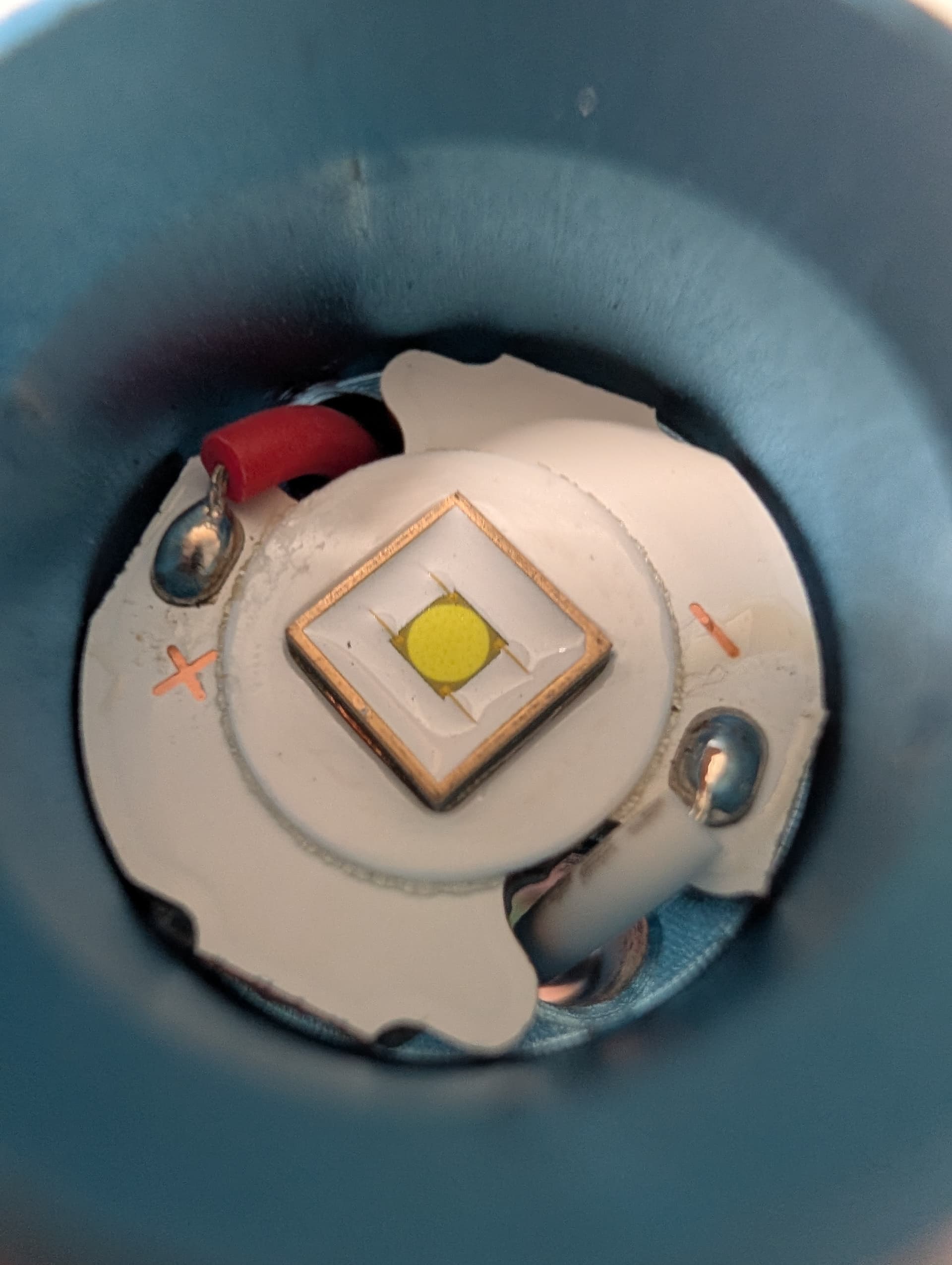

Switch feels a bit too cheap, UI is bad, LED on normal 20mm Star, 20mm Driver.
Put in a 5000K SST40 and a 5A driver.
The reflector does not work well with LHP531 or XHP50.3 Hi.

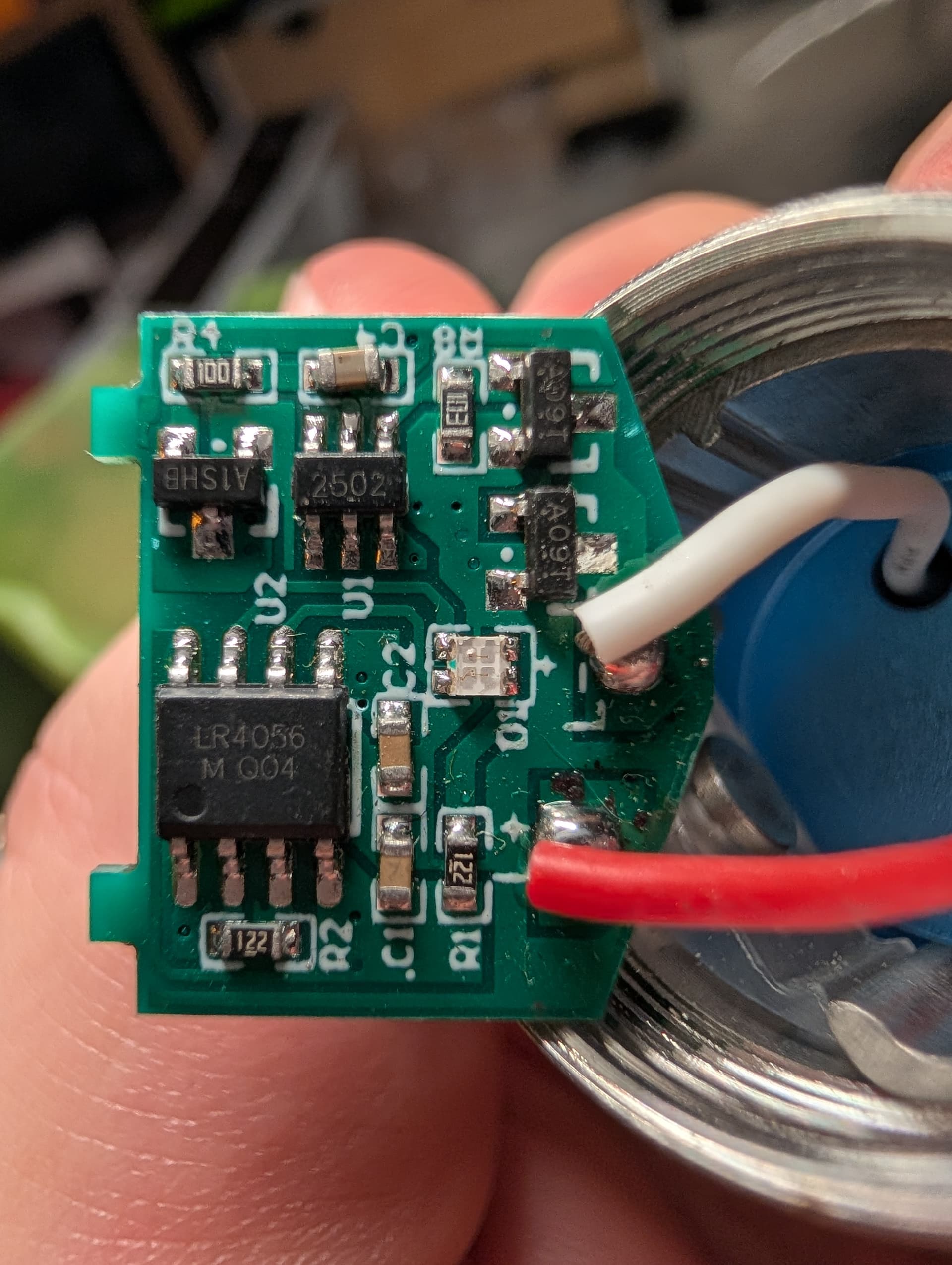

The suspiciously light cell that came with it has a USB-C port built in, but only measures 500mAh on my tester, instead of the 1000mAh stated on the cell.

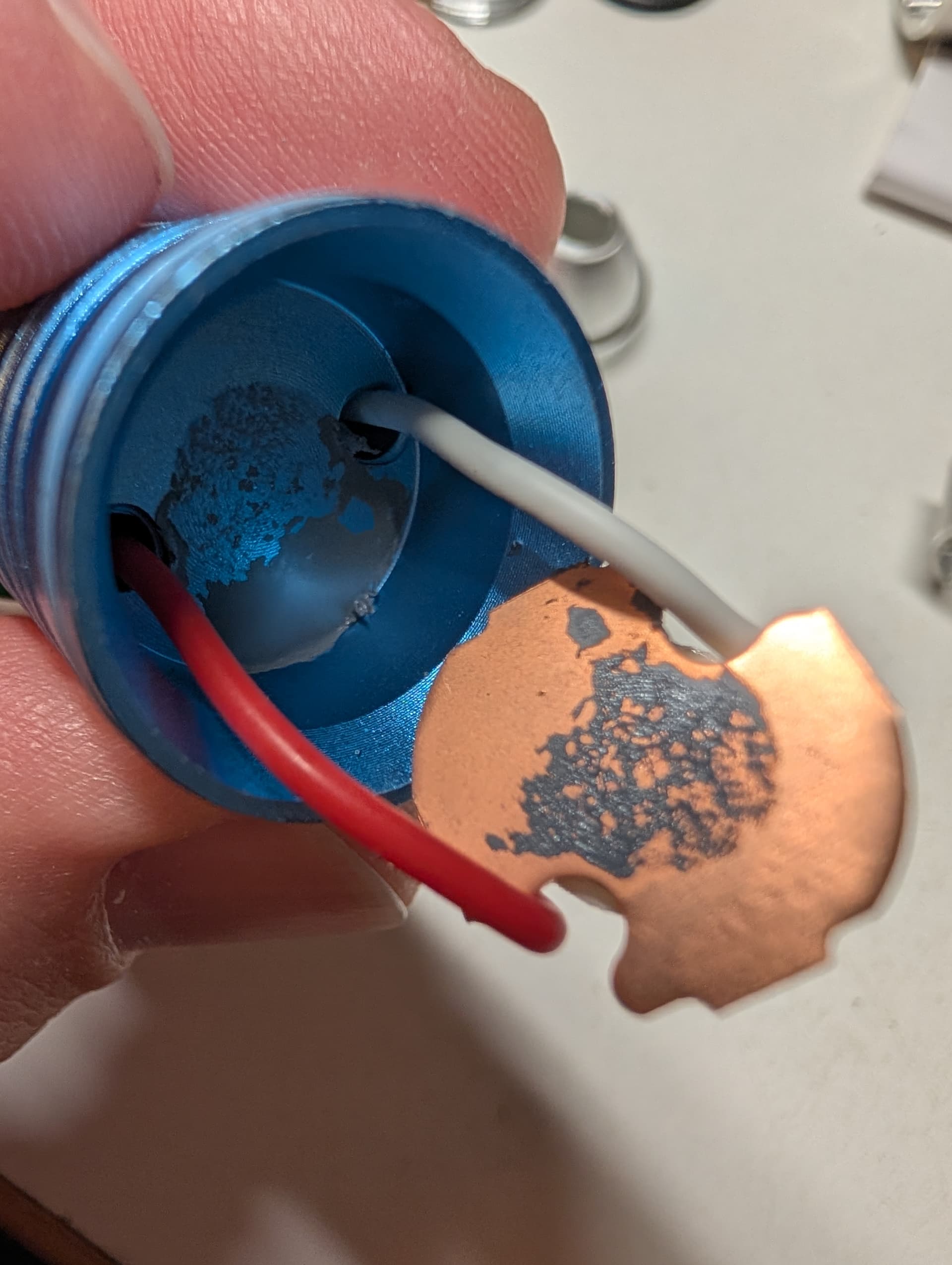

Pill from the back and the attempt to glue it down?
Glass package, Glass is 40mm, reflector is aluminum, but very thin
LED on 25mm copper MCPCB, didn’t check if it’s DTP, though…
SST40? Mine look different, silver on the outside.
Notice the anti-spin-pin on the bottom left! You usually don’t see that on other cheap lights.
A chonky boy! All full material!
This reflector also doesn’t work with LHP531 or XHP50.3 Hi, so I put another SST40 5000K in that one.

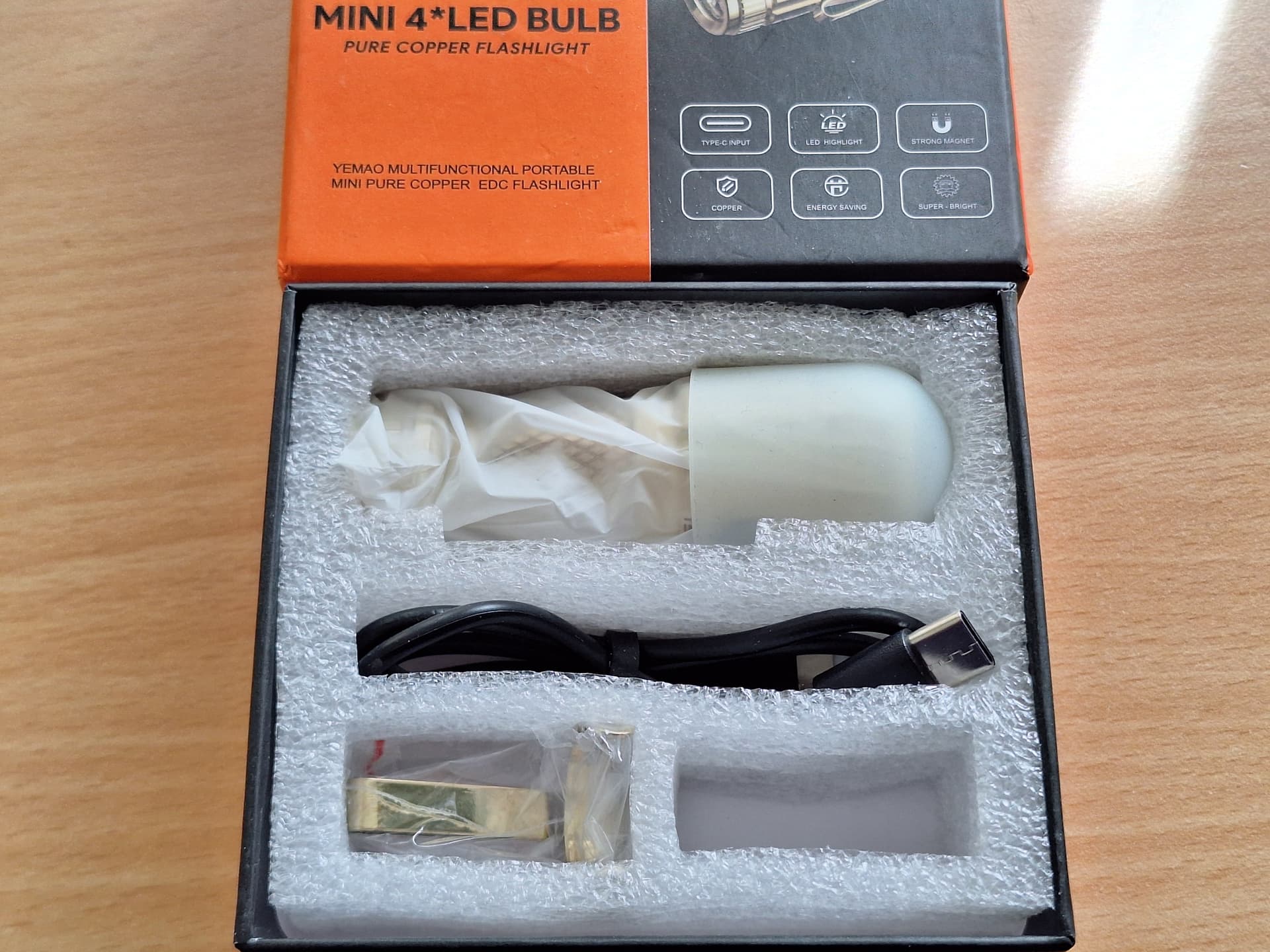

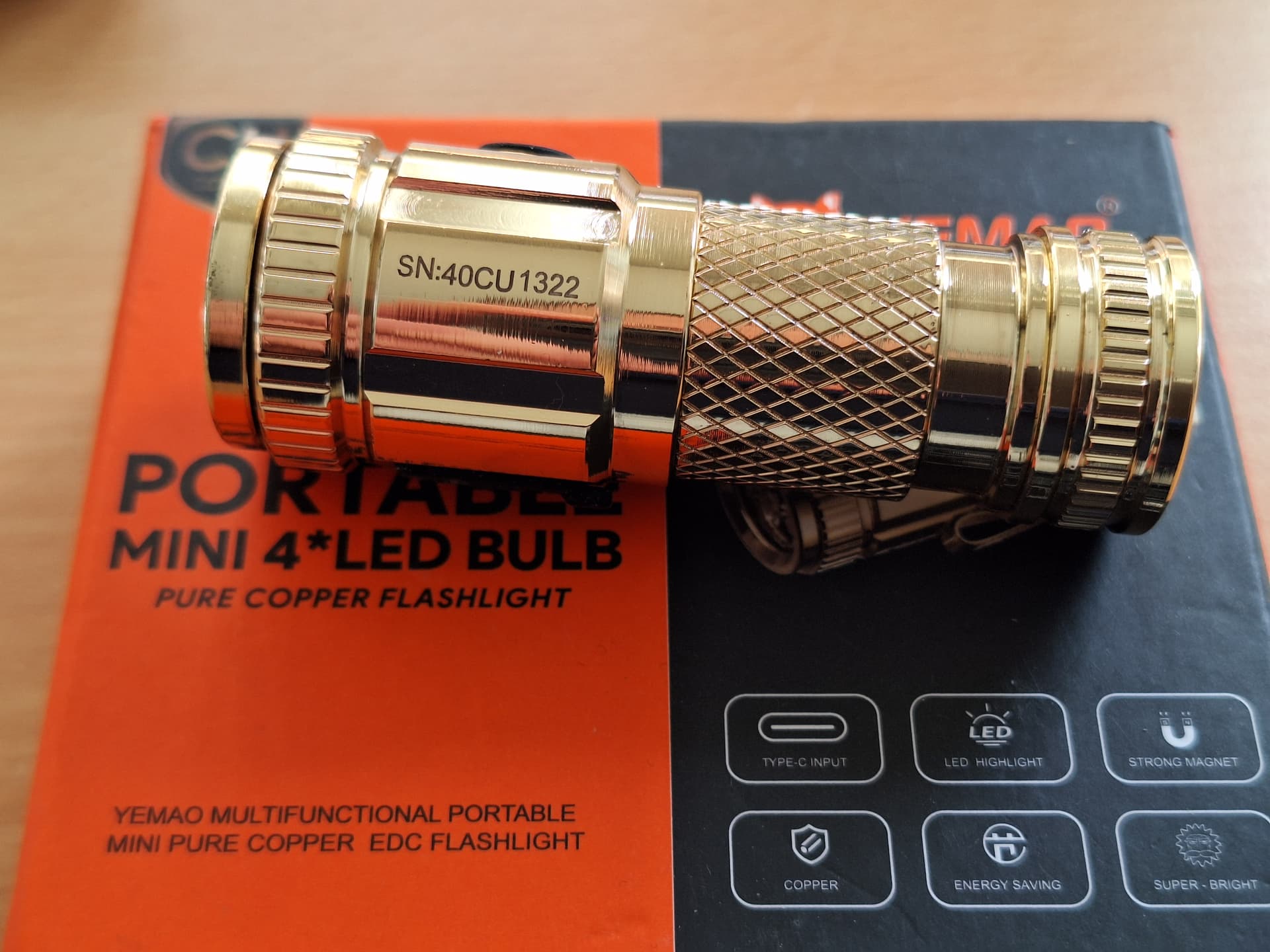

I recieved my Yemao F40CU yesterday and so far I’m positively surprised in several ways, although the UI might turn (some) people off, but more on that at the end of my short “first impressions”.
It came in a nice and sturdy box:
First visual impressions of the light itself; it has a very ‘glossy’ finish, which almost gives me a feeling it might have some sort of clear coat over it, but I’m not completely sure. It has some minor machining marks, but nothing too bad and it’s what you could expect from a “cheap” brass/copper Chinese light at this price point.
It does appear to have a ‘unique’ serial number; I did found a photo in a review on Aliexpress where the SN was visible, and it was a different one than my SN.

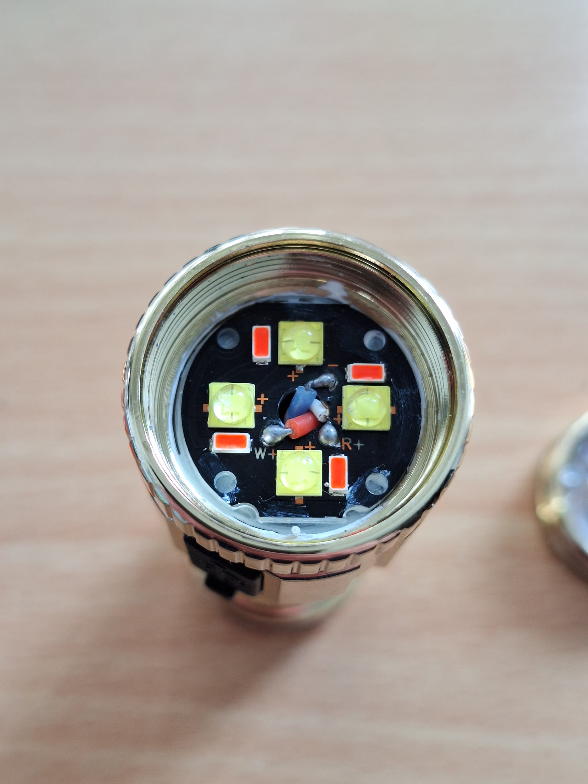

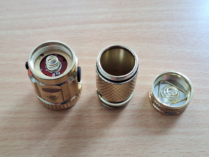

The light is easy to dissasemble and the driver is held in place by a removable retaining ring. The threads on both ends appear to be bare brass/copper, so doing a manual lock out isn’t possible.
The bezel can be removed/unscrewd by hand very easily and there is no glue/threadlocker noticable. Be CAREFULL though, when unscrewing (or tightening) the bezel: the TIR has a tendency to turn with the bezel, which can rotate the hole MCPCB or when the pegs of the TIR are out of the locating holes, they can hit against the side of the LED’s. I would recommend to put downward pressure on the TIR with one finger, when removing or placing the TIR.
Unfortunately there isn’t any glass in front of the TIR though, just a rubber O-ring between it and the bezel.

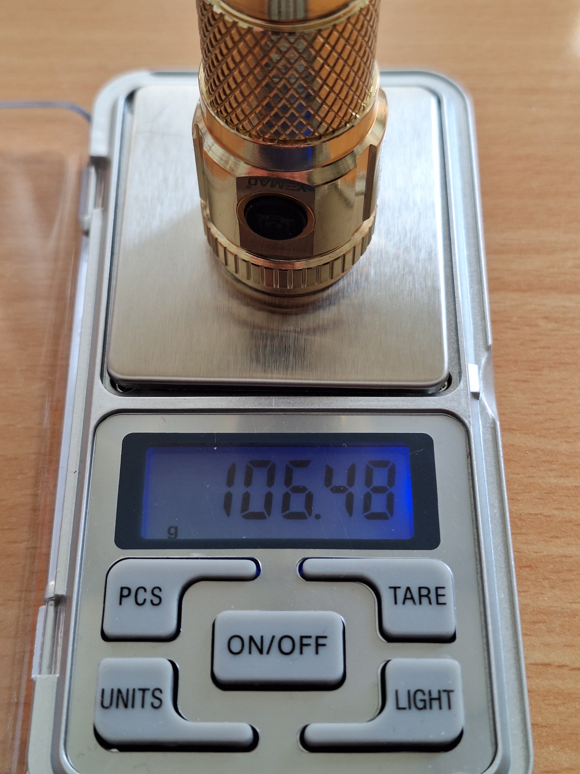

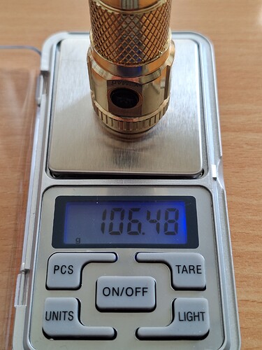

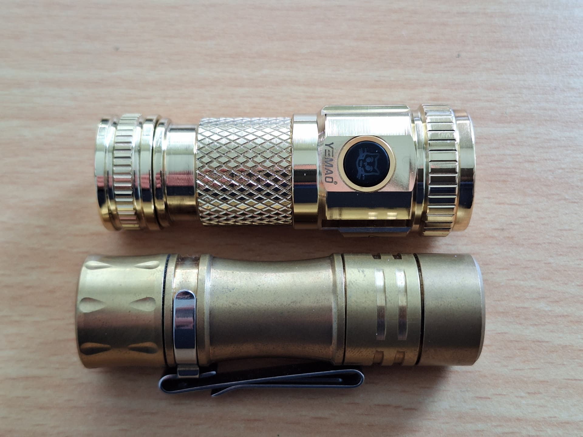

It is a chunky/heavy flashlight though; I compared it to my brass TS10, both without batteries, but the TS10 with a pocket clip on and the F40CU “wins” easily with a good 33 grams more over the brass TS10. The F40CU pocketclip (which I weight afterwards), would ad another 3,60 to it.
In length, they’re almost identical, with the TS10 even being ~2mm longer, but (ofcourse) way less bulky. I’ve added a photo below, to show the size comparison.

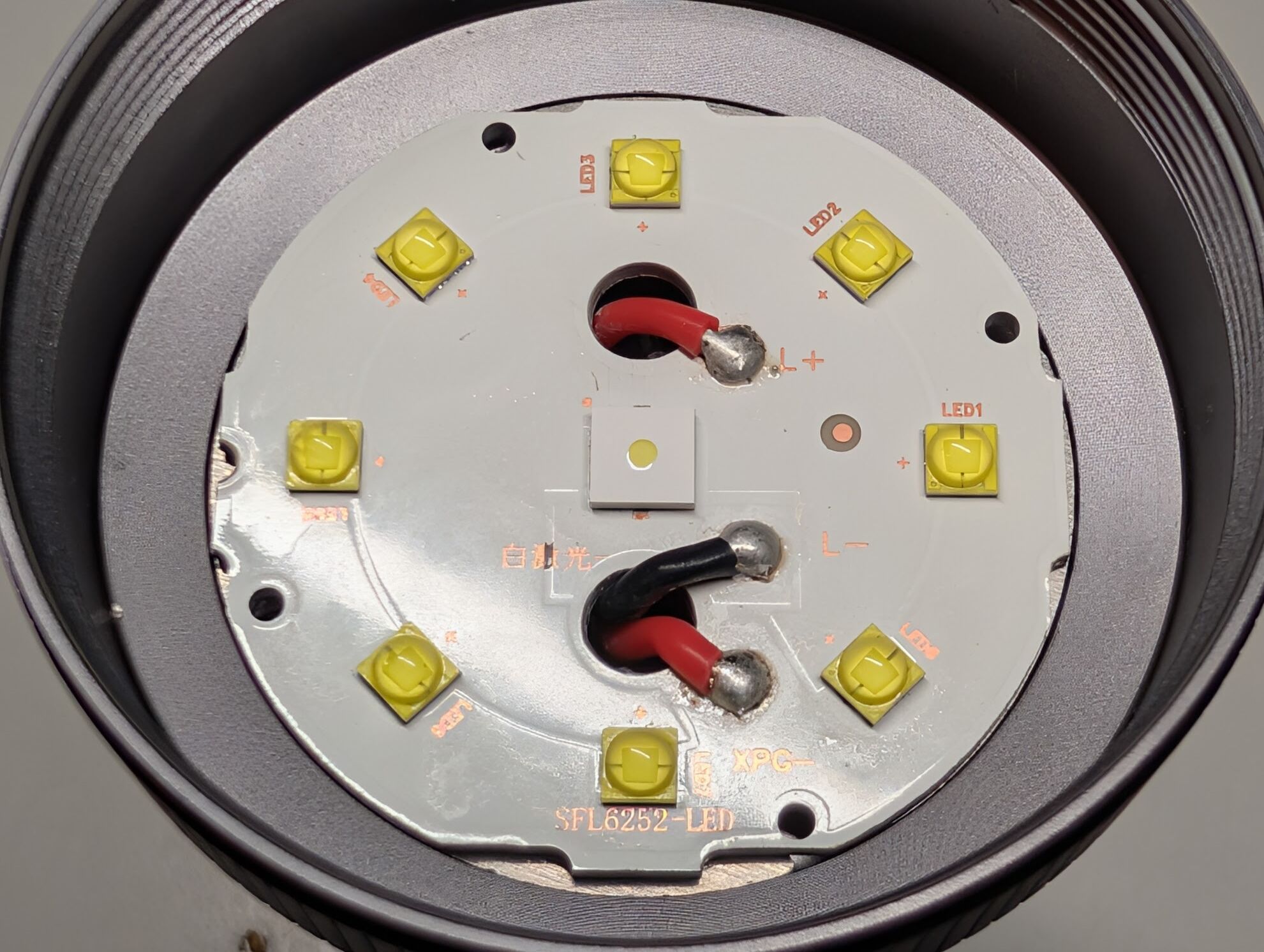

I have this Yemao: YEMAO F81X 2000LM 8-LED-Taschenlampe – wiederaufladbare Taschenlampe aus Aluminiumlegierung mit magnetischem Schwanz für Camping und Notfall - AliExpress 39
One of the LEDs didn’t work and the 2500mAh Battery only has 1200mAh. Got like half of the money back, now it’s an OK price.
Paid $17.31 and got a $7.34 refund (I asked for this amount).
Since I wanted to change the emitters anyway, the dead emitter wasn’t a big deal, but the battery kinda is.

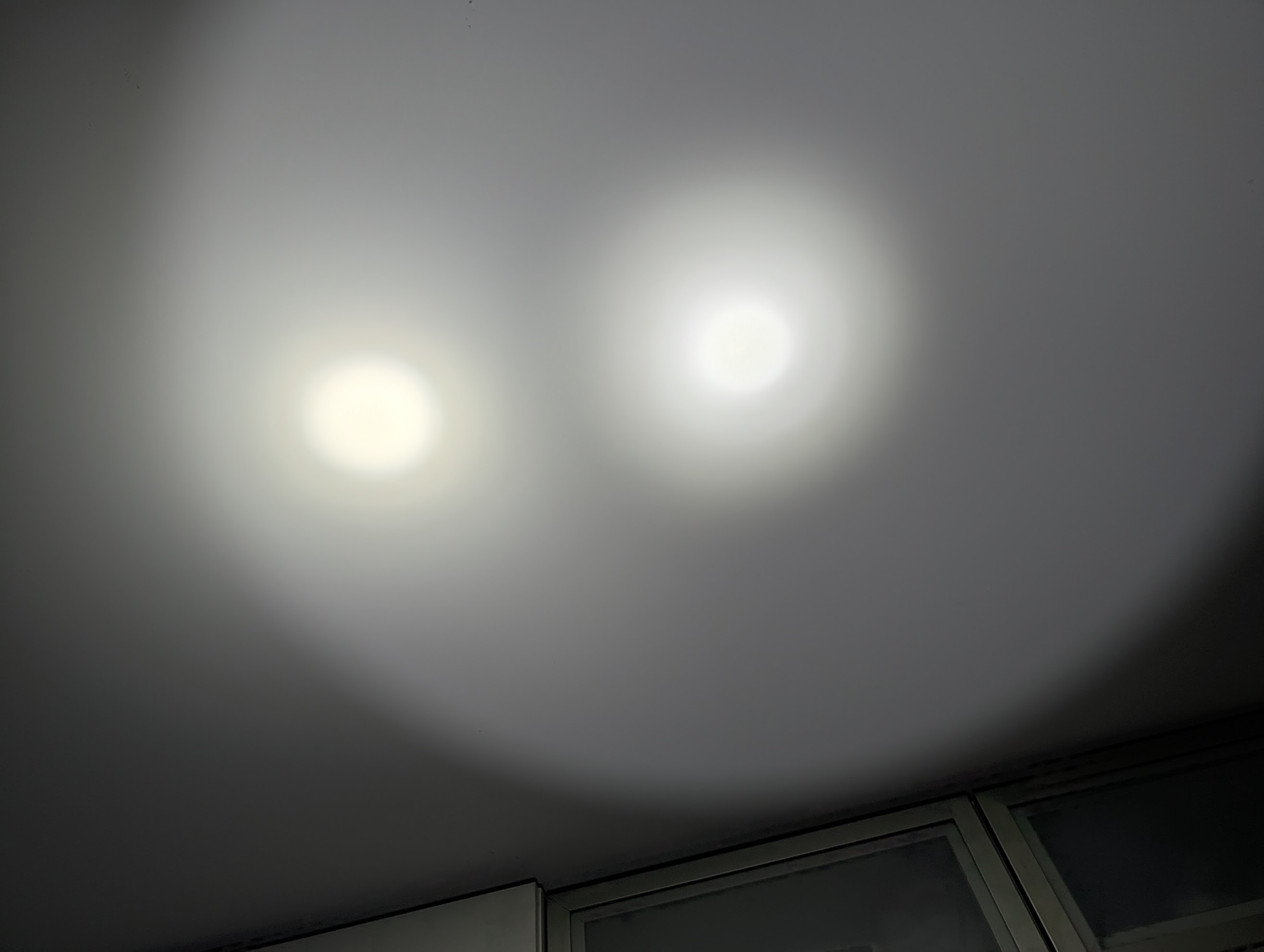

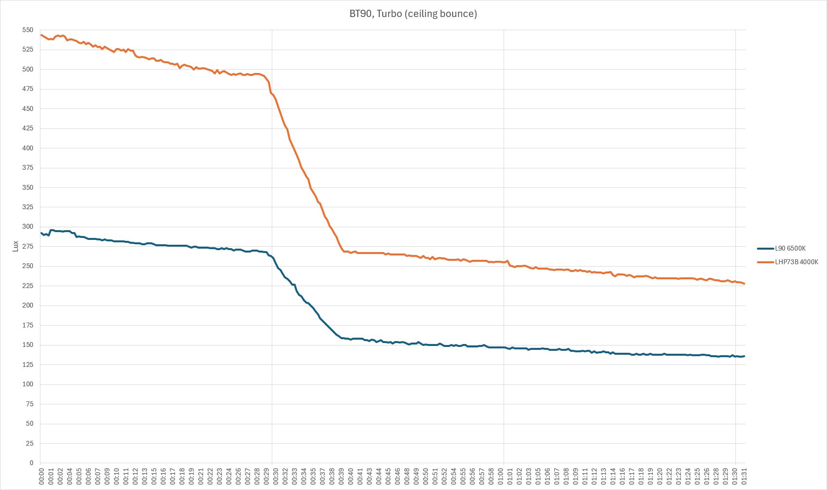

EDIT: Ceiling bounce emitter comparison.

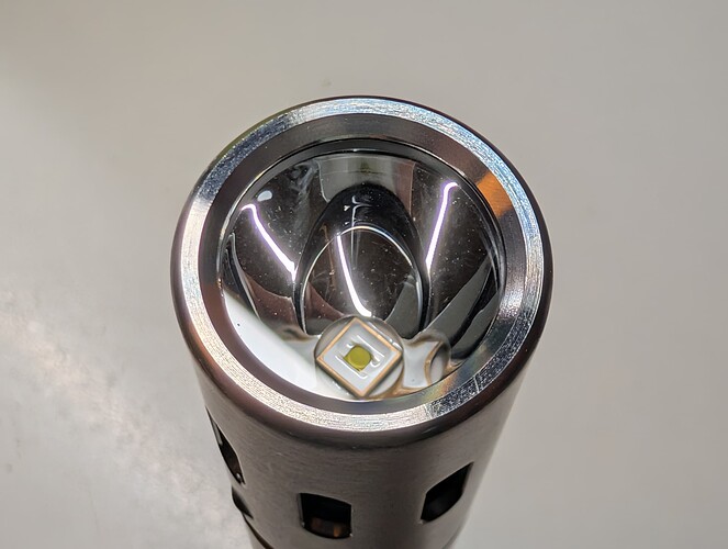

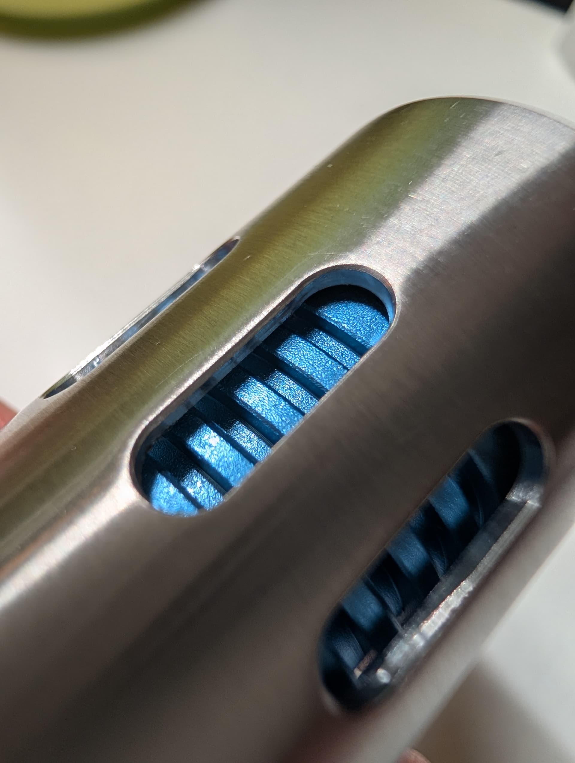

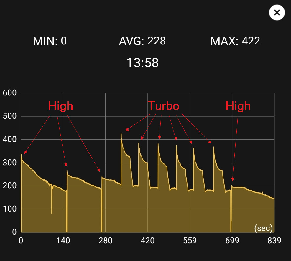

The flashlight doesn’t get hot at all, maybe 40°C, so I suppose the stepdown is timed.
EDIT2: I’m not sure but it seems like the flashlight doesn’t have a thermal protection (or does it ?)
In its defence I can say that with all that high and turbo reactivations surface temperature hardly reached 54°C.

I’ve added the ceiling bounce test results.
I don’t have runtime logs of other modes with the stock (L90 ?) emitter.
In both tests battery used was Sofirn’s 26650 from SP33s, which has surprisingly high IR (45 mOhm) but I’ve got very close to the stock battery tail currents in all modes with it.

A lot of you will have seen the “Philips” branded lights on AE. Out of curiosity and because the price was lowered, I bought one, the “SFL6252”
Price then: $19.10

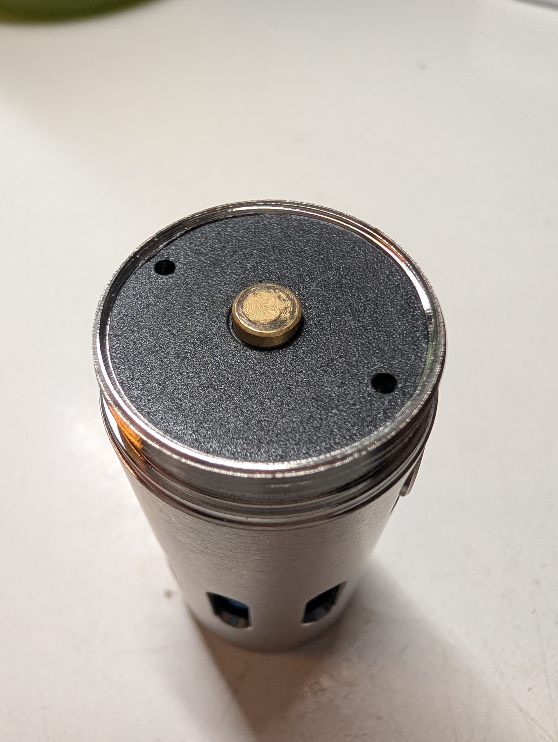

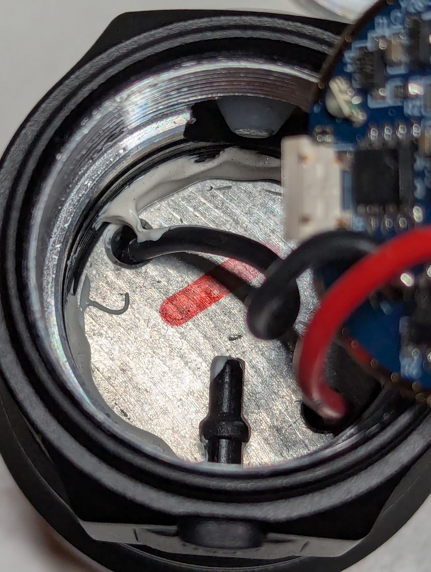

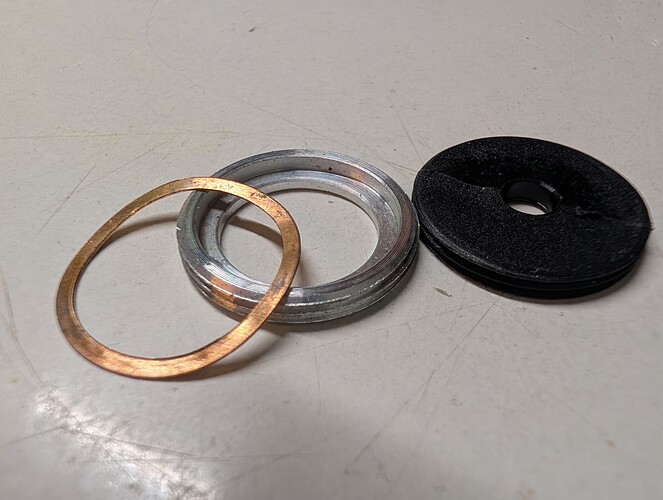

The bezel is glued on lightly, I 3d printed myself a tool to open it. There is no gasket.
Interesting layout

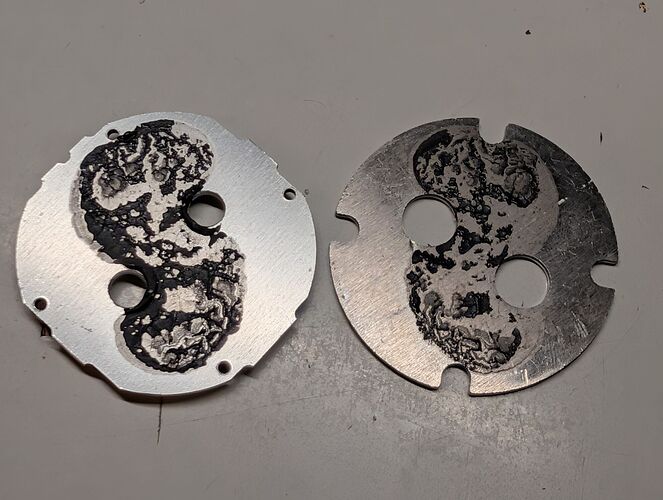

At least some thermal paste, but not on the contact ring to the case
And here it ends, I couldn’t remove the driver without destroying something. The rubber of the switch seems to be too tight in it, I didn’t want to risk damage.
Pretty much bang on. Even though 3Ah is quite low for a 21700, at least you get a cell.
The UI is good.
First mode is Flood (8 LEDs outside), and it’s very floody, second is throw (one LED in the middle), third is both combined.
In all modes, you can hold the switch to ramp up and down, it blinks twice at each top/bottom, then continues to ramp up/down again.
Double click from off or on goes to strobe, double click again goes to SOS. One click at any time goes to off.
I really like this light. I already changed the 5050 LED in the center to a FFL505A 6500K 95CRI one from Firefly and ordered 8 Nichia 219 5700K for the outside emitters.

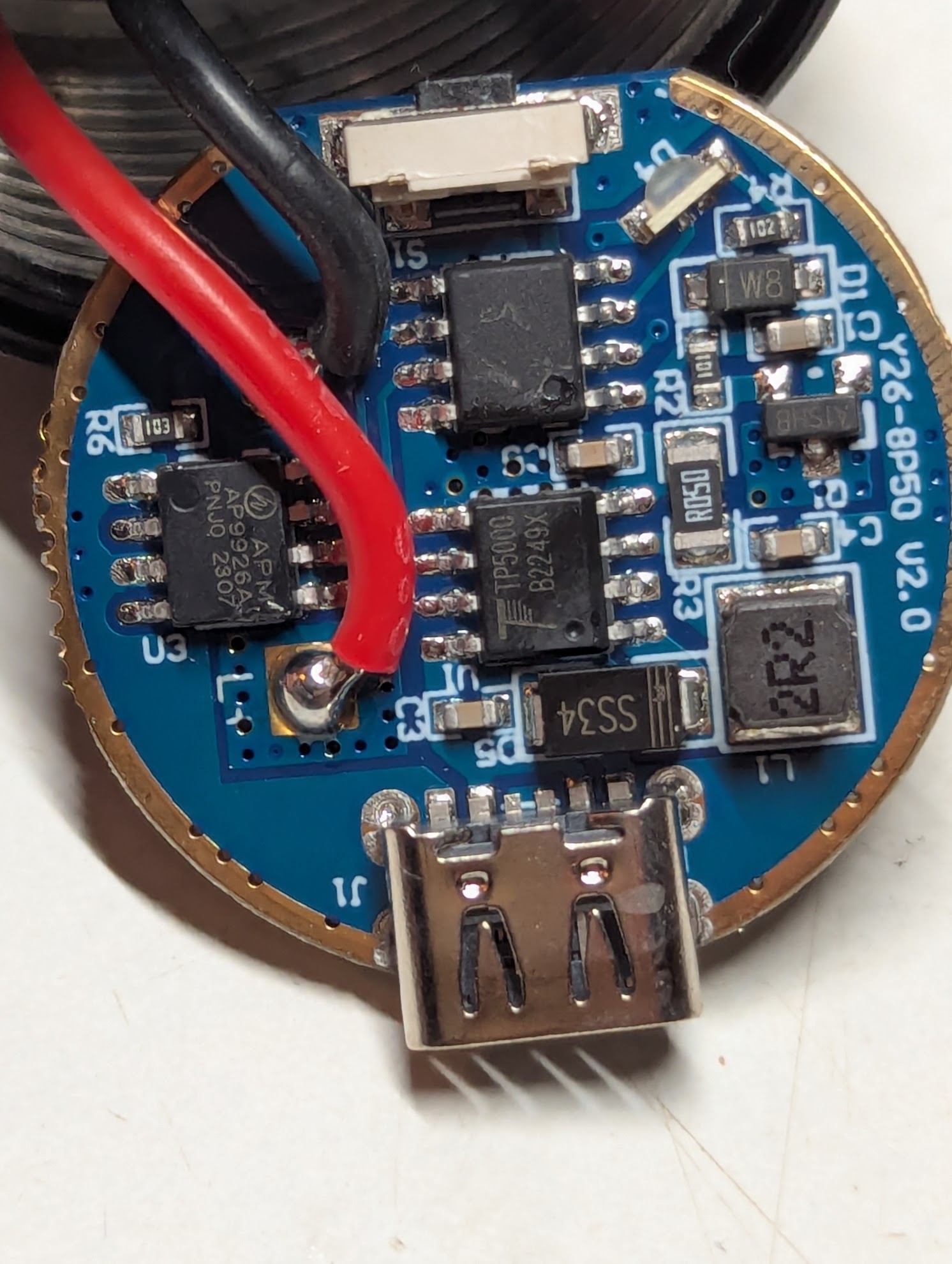

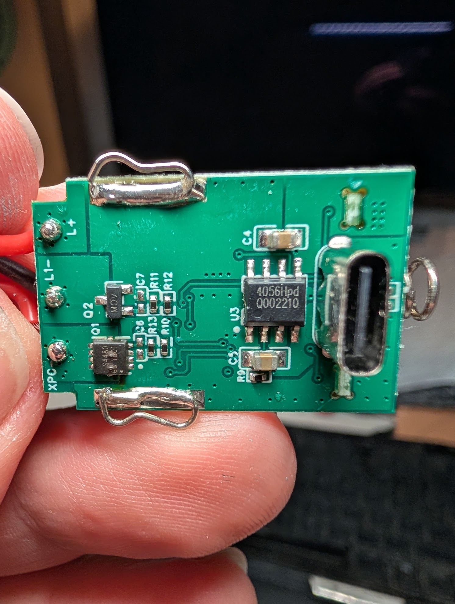

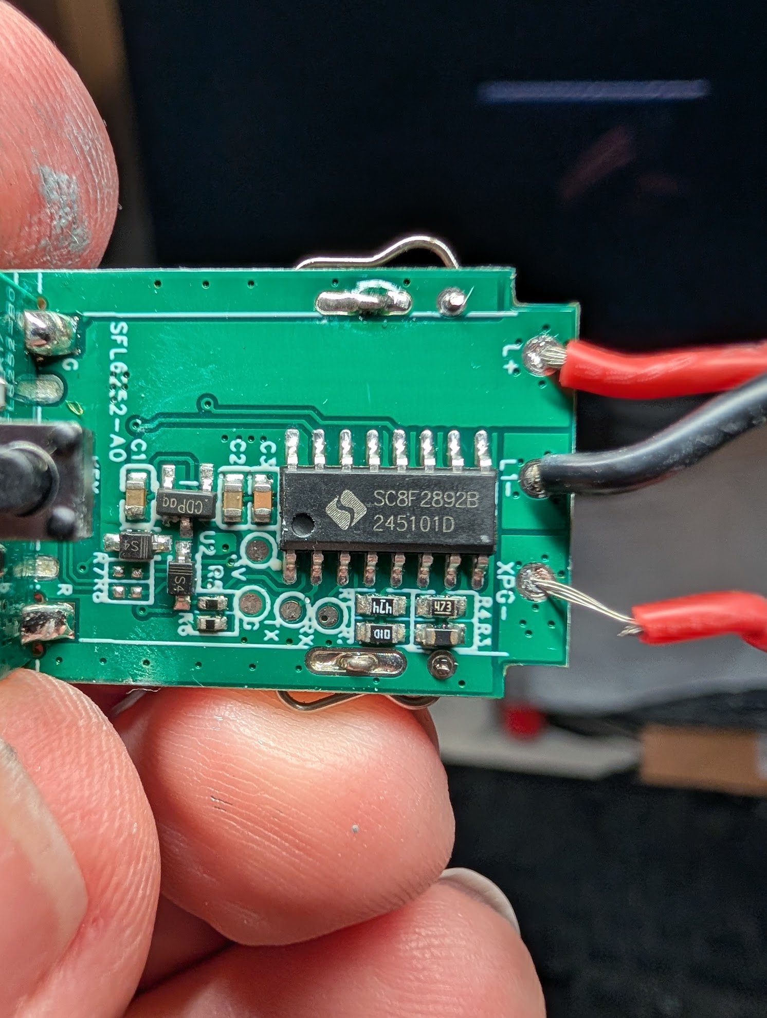

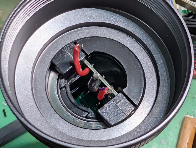

OK, here are pics from the driver of the Philips light.

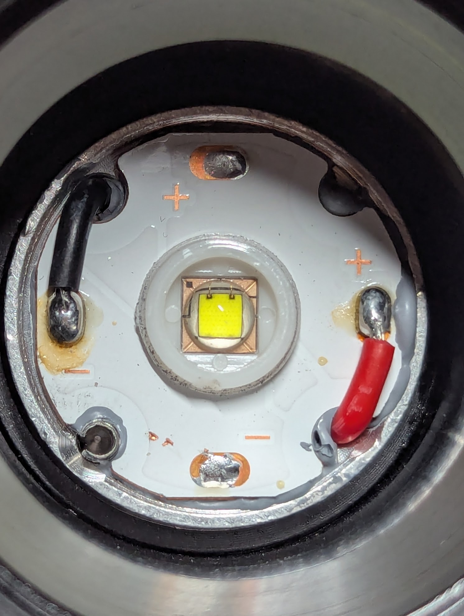

Changed the 3535 LEDs today and fried the driver Mosfet. Luckily not the main chip, so I can probably repair it.

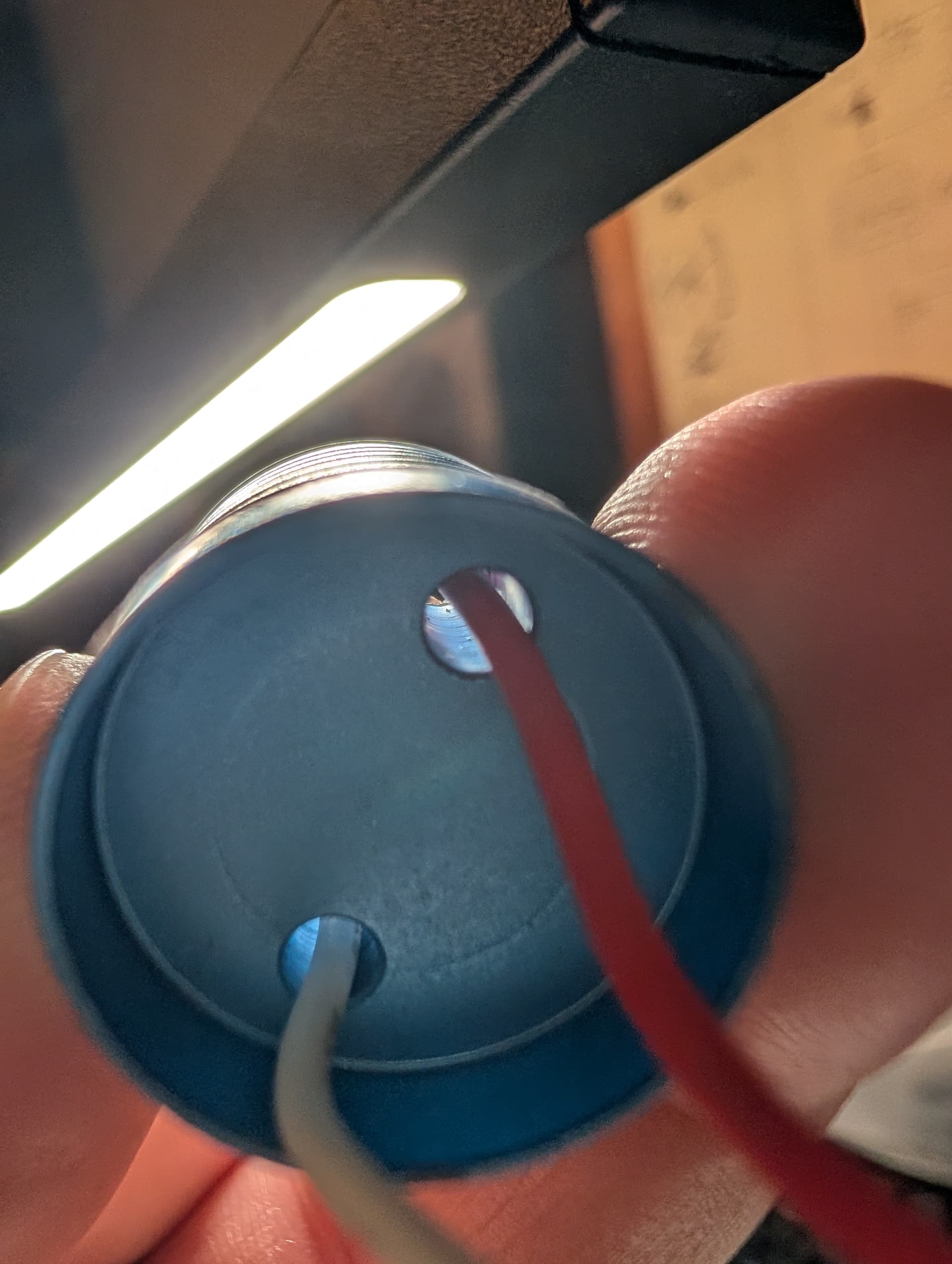

THe two springy-things on the side are the negative-contact to the body.
The failure occured because the optics spun while I fastened the bezel, so the wires spun and ripped, as you can see. Probably made contact somewhere.

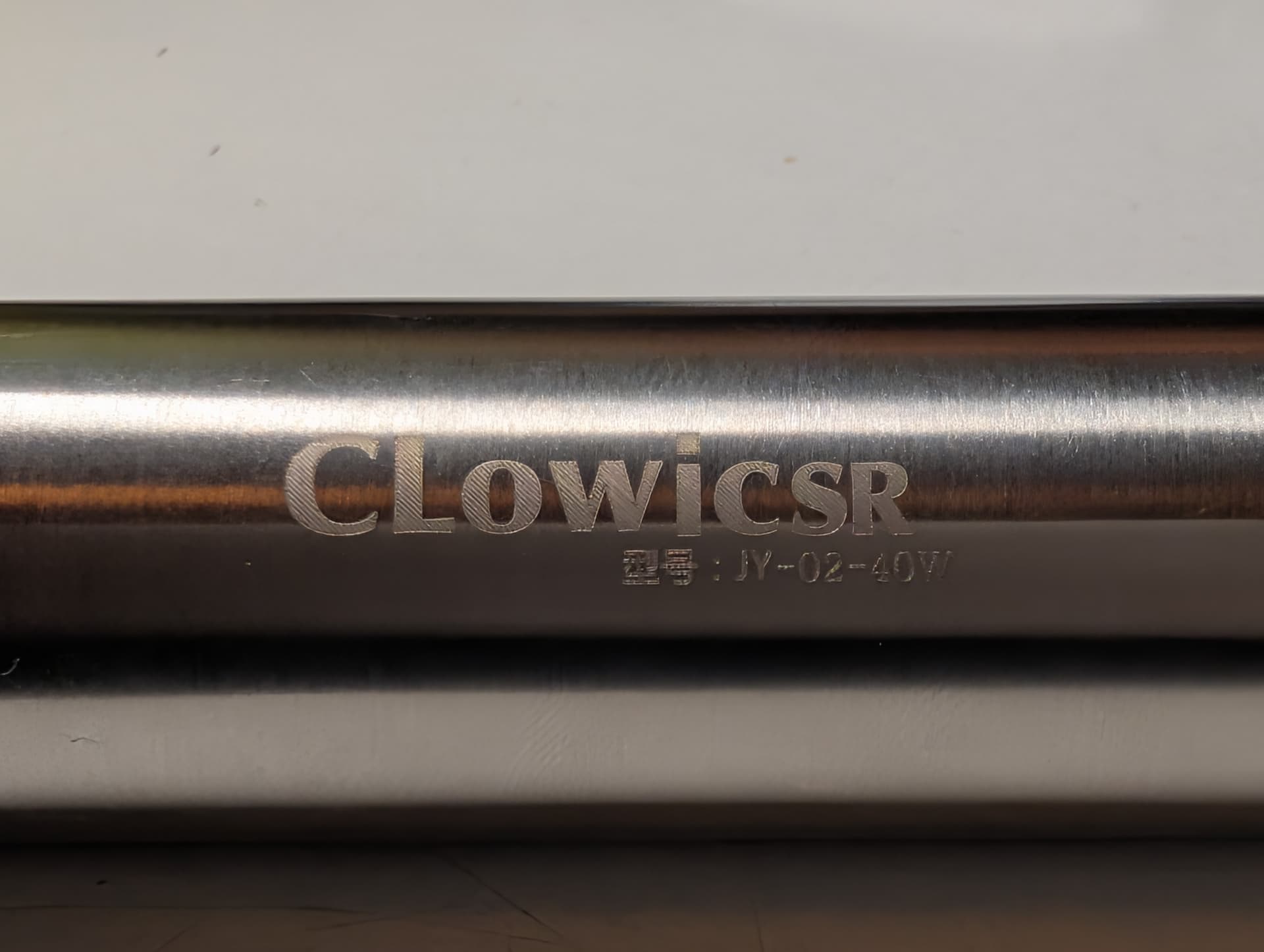

One of those names that just roll of the tongue…
If you say the “wicsr” part in german, it’s “Wanker” in english… and “Clo” sounds like “Klo” which is toilet in english, so it’s a flashlight by “toilet wanker”

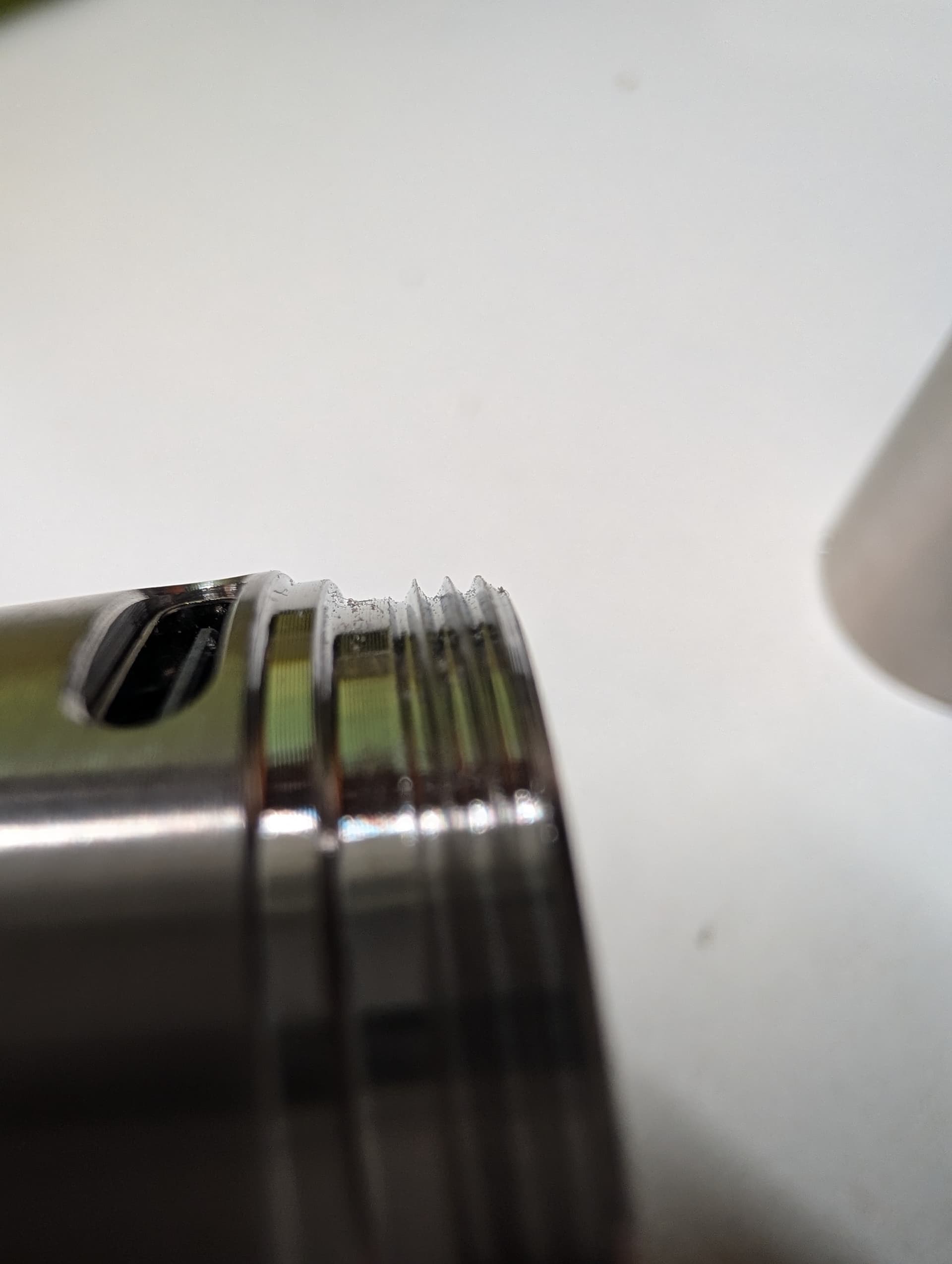

A little burr, other than that the finish is nice

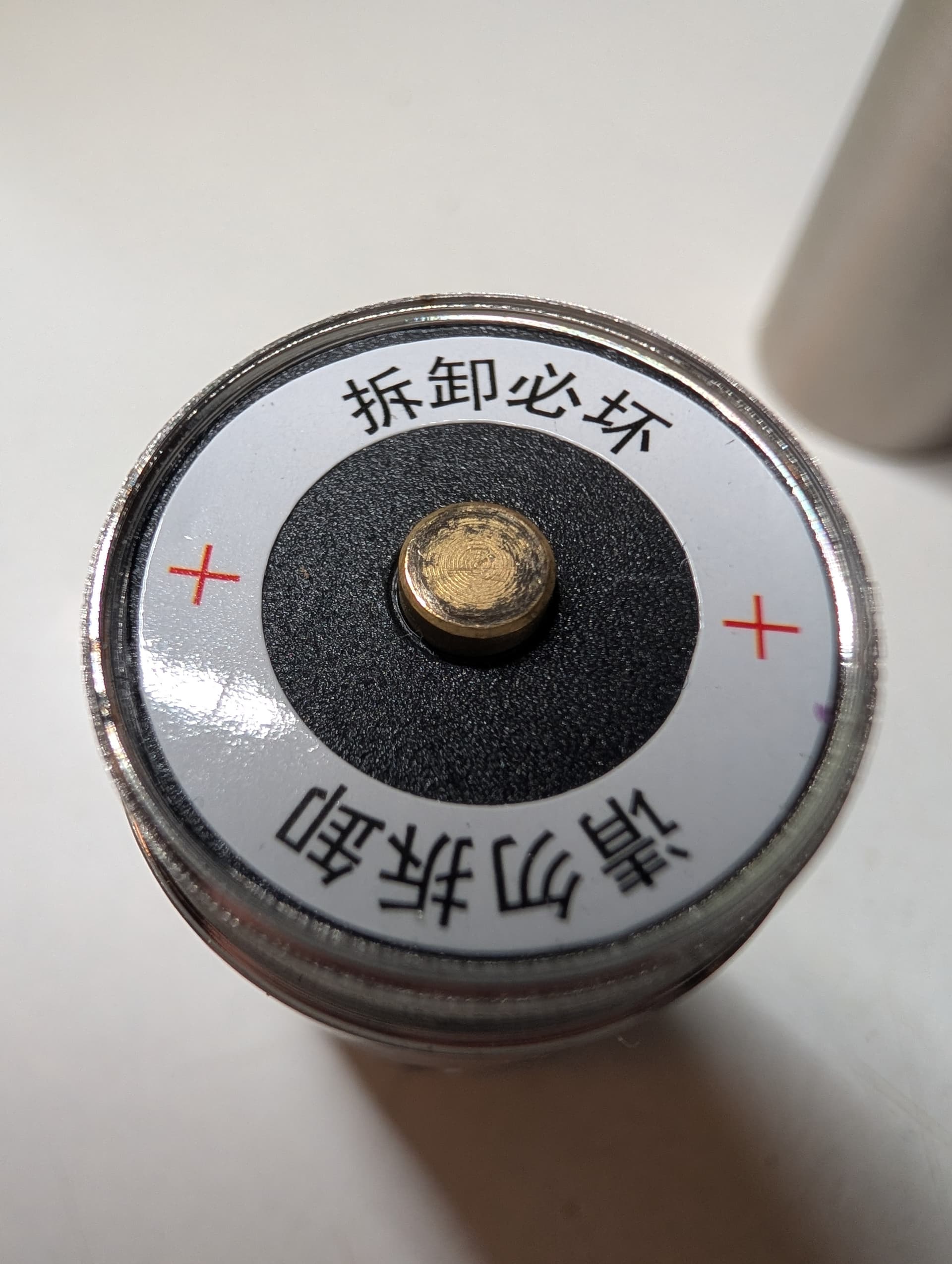

Normal threads that need lubrification. No O-Ring, the whole thing is not made for water contact.
This means something on the line of “Stay out, you will destroy it”
But I ignored it, true to the motto “I’m a sign, not a cop”

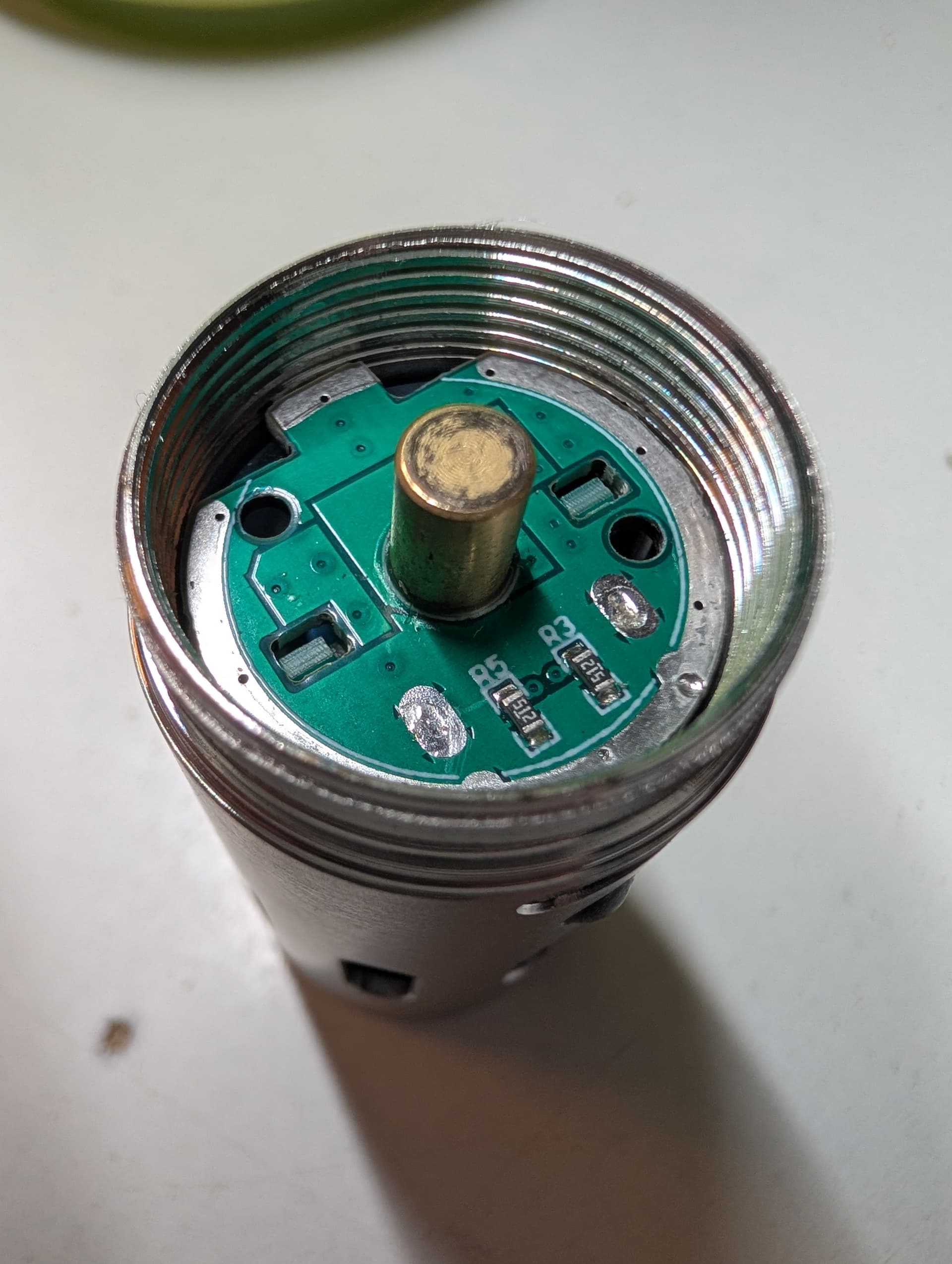

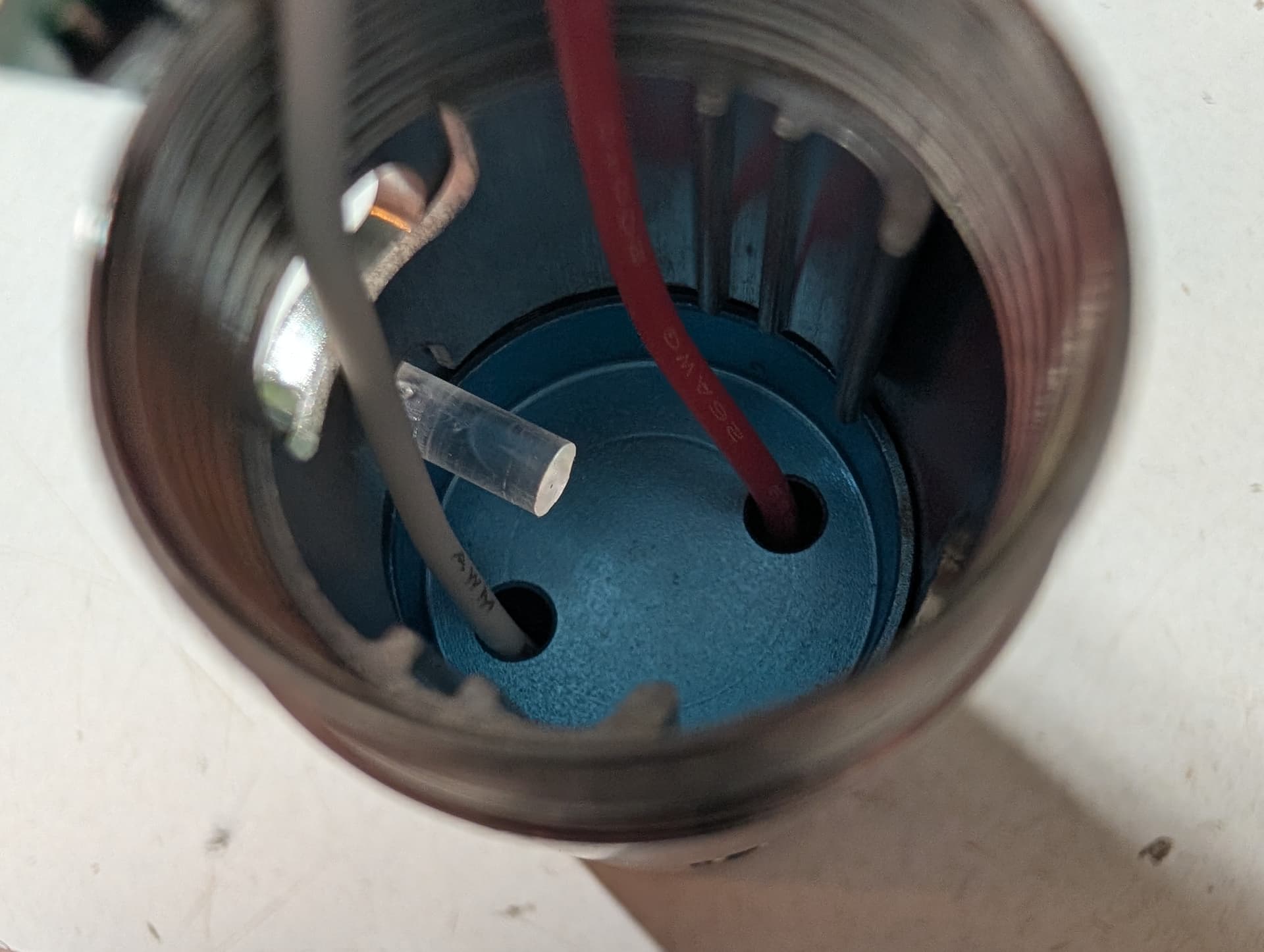

This plastic part is just screwed in, normal thread.
THen it begins to look like usual
The acrylic pin can be pushed out from the inside
The LED again, on a 16mm copper MCPCB with a protection ring so that the reflector doesn’t touch the traces

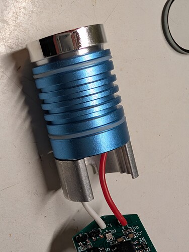

I would be perfectly fine with sacrificing the onboard charging, as long as I manage to find a driver (with a side switch) that could be able to make work in this light.

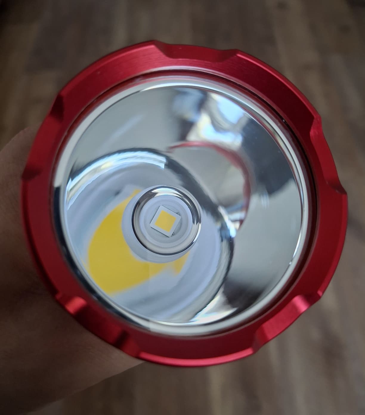

By the looks of it a aluminum/aluminium reflector? (It happens too often that I find ‘plastic’ reflectors in those random Chinese lights…)
Nice, that the shelve has a lot of mass; should help a lot with heat dissipation!
All in all it has several possitive points that could make it an interesting host, but that all depends if you could source a fitting replacement driver.
Also, the price is also an important factor to determine if it’s worth using it as a host. What did you pay for it in the end? The links I’ve posted earlier are dead now and I could only find one other shop on AE that still offers it, but that asks € 33,- which it makes it a bit expensive for ‘just a host’.
