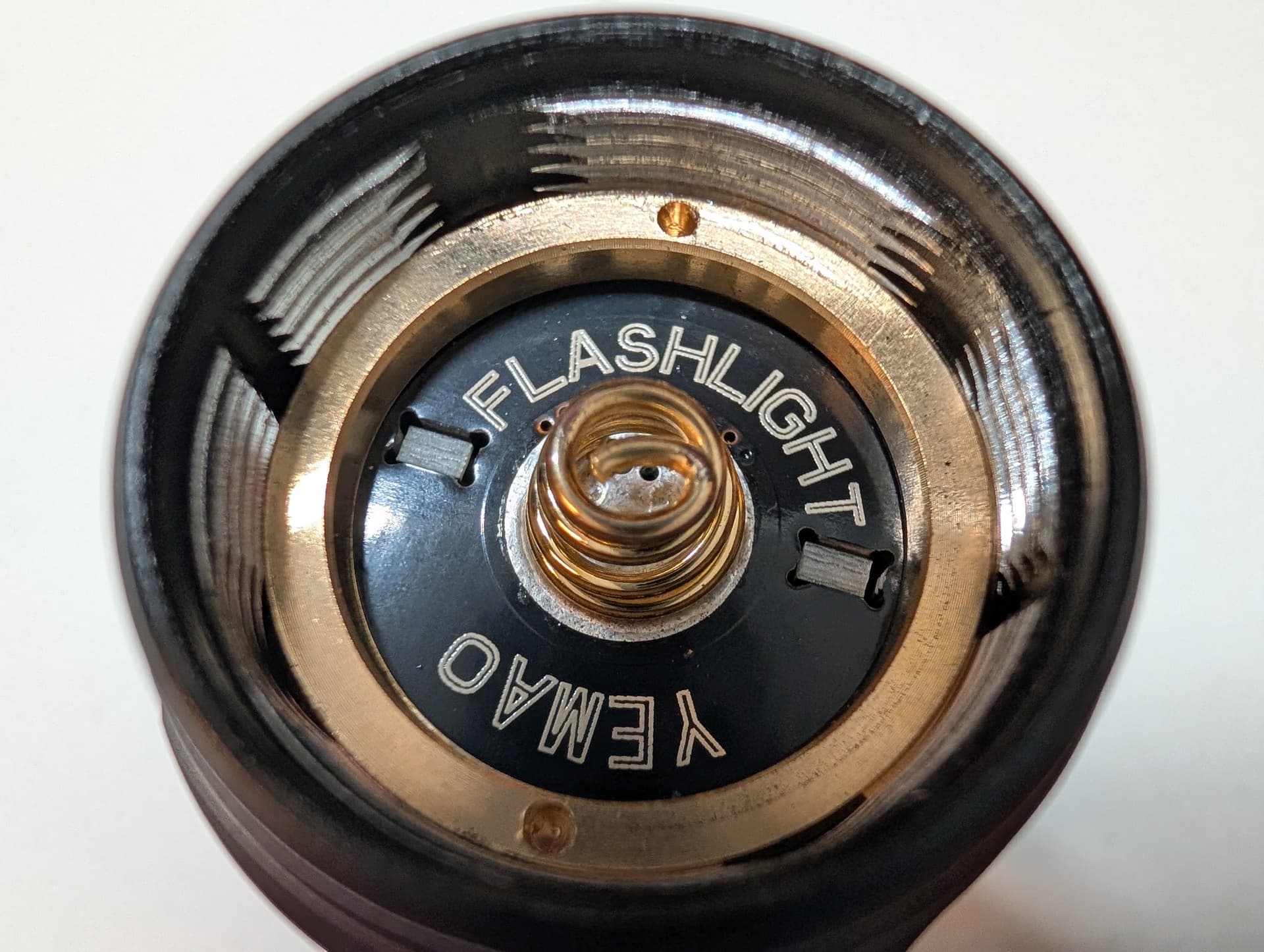

Battery still on test, but the internal resistance is too high for it being a usable cell (~120mOhm) (Edit: Measured 4791mAh)
Also the top is dented quite badly (even though the light has two springs), it has been used before I got it so I don’t expect much capacity.

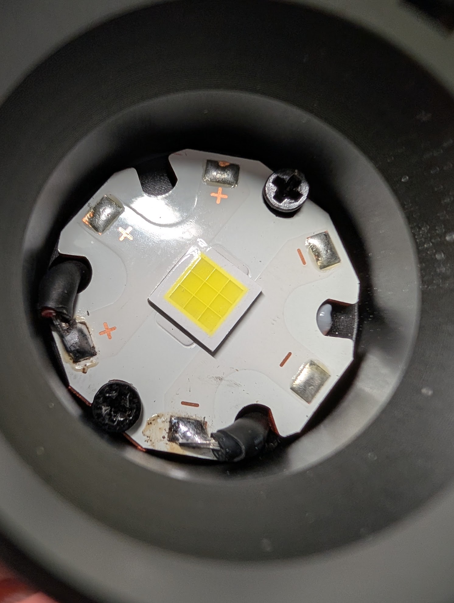

28mm Copper DTP Board with 3V 9-Chip 7070 LED

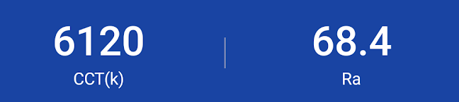

DUV: 0.0048 - It’s a nice cold white, no changes needes except you want a different CCT of course.

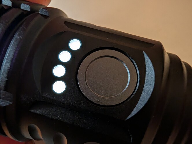

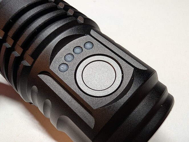

I quite like the switch style, feels and looks so nice!
I love that they used white LEDs for the battery indicator. Had a light or two with blue LEDs that were annoyingly bright.

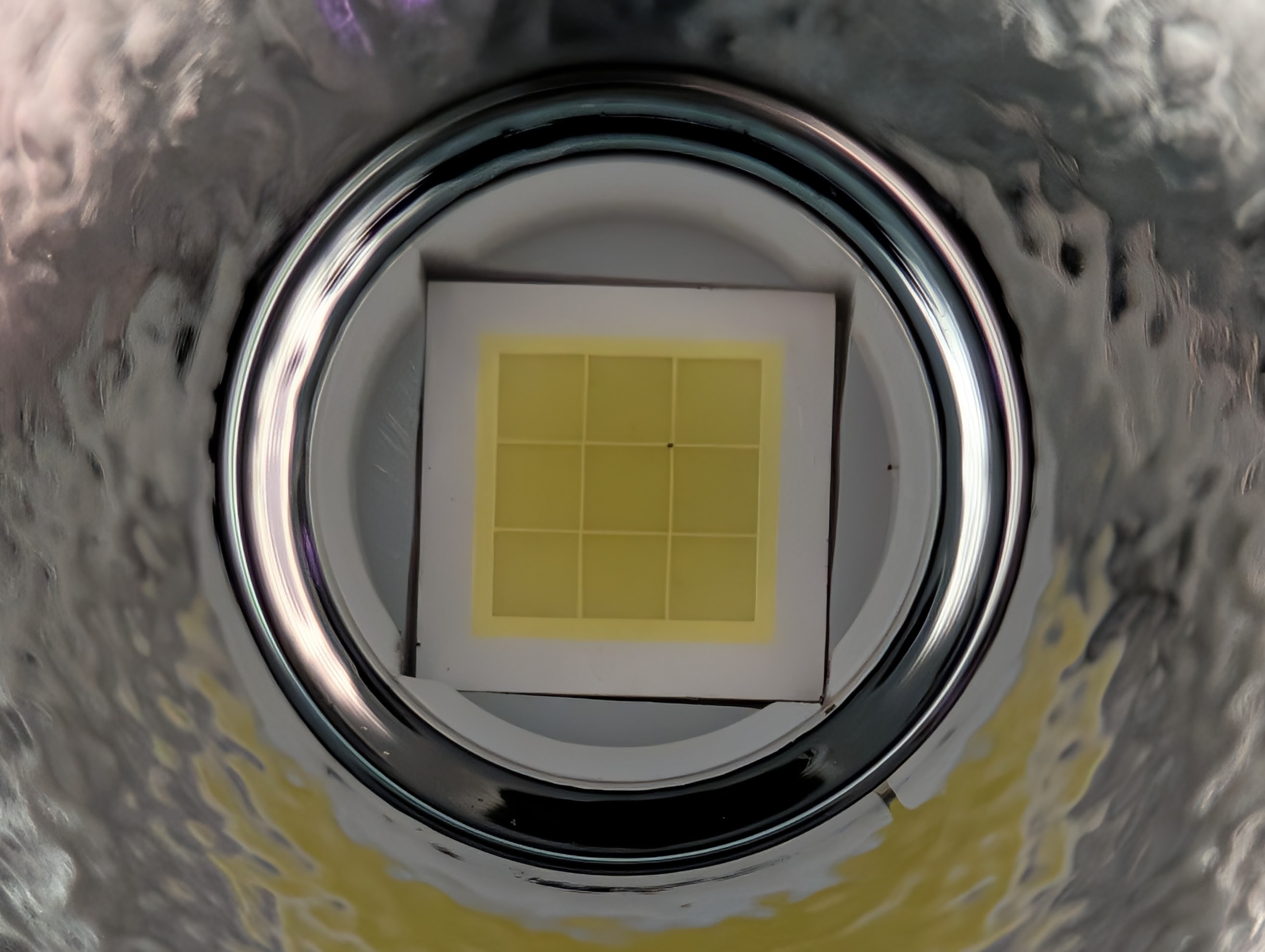

All I will do to this light is to change the LED to an LMP LHP73B 5000K - not because it is needed but because I have so much of them here.
Edit: LHP73B fits nicely, beam has no donut or other artifacts
