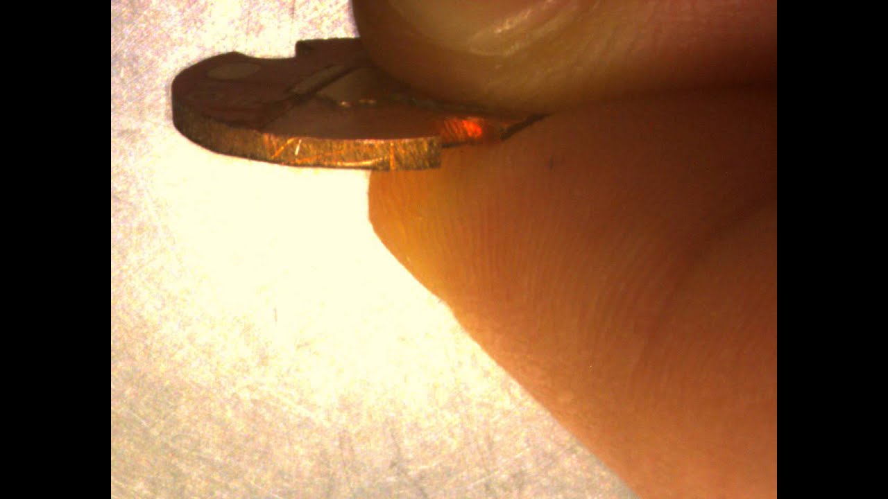

On one of the samples I received, I cut away the insulation layer to expose the base copper. This shows quite nicely how the center thermal slug is solid copper rising out of the base.
On some MCPCBs, the insulating layer is not very well attached to the base copper, and it can detach itself during the extreme heat of reflow. I heated the whole MCPCB up to 250 degrees C and used a sharp blade to try and separate the layers of the PCB. I was unsuccessful. The layers of the PCB are very well joined together.
