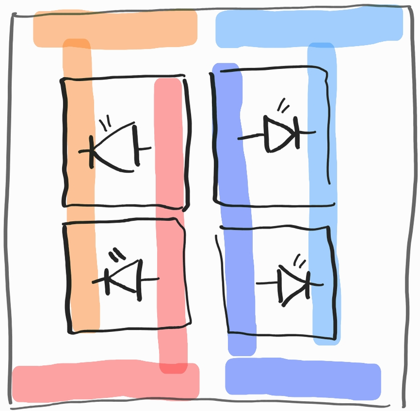

Oh god freaking damn it!
It looks like our dreams have been dashed almost entirely: while the GT FC30 can be made to work in 6-12V, 3V is not currently possible.
“the circuit structure determines that it can not shifted to 3V without an entire redesign”
I am currently trying to get Getian to make us a semi-custom LED in 3/6V variety, but I’m not sure we’ll be able to make that order, as with my previous experience at a luminaire manufacturer, Cree and Luminus required us to make quite the large order to make it so.
I’ll still order the samples for testing obviously, and I’ll be hard at work to convince the higher ups at Getian to make an internal redesign ![]()
