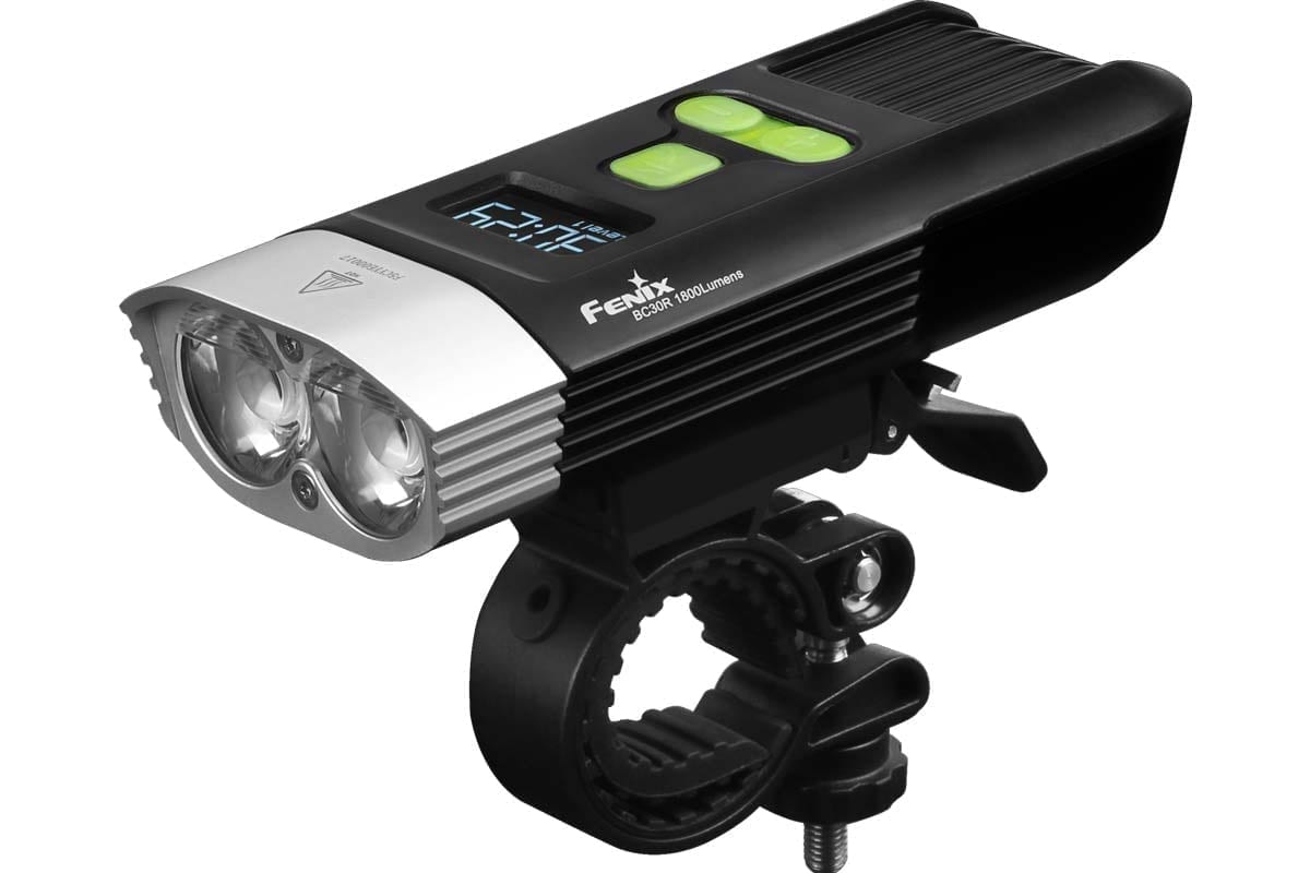

Fenix BC30R

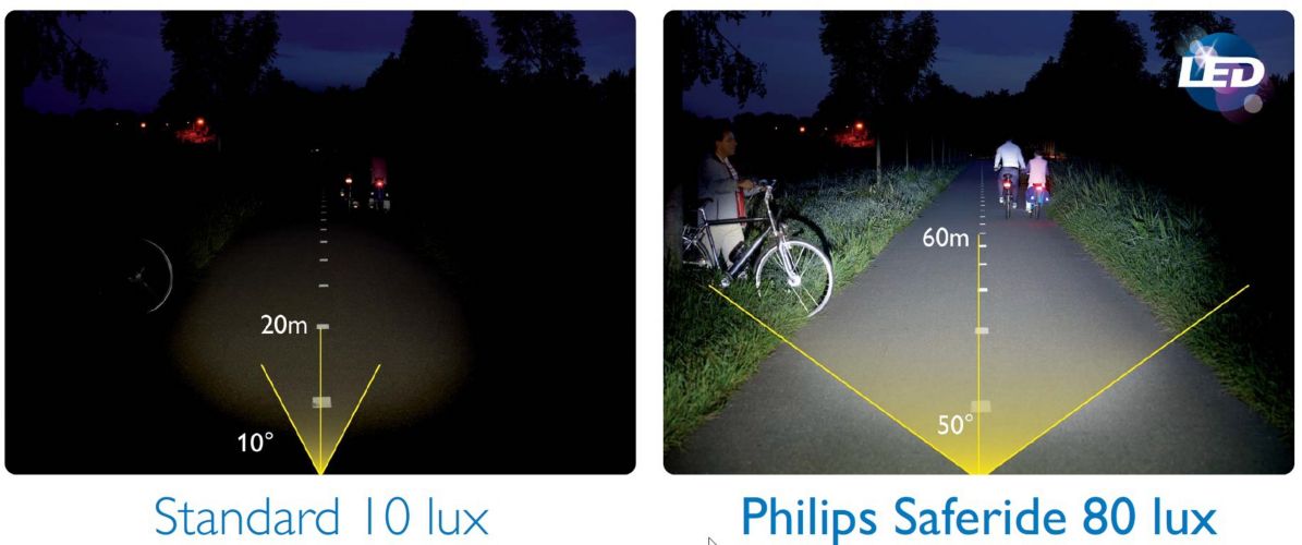

I did some research on the topic a couple of years ago. At that time I was able to find two models with good cutoff - Philips Saferide and Busch & Muller IXON.
+1 Outstanding bike light w/clever mount.
Honestly the beam pattern on the fenix doesn’t look that impressive on the pc. It just looks like one led is facing down while the other is up.
The two that sneym321 mentioned look interesting

My opinion was based on hundreds of uses of the fenix bc30 and bc30r, not a PC image.
Your results may vary. I’m confident there are other fine choices.
