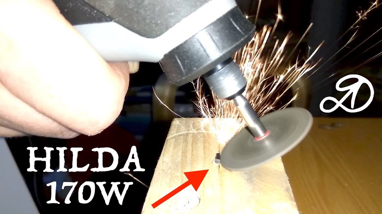

My experience with Dremels (395/3000) has been that they are made to fail by their inadequately designed speed controller.
A few years ago I found and bought a Hilda rotary tool with continuously adjustable electronic speed controller. Its manufacturing finish may seem a liittle bit shoddy for perfectionists, but in my experience with it, works like a charm. It is this one:
The 350W rating is a lie, its actually about half that “continuous” power.
Here is a related video I found:
Of course your mileage may vary, as you are also responsible of giving proper care to the tool.
03:36
