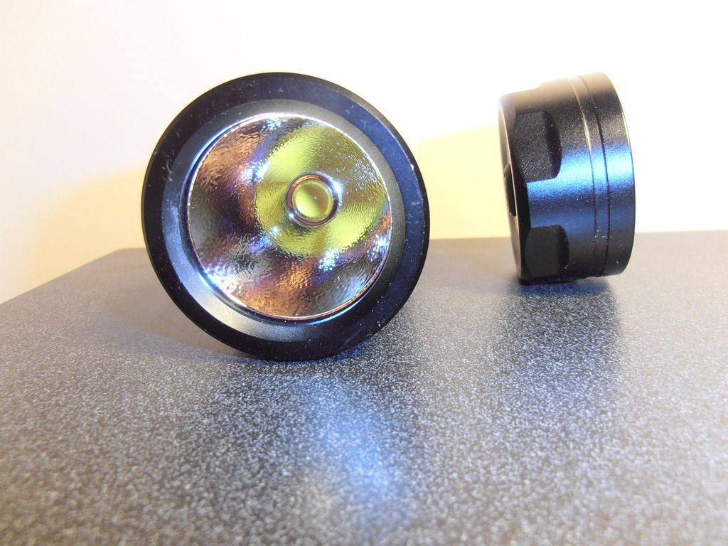

- Perfect slightly creamy neutral white tint
- 4 nicely spaced modes using tailswitch or sideswitch.
- Floody beam profile, this is not a thrower but very nice indoors or outddoors to a couple hundred feet or so.

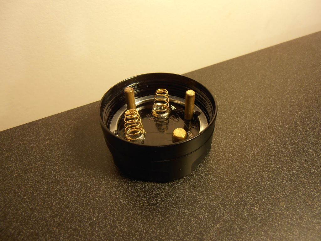

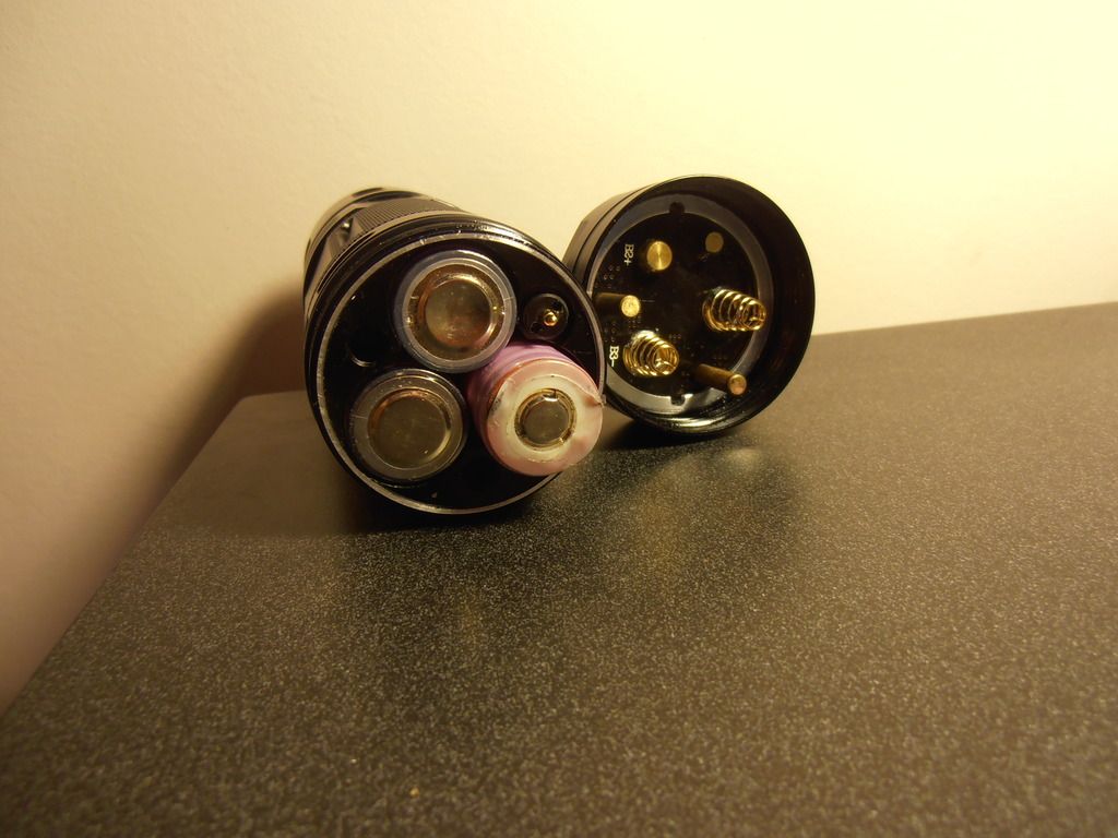

  • Batteries load from rear and contacts rotate inside tailcap when tightening tailcap

Are those 3 different cells being used in series?
Oh weird, one looks black and the other purple with a white ring. I guess it’s just the lighting and slight variations in wrapping.

They are in series, you can see this from the tailcap design, there is also a pic where traces on the PCB are wisable…

One word of warning for all fellow G30 aficionados though: It seems Klarus missed to properly lube the rotating contact element in the tailcap and on some of the G30s that lead to total destruction of the metal bolts when trying to unscrew the tailcap!
It is recommended to add some lube through the little holes or even disassemble the whole tailcap (see Klarus G30 | Taschenlampen Forum for images) and put some lubricant on the metal slide buttons.
