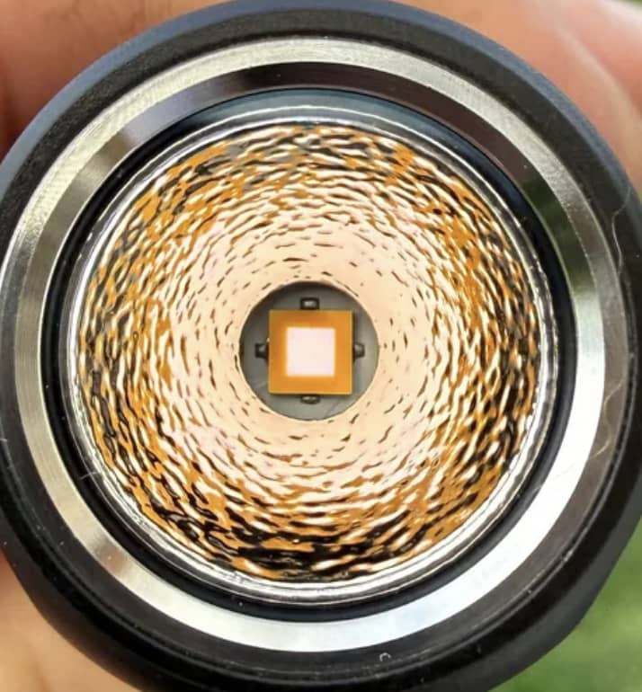

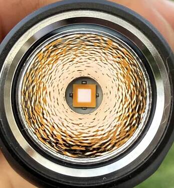

fwiw, not the whole phosphor area actually lights up:
(not my photo, for illumination purposes only)
thats actually an FFL351a.. but same source and phosphor coverage as NTG50.. you can actually see in your photo that the phosphor spreads past the active electrical surface just the same

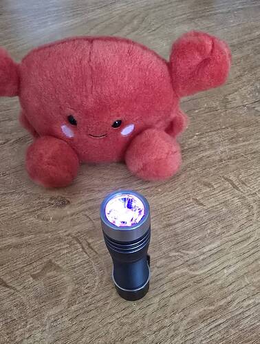

For “dog duties” my secret tip is UV light at night.
It doesn’t make the dog stuff light up though.
It increases contrast so much that it makes it easy to find what you are looking for.
