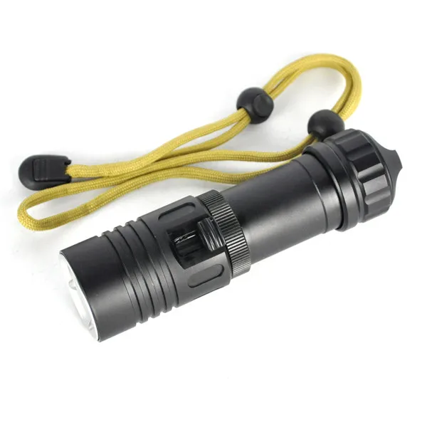

I like the DV-S9 as a nice inexpensive diving light with magnetic slider (no screws, gaskets, etc., for any switches).
Ultrafire DV-S9 seems to be out of stock in Gearbest.
The DV-S9 from Ultrafire.com doesn’t seem to be using genuine Cree XM-L2 LEDs (slightly less bright).
I got 2 of mine from FT. Think only 1 from GB when on a flash-sale.
I was itching to make a wooden “stick” (similar to a wooden ruler) to fit the grooves and try to take off the front bezel, ideally to to an emitter-swap, but never got around to it. It’s fine as is. <shrug/>
Oh, and the BLF code at FT still works, as far as I know, so that knocks off a few % from the price.

The Ultrafire DV-S9 is decent and has been personally tested on a few dives. That does NOT guarantee it’s reliability over time. Typical of cheap lights this one may come with different LED’s or maybe even drivers. Of the 2 I have they absolutely have different LED’s. Construction seems OK. Anodizing is ‘pretty’ and not very good for wear.
I have one of these: U`King ZQ-X960 CREE XM-L2 1200LM Underwater 100m Diving Flashlight Torch - BLACK to compare. Almost exactly the same light but seems better made.
An advantage both have is the ability to use 18650, or 26650 cells. That also makes them larger but they can last more than a single dive. Most bright single cell 18650 are good for a single dive.

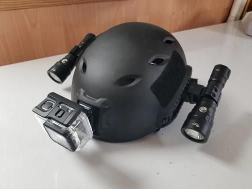

BTW, here is a pic from one of the buyers of the Sofirn SD02 on Aliexpress. He likes the light and I like his set up with his dive helmut.
Sofirn has the SD02 and SD02A (3000K tint). They say the warmer tint of the SD02A works better for underwater?
