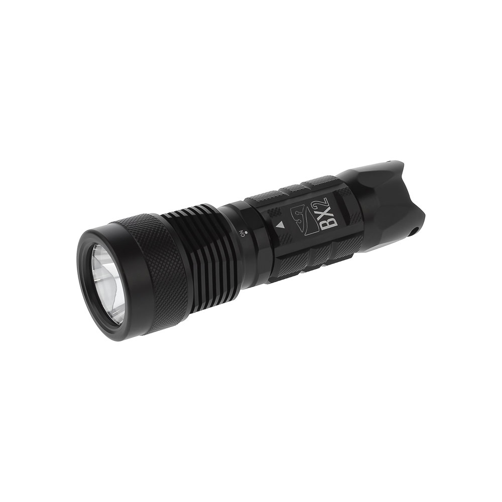

I know the DGX 600 (Dive Gear Express) that I linked to is a ‘cheap Chinese light’ with DGX logo on it. I forget the original brand name but it was pretty common for awhile. I’d strongly suspect the same for the bx2. The issue is sorting out the decent stuff from the crap. I’ve got a good number of cheap dive lights that are only suitable for walking in the rain. For serious diving, I take good lights.
