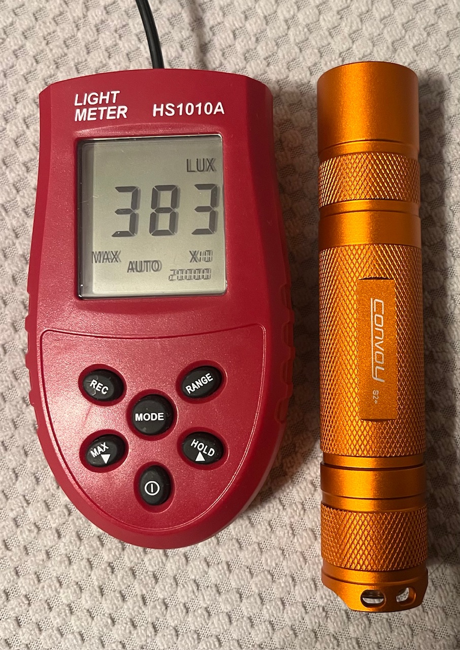

I am interested mostly in the spacing between the modes–if you could give me a relative estimate of how bright the 0.1% mode is in comparison to 1% (via eyeballing or a measurement app like ceilingbounce or phyphox), I would appreciate it very much. A high moonlight does not bother me as much if the modes are well-spaced.
To help me get a sense of the absolute brightness of moonlight: if you happen to have another fairly common light with fairly consistent moonlight (e.g., Convoy 17mm 5A linear driver), a beamshot of them together on the wall would be illuminating.
I don’t particularly mind which emitter is paired with the 6V 5A driver, as the relative mode spacings and the moonlight brightness are practically unaffected.
S2+/LHP531 5000K/10A Buck Driver
