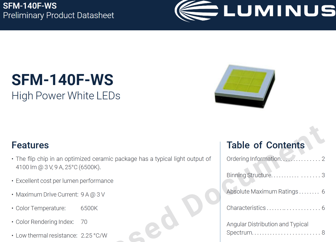

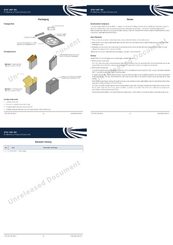

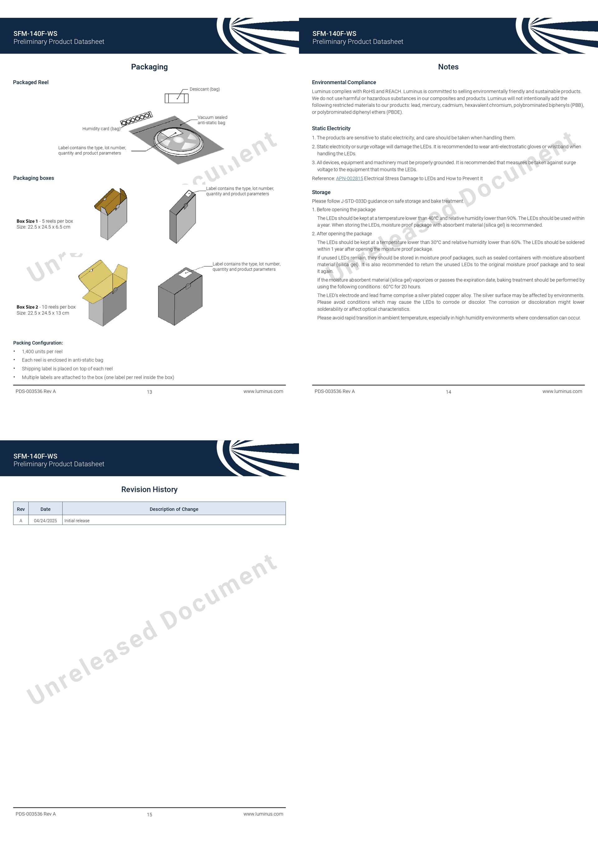

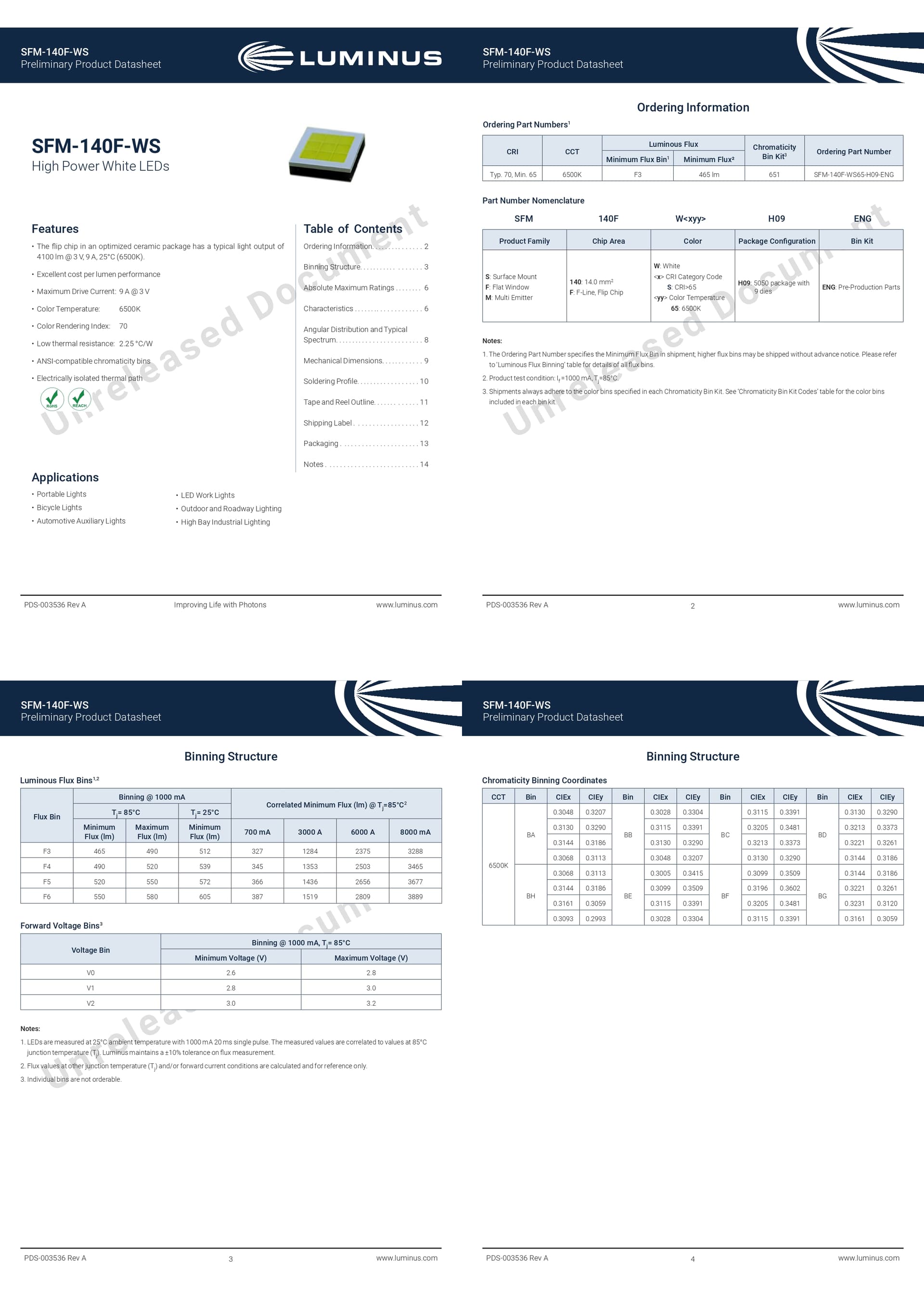

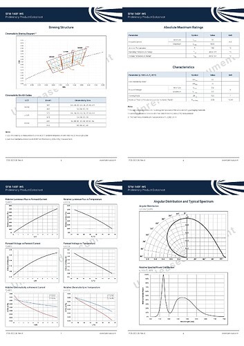

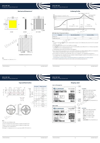

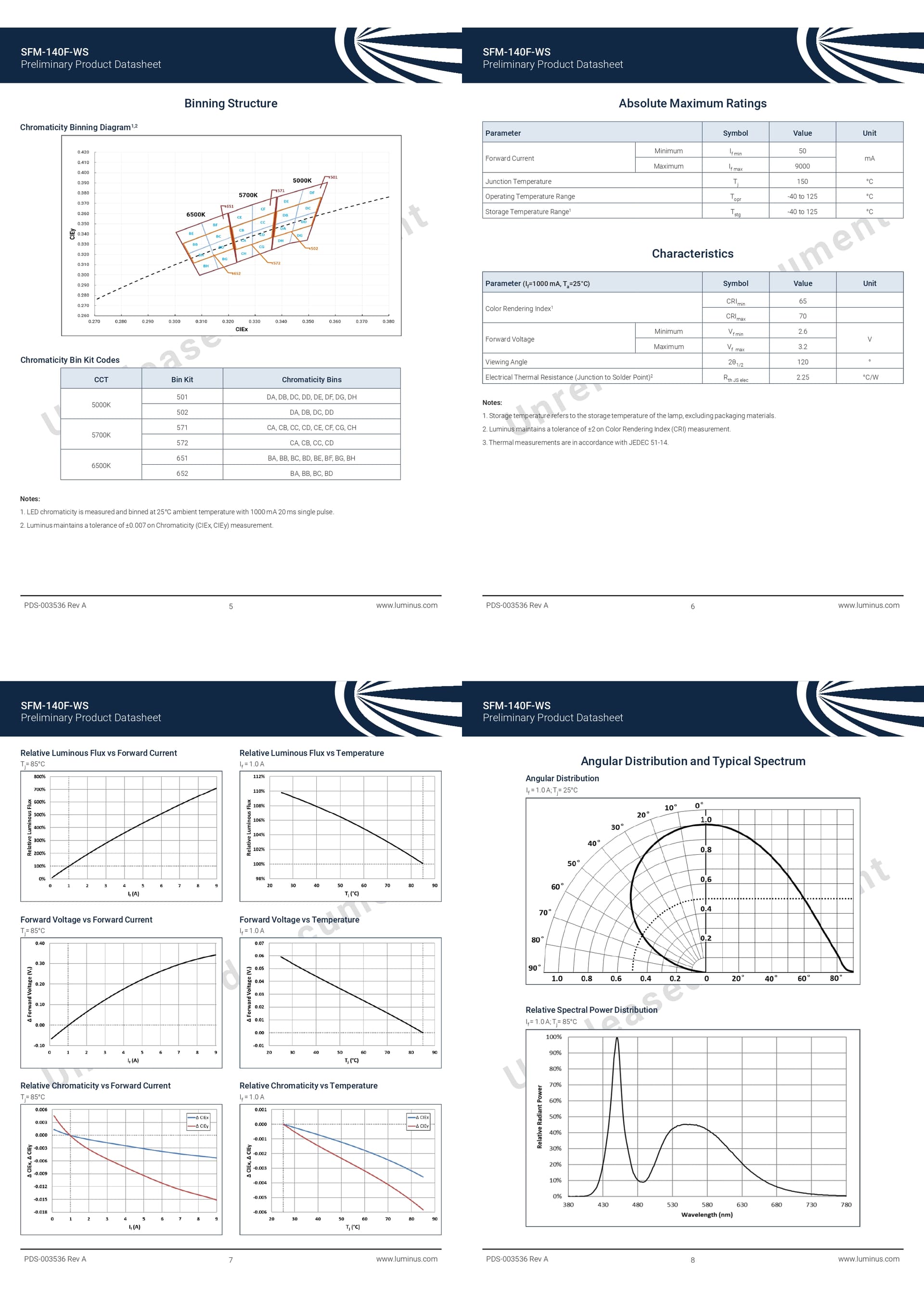

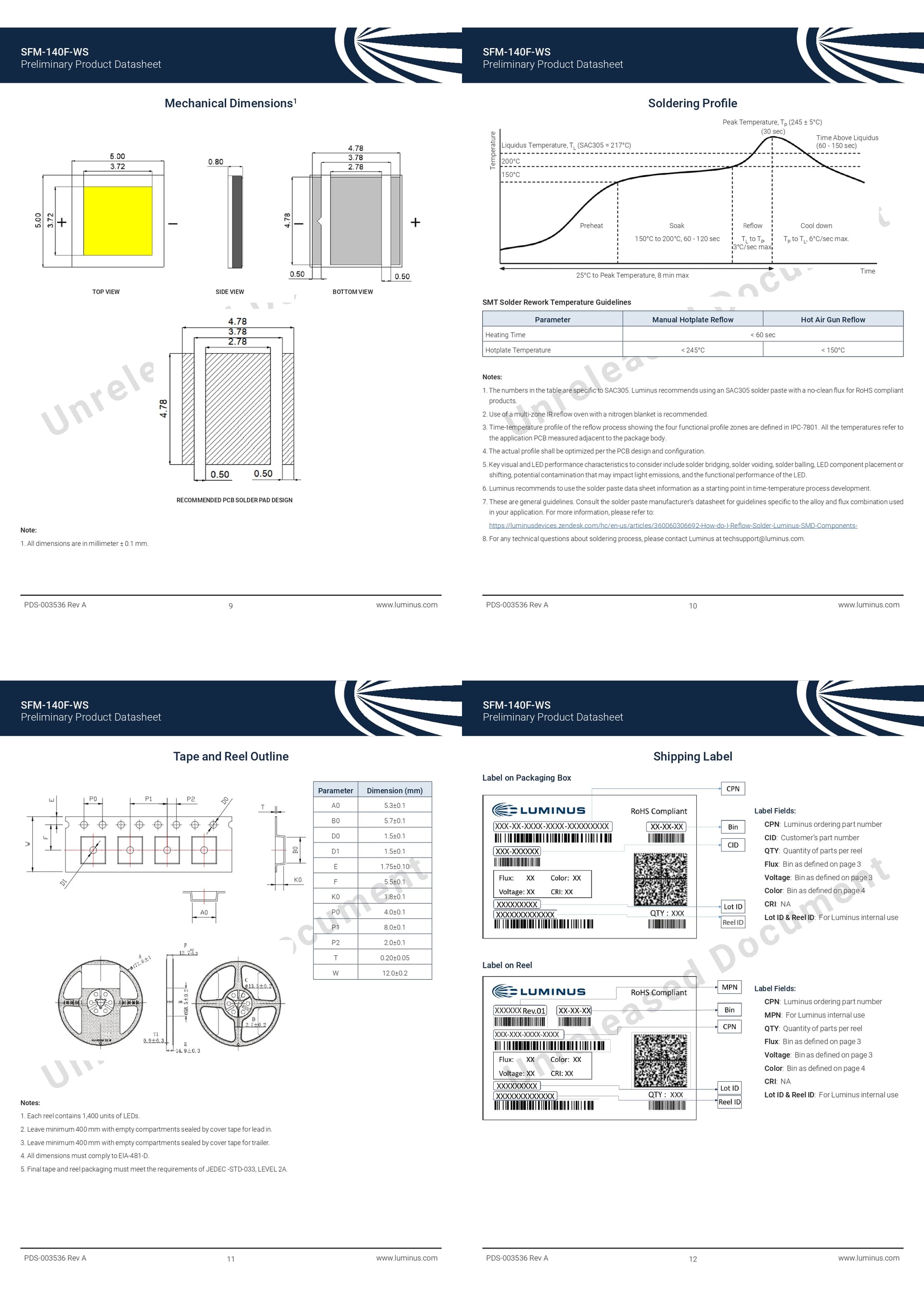

Luminus SFM-140F-WS, in before people search for this emitter name.
The identical photo implies they’re the identical emitters, but the brand Luminus should allows them to be sold more widely.

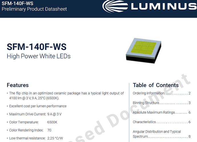

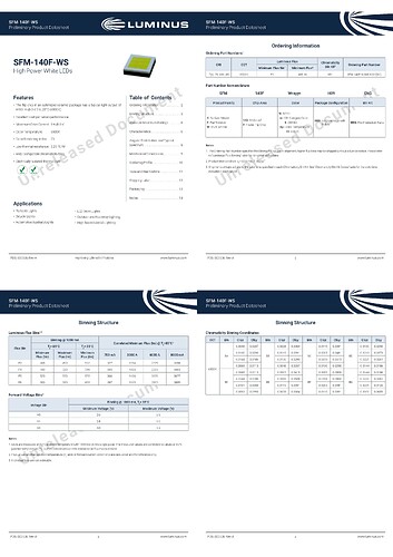

update: the whole datasheet of SFM-140F
8 Thanks
Hmm…
Is it common for emitters to be cloned/rebranded like that?
Can’t wait for worse tint and DUV for 3x the price.
7 Thanks
Pretty sure these LEDs are directly from LMP and are just sold by Luminus under Luminus’ brand and their own sales structure in the West. So far I understand these SFM-140-F are a little bit more expensive (After all, Luminus wants to earn something from every LED, I suppose), but from technical specs they seem to be exactly like LHP531.

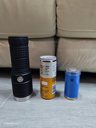

Edit: anybody knows where to buy cheap flashlight with 32mm PCB cavity?
Taobao or any Chinese sellers you have access to.

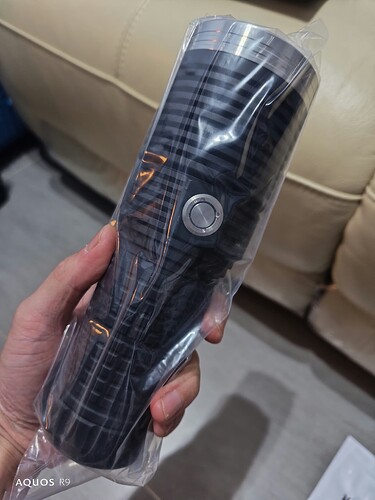

Currently playing with this beast: DDH-D6E
¥168 RMB, fits a 32mm MCPCB, 47mm driver with USBC opening, and a 46950 battery, with 46120 tube optional.
7 Thanks
Thank you. Unfortunately don’t have access to these, only KD, Ali and brands shops with direct shipping to EU.
But I’ll keep searching.
