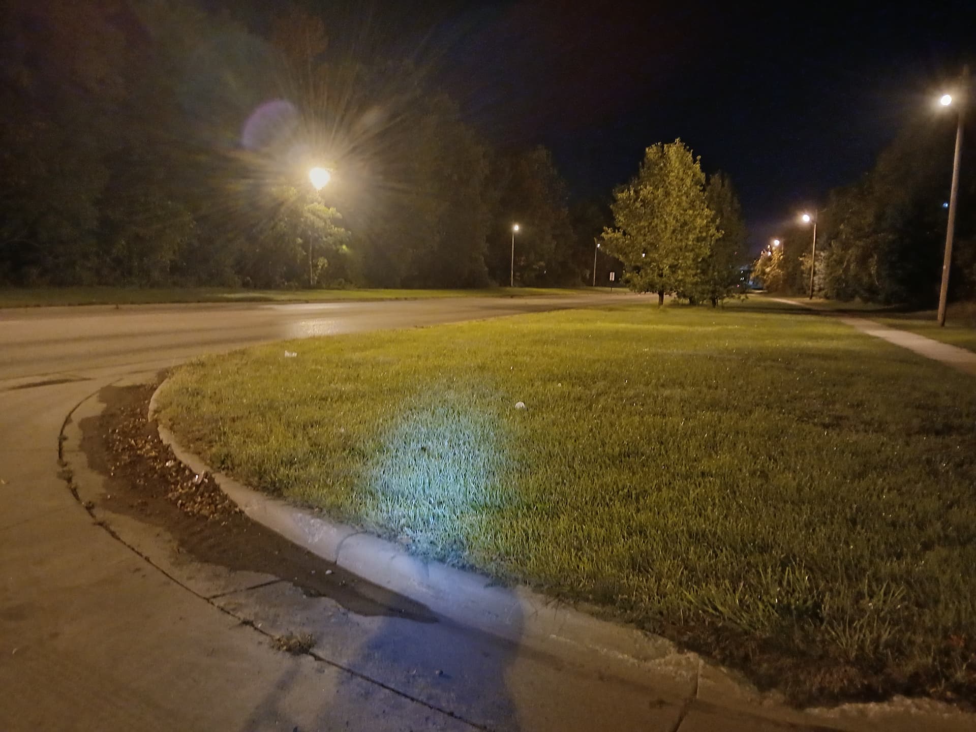

The 1800k is only doing 113LpW. Honestly not worth swapping out High pressure sodium installations above 150 watt. 150w+ sodiums already achieve 105LpW+. 250 watt General Electric lamps Achieve 110LpW and as you go up into 400 and 1000 watt ranges you get up into the 120-160Lpw Range. These would work for replacing sub 100 watt lamps I suppose. But it is not a “Blanket replacement” magic bullet despite popular belief. As with everything there is nuance that is missed under blankets of corporate brochures and sales pitches. Thats not even getting into the Low Pressure Sodium lamps that are comparable to LED in efficiency (higher wattage ones).
That does not stop most Electrical utilities and Citys from slap sticking LED on everything. But sometimes it is a waste of money. Especially when taking into account fixture cost and paying people to throw them up when a high quality sodium bulb is swappable in a few minutes and is able to last 10+ years. (Atleast before manufacturers started dropping quality)
HPS is worth replacing because of how bleak and sickly it makes everything look like.

Why would anyone replace awful sodium lamps with awful monochromatic LEDs?
Because white LEDs are responsible for light pollution..?
IMO 3000K continuous spectrum would be a lot nicer than 1800K (let alone 1800K that’s almost PC Amber)
Edit: for street lights. For flashlights ofc too :sweat_smile:
Any light causes light pollution. Sodium light got popular for one and only one reason - at the time it was the most efficient source of light per Watt. It got popular despite terrible light characteristics. There’s no reason to repeat the bad part of the sodium lamps.
6 Thanks
Your opinion is not as common as you think. Sodium is awesome. And alot of people miss it after they installed glare bomb LEDs with their gray colored lighting (crap CRI). I will take cheap warm sodium with it’s crap CRI but biased towards orange any day over cheap cold LED. Atleast it is not pretending.
I dont NEED to see colors in great detail at night. And if I do thats what headlights are for. And honestly if people are not able to just see with their headlights with some assistance from over head sodium lighting. Then they should be on a bicycle.
Ultimately thr best street light is NO street light. But if it has to exist. Then make it yellow or low CCT. Full spectrum lighting is destroying the eco system all because people are worried about stuff looking pretty.
I would appreciate my tax dollars going more useful places. Like the destroyed potholly roads or the over headpower lines they could move underground.
Sodium lamp has like 50 CRI, 70CRI white light looks like beautiful colorful paiting compared to sodium. If we can make things better than why not?
