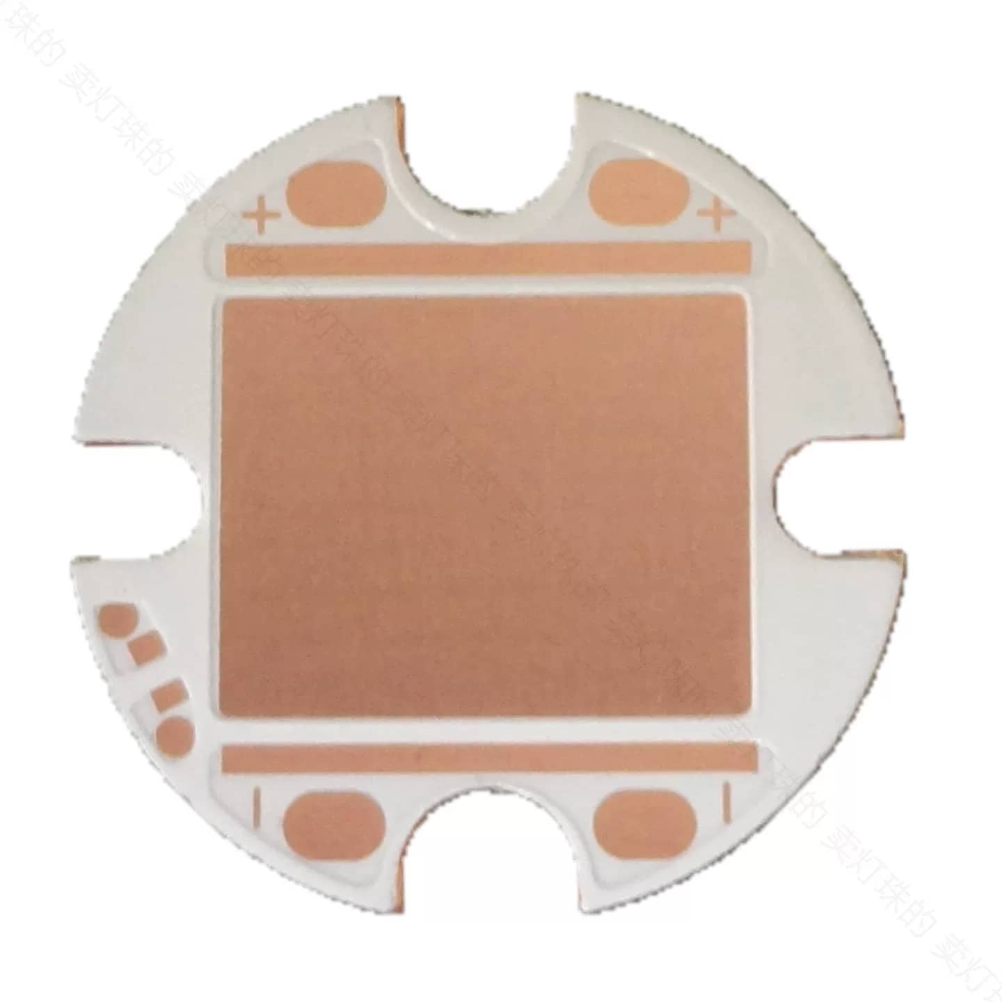

Hallo…Did it happen?:laughing:
Hey, no it did not lol
No 17mm pcb can fit that monster =/
It can be fitted on 25mm MCPCB. Anything smaller? I’m not sure
Simon also offers in 20mm mcpcb…but not in 17mm =/
How will you fit an led with 16x16mm on a 17mm round MCPCB? That doesn’t fit at all
My mistake, I was considering the Nv1010, he does not have the SFY55
No, max square fit in a 17mm mcpcb is 12mm. For a 16x16mm led you need a 22+mm mcpcb.
Since the diagonal is 22.6mm, 25mm mcpcb is the minimum.
