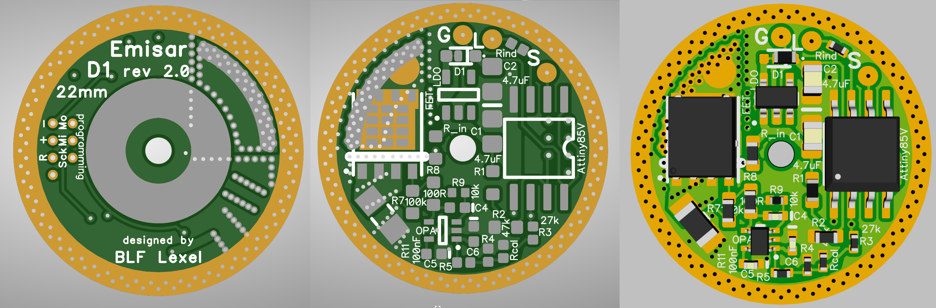

22mm D1S white flat
after the first ptototype failed due to PCB bug I can now finally announce I it for white flats running
first Prototype 20mm small LDO and MCU did not work out
2. Prototype of 22mm with D1S specifications works
still a few things to be addressed, like The not tented Viases next to the LED- Pad that are ground, they are there to get heat from MOSFET note spread but should be below mask

Do you think it would be a good idea to make some future generation that would have FET on MCPCB, compatible with Led4Power’s PCBs?
I have that board thermally improved a lot filling vises with solder, placing a lot of them from ground plane right next to the FET planes
I guess up to 5-6A should be no problem with that PCB, 2 layer MCPCB would be too expensive
there is no single 20mm MOSLED DTP MCPCB for 3030 LEd that I am aware of
also the driver runs on 2.8V
I need for OTSM with also a diode after the LDO
the MOSFET has to have a low resistance below 2.5V for good reguilation at lower battery level
SIR800, 404 and the Infineon BSC009 have down to about 2V relative constant low on resistance
for LFPAK33 package I need a new MOSFET with similar prroperties
any recommondation what to change?
LDO in D1? For what?
CC FET OPAmp has to compare the voltage over the shunt
relative to to the PWM cycle which gets transformed to a DC voltage
The OPV changes the FET resistance to match both voltages the same
But for a constant max current the PWM voltage needs to be aleways the same amplitude so I have to use a 2.8V LDO

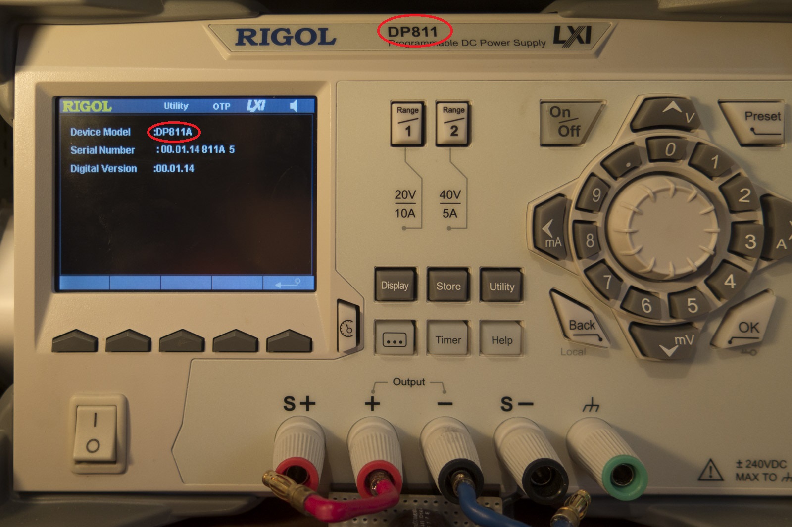

why buy it for 800€ when you can hack it in 30 minutes?
Legally your not supposed to. You lose the warranty as well. That’s the only reasons I can think of.
legally I can also set them back to original non A version, but why is it they sell me the hardware with locked features
unlocking cost 70-80% of the PSU?
So is it legal you reflash the firmware on a driver?
its just a few bits in a a code line that make A version or non A version, no hardware or special calibration
the calibrated PSU costs another 300€ more
I don’t know anything about it, but if it comes with any kind of user agreement, then that could be the basis for the “legally” that Jason mentions. Other than that, it’s just a loss of warranty, since they “legally” don’t have to honor a warranty on a modified piece of hardware. I say go ahead and do it, as long as you are willing to take the risk.

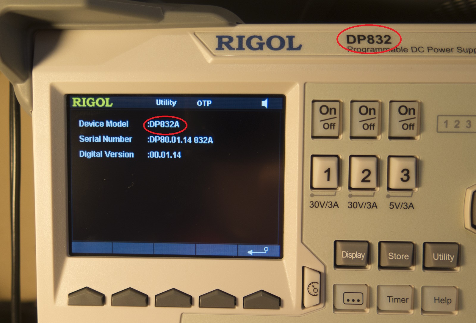

They do it with lots of electronics. My to modify a Fluke 177 to a Fluke 179 takes 15min. It’s a lot cheaper! Well done Lexel!

the thing is both firmwares are identical, the hack changes only in a file DP811 to DP811A,
so its one byte of data changed which makes the difference from a limited to unlimited features supply
It is my property if I want I can throw it out of my window and beat it to a pile of scrap with a 4 pound hammer,
guess trying to claim warranty successful is kind of hard if I do so
Huh, wait, there’s no different firmware that you had to install? Just a different pointer address to the name of the machine?
