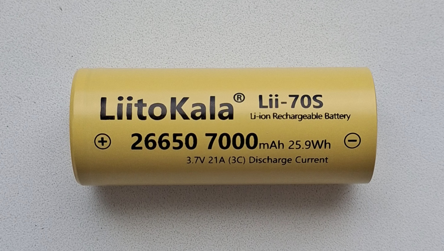

Nominal capacity: 7000 mAh
Nominal CDR: 3C, 21A
Weight: 96g
ACIR: 17.7 mOhm

Bougth it from AE
Far less cheap than King 4000, but with discounts I managed to get it for smaller price than NKON’s Keeppower 26650 7000mAh (and with free shipping).
I’ve also bought a Lii-70S a while back from AE. Normally I don’t buy 26650, since I have only a couple of lights that use that size and I prefer to run 21700’s (with an adapter) in them.
Because I was curious about this cell (and it’s actual capacity) and I could stack a couple of coupons to get the price down to € 5,73 (incl. shipping), I’ve ordered a single one.

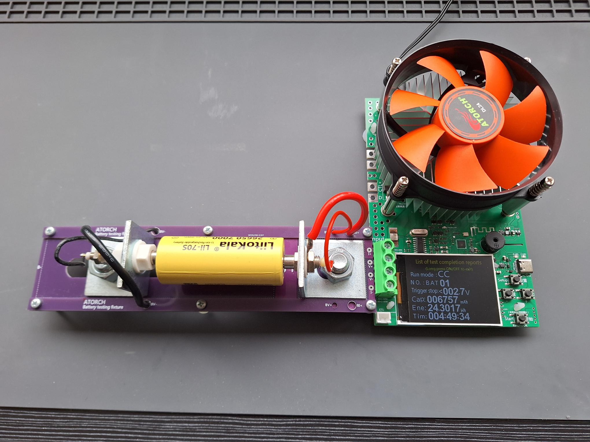

I finally had time to do a first discharge test of my single Lii-70S, which has been (unused) in storage since recieving it.
I had charged it up and let it rest for 30-45 minutes and measured 4.201V on my DMM at the start of the test. I applied a 0.2C discharge current (which comes down to 1400mAh), because that is (most) common for manufacturers when capacity testing/rating their cells. (Liitokala doesn’t specify that on their website.)
I set the cutoff voltage at 2,7V, although Liitokala gives contradicting values on their website.

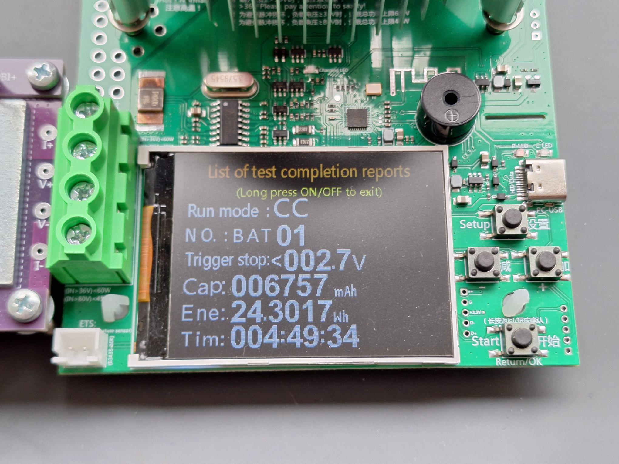

Testing was done on my Atorch DL24:
In the end I’m slightly confused/dissapoint by the low capacity that was measured:
6757mAh is well below what @Qubeet measured at 2,8V and also too far off from its rated capacity. I will repeat the test in the near future, to see if I made a mistake or that I just might have a bad sample. (In the end, I only have a sample size of 1, so not the most scientific approach.)
