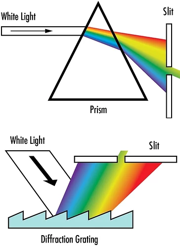

In the spectrometer however, in front of the sensor there is not a camera lens, but a diffraction grating (that acts the same way as a prism for this application):
(Source: https://www.edmundoptics.com/knowledge-center/application-notes/optics/all-about-diffraction-gratings/)
The diffraction grating splits the incident light, and depending on the wavelength, bends it “more left” or “more right” on the sensor. This allows the spectrometer to use physical position on the sensor as a way of measuring the wavelength. Depending on the quality of grating and sensor used, one can go deep into sub-nm resolution. This here is a cheap grating (repurposed DVD) and a cheap sensor, so while it gets barely sub 1nm per pixel, the usable resolution is, even after calibration, not quite as low.

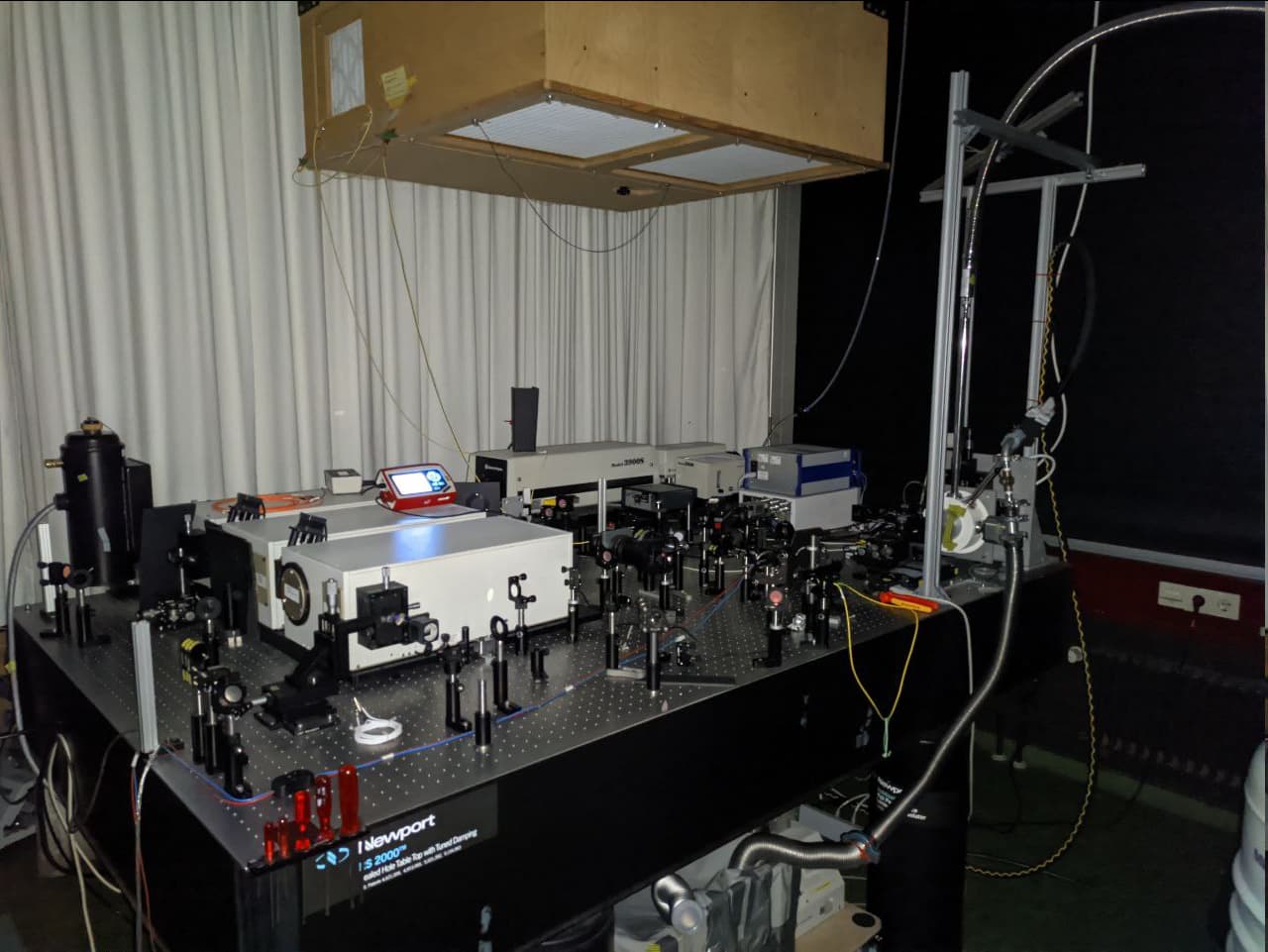

As a comparison, the 3 large white boxes on the left side on this pic are a spectrometer as well (all 3 together) and the large black cylinder on the rear left side is a liquid nitrogen cooled CCD sensor. This is how the large and spendy scientific tools look like :smiley: And it probably is still pretty small by those standards.
