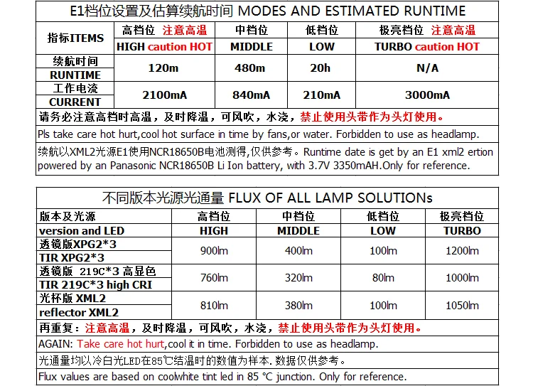

Right, I was considering this one. But Jaxman claims it has no temperature sensor. So either it does something I don’t know to regulate the current, or high mode is time driven. Still holding until this is revealed.
