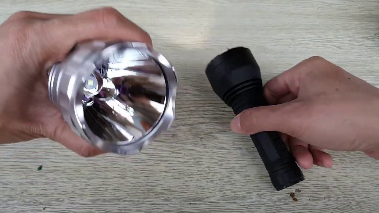

Hi my friends, surely a lot of you are looking for a thrower flashlight. Today I send you a comparison of the two thrower flashlights I am using, Lumintop GT mini and Convoy L2.
I will share the things that Lumintop GT mini has and Convoy L2 doesn’t have and vice versa. Hope you will choose a flashlight suitable for your needs.

Things Convoy L2 still has Lumintop GT mini does not have:
- Convoy L2 is much larger in size, and twice as much as the mini Lumintop GT mini. Due to the large size Convoy L2 will dissipate heat better. Lumintop GT mini reduces brightness when running in Turbo mode continuously for a period of 3 to 5 minutes by rising temperatures and Convoy L2 is still very cool. If you need to use high brightness in continuous time, the plus point for Convoy L2.
- The size of Convoy L2 is extremely large, if facing the neighbor dog you will be more confident if you hold the Convoy L2 in your hand. Convoy L2 can be used as a weapon for self-defense.
- The use of 2 26650 batteries for longer usage time on Convoy L2. Using 2 batteries is also an advantage when you can use 2 laptop batteries with low discharge for Convoy L2 by P = U * I.
- Convoy L2 has more color options than the traditional black color of Lumintop GT mini. I really like the white version of Convoy L2, it’s very nice.
- Convoy L2 is sold with more accessories. Includes 2 small magnets for us to use with flat batteries. You won’t worry about our battery being too bad in the middle of the lamp. A combat ring, I don’t use it but you might like this battle ring.
- The user interface of Convoy L2 is extremely simple. You only have 3 light levels: low 5% -mid 40% -high 100% with 2 strobe and SOS modes.
- Convoy L2 has up to 4 colors suitable for the needs of each person: V2-1A: 6500-7000K, U6-3A: 5000-5300K, U6-4C: 4500-4700K, U4-7A: 3000-3300K compared to 2 of the Lumintop GT mini.
- Convoy L2 uses tail button
- Non-spilled lamp head brings an unlimited Mod ability for Convoy L2.
- Convoy L2 has a low voltage protection function and anti-reverse polarity, I do not see Lumintop mentioning these 2 protection features. During the use of the Lumintop GT mini, my battery has dropped below 2.2 vol and I cannot charge the battery with the HTRC charger.
