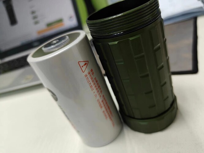

There are two versions, Mach 4695 has a built-in non-removable battery. If the battery is replaced, only the battery pack can be replaced. The upgraded Mach 4695 V2 battery is detachable. I checked this link and upgraded it to V2 version.
Looks the same as the Amutorch battery with the combined +/- on the top.

I received mine last night. V1 46950 version, it’s only 3 mm’s longer than the 3-21700 version. To keep it short they completely omitted the removable tail cap and charging station. This light only has the side charging port but does work as a battery bank. The difference I see with V1 and V2 looking at Noda’s picture is V1.
Running it against the Astrolux EC06/Sofirn Q8 plus at 4.15v using 3-Molicel 21700 P42A it was nearly equal in output. However the Mach 46950 only at 3.7v as received. Testing/playing with the two last night I managed to run them both down to 3.3v and the Mach was brighter at this point. The fan really helped keeping the top half cooler. The one part of this light design that I’ve got mixed thoughts on is the limited thermal path of the head to the body. First the fan cools well and the limited path keeps the body and battery cool. However the body and battery gives lots of mass and surface area for additional cooling.
