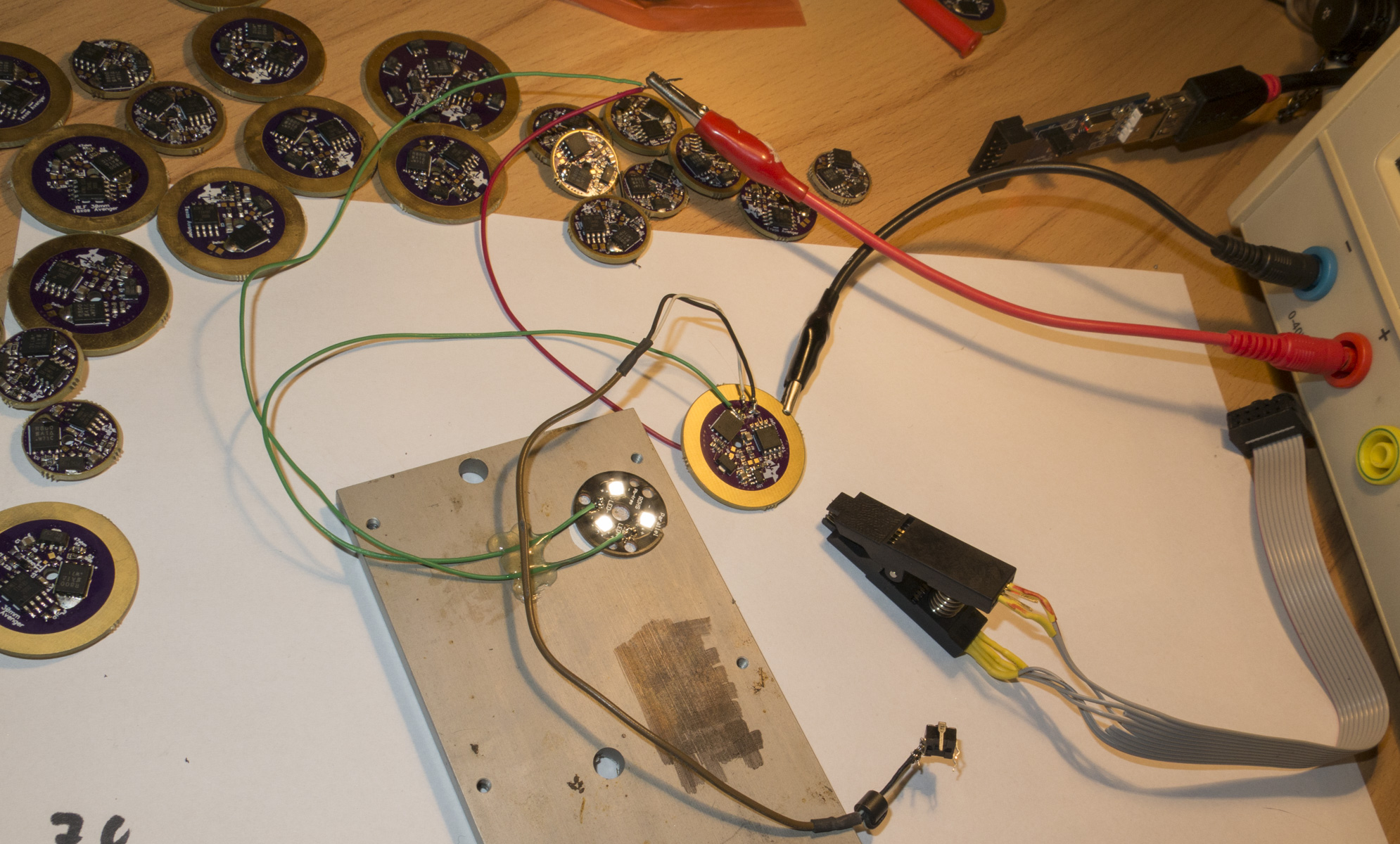

first driver flashed and under testing and temp calibration
With lots of happy on lookers. ![]()
first 8 Narsil driver cleaned from flux, electrical check
test and temperature calibration

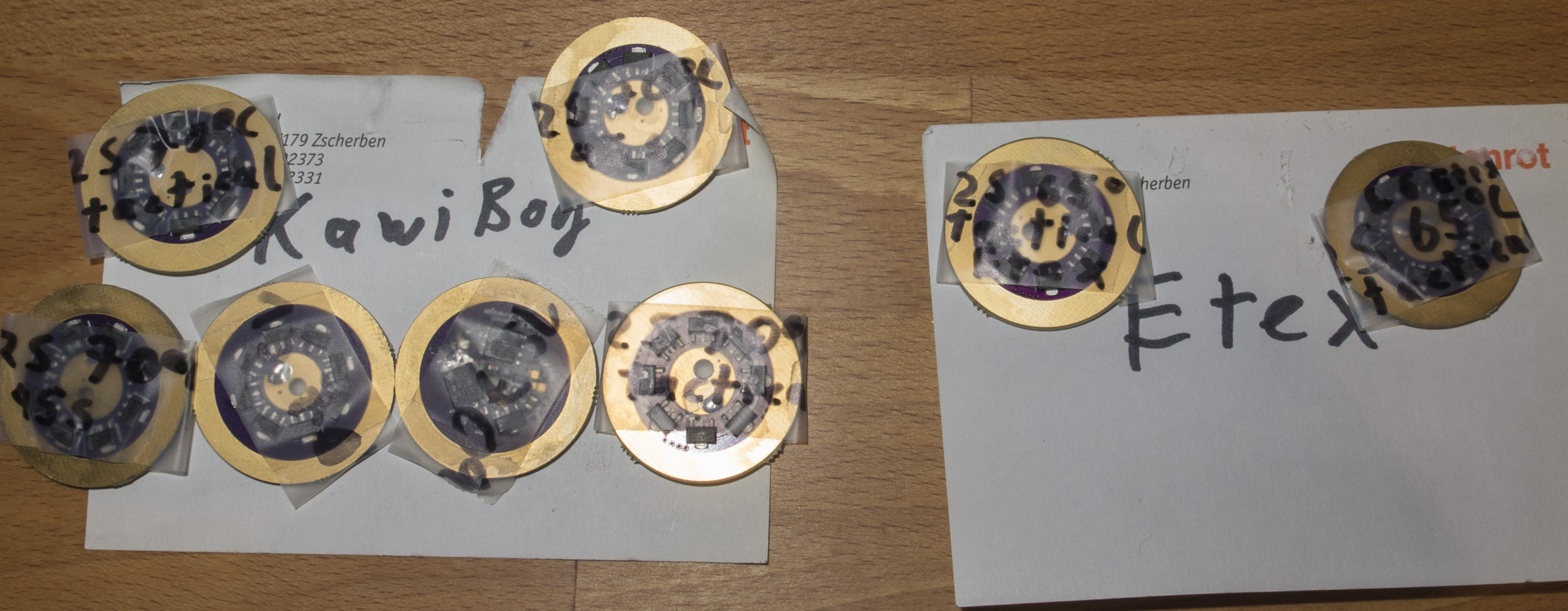

Output first orders complete to get shipped
