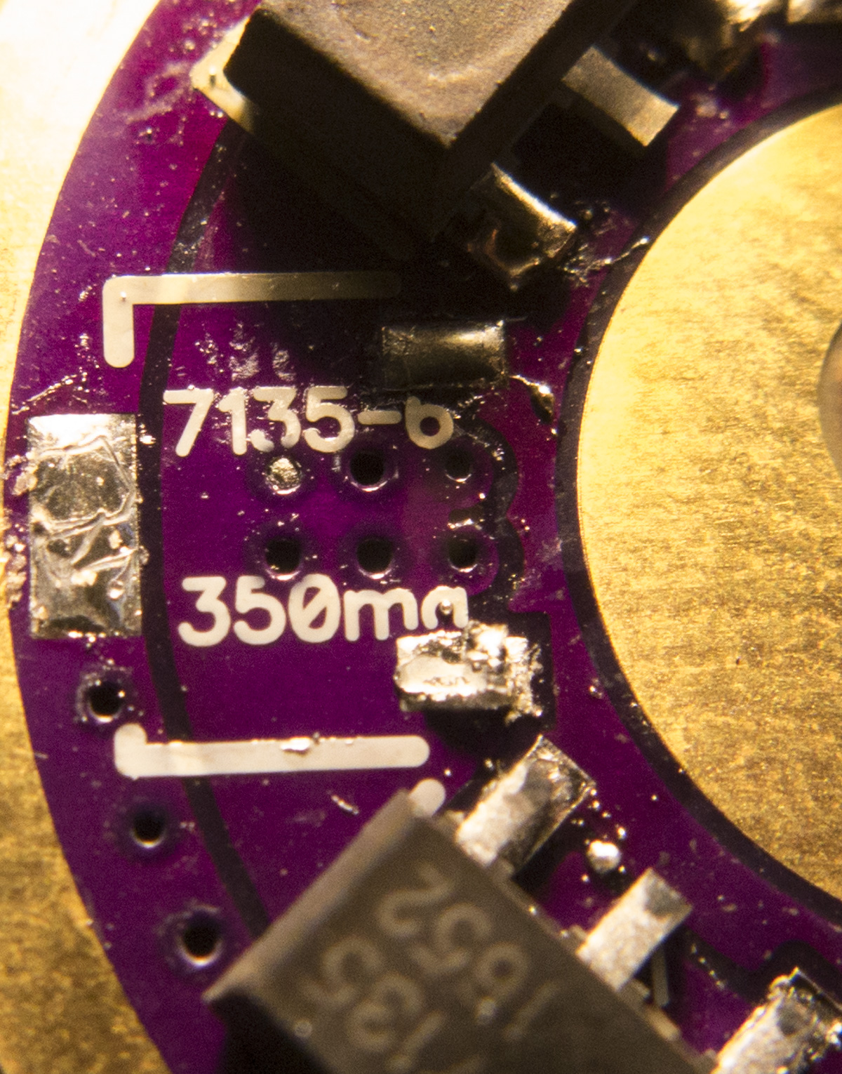

this is now the 3. board witch such an issue
not enough solder mask paint, and I get ground short from back of one AMC7135
costed me 1.5 hours so far
board looks messy when you unsolder those AMCs too often
Those shorts are almost always a result of too much solder paste. This is why I recommended the stincles. They make it much easier to get the right amount but not too much.
This is a case where less is more.
The mask looks good, the solder looks to have been pushed up from the FET having too much paste.
Generally if you replace the 7135 and reflow it back on it will work fine as that removed a little bit of solder paste when you do that.
