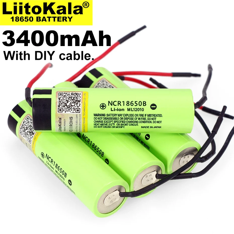

I have tried it with my charger and i can only get 3200mah with 1.6A Discharge if only i charge my batteries (from liitokala stores) with 0.5A and i read 84mOhm internal resistance so i am sure these cells are not original. I have original NCR18650Bs with 32mohm IR and they are 3 years old i guess. meausered with same icharger 3010B.
I will do further testing with stronger contacts as ’‘
’’ mentioned. Will see if it makes any difference.
84mOhm AC resistance is very high for NCR18650Bs, especially new.

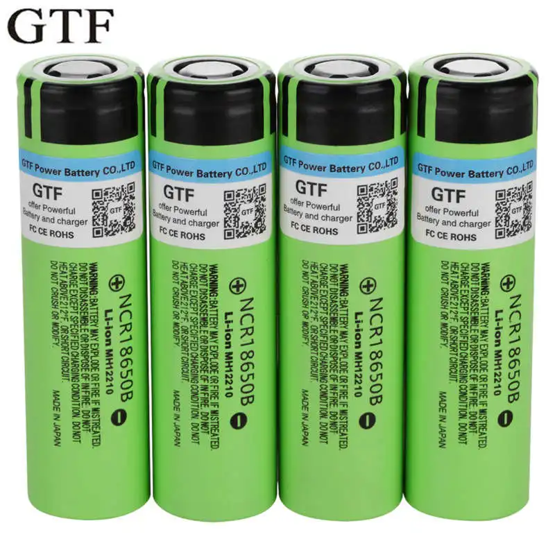

I have ordered from lucky E. store, turned out it is same store with Aliya store, they are selling from 2 different store. i will test their battery and share the results here too. currently testing Littokala and GTF batteries i had … suprisingly some of them shows results same as originals.
CHG 1.6A, DCHG 4.5A, Capacity around 3170 mah but some of them , you just cant get more than 2300.
So, i have a question to you guys, is there such thing like cycling batteries at low amps can increase their capacity ? (i know Nimh or NiCd batteries have ‘’memory effect things’’ never heard such things for lipos or li-ions)
i am having hard time to figure out why some of the batteries i get from littokala or GTF store are performing better now…
Edit Store links here, i have got batteries from these sellers some of them are still on the way;
https://www.aliexpress.com/item/GTF-100-Original-3-7V-3400mAH-18650-Lithium-Rechargeable-Battery-NCR18650B-Li-ion-Cells-For-Panasonic/32931029532.html

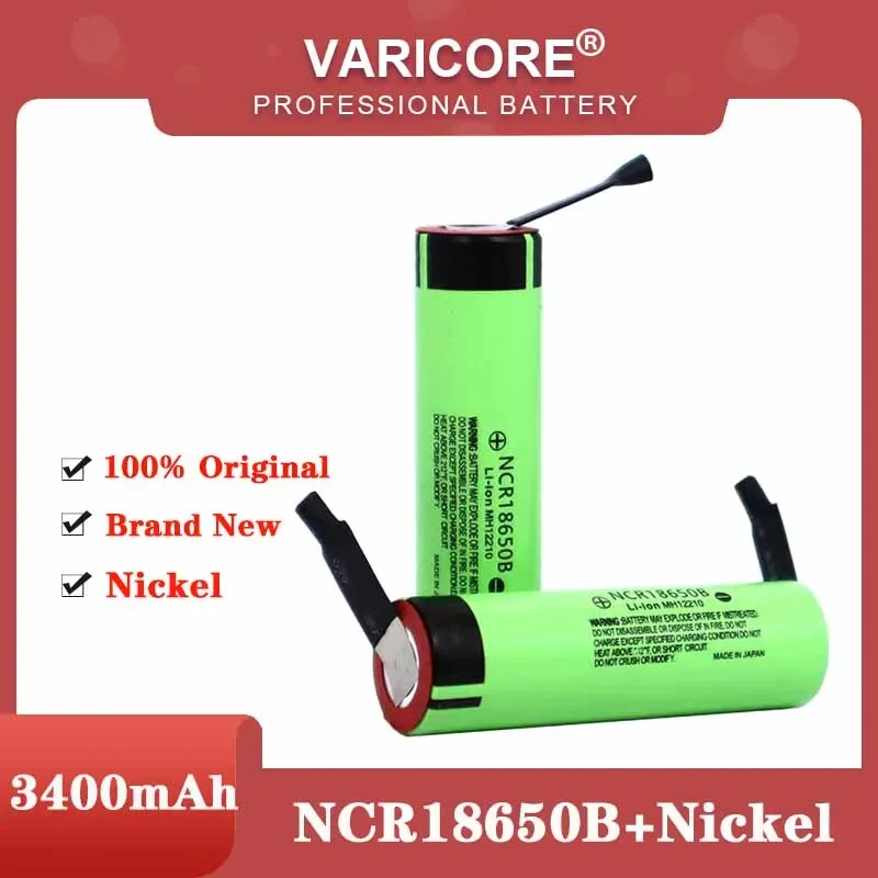

What are brands Varicore and littokala compared to Panasonic, Samsung and LG?
Isn’t NCR18650B a Panasonic product? What is a Littokala NCR18650B?
