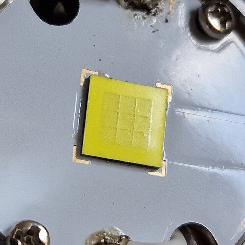

You’ll also possibly need a centering gasket of the right size and a new MCPCB. It isn’t too clear if the light is actually using a 7070 SFN55 or a 11x10 SFH55. It’d help if you could post a closeup photo.

Thank you for the information! Here is a picture of the LED closer up:

That is definitely an SFN55, looks like XHP70.3HI will be a drop-in swap with the new driver. You’ll just have to reflow the mcpcb.

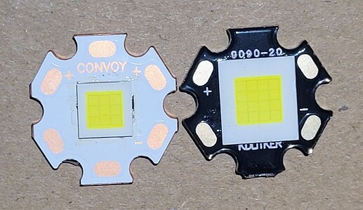

Btw ya, that emitter doesn’t look like an sfn55 or an sfh55 to me. Here are the two emitters side by side. Sfn55 on the left. Sfh55 on the right
Not sure what yours is. Haven’t see that one
Some of the new production San’an emitters had phosphor all over the sides as well. It looks like a new style SFN55 to me, note how it is a 3x3.
Is it just me or does it kinda look like a 5050?
Oh wait, nevermind, I watched OPs video. Does look like a 7070 there.
Even if it was 5050, I don’t think there’s any 9-die 5050 emitters.
Sfn40

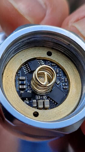

So I managed to find a 17mm 6v 5a boost driver from Convoy and it arrived today.
I’m still waiting on the XHP70.3 HD 90cri.
The driver fits snugly in the head and an 18650 unprotected cell fits inside just fine.
However, I have limited experience with this so I wanted to ask you guys if something is wrong here:
The brass retaining ring appears to be making contact with components on the driver, or at least very nearly!
Is this a problem or do I need to machine a little off the brass ring to avoid contact?
Thank you for any advice here.
Philip
It looks very tight!
It also looks like it should be fine but to be safe I’d maybe just take a small round file and remove 0.5mm or so on the inside
Yeah, it’s tight alright! Ok, I’ll probably chamfer the bottom inside edge then. Thanks for the advice!
