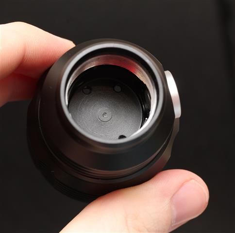

This, another reason to buy it. No pill. Should have great heat transfer..
