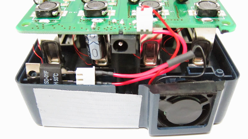

I'm going to add a cooling fan to the i4 and hopefully, it will help. This is a 5v fan from ebay (30mmx30mmx10mm)
I will need a hole here, so the fan can push air into the case.
I will make a cover for it, with some aluminum sheet and some foam to keep the dust out.

There's the board.
The case already has some slots molded in, for cooling, so I will have an exhaust area for the fan.
I am also going to cut tiny slots along the case where the batteries set, so that some air might possibly blow past them. This area is a natural channel, so air should be able to get down there easily.

OK, so I got the fan mounted and I got power to it. The fan works, but as long as the fan is in the circuit, the charger does not work.
It's a fail and it's because I do not understand circuitry. Plain and simple, don't try something you have no clue on how to do, unless you are prepared for complete failure.
Anyhow, someone who was an electrical engineer, would probably find the correct circuit in a flash, but that's not me.
I just left the hole open and **** it! It will just stay hot.
Thanks texaspyro. All I needed was to know which point to get the current off of.
I ended up taking the filter off. Some other time I will figure out a better cover.
