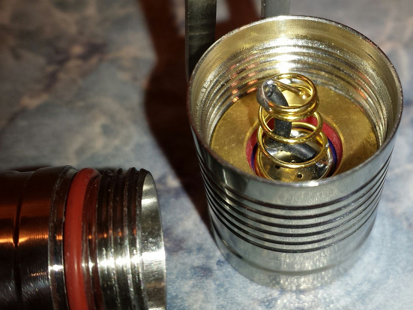

E01 from banggood
made from stainless steel
that thing is heavy
XP-G2, orange peel, GITD O-ring no coating
they braided the tailcap!!
inside the head
the UI:
using the reverse clicky you switch ON
a soft half press toggles modes (LOW-MID-HIGH)
another full press to OFF
no mode memory (10 sec) - starts in LOW
my thoughts:
not very cheap, but feels heavy and trustfully
no knurling - just polished, slippery stainless steel
very simple UI - i love lights without disco which start in low!
