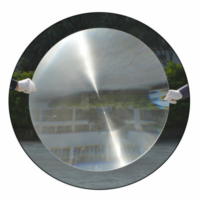

We bought this Fresnel
and we will see if it rocks…
Regards Xandre
PS This Fresnel is the only one (big sice)
which so a short focal length -
